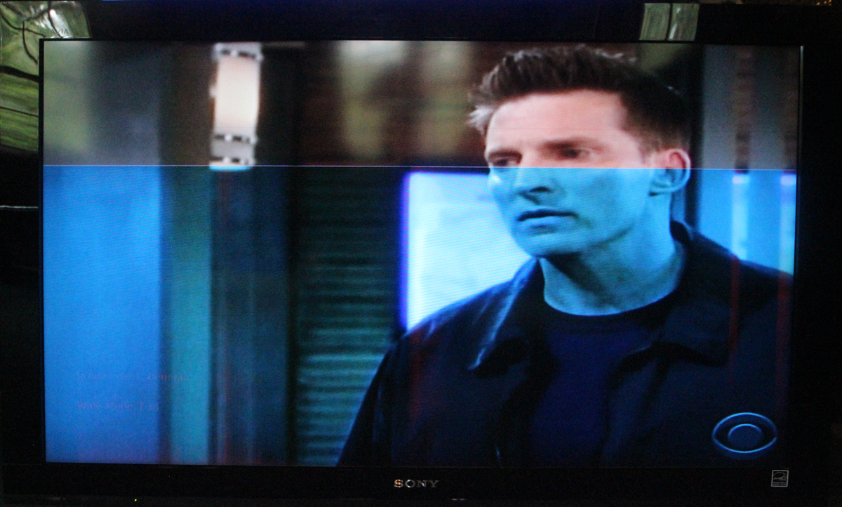

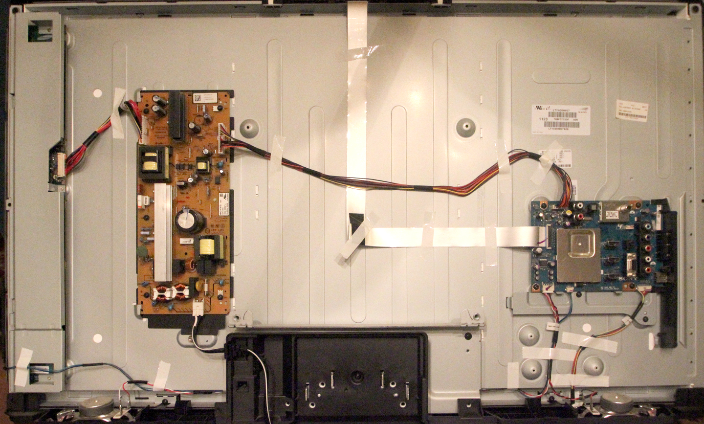

    Sony KDL 40 - tabs bonding?
    Have a Sony KDL-40BX421 - something going on with the screen. Have seen a few threads about tab bonding. Top quarter of the screen looks great - bottom looks like bad panel or T-con. Can't figure where the T-con is on this TV. From the photos any suggestions? And where is the T-con board? Thanks
    Re: Sony KDL 40 - tabs bonding?
    One of those integrated T-CON into the panel, not much you can do for fixing the T-CON.
    Looking at the screen shot of the screen, not 100% sure if it is tab bond problem or not.
      Any other options! Any chance of selling any of the parts that are probably still functioning fine? Thanks
