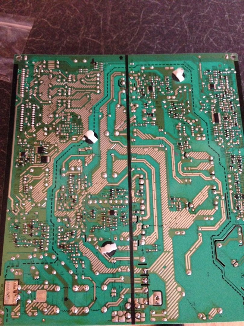

    hi guys i have a samsung le37r7bd with white screen, see pic, anyone know the cause, thxs

    Most likely TCON.
    Pics of boards please
      Re: white screen on samsung 37"
      Looks like Bad GAMMA IC.
      Probably this is the T-CON in his TV with AS15 GAMMA IC.

        Exactly what I was thinking budm... Gotta love the AS chips LOL

          thxs guys. i did suspect the tcon board, just didnt want to buy one untill i was sure as they about £50,
          i looked into changing the ic but look tricky.
          will order tcon as soon as i see one turn up on ebay,
          http://i989.photobucket.com/albums/a...image1%201.jpg

            You haven't open the screen yet, right?
            Once, I had something very similar and it was a pot on the LCD PCB, it got knocked off the board by me, when I was putting the screen together.

              i hadnt opened it untill the fault but have since had the bk off to look at the parts

                received new tcon board today, fitted and tv fully working, thxs guys
