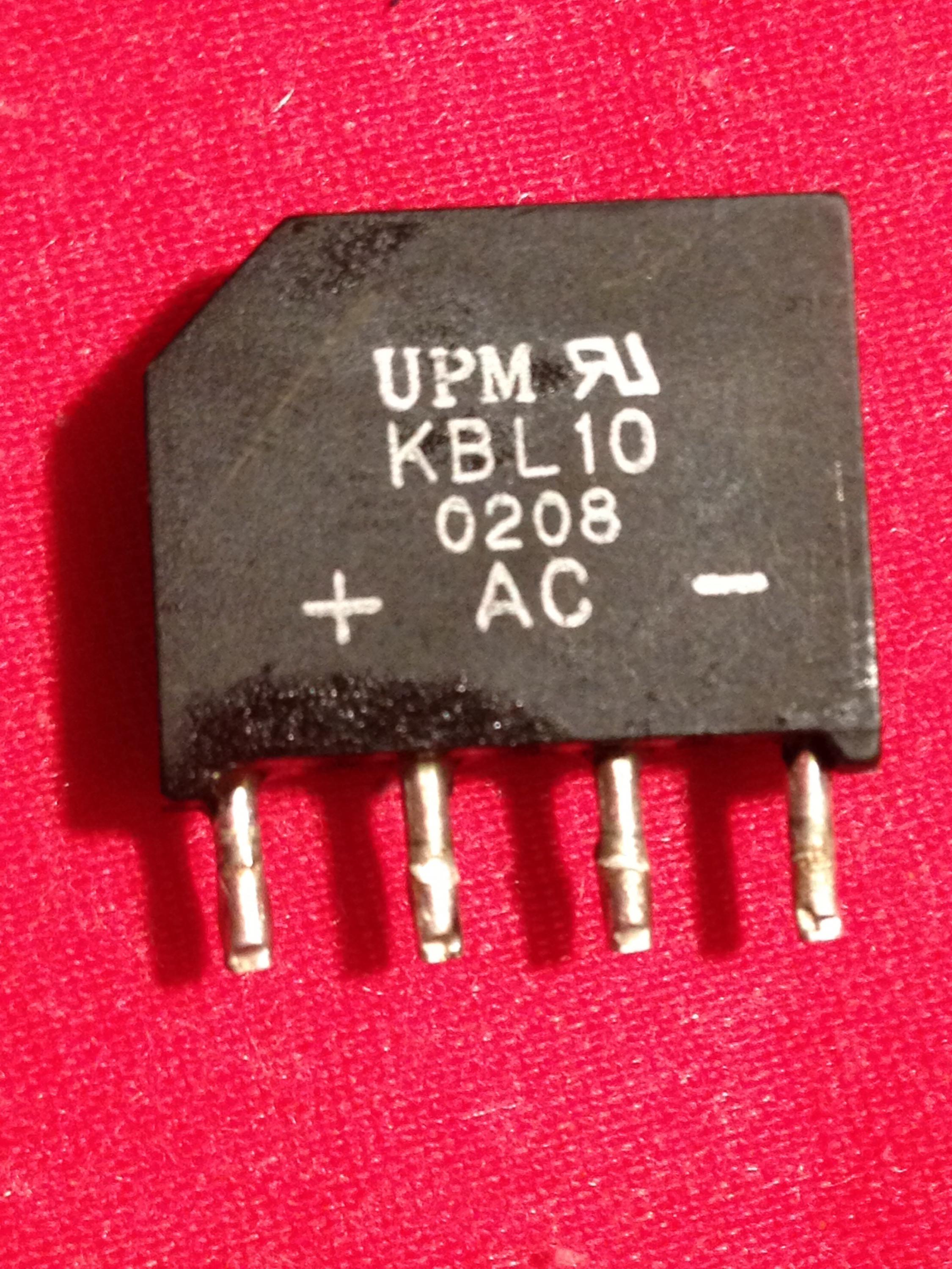

                Re: Vestel 17PW16-2 Fault Dead
                Hello,I have the same power supply 17pw16-2 and I had main fuse blown ,after replacing many components I finally found the fault ,it was the bridge rectifier KBL10.
                Could anybody help found a replacement please for KBL10.
                Could I use Gbu4m 4A 1000V ?
                Thank you.
                  KBL10 is 4A 1000V rating so what ever you use it should match the spec and lead spacing so it will fit into the board.
                    Thank you for the reply Budm ,I replaced with Gbu4m 4A 1000V and power board working great.
