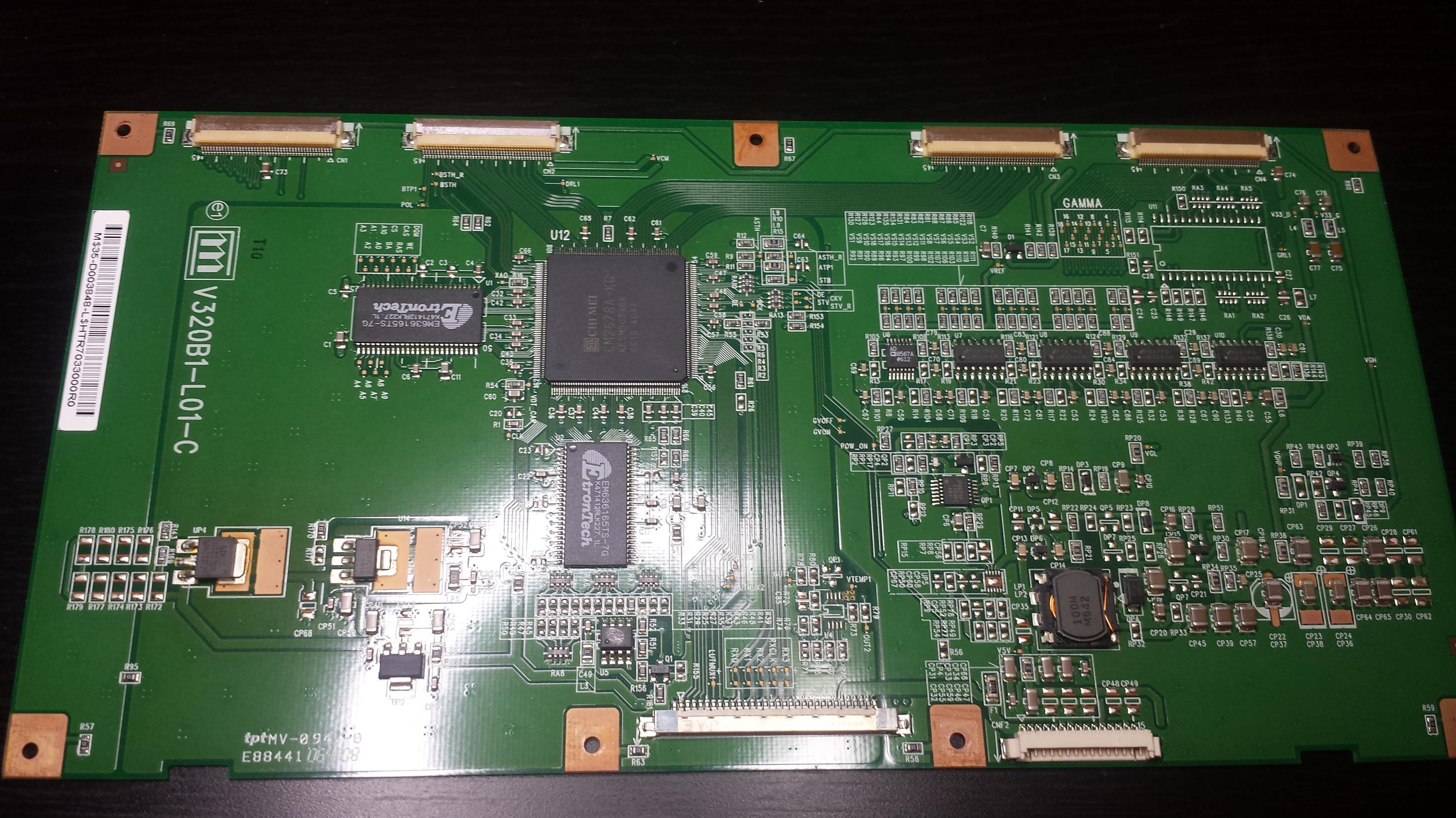

    hi guys got a samsung 32" tv which has funny colours blended in with the picture / mostly on whites. anyone know what could be the issue, im guessing T-Con but unsure.. have attached a short video to let you see what im on about.

    Pictures of the T-CON board? Model number of the TV?
    Looks like the GAMMA Voltages are off a little.
    Try re-seating the cables first. tightened all the board mounting screws, etc.

      look if your tcon has a AS15 chip on there. Maybe make a nice pic of your tcon board and post it.

          99.9% certain the as15-F has failed.The RM5101 is a much more reliable replacement.
          For a quick test,leave the metal tin off,switch the set on and you will find the i.c is red hot if you put your finger on it.
          Replacement is easier than it looks,I use a Stanley blade,cut all the legs off in situ,then use some wick to remove the legs still on the board,then a fine iron to fit the new one.

            Hi guys sorry for slow update, this is the T-Con from the tv and cant see the AS15 chip on there, anyone else have any other suggestions, tried reseating ribbons and problem continues

              i cant see it either maybe reconnect the t con on the top right of the board theres some gamma test points 18 i think maybe test each point and post voltages.

                Ribbons on the panel, take the panel apart and apply pressure to the ribbons see if it changes. Report back mikey!

                  ok so put tv back together to test voltages and the tv switched on by itself and hey presto it seems to be fine.... will it stay like that or is there a chance it will come back ?
                    Re: problem with 32" Samsung TV
                    A problem that goes away on its own will come back on its own... at the worst possible time... and in the worst possible place
