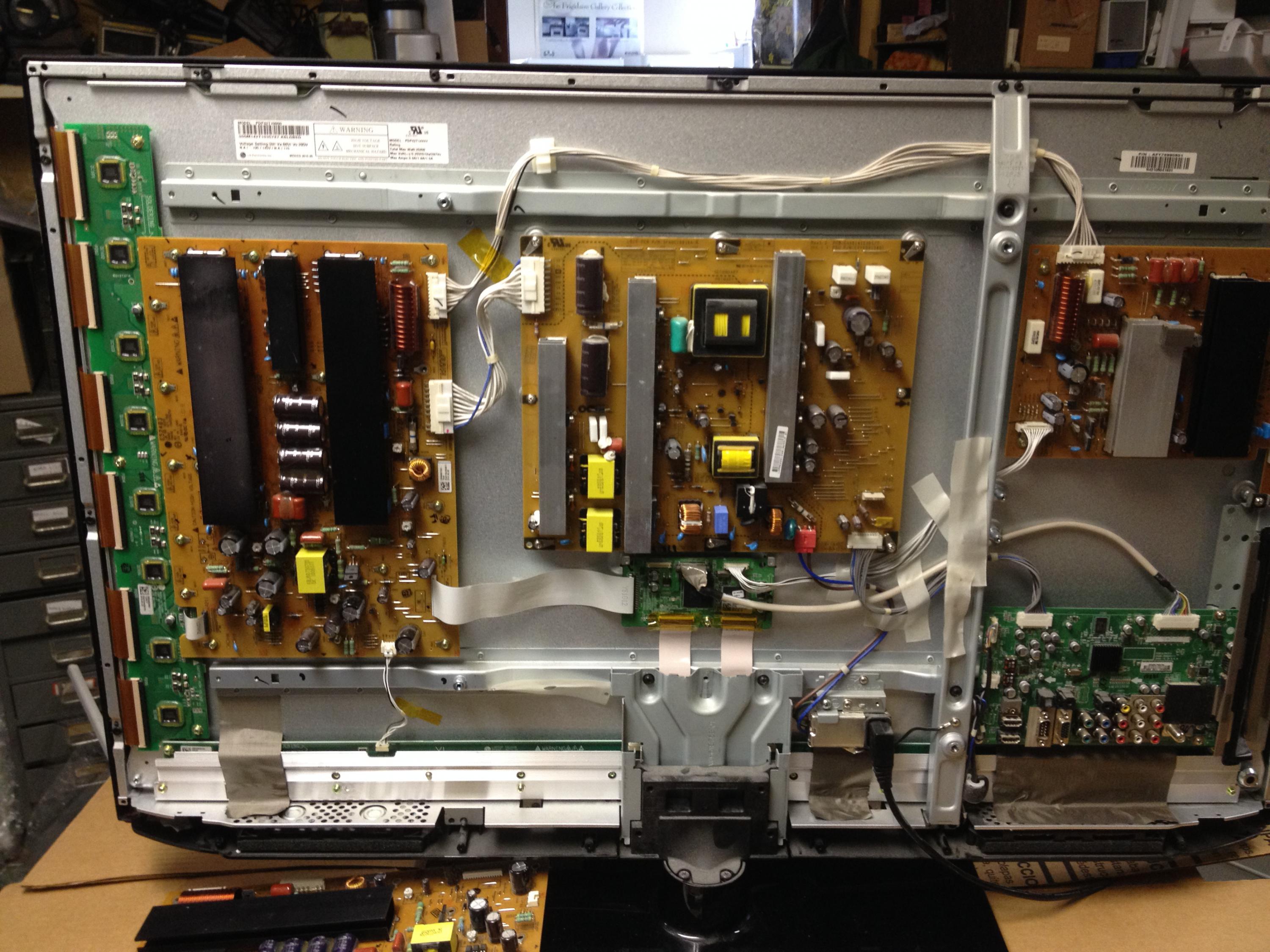

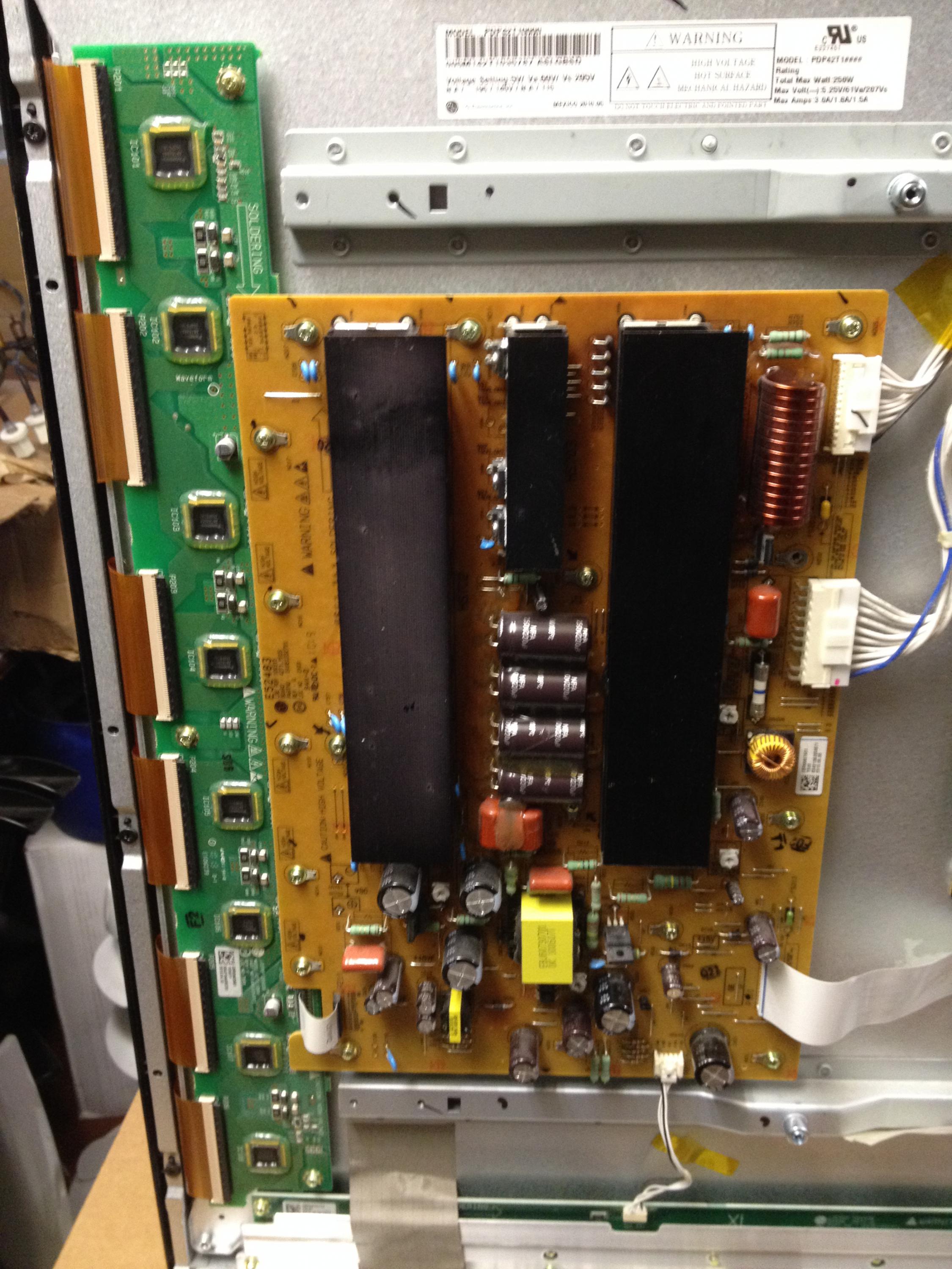

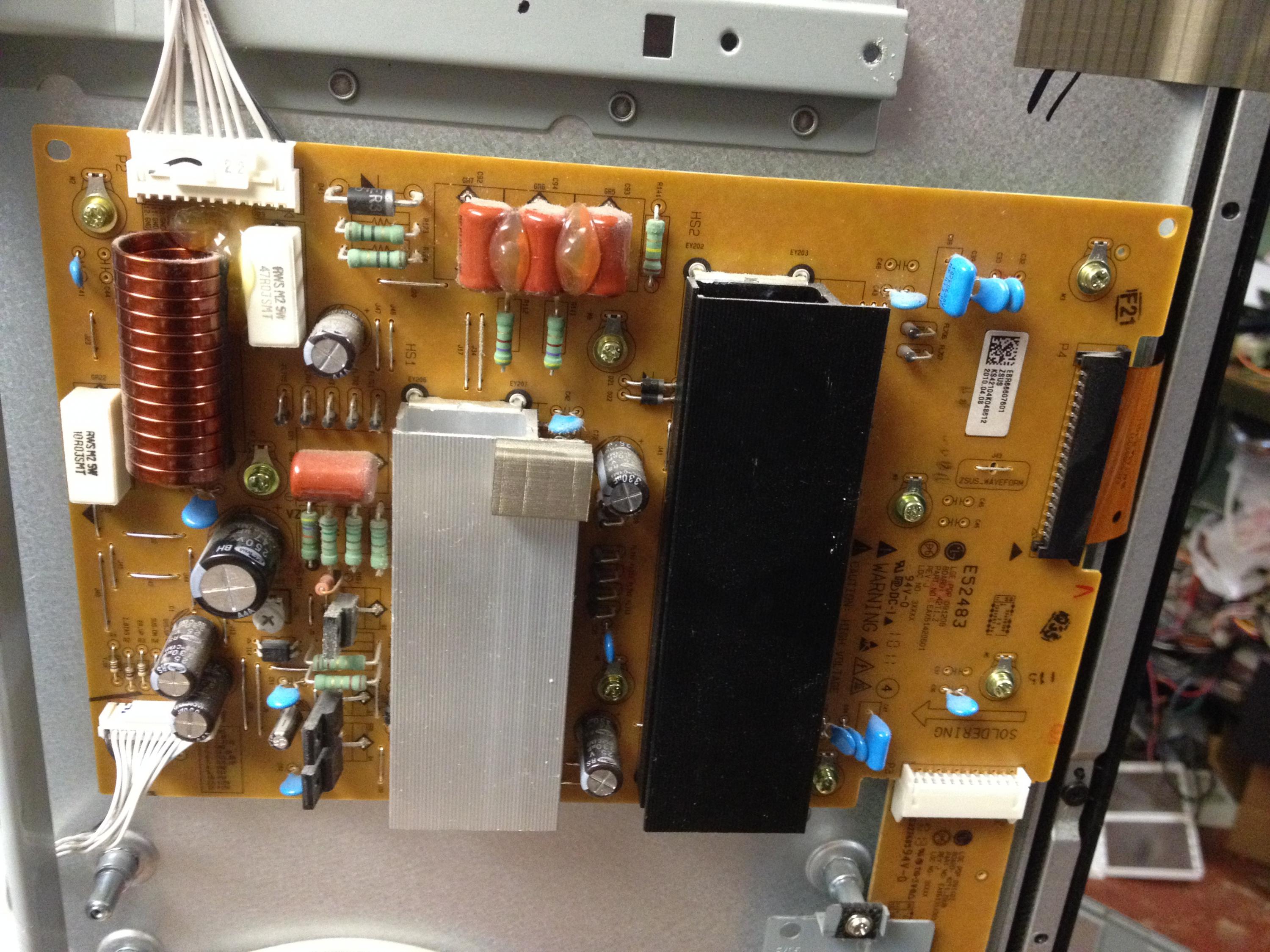

    I have a Zenith Plasma M# Z42PJ240 that has sound, but no picture. I replaced the Y SUS board and still has the same problem.

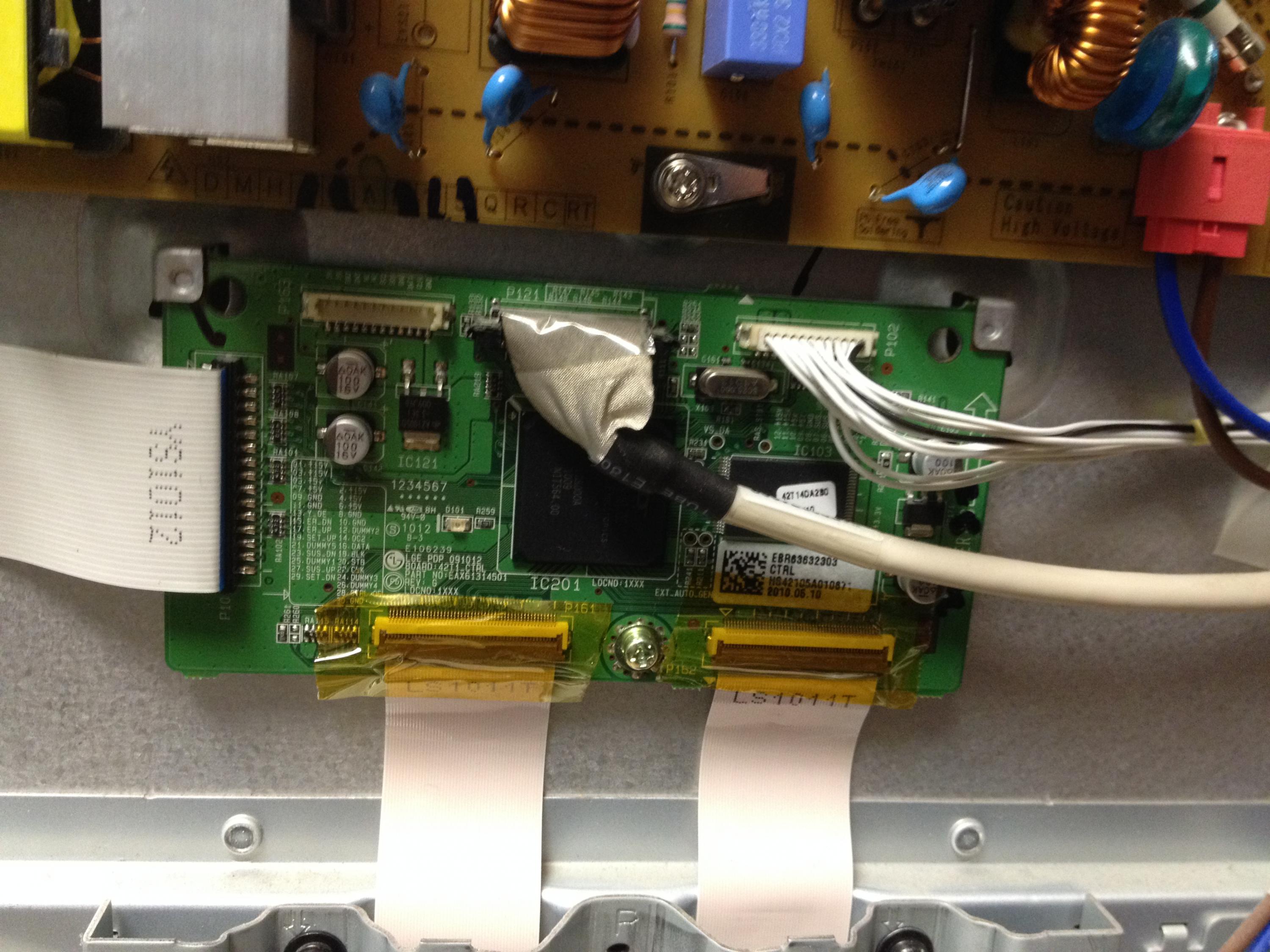

    On the logic board, the D101 is not lit up at all.
    I did the test on the logic board that involves putting a resistor on the EX AUTO GEN and it did not change anything.
    Does anyone know if not having a blinking D101 is evidence that the logic board is not working?
    Thanks for any help. I will get some pics uploaded.

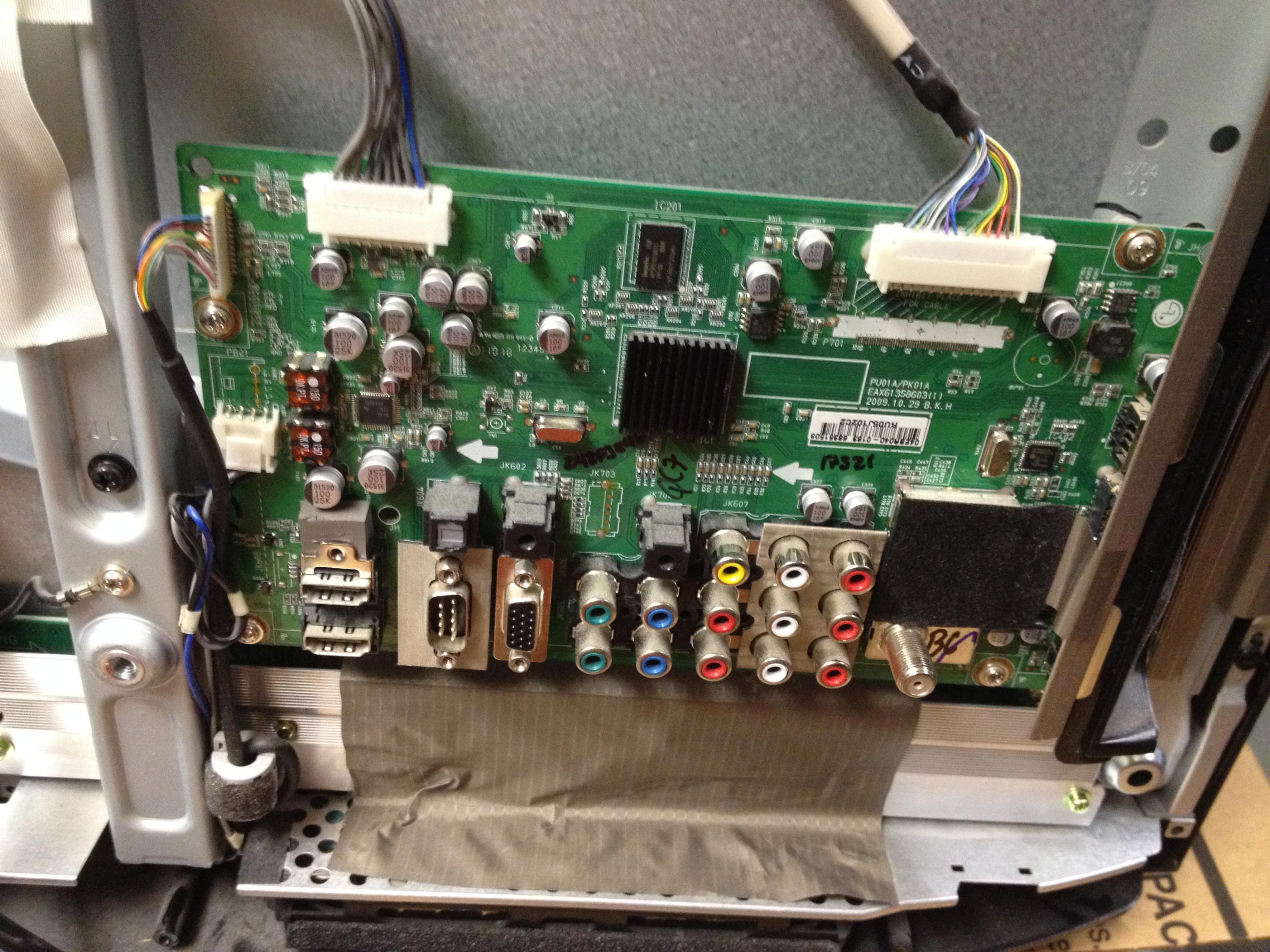

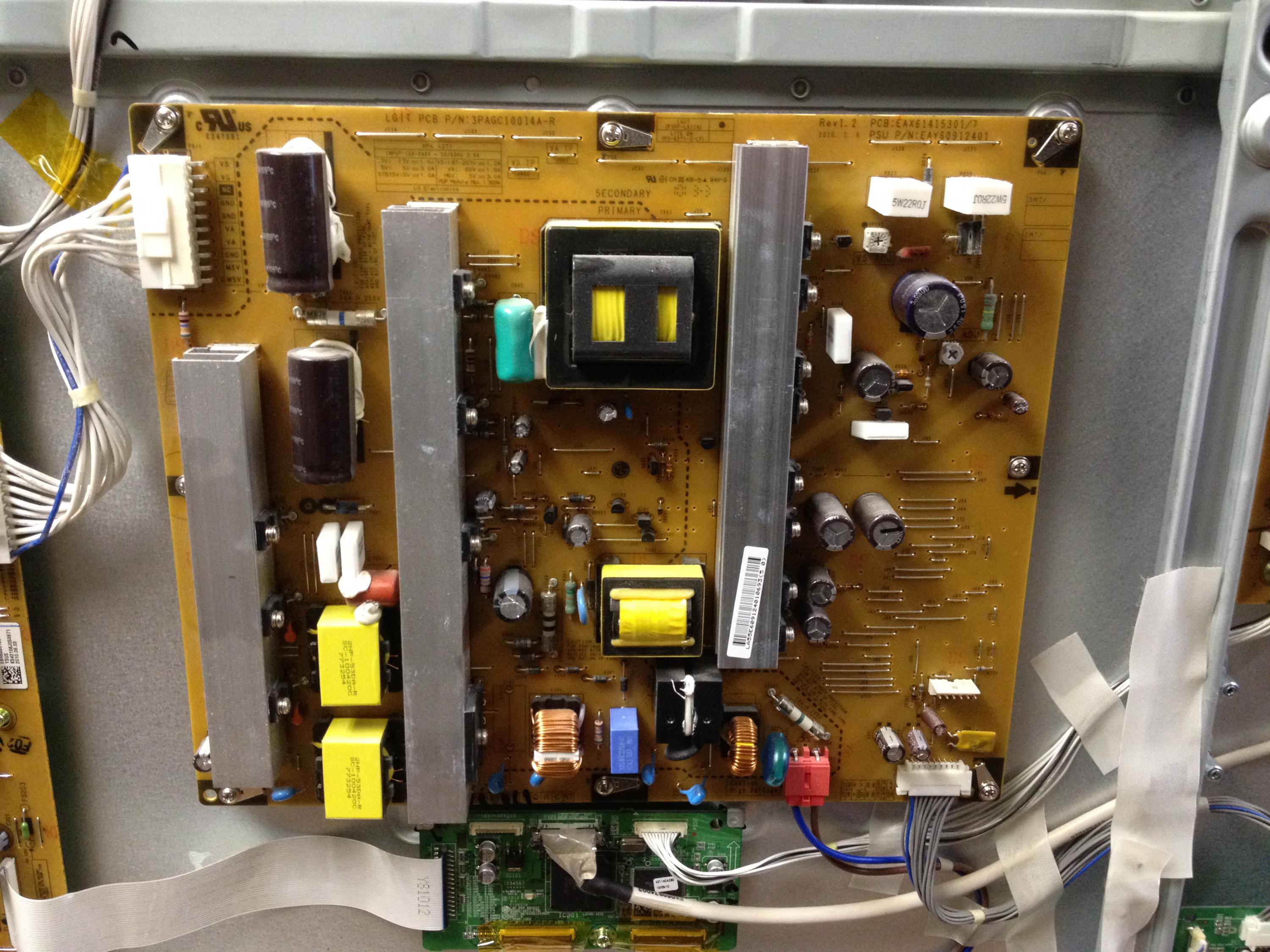

    Re: Zenith Plasma Z42PJ240 has sound but No picture
    Here are the pics of the boards.
      would appear it needs to be blinking. My understanding is auto-gen is shorted not a resistor for the test patterns?
          TW is right, I resistor will not allow the test patterns to show.. Simply a wire or similar is needed
            Thanks for the response. I did a wire first, then read in another thread that it needed a resistor. The wire and resistor had the same result: no test pattern.
            Does anyone think that it may be the logic board?
              VERY common fault with this LG based chassis is No Vs caused by the SUS_Up and SUS_Dn IGBT's on the Y-SUS board gone short. Quick check with DVM will tell you
              You probably got a dead YSUS from whoever you got it from....
                I have voltage coming from VS on YSUS. It is about 175 VDC that cycles down to 0 and then back to 175 and keeps cycling. I hope that makes sense. That is on the new board.
                  Well after putting a YSUS and a ZSUS in, and having no difference, I put the logic board in. That was the fix. $29.99 on ebay. I should have stuck with my first instincts. Thanks for the help. TW2005
