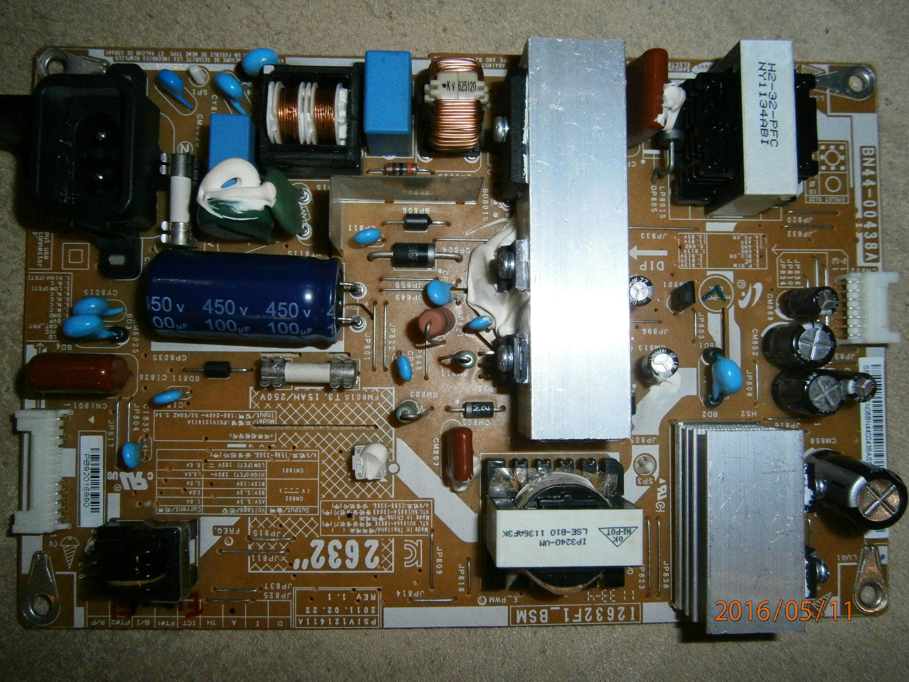

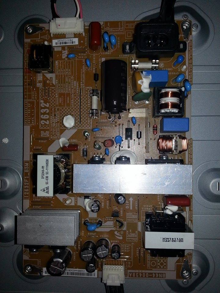

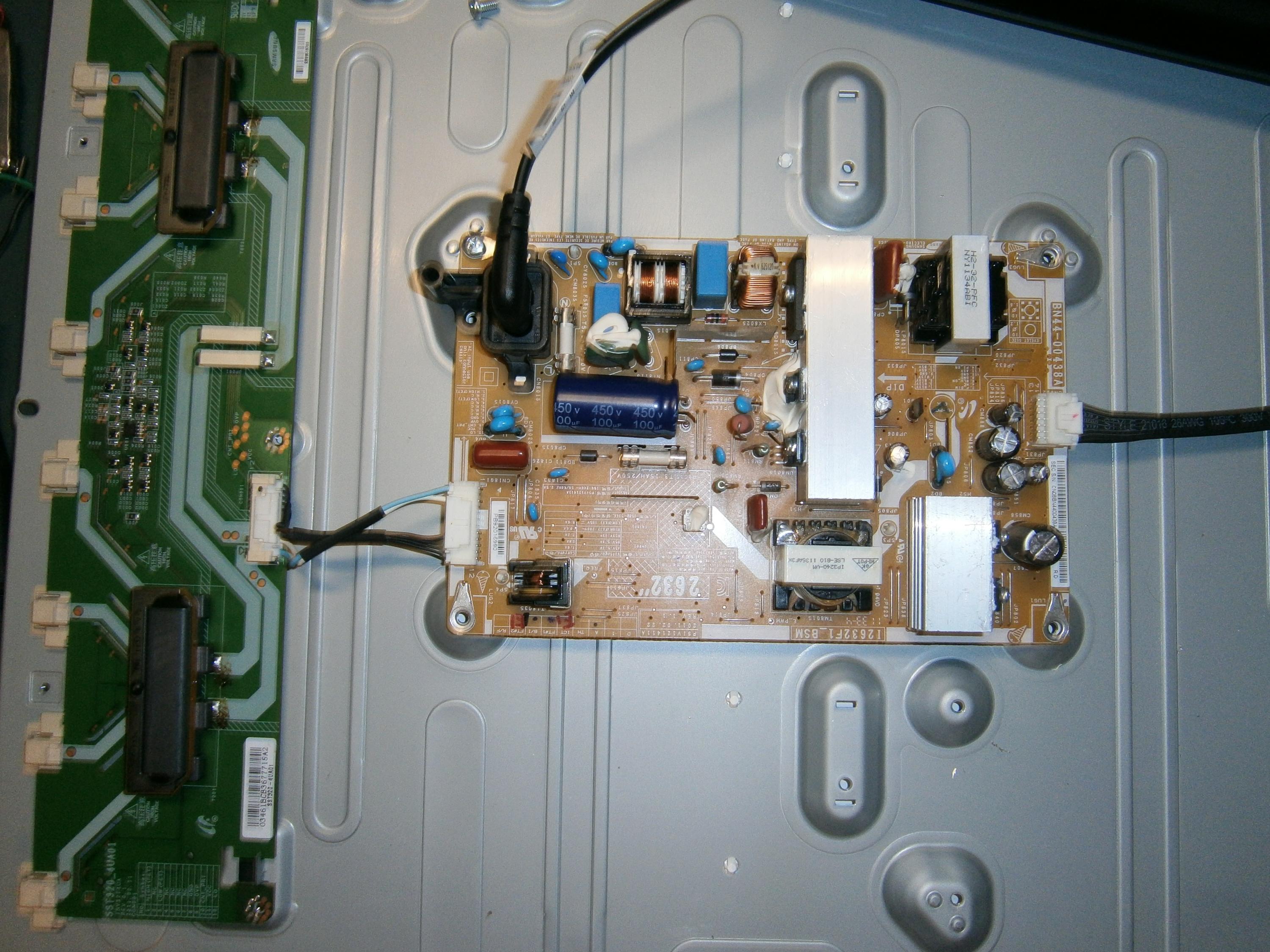

    Hi Folks
    A new one for you all
    I have a SAMSUNG LE32D400E1W here with a fault on the PSU - I am not getting no power to the Backlight circuit from the PSU board (checked voltages and showing as nothing/fuses are ok
    With the TV on and a torch the TV boots and shows the image with no back light
    Board is BN44-00438A I2632F1_BSM
    Any pointers please.

    Re: SAMSUNG LE32D400E1W - No Power to Backlight
    Ohms... Black to screw and red to each fuse... Results?
      F1 110V (should be 240v?) - no reading
      F2 5.9v -224k
        OK, those two fuses are in the PRIMARY HOT DEADLY SIDE of the circuit, you will not use the screw or the chassis as the ref point for testing the Voltages.
        Also DO NOT test the resistance if the TV has power.
        Check the resistance between he two ends of the fuse, it should be <1 Ohm.
        The main fuse is OK other wise you will not have the power supply working to produce pictures on the screen, you do not have backlights so you need to find out if the inverter circuit is getting b+ and correct B+ to run, if it is getting BL-ON to turn on the backlights.
        Check the DCV between the two legs of the main filter cap when the TV is turned off and when the TV is turned on also.
                I have the same issue with this model.
                I have check the fuse it's ok and i have the 12volts in the inverter pin 11
                SMPS board : BN44-00438A
                Inverter : sst320-4ua01

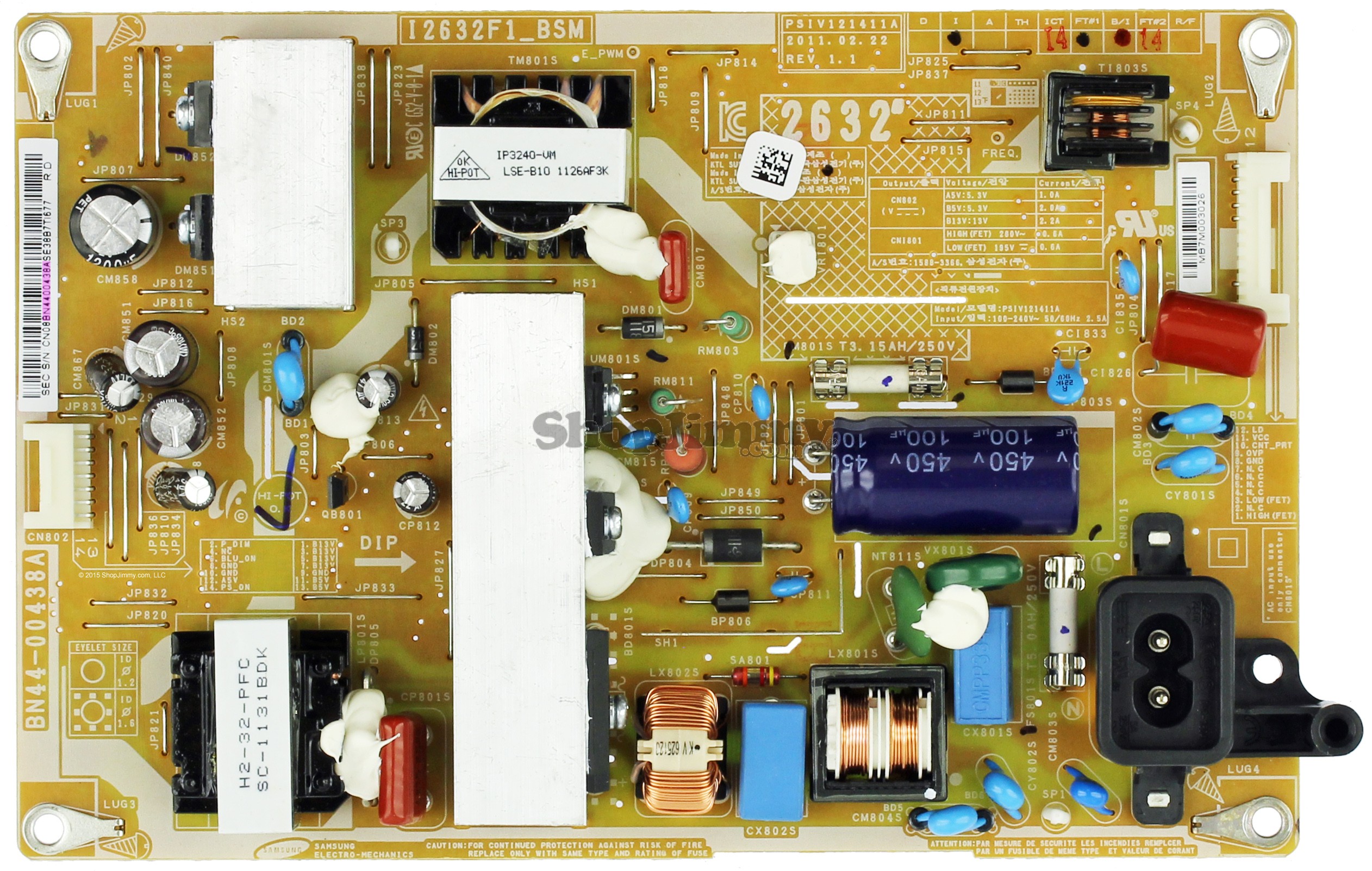

                    another manual for BN44-00438A

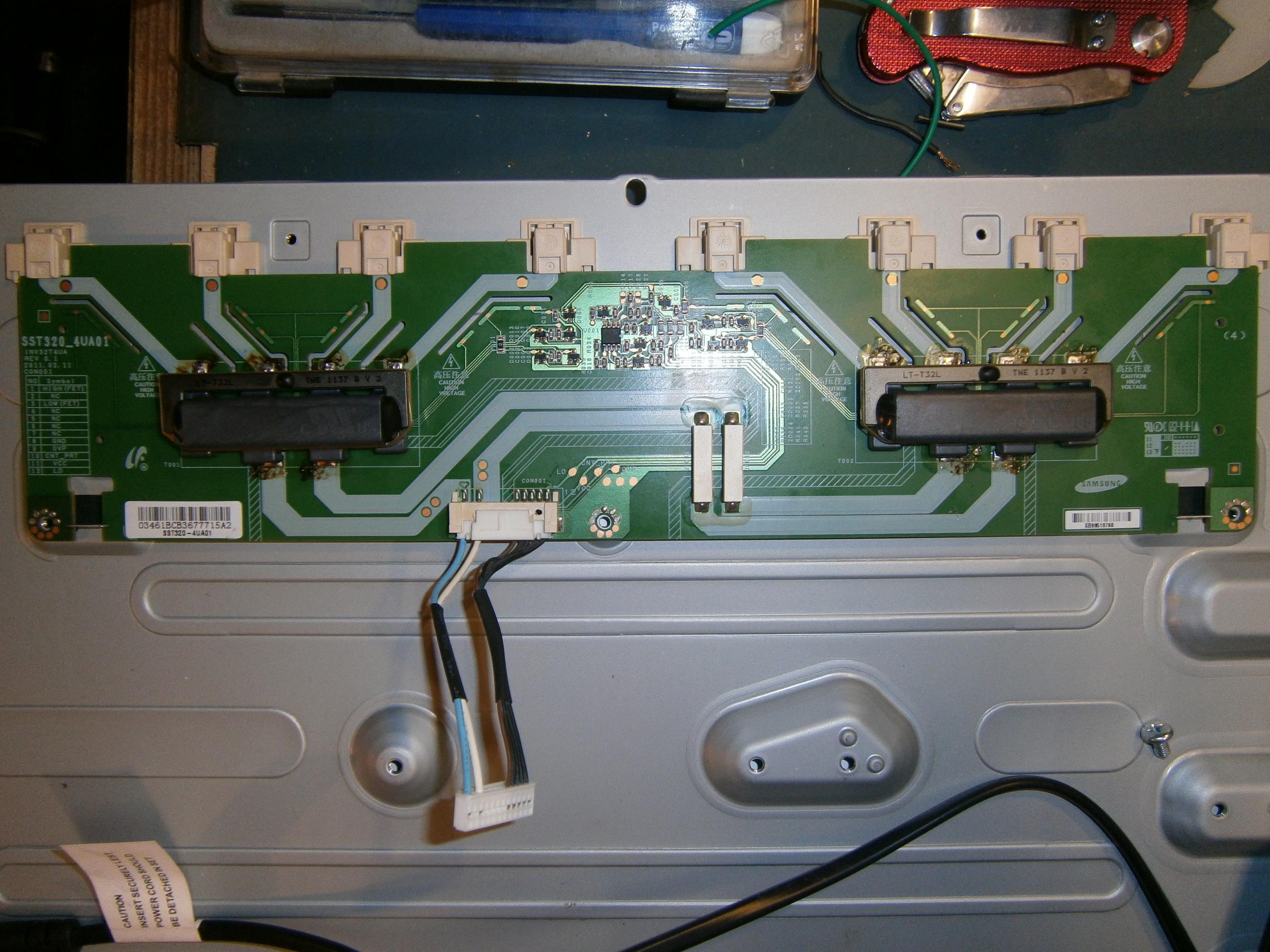

                      Are you getting about 400vdc between the two legs of the main 450vdc FILTER CAP?

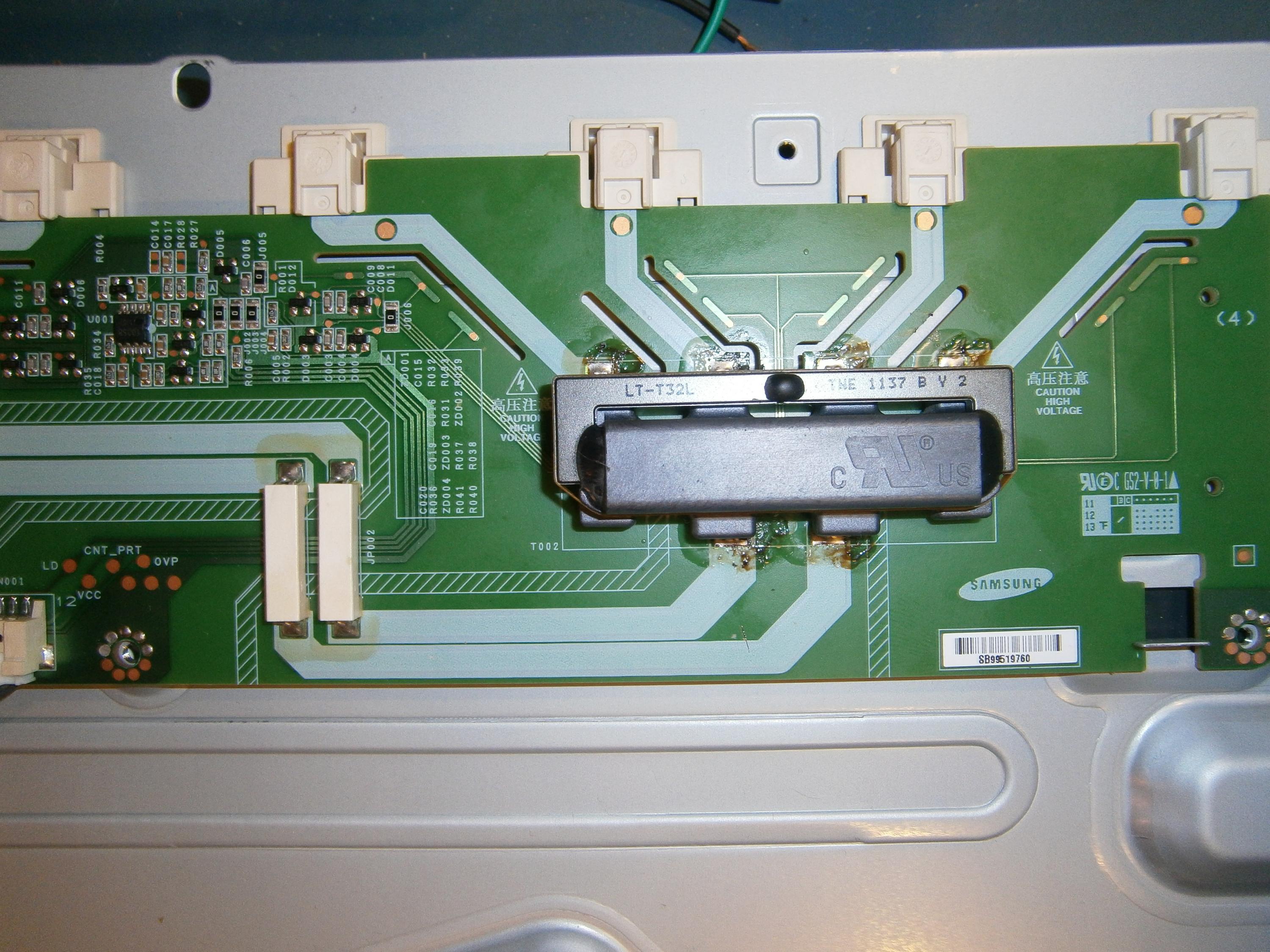

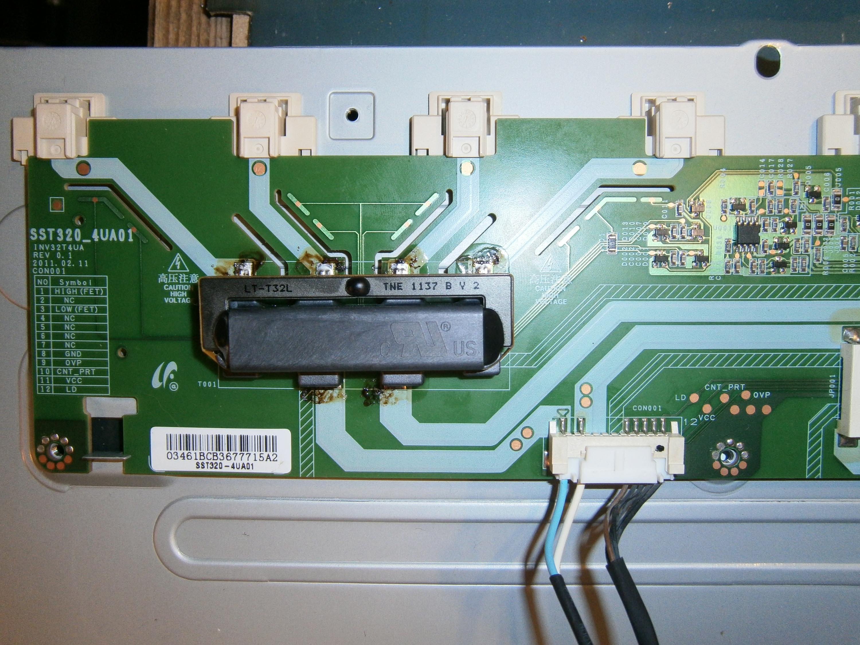

                        Also need good clear pictures of the inverter transformer board, SHOPJIIMY does not have any info on this SAMSUNG LE32D400E1W.
                          between the two legs of the main 450vdc filter cap i measure 390Volt DC
                            Good to the PFC Voltage booster is working.

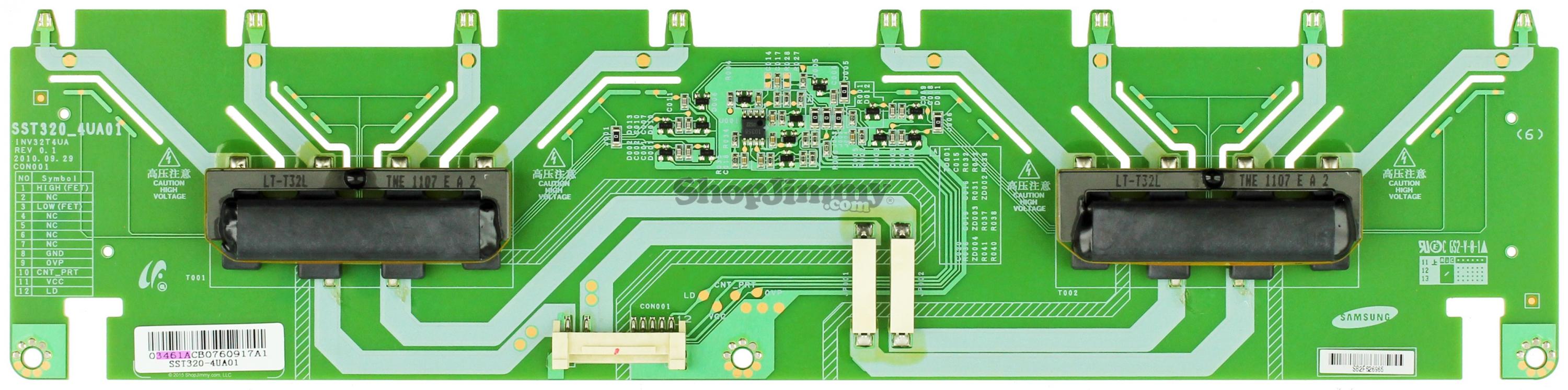

                            Just to be sure, if you look at the front or at the back of the TV in the dark room, do you see the backlights even flash on for seconds?

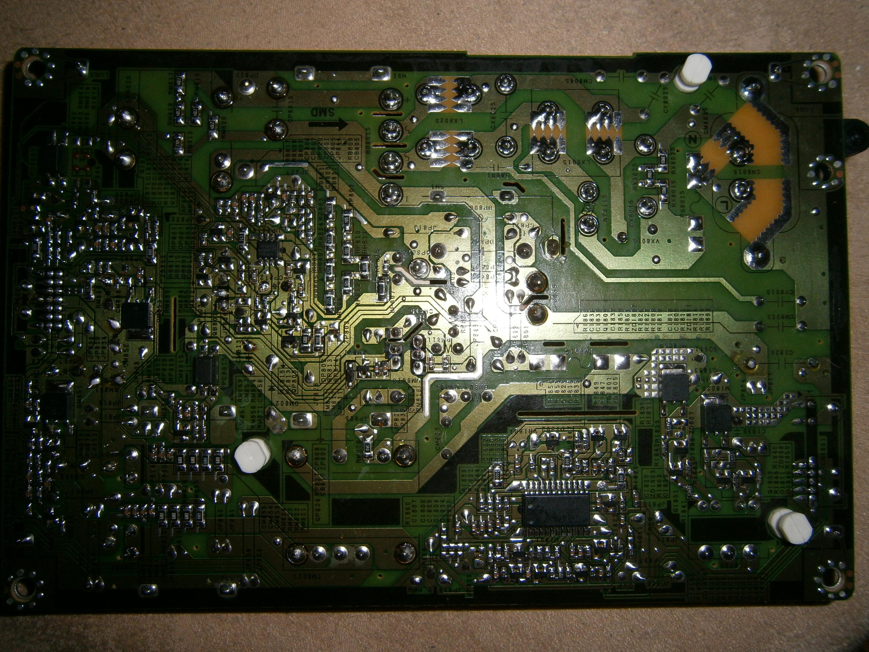

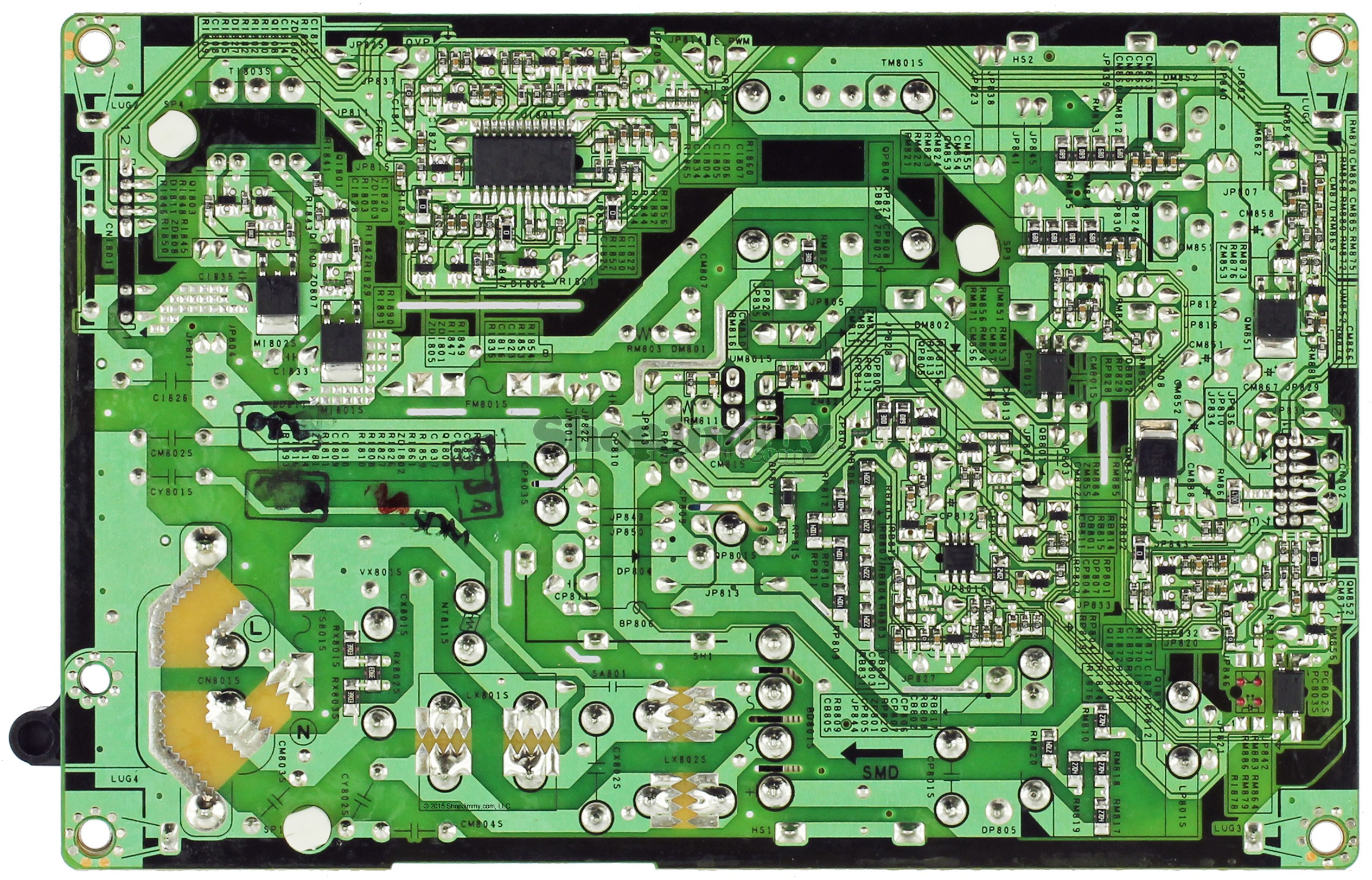

                            I am able to find good pictures at shopjimmy.
                            Samsung LJ97-03461A (SST320_4UA01) Backlight Inverter.
                            Pictures provided by shopjimmy.
                                Originally posted by YiannisQ
                                some more measurements that i take
                                first the name of pin then the voltage in standby and on power
                                B13V---> 0.0V------- 12.86
                                B5V----> 0.0 ---------5.27
                                P_DIM--->0.0 ----------0.8--------------CN802
                                BLU------>0.0----------5.14
                                A5V----->5.26 ----------5.26
                                PS_ON-->0.0 -----------3.53
                                LD---->0.0----------11.50
                                VCC-->0.0-----------12.80--------------CNI801
                                CNT_PRT-->0.0--------12.2
                                OVP--->0.0-----------0.0
                                What dcv do you have on PIN 3 (LOW FET) and PIN 1 (HIGH FET)?
