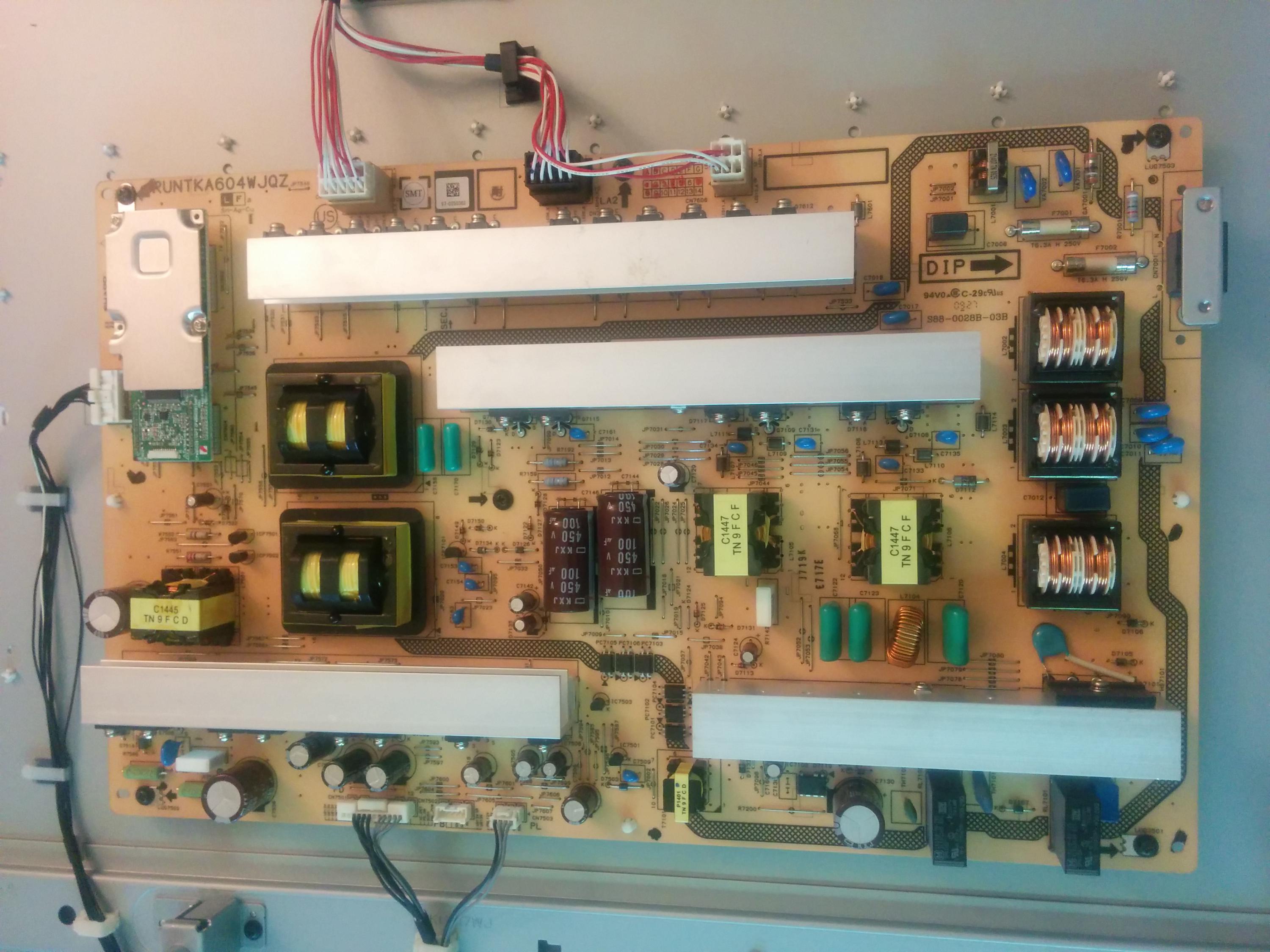

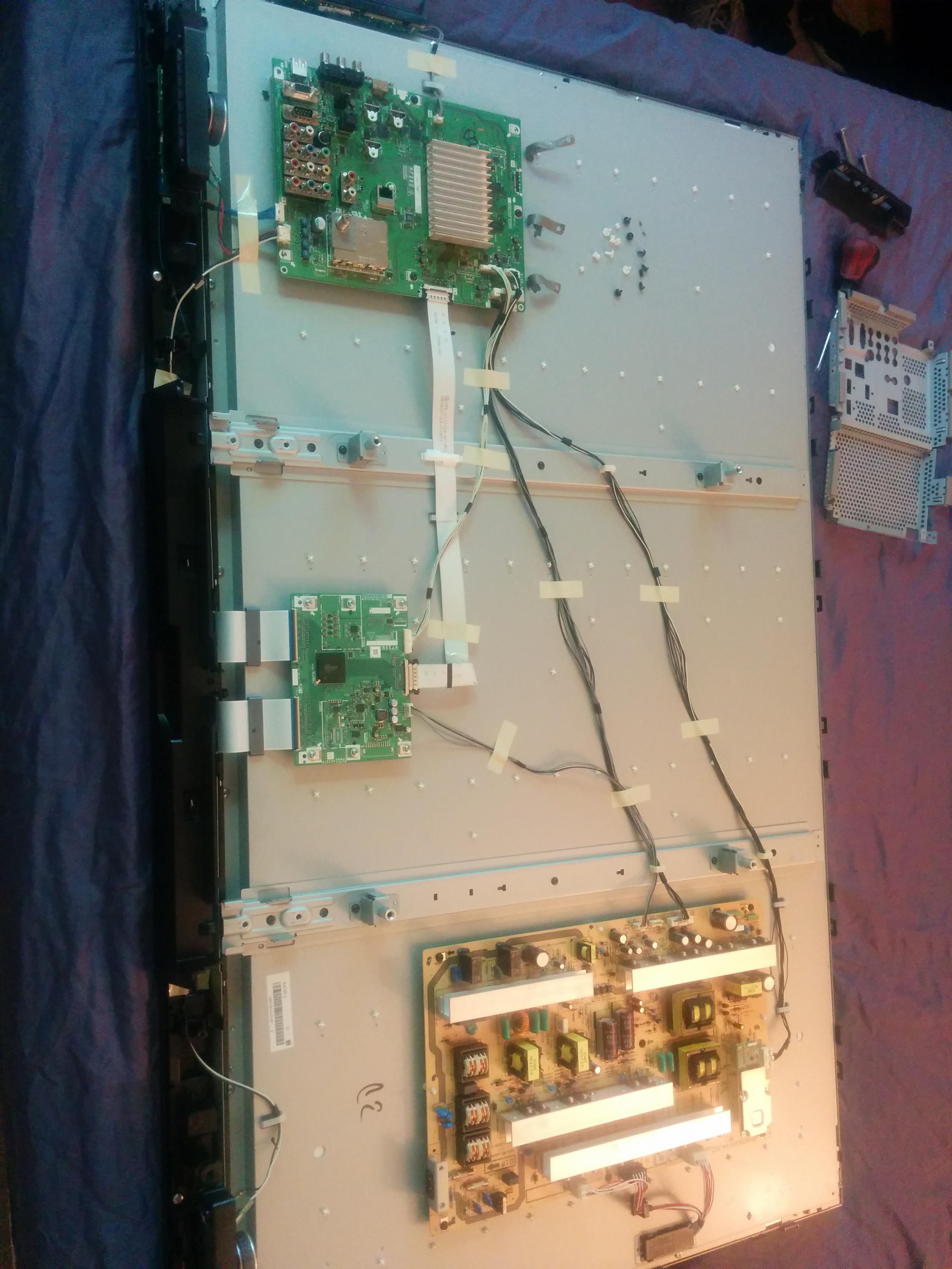

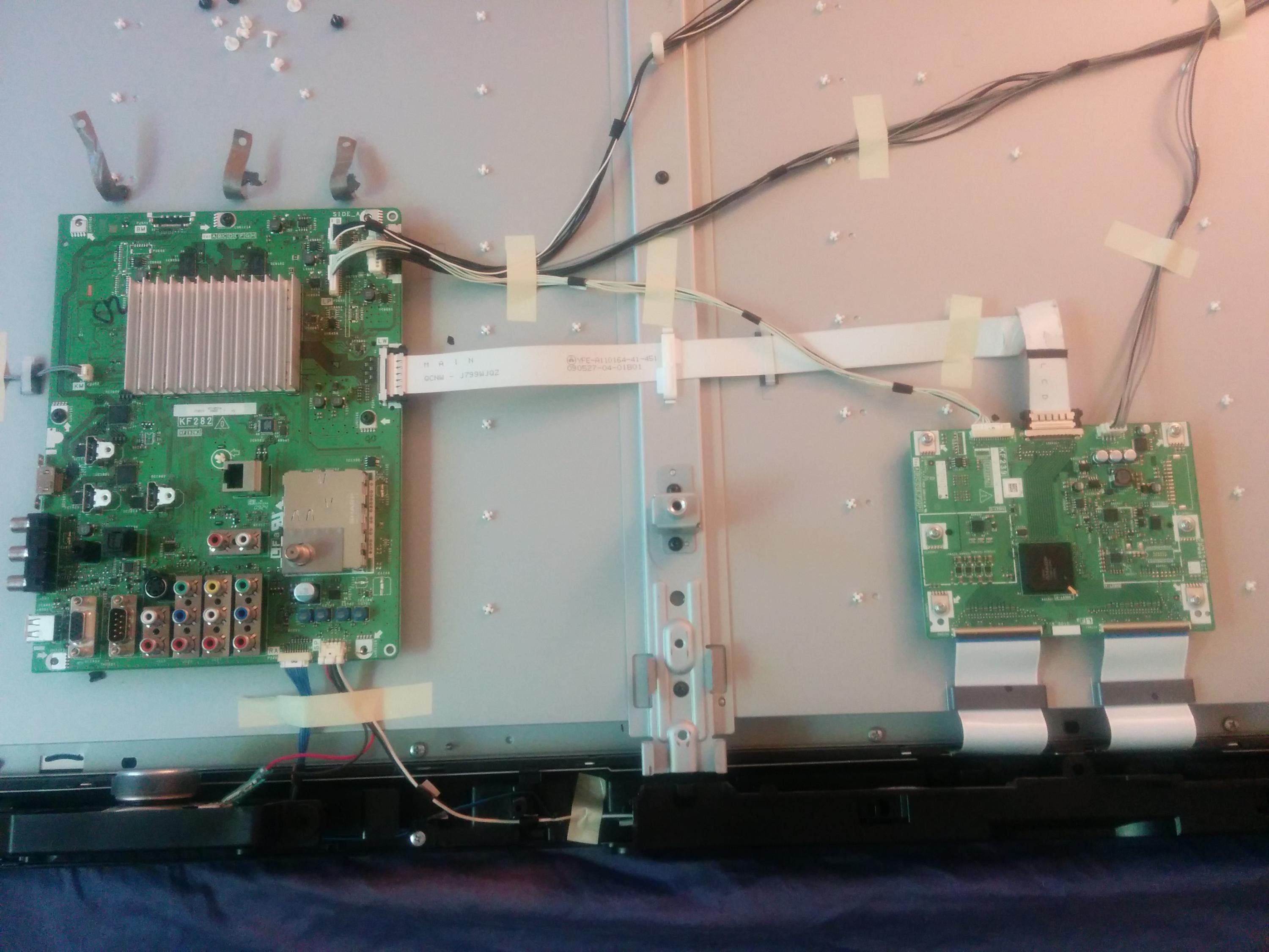

Sharp LC-52LE700UN was working with an occasional white screen issue, stopped
  • pk7tanner
    • Apr 2013
    • 98
    I had made a previous post about this set https://www.badcaps.net/forum/showthread.php?t=43199
    Well, the problem was getting worse, so I tried entering into the factory reset mode while it was happening. When I couldn't get it to fix the problem, I just turned the set off. Now it won't even power on. When I try to reenter reset mode, it turns on for 2 seconds, then shuts off.

              Re: Sharp LC-52LE700UN was working with an occasional white screen issue, stopped
              Connector from PSU to Main. Check pins at PSU side with DMM set to DCV. If there are voltages written by the connector write the results out like this for EG:
              12v - 0v
              PS_ON - 3v
              STBY - 5v
              etc
              etc
              You labels may vary

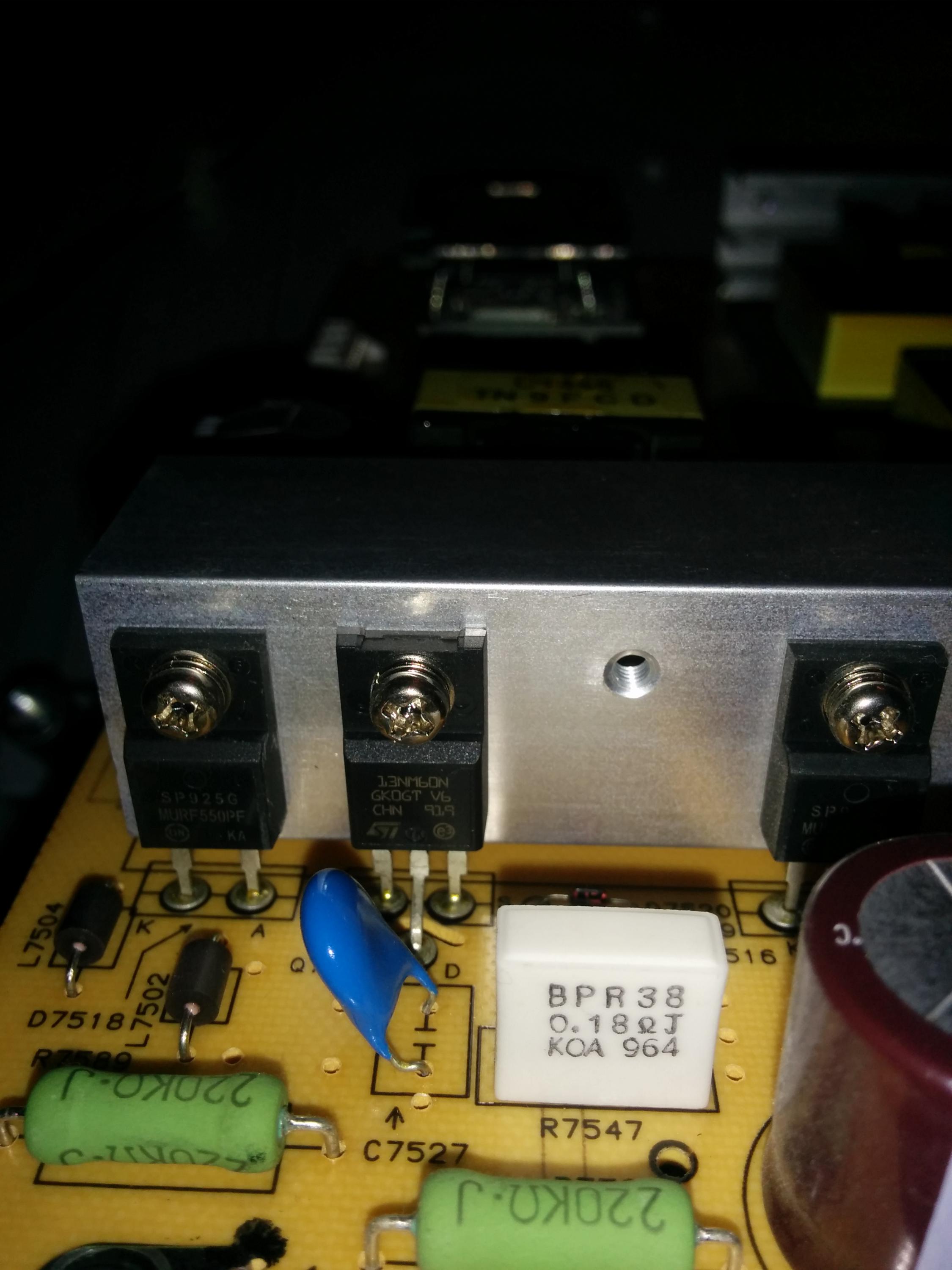

                Sorry for taking so long. The only one with voltage is the BU5V which has 5v.
                I have another question. I was checking the MOSFETs on the power board. Since I'm a novice and can't decipher data sheets, I check them against their matching counterpart. One of the st 13nm60n gives a reading of .955, while the others read OL. I'll attach a photo of the suspect fet.
                  Here's the data sheet. http://www.st.com/web/en/resource/te...CD00261517.pdf
                  If someone can give me the v readings I should get, that would work as well.
                    Before we jump into MOSFET testing etc can you provide the voltage readings in the format of post #7 please. This way we can see what the pin labels are
