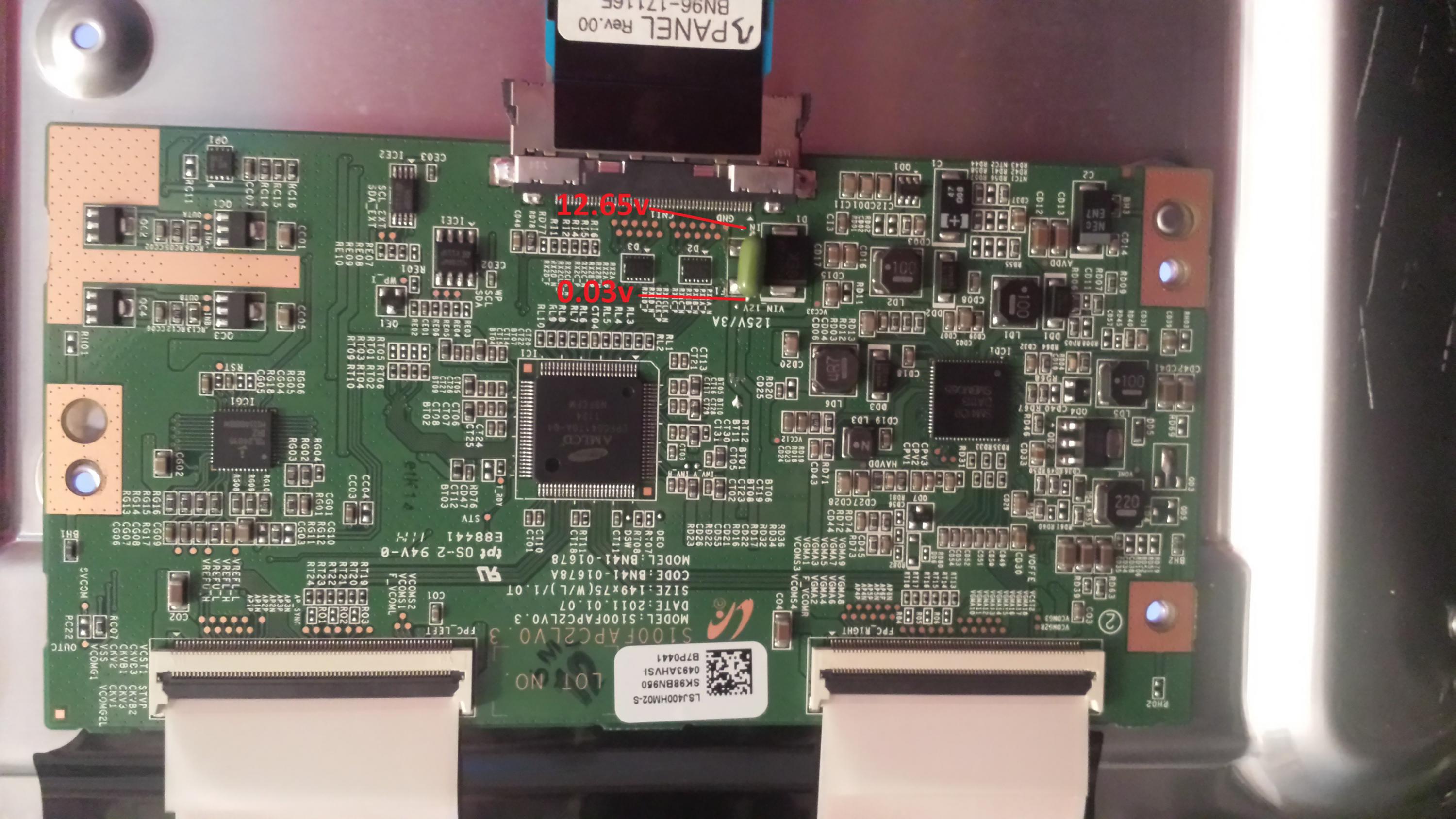

                    Tom, I tried disconnecting each ribbon and still the same no picture. do i test the voltages on the point i have circled in red ?? and also where is the fuse on this board ?

                      Green fuse with label 125V/ 3A printed on the board, someone may have replaced the SMD with PICO fuse.

                        Re: No Picture Samsung LED TV
                        do i just test it as if im testing a regular fuse ? should i test the voltage points next to the fuse also ?
                          Just check voltage at either side of the fuse
                            measured voltage on fuse and got 12.65v in and 0.03v out
                              Come on Mikey!
                              IF there's 12v one end of fuse and nothing the other--
                              WHAT Does THAT mean! You been doing these long enough now to Know the answer!!
                                yeah i know Alaistar E, what should i replace this with though ? i guess someones tried to repair beforehand and put in the wrong fuse ?
                                    Does it look as though its been out?
                                    The rating of it should be on the board. You can tack some wires to a conventional fuse of the right rating and tack that across the original as a test.....
                                        will try that, maybe a bit of speaker wire ?? board says 125v 3A which is why i was thinking this would be suitable ?
