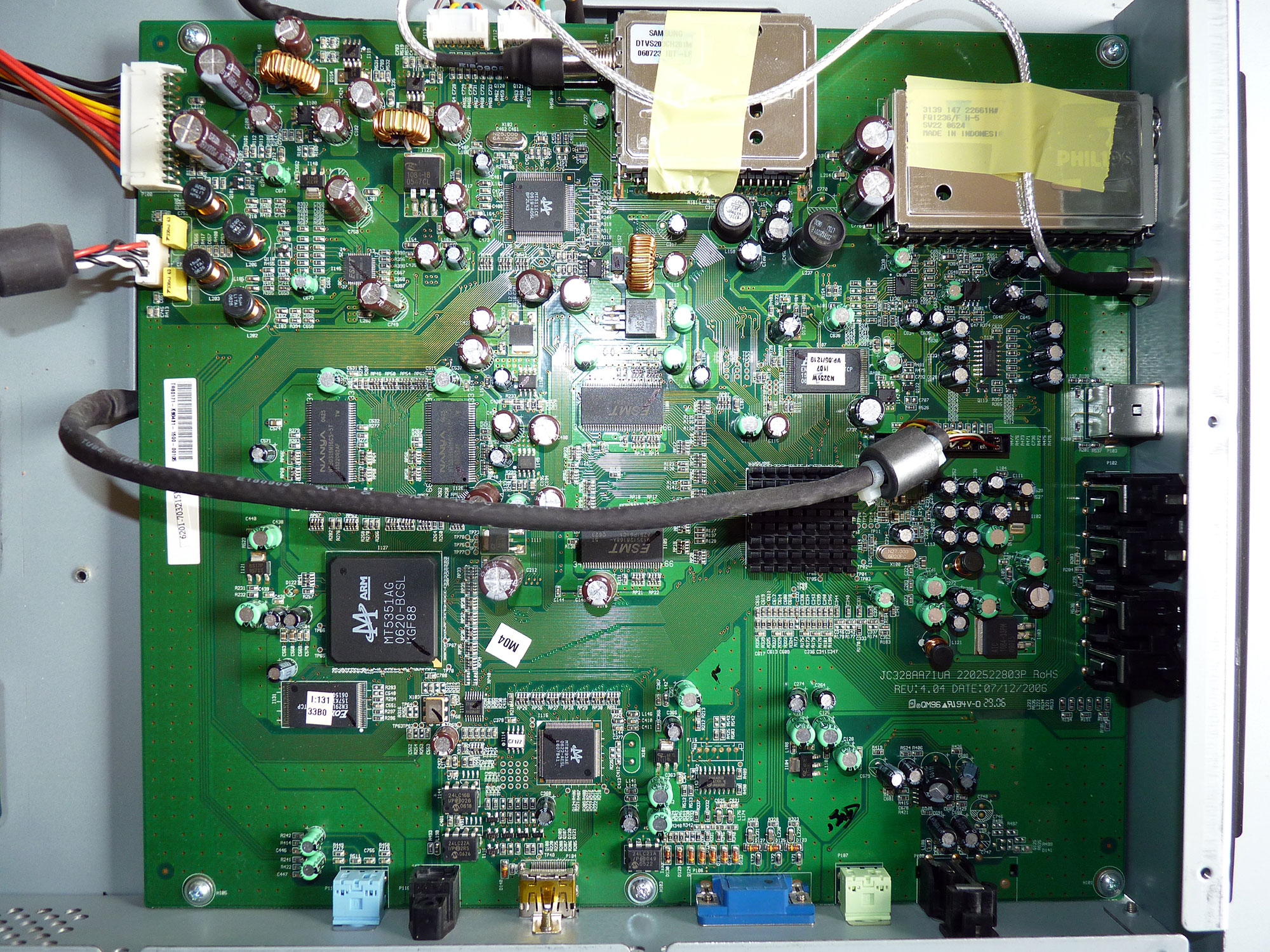

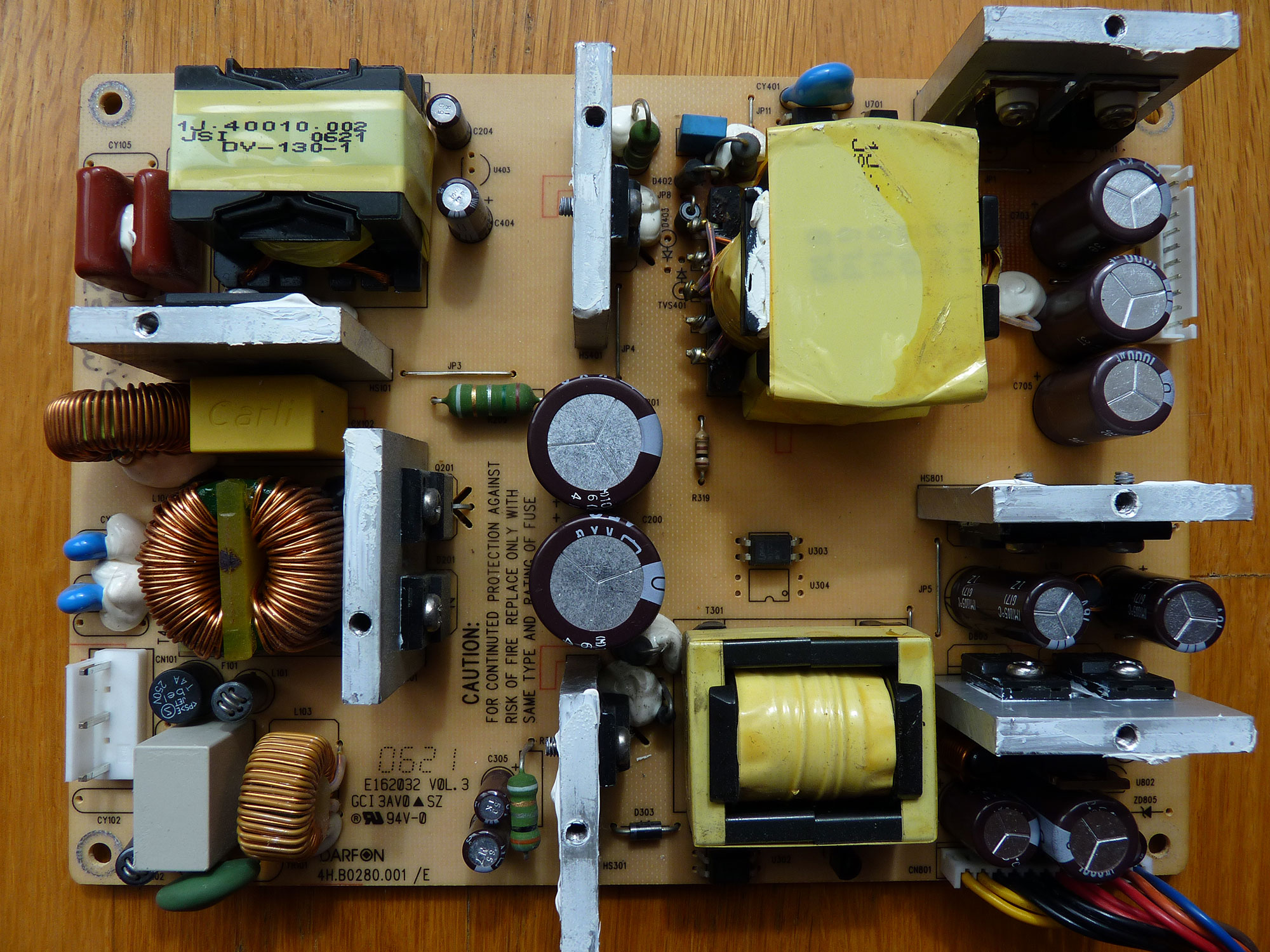

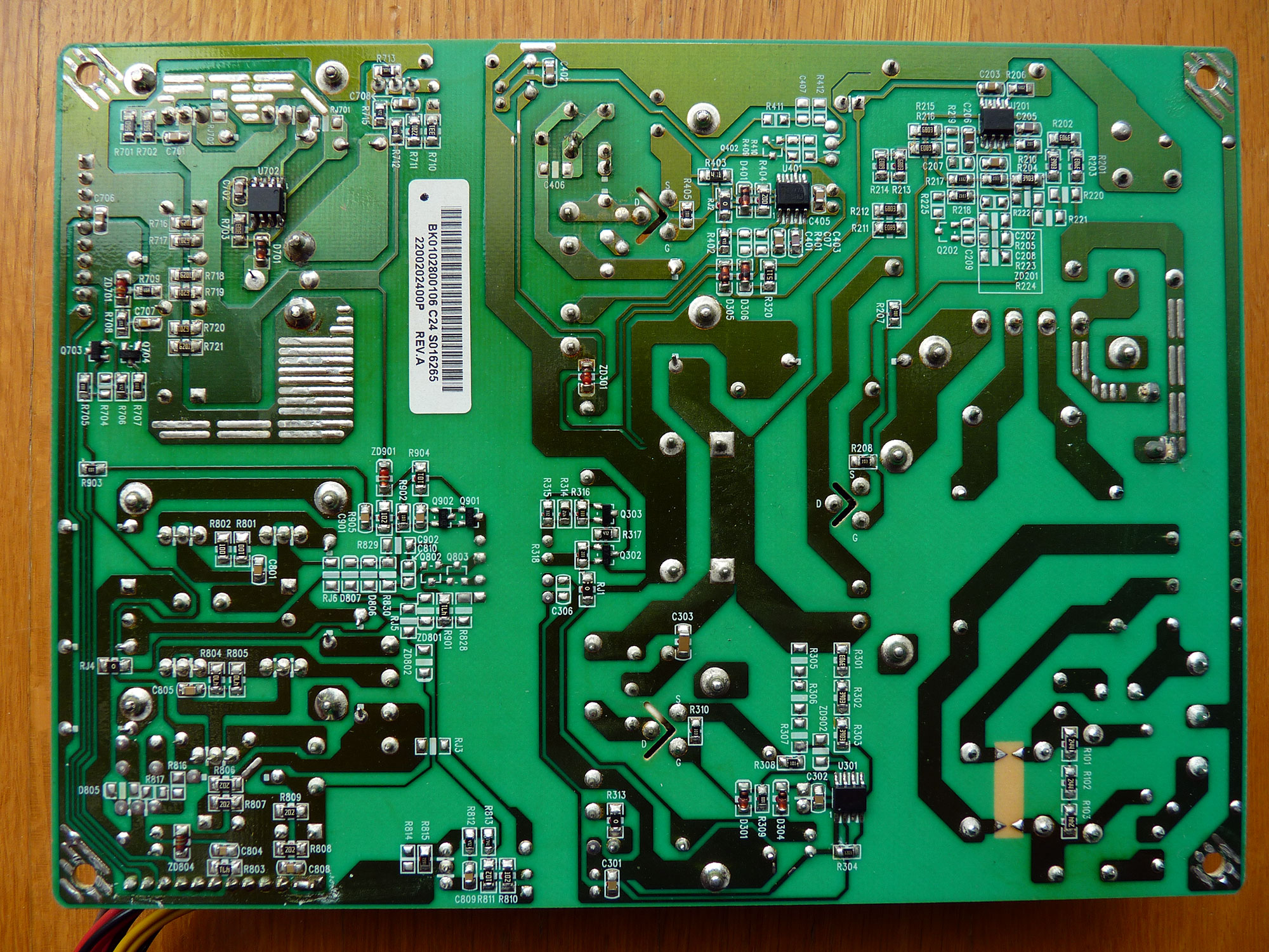

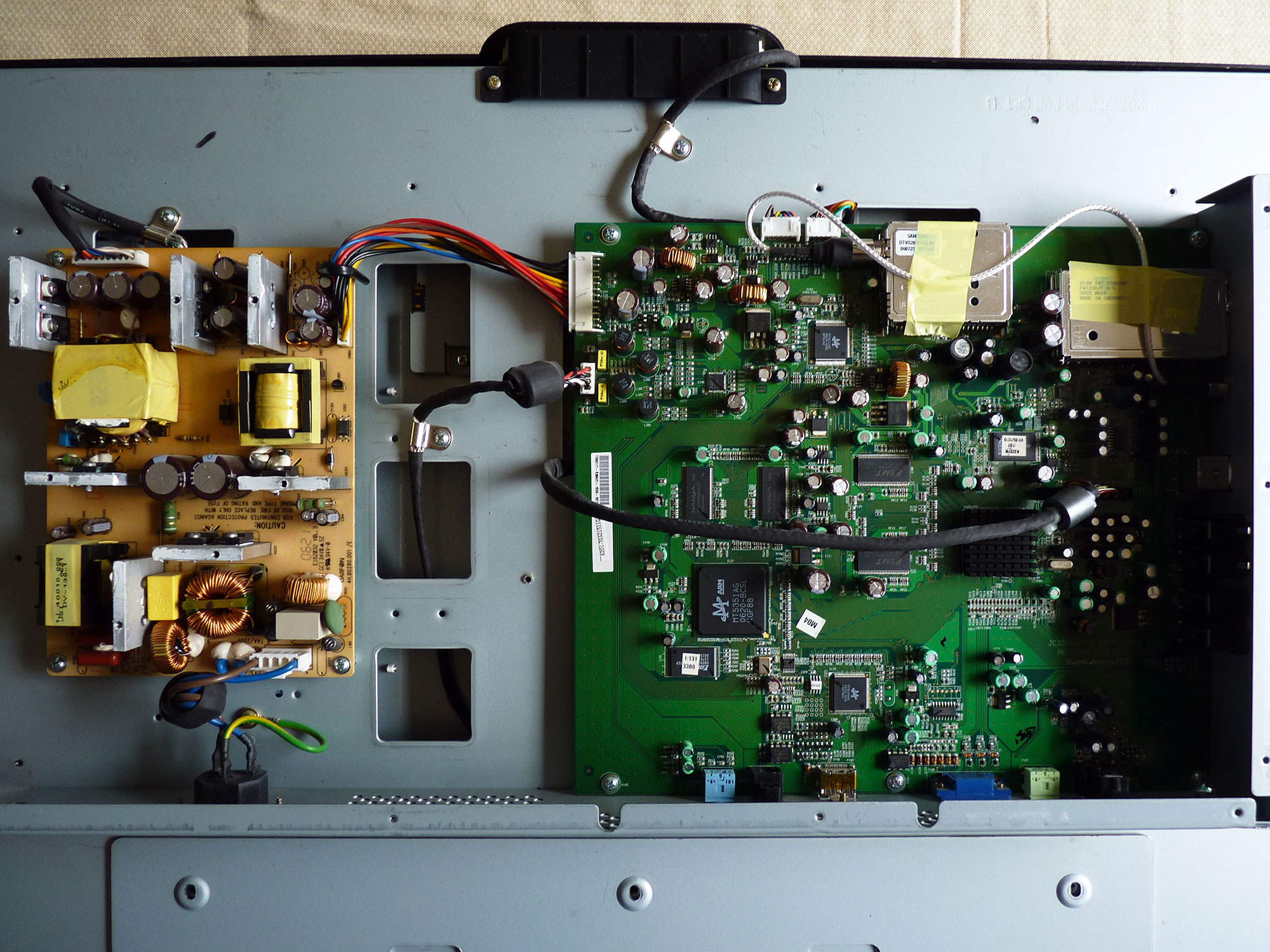

My Stepfather gave me his Viewsonic N3252W to (try) fix it. Suddenly, one day, the display went off. The power button stay green and the sound work but that's all. I already replaced a NKS N3856VG chip on the under side of the power board because the area around was brown (heat) and because i found some people talking about this possible faulty piece.
After that, i took pictures of the board and i made measurements. Here they are:

I hope that those numbers will help you to help me ;-)
Thanks.
