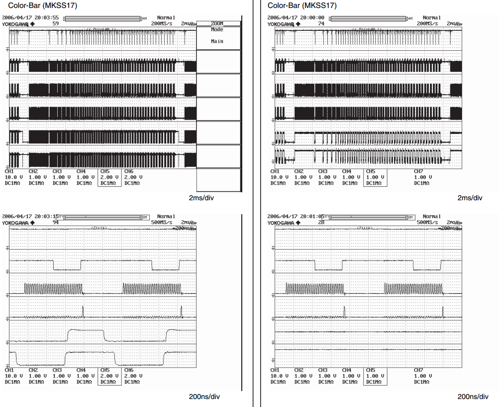

                        All you need to know about Japanese engineering is they test and check everything. So they are very well engineered. This is a reputation thing - it's why Japanese cars, like German cars, are often considered the best in the world.
                        You can see the engineering teams work hard. The oscilloscope screenshots show one unlucky bugger was up until 8pm finishing the manual...this is pretty common in Japan. I know an EEng who works there, it's brutal. Hardly any time for a social life.
