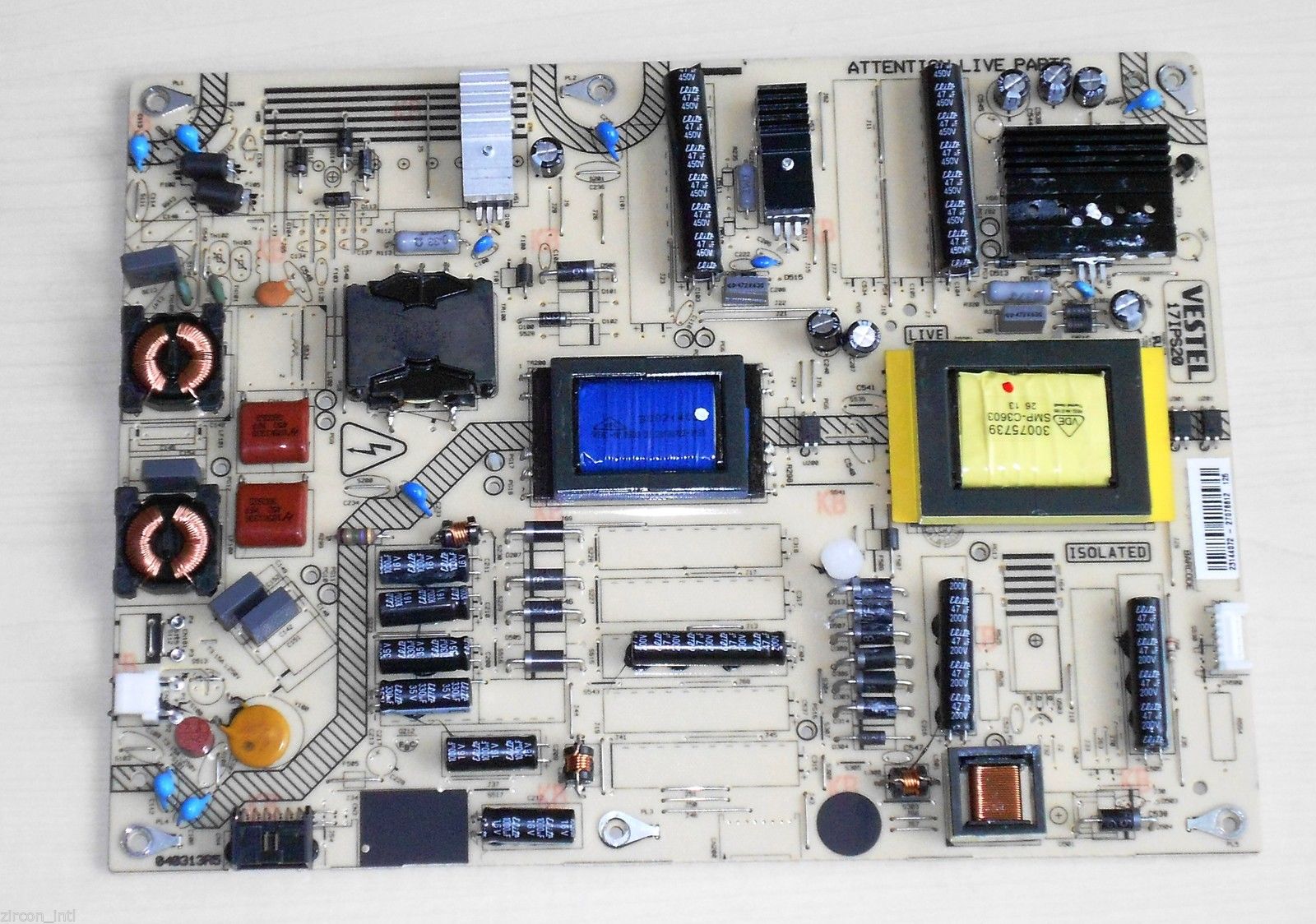

                            Hi, I've got a 40l1333db with the same sound but no picture problem, my power board is different to the one on this thread, I opened the screen and checked all led's work fine.
                            The lower left black connector is giving me, 3v, 5v, and 24v so all seems good
                            The connector for the led's is on the right a white block with just 2 wires to power the led's, when the tv is on this gives just 2v, can anyone see where on the psu the fault could be?
                            Thanks.

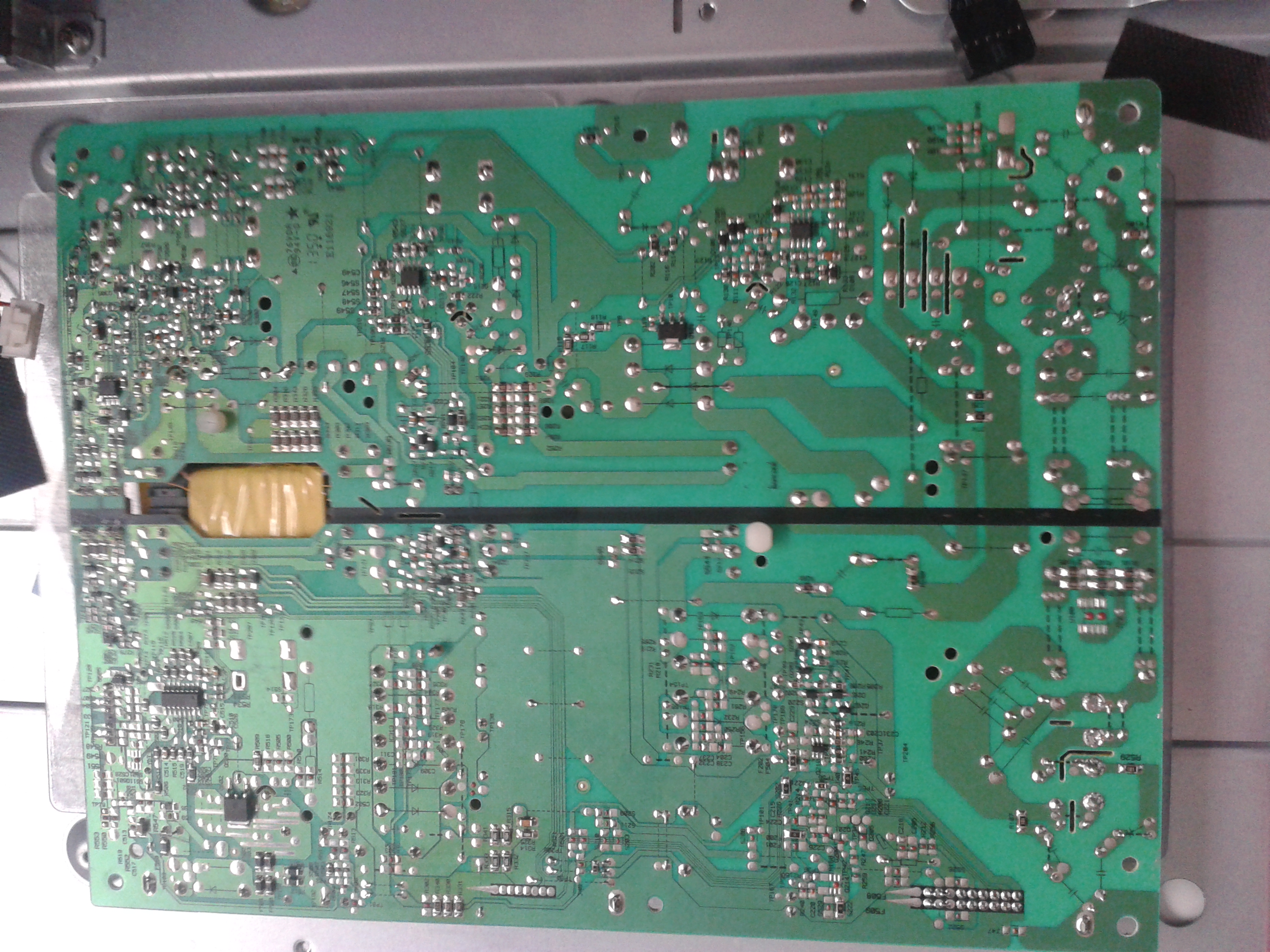

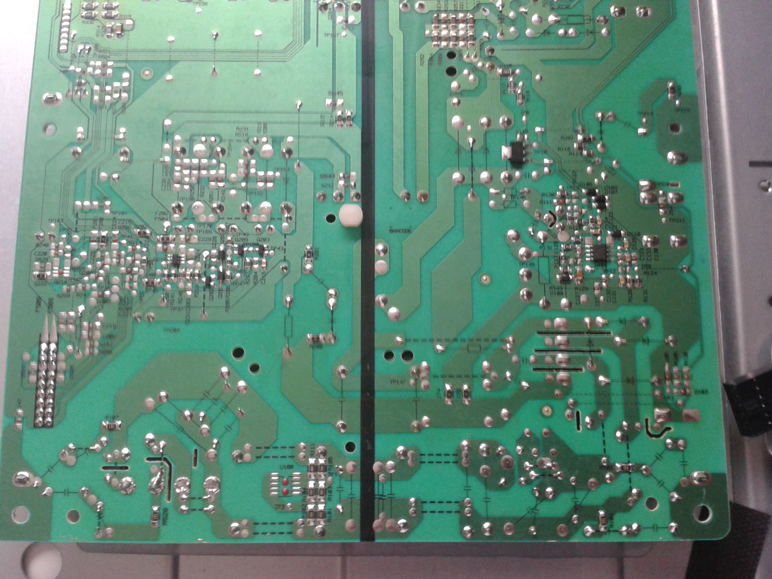

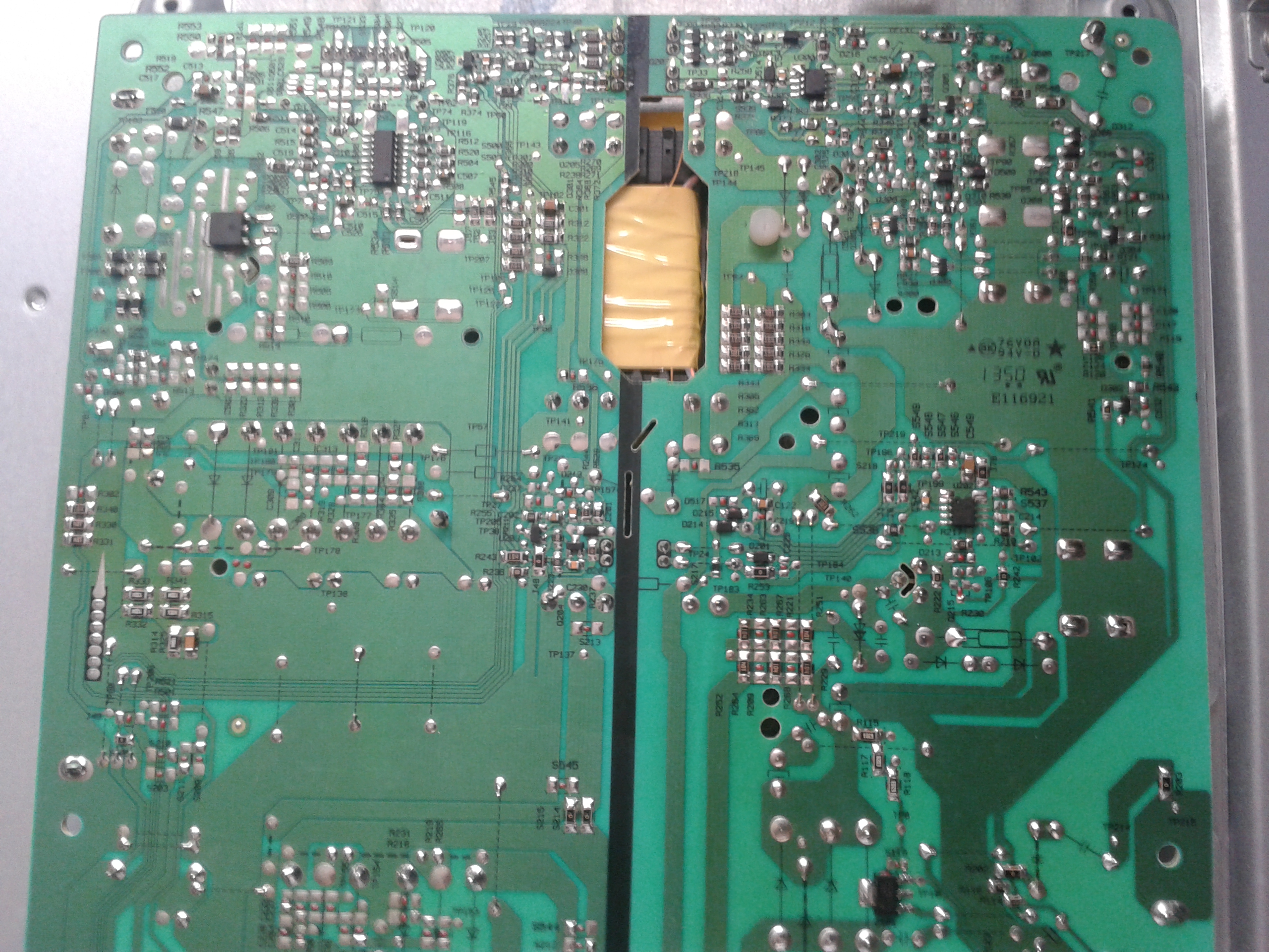

                                  Any good clear pictures of the whole bottom side of the board?
                                  • riget
                                    • Sep 2011
                                    • 66
                                    #37
                                    Re: Toshiba 40D1333B no back light.
                                    I'll take a pic tomorrow, thanks.
                                    • riget
                                      • Sep 2011
                                      • 66
                                      #38
                                      I'll attach some pics, the best my phone can do.

                                        As you have most probably already read, the PSU isn't the problem, at least not in my case, indeed this PSU has been used elsewhere now(a 50" Celcus) and has been working fine for a while now, my bet is a bad driver board or bad connections between the LED strips, some have actually soldered these together to cure the problem.
                                        • riget
                                          • Sep 2011
                                          • 66
                                          #40
                                          No mine is the psu, there is no driver board, the connector on the psu goes directly to the led's.
