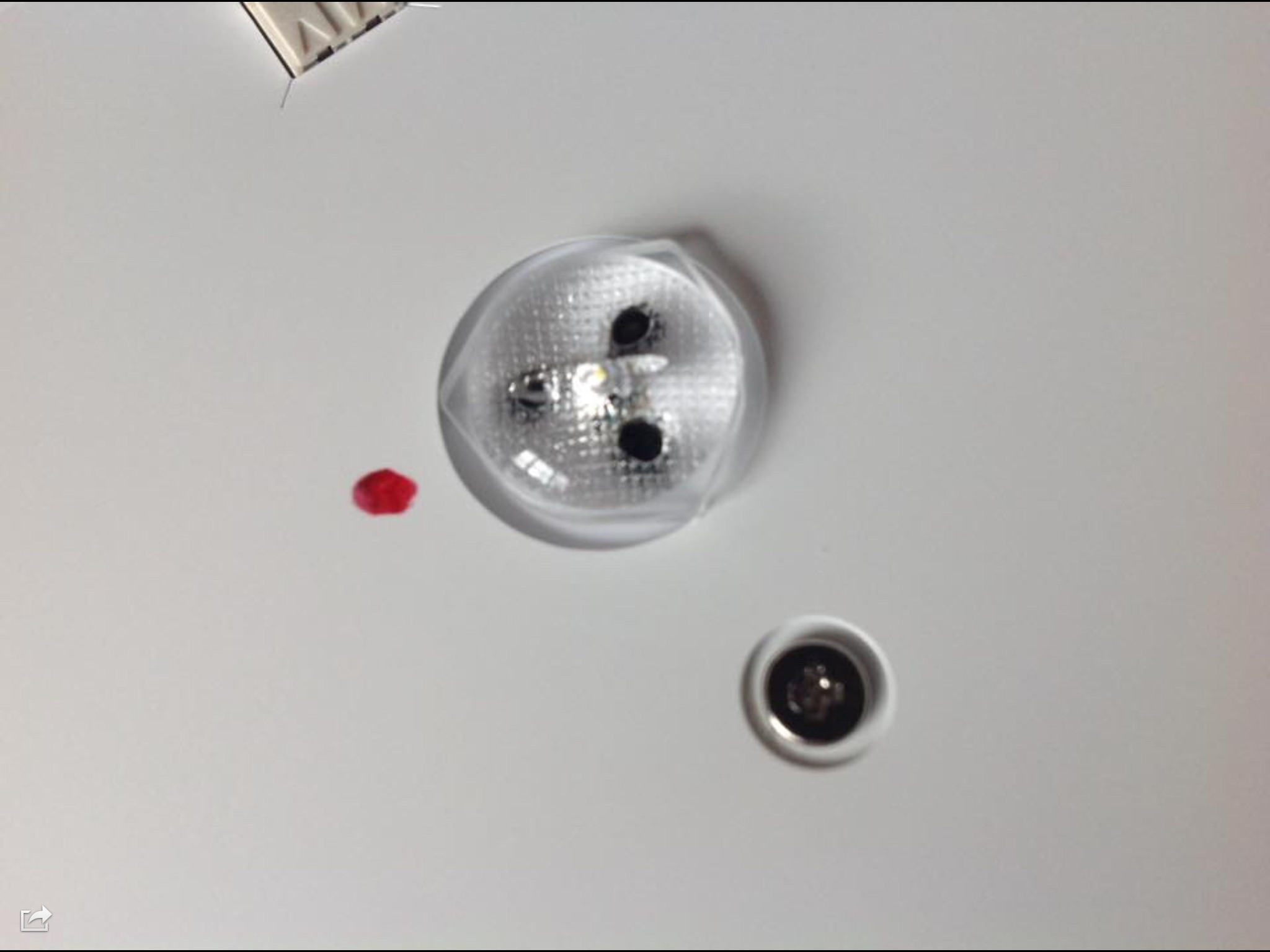

          Re: Toshiba 40D1333B no back light.
          Here is an example of the bad led, from the photo you can see that the optic is cracked probably because the led shorted and got really hot.
          • zomi
            • Nov 2011
            • 509
            IS the crack next to the red line I added ?
            Best to view these under a magnify lamp from the looks of it ?

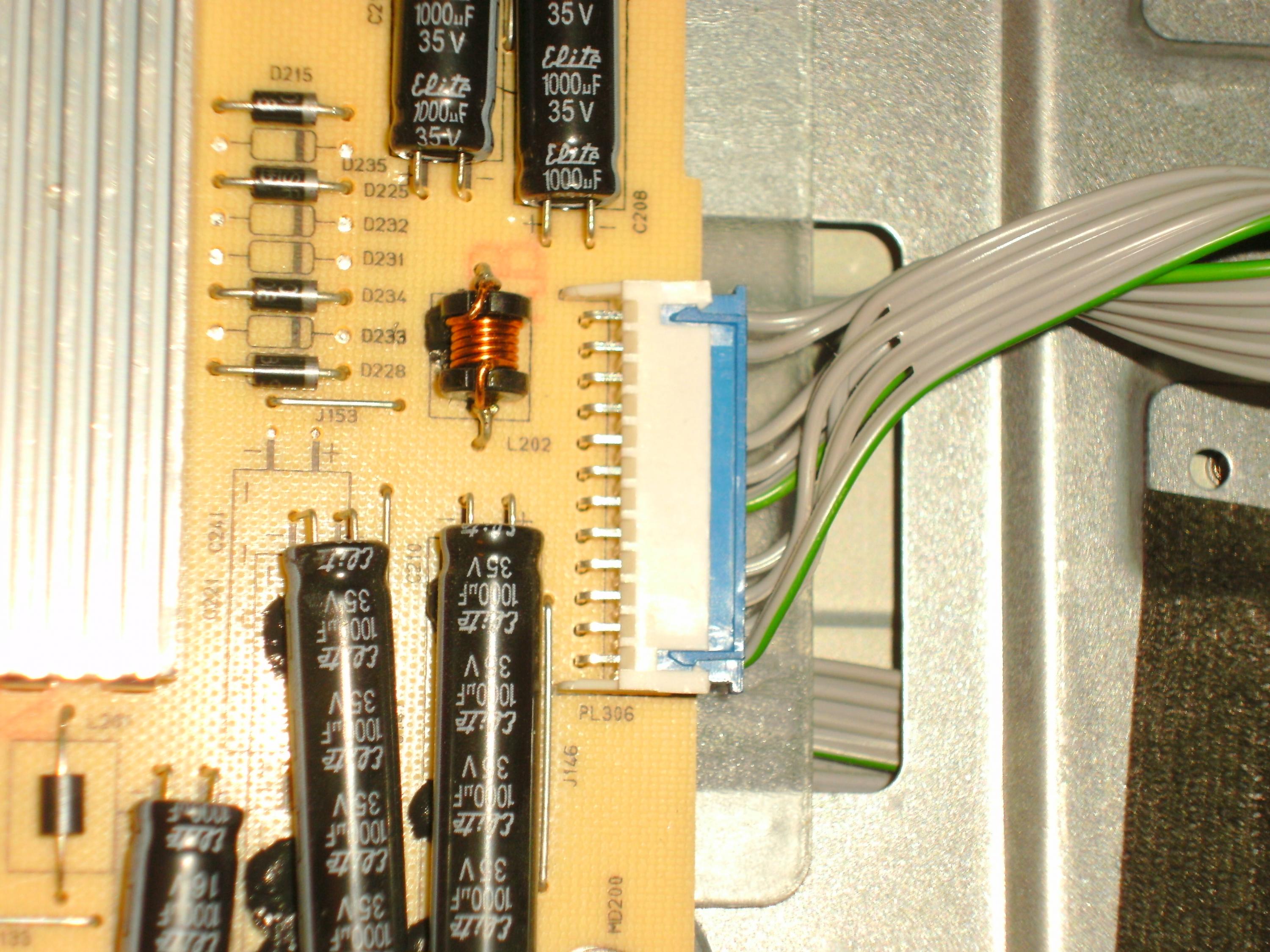

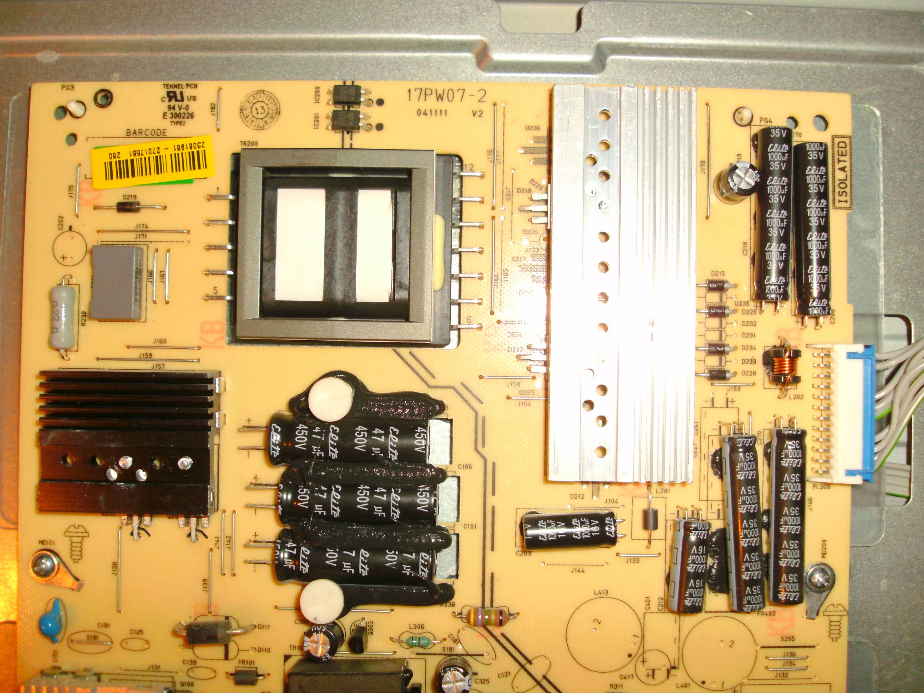

                    OK, let me analyze the board layout to see how the LEDs are connected.
                    OK, I cannot find anything at Shopjimmy to see if they have good pictures of the top and the bottom side of the board.
                    17PW07-2 power supply.
                    Can you please provide the pictures of the bottom side?
                    it looks like it has 4 LED strings (8 wires on the connector), 4 filter caps 1000uF/35V, so the drive voltage is not very high.

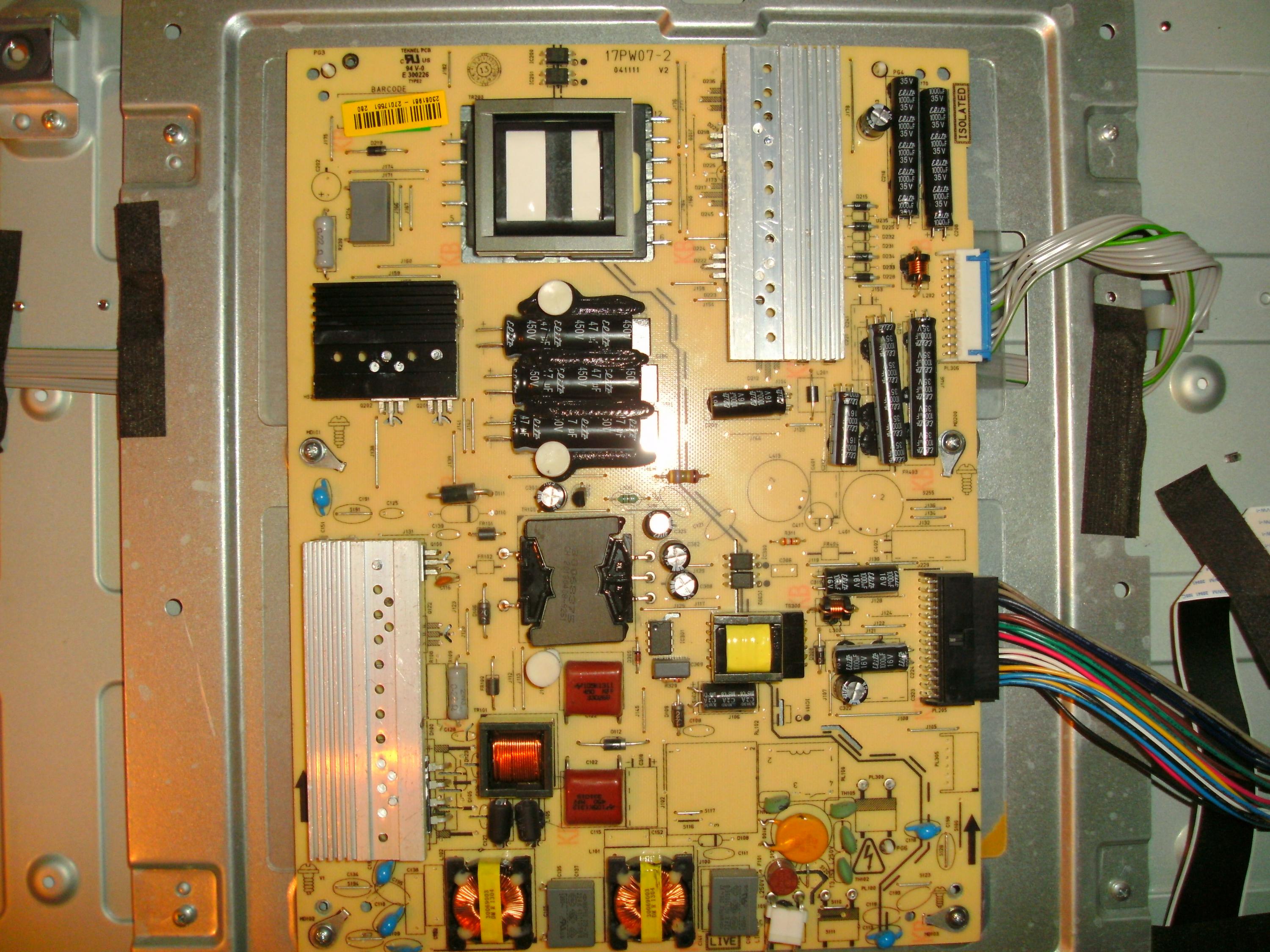

                        OK, we are missing the LED driver board picture!
                        Can you upload the pictures of the whole back side of the TV.
                        That connector PL306 is just the output connector to feed 24Vdc, and backlights commands signals to the LED driver board.
                        TOM, thanks for the diagram.
                          I have a sneaking feeling this is a TV with the 24V going to the panel, and the LED driver is inside the panel.
                          That's how the AUO panels in the 40L1333DB sets do it, and they use a very similar arrangement of parts.

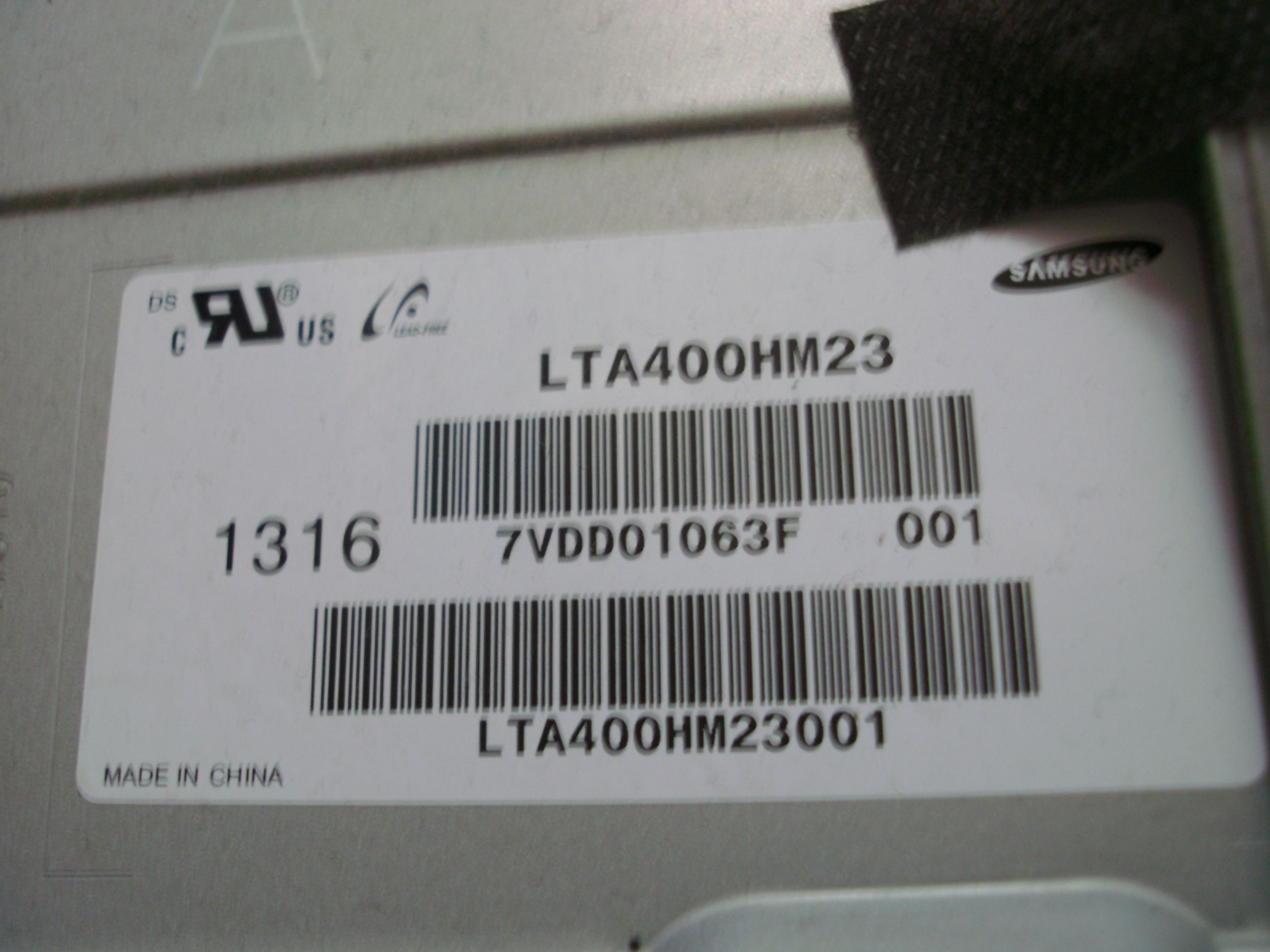

                                  Samsung panel with LED driver inside the panel?
                                  Can you provide the panel model number sticker? I would like to look up an info for it.
                                  • Dang
                                    • Aug 2013
                                    • 440
                                    Here you go, picture attached.

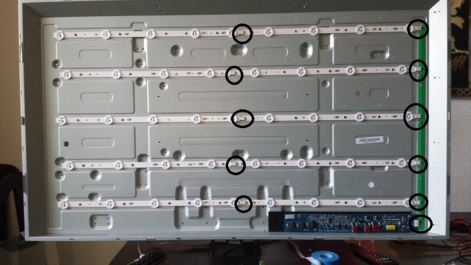

                                    • zomi
                                      • Nov 2011
                                      • 509
                                      To fix you have to strip the panel
                                      And get it like shown in the pic.
                                      If you have full voltage across the inverter
                                      Then you have to check for any blown led.
                                      If all is fine its best to bridge the connections shown with solid wire and all should be well ..
                                      Test it to see if any led's on verge of failing..
                                      • ReeceyBurger123
                                        Never Give Up !
                                        • May 2014
                                        • 7325
                                        • Britain
                                        The inverter will shutdown if it detects that an led isnt lighting and will only show 24v on the output. These panels are pure crap I have two more of these sets in now that need new diodes.
