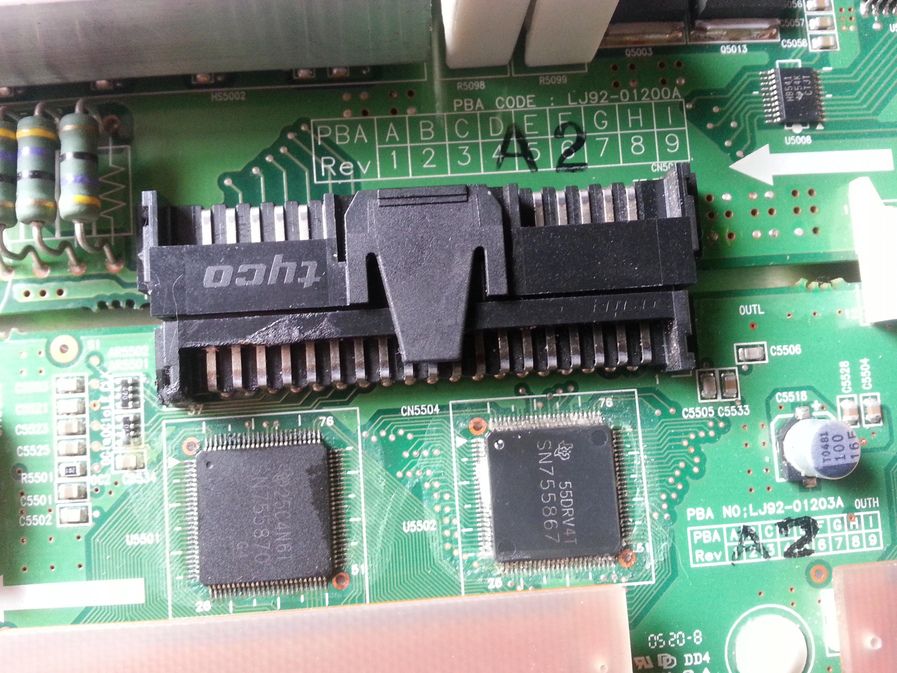

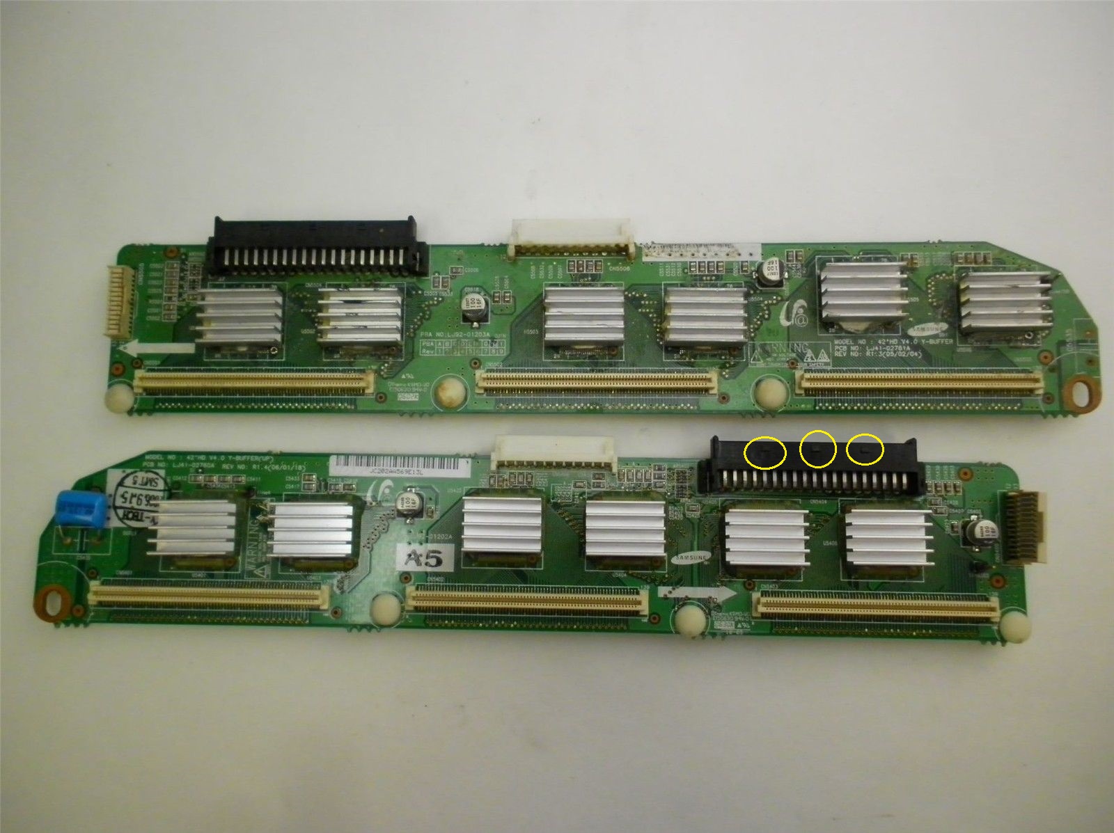

    Right I'm back hahaha had to put this on the back burner for a bit while I had some other jobs on so now that ive come back ive decided mayb its best I bite the bullet and just buy some known working upper and lower buffer boards.

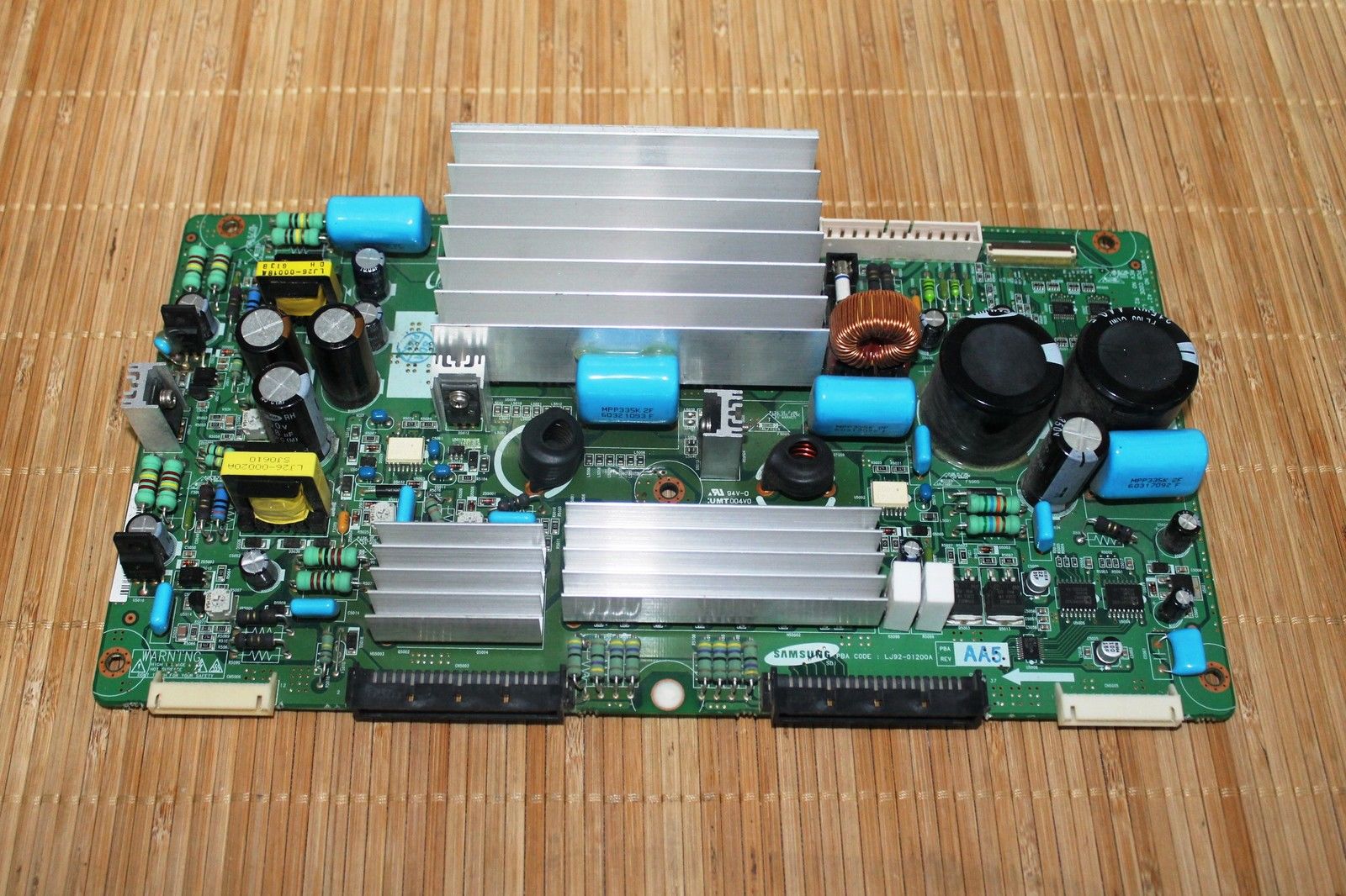

    Now my next issue is ive found plenty of upper and lower buffer board that I can get but ive notice my board revisions seem to be different to the replacements that I can find that's available. The black Teco connector that joins the upper and lower buffer board to the y drive boards appears to be the only difference that I can see physically.
    so if i was to buy an upper and lower buffer board with a different board revision, but has the same part and model number of the boards i have, will i have to also buy the same Y drive board with the same revision that has the same connectors? how does this work? are all revisions compatible even tho they can come from a different model plasma?
    I'm looking at these: (pics for eg only, mine is the 1st attachment)

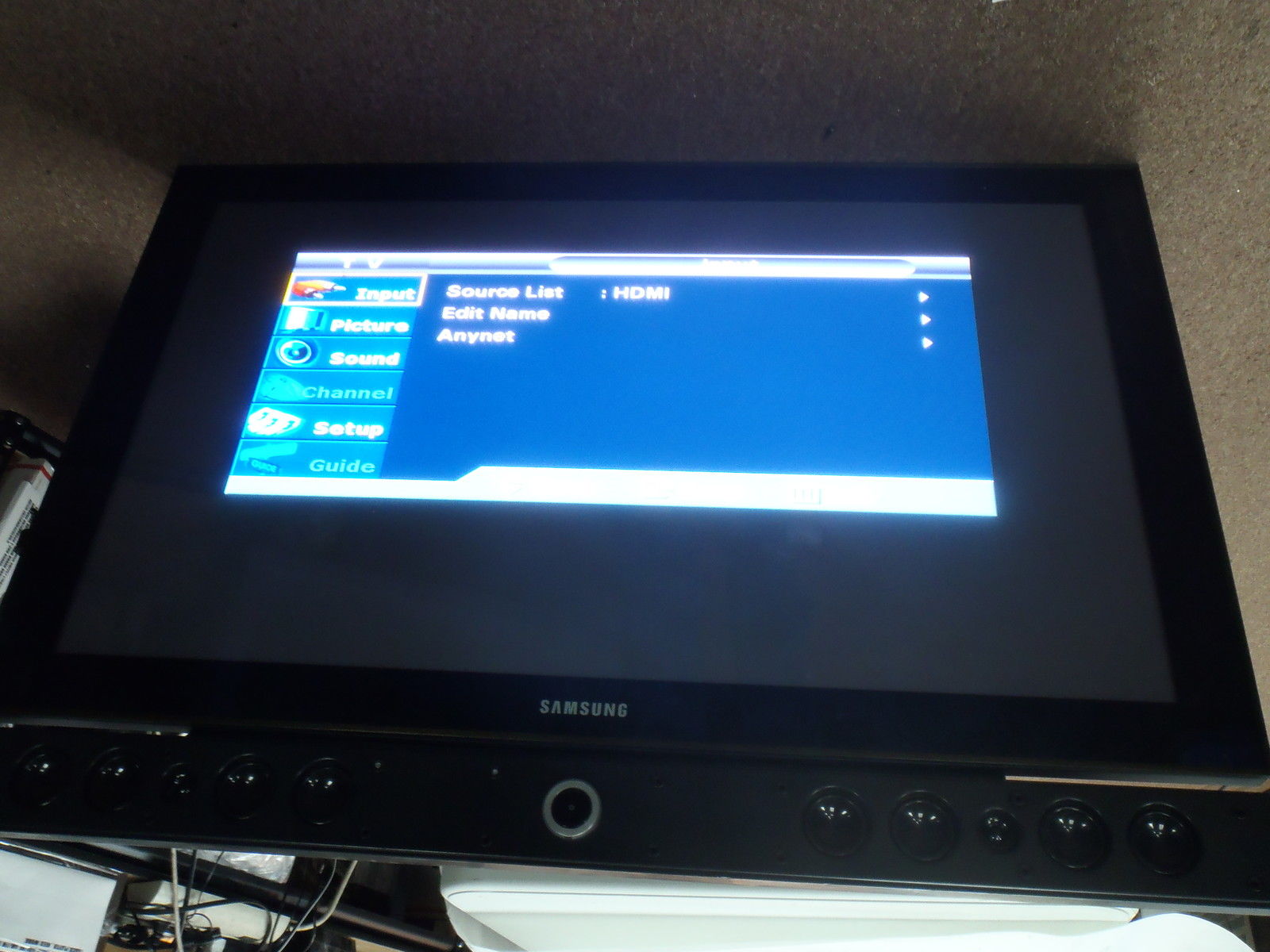

          OK finally got both replacement parts from separate sellers in which one buffer (the top buffer board) was a suppose a re-manufactured board that was never fitted with a later revision and the other which I was having a harder time to find was supposed to be from a working TV with the same revision as my originals.
          Anyways installed them both I can confirm board revisions seem to have no effect being different and I can cut those 3 small tabs off from the later revisions and use my own Y drive board with it.
          Well baby steps I guess its almost fixed with these results:
          Now as u can see the bottom buffer is not totally good I noticed a bit like my other original buffer boards, the IC's (with heat sinks attached) get a little hot much like the original buffer boards did but the top buffer boards IC's I could barely feel any heat from the heat sinks so my guess even tho there is no shorts, these IC's can still be faulty in some way.
          Can caps on the buffer boards create these IC's to get warm/hot if they are going bad?

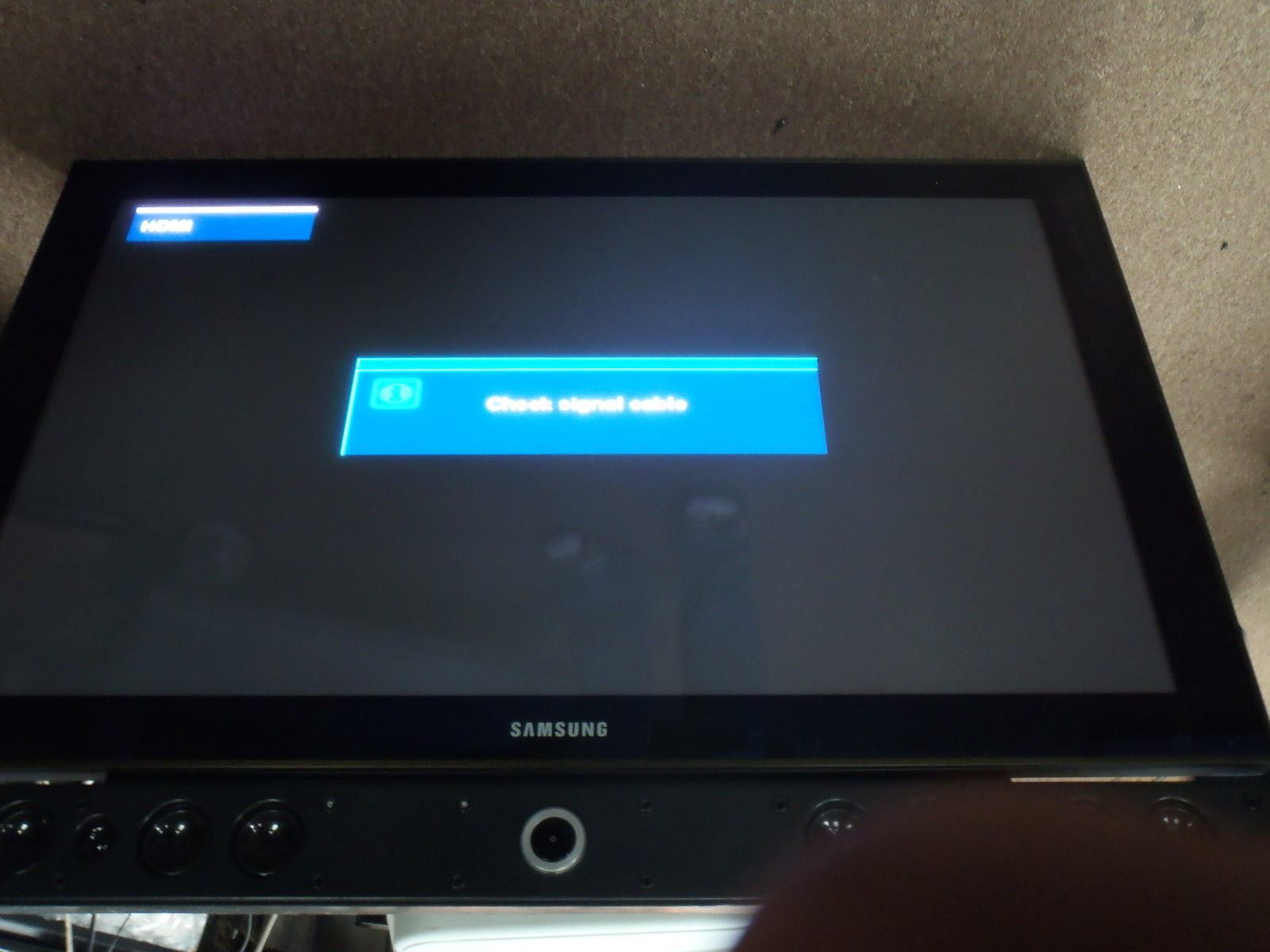

                Finally got this other replacement lower buffer board here and in but I now face this issue with this buffer board?
                1 solid black line across the screen, picture is prefect otherwise and all IC's on the board don't get warm to touch like the top buffer board, So the IC's must be good but is it now a pin or trace on the bottom ribbon connector not making good contact or something?? or just another faulty buffer board?
                I'm now looking back at the ad where I got this from and the shown working photos are these:
                would I actually see a black line on a black screen that's shown in the pic? I hope this is an issue I have and not the buffer and is just a sneaky way of fobbing them off as working?

                  Re: Samsung PS-42S4H flashing pixelated screen
                  Black line can be a panel fault or a buffer fault, but in most cases it is a panel fault which wouldn't be repairable. Sorry.
                    #89
                    Wouldn't the black line show up on the other lower buffer boards I've tried so far as well if it's a bad panel? i mean you can see previous pics to see if the same black line is present and its not.
                    Question on the black line tho does each horizontal line represent each trace on the ribbon cable? Since its broken up into 3 sections on the bottom i should be able to narrow down if it's a bad trace or something on the ribbon connectors or even buffer board? Or is it just not that simple?
                      #90
                      Yes, the black line should have shown up before if it was a panel fault. Can you try the old boards to confirm you did not damage a ribbon while installing the boards? If there's no line, then I guess the board(s) are bad.
                      Each display line has one trace associated with it on the flex and PCB. The purpose of the buffer boards is to switch a row select voltage on to each line sequentially, programming the panel. So each trace must be distinct to keep each line showing different data. (X-main/Z-sustain drives panel with common signal, hence one large "fat" trace instead.)

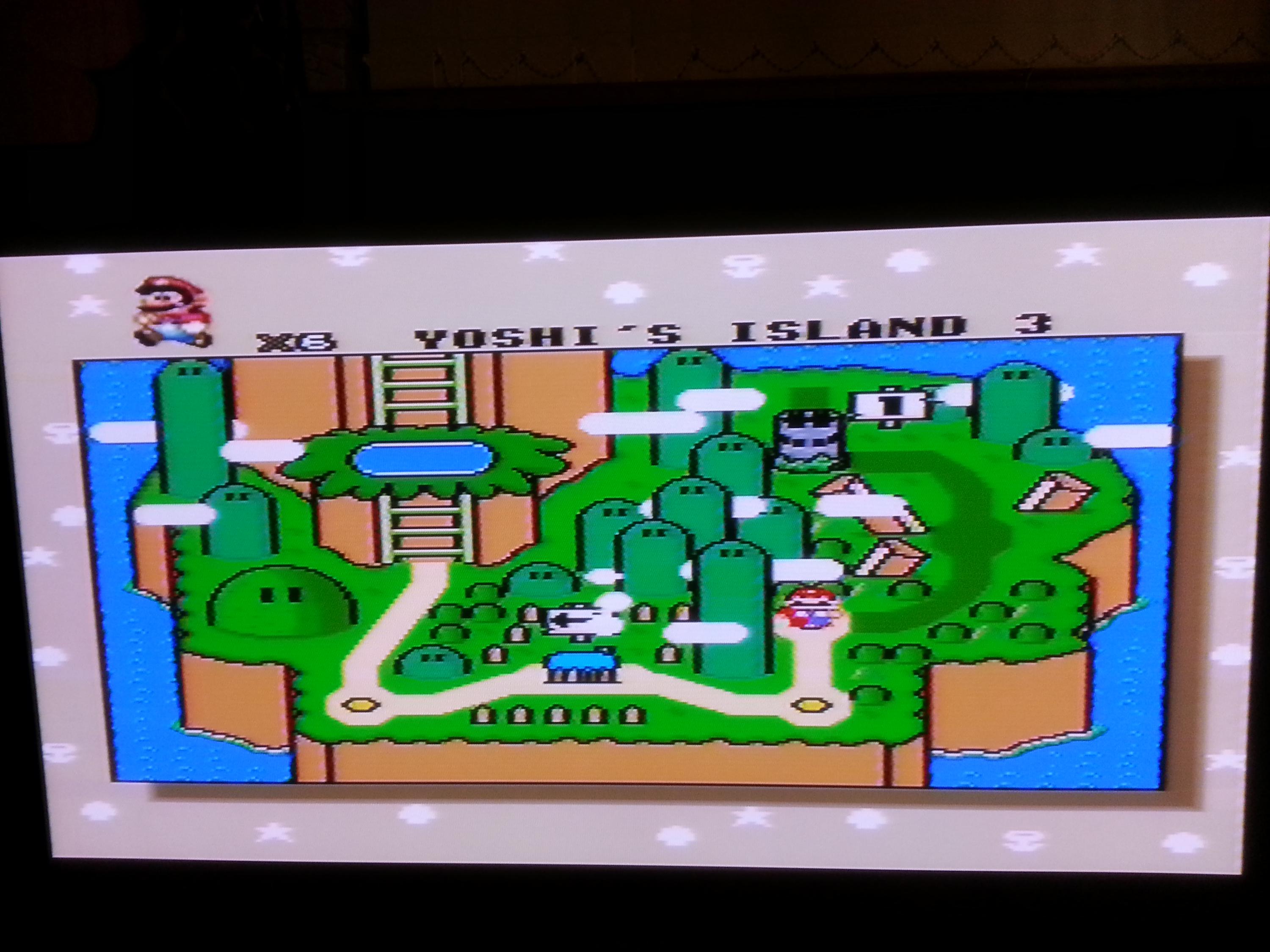

                        WOOHHOOOO fixed my 1st TV haha from persistence I managed to get rid of that black line. I tried the other buffer boards I had, it was hard to sport the black line on these but I think it was present but I'm not 100% sure as the display from these were fairly blotchy like u can see in previous pics but I think it was present.
                        So I tried to narrow it down by taking 1 connector off at a time and I found the middle connector from the lower buffer board must have been the culprit. when I plugged it back in and unplugged the 3rd lower connector that line actually worked which I found strange, it was kind of like the bottom traces of the middle connector and top traces of the bottom connector must connect in some way? mayb I'm talking BS? but that black line did show colour but when both connectors were connected the circuit is not complete giving me the black line.
                        So I thought i'll reflow the bottom 8 left and right sides pins of the ribbons connector and the top 8 of the same pins on the very bottom ribbon connector as surely 1 of these would be the culprit for the black line if there is a break in the line somewhere.
                        Plugged the buffer board back in and what do u know? NO BLACK LINE woohoo

                            LOL well its making a come back here, all retro stuff is so this TV will be seeing a lot of new and old consoles that come in for repairs from now on

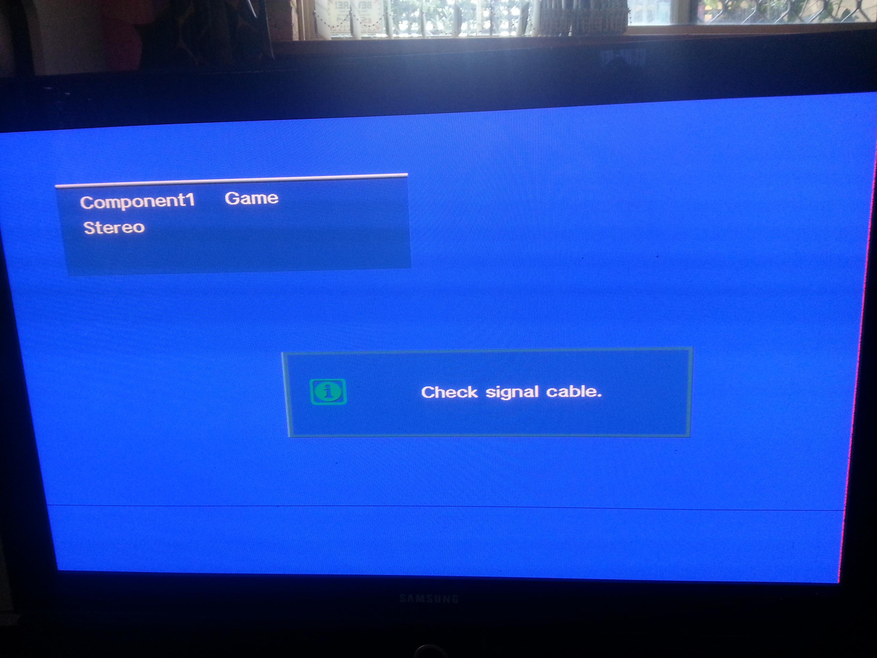

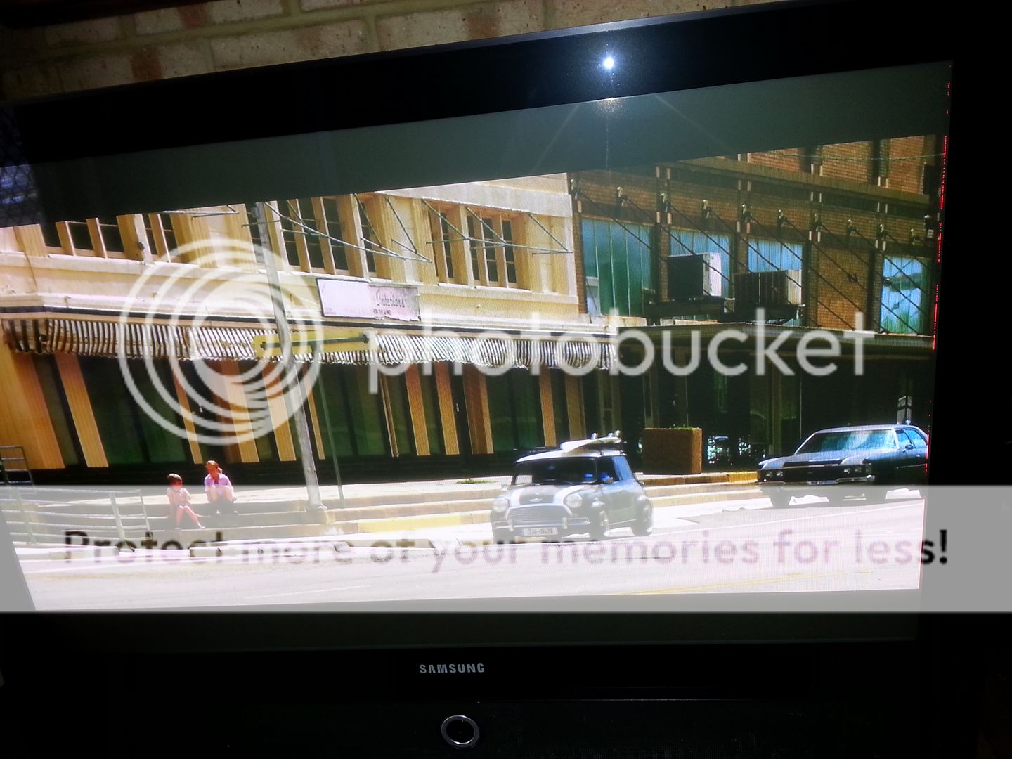

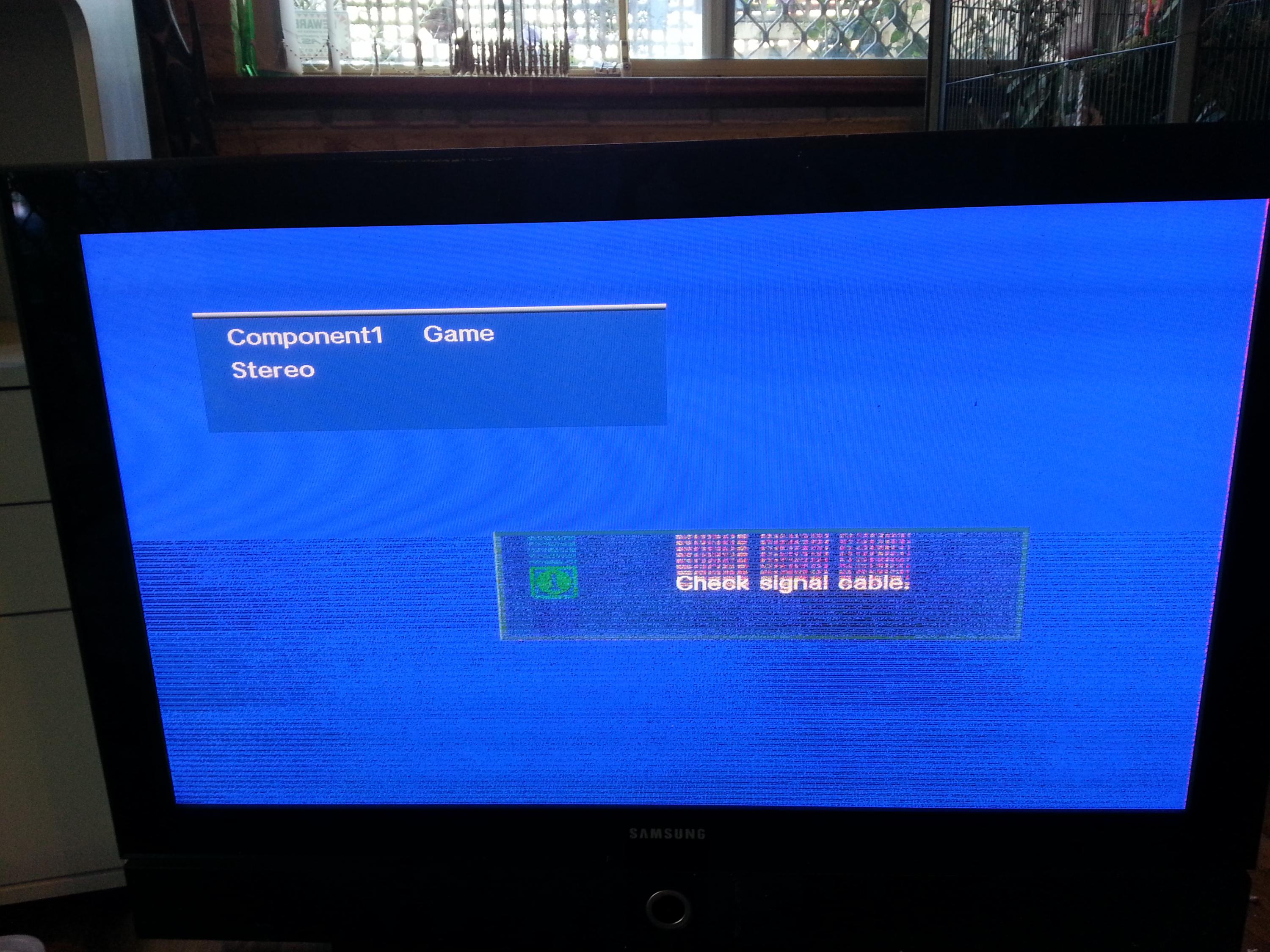

                              Just noticed something I'm not sure if its normal or not, I didn't pick up on this on the super marios screen before but on the blue screens looking back before I can see now I had the same issue present. I haven't used this TV really since the repair.
                              There's 1 red vertical line right on the right hand side panels edge, I assumed this was normal when I was originally working on it and thought from the close up angle I was looking at I thought the TV's frame would cover this and thought nothing of it but only now that ive gone to watch a movie on this TV I saw this and its not a constant red line.
                              is this something I need to be concerned about?
                                #95
                                Just thought not sure if it made a difference as to ahy I didn't see the red line before, the video gaming screen was played through the standard AV output and the blu ray movie was through HDMI Via PS3
