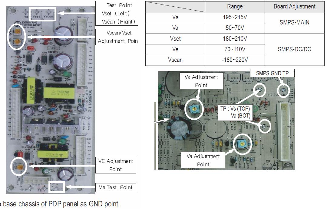

Samsung PS-42S4H flashing pixelated screen
    #61
    Re: Samsung PS-42S4H flashing pixelated screen
    Yeah I don't know if that's too low for this panel or not unfortunately. Any sticker on the panel indicating Vsch?

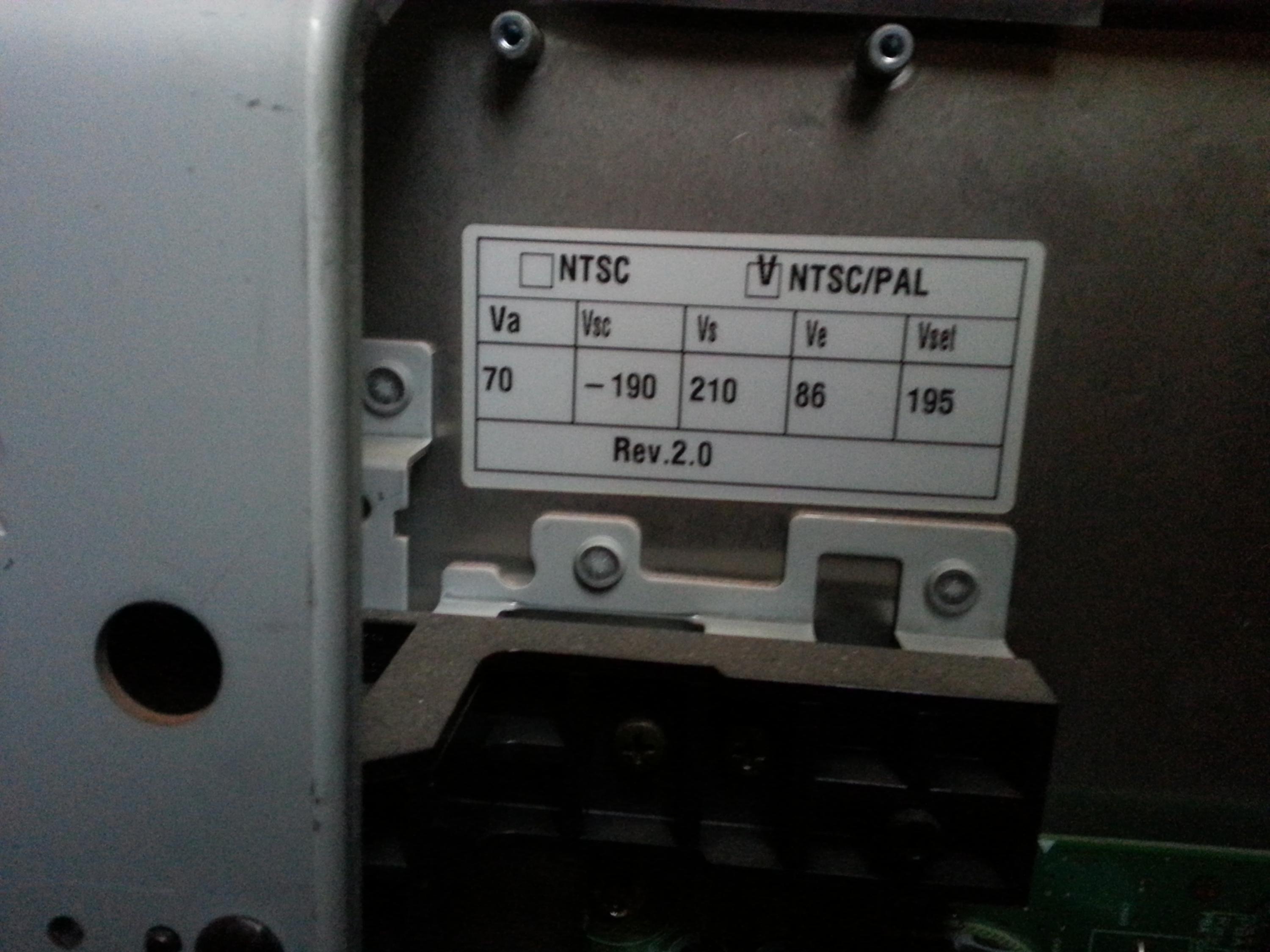

      #62
      The only sticker with any set readings is this one.

        #63

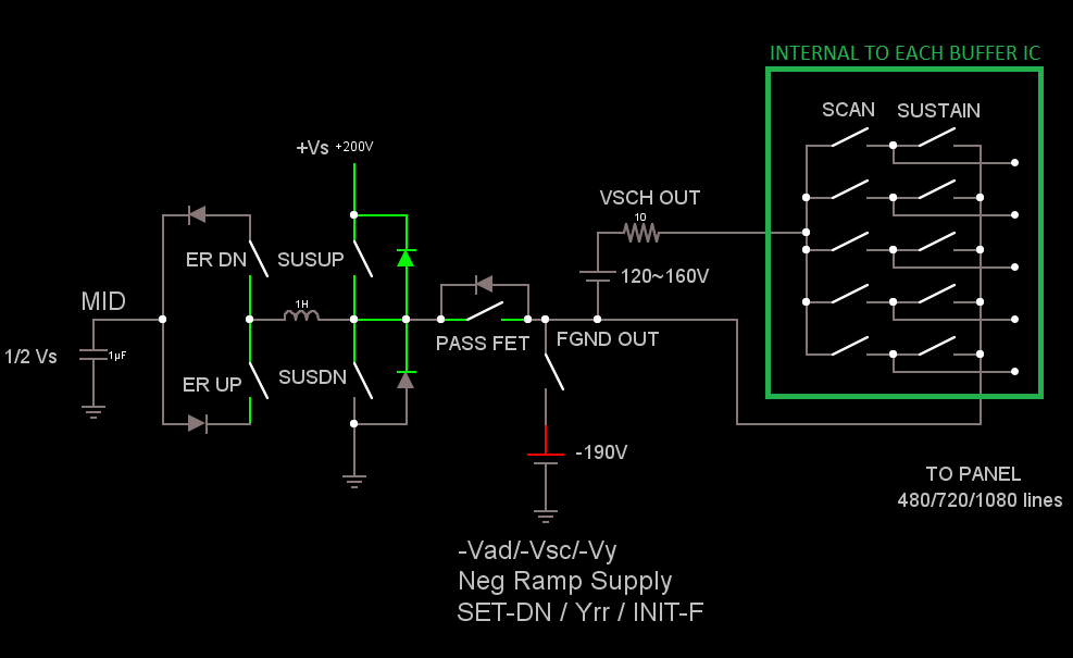

                #67
                Vsch is the row selection voltage. Around 120 to 160V. It is applied above the FGND on the Y-sustain board. It's only used by the buffer ICs, they either output the FGND current (peak 100A+), or the FGND+Vsch (very low current.)
                The Y-sus output is effectively ground for the ICs -- all the signals for the ICs are referenced to FGND.
                When you check for shorts on a buffer, you're checking between FGND and Vsch, the primary node, and FGND and all the logic ICs, and between FGND/Vsch and the outputs.

                  #68
                  so is it something you'd check with a cro more than a meter?
                  if we had to translate this back to a Panny would this be the MID voltage?
                    #69
                    MID is a different voltage, that's the energy recovery voltage.
                    Hang on, I'll draw something up on this. It's hard to explain in words.

                        #71
                        Ok... here's a rough overview.
                        The buffer ICs switch between FGND+Vsch (I'll call it VH) and FGND (I'll call it VL.)
                        FGND can vary from -190V in -Vad portion up to +200V during Vs in modern designs, some older sets would peak at 350V for Vset but this has been largely eliminated now as panel design has improved.
                        HOWEVER... effectively the buffer IC only "sees" the Vsch voltage, nothing else.
                        Each buffer IC switch is about ~20ohm IGBT and there are ones from VH to the panel output, and ones from the output to VL, the ground. For a 1080p panel that's 2,160 different IGBTs inside ~12 chips. Pretty impressive stuff, when you consider each IGBT stands off about ~160V max and has to sustain several amps peak.
                        As for the rest of the sustain board layout...
                        The various voltages are generated by one or two transformers, which generate isolated voltages, or in the case of older Panny sets, an isolated boost converter does the job.
                        Most sets only use Vsch during the scan period, when most panel outputs are at -Vy, so some of them turn off Vsch or lower it during non-scan periods.
                        The panel scanning works in tandem with the address buffers (Vda/Va/Vad etc) but is an independent system. The buffer ICs only select rows - they do not scan in individual lines of data.

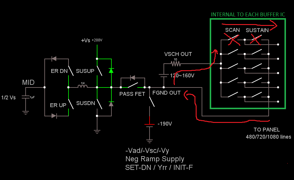

                                #75
                                Typical fault path if buffer IC burns. There would need to be a path from FGND to GND and up thru Vsch perhaps thru transformer to kill SUS DN. It's pretty unlikely.
