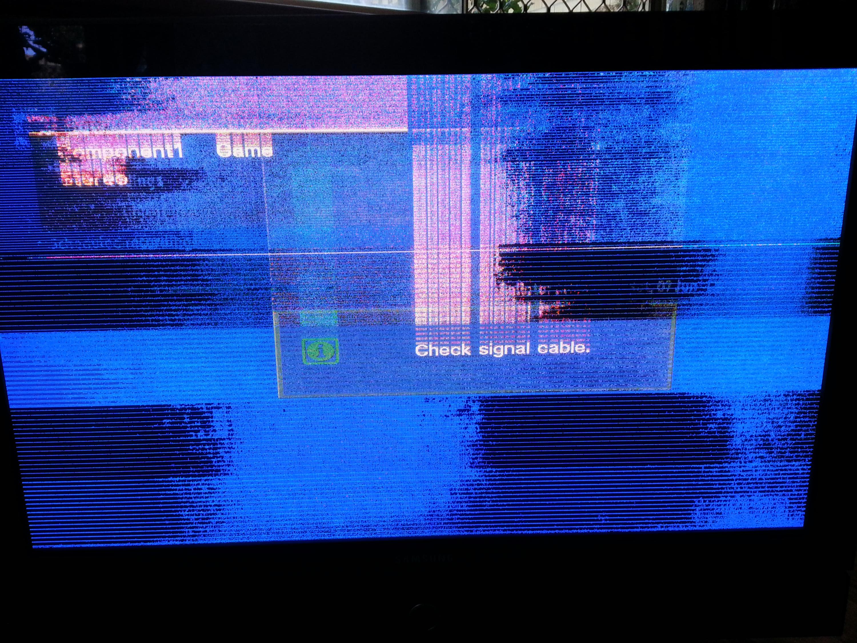

                                      Re: Samsung PS-42S4H flashing pixelated screen
                                      Well good news is there was no pops and the IC's are not running hot (heat sinks still not attached yet) but I now get picture that's pixelated and fussy. At least its not switching on and off now
                                      So what could these be? I read the cables that plug into the buffer boards can cause issues similar but I did re check these and plugged them in and out a few times just to be sure.
                                      thoughts?
                                      posted pic just for u too tom incase u cant see the pic from photobucket.
                                        #59
                                        Can you check Vsch with the Y-buffer connected? Just to see if it's stable under load.
                                          #60
                                          im getting 115.5V
                                          So that's black probe on FGND and red probe on the 2 outer most pins on those buffer connectors.
                                          I was actually wrong about those Buffer IC's with the TV sitting for longer periods, they are getting fairly hot to touch but I did notice the IC I changed is much cooler then the others but still warmish.
                                          is it possible I need to go over my soldering again on the IC I changed?
