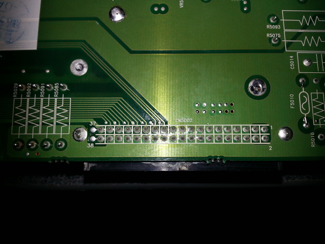

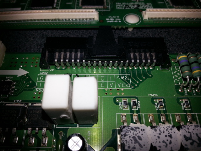

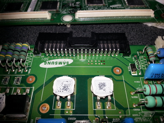

                                I think I know what u are talking about now if im correct I noticed this when testing the top and bottom buffer boards for shorts?
                                So in that case im guessing VSCH are the lighter green PCB trace (floating ground) and the VH is where the darker green traces are?
                                connector CN5002:

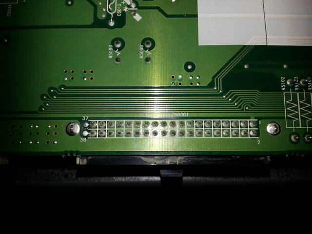

                                So lets say pins No. on top connector on y drive board VSCH is seen connecting all pins by the lighter green pcb trace? and VH is pin 1,2,3,4?
                                Connector CN5001
                                pins No. on bottom connector on y drive board VSCH is seen connecting all pins by the lighter green pcb trace? and VH is pins 35,36,37,38? pin 1 and 2 here looks like it links up to the other connector CN5002 is this also a VH point?
                                To check this voltage I would have to install the Y drive board back in and hook everything up except for the top and bottom buffer boards and power the TV on and measure its voltage that's mentioned is that correct?
