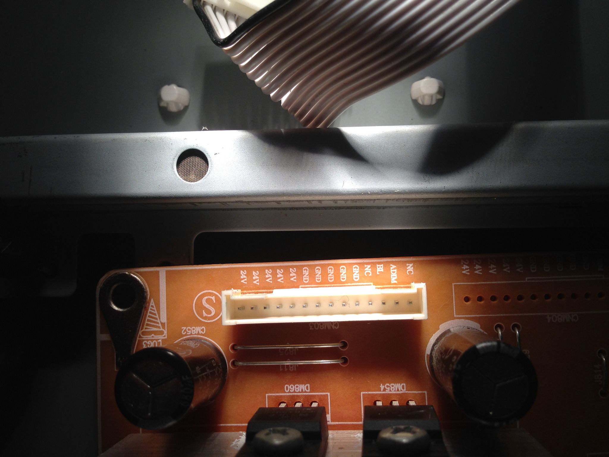

    Hello again everyone. I was watching TV the other night and it was working fine. This morning when I turned it on, it won't power up. The standby light is ON and when I press power, the standby light flicks off, then on again (and remains on) but nothing happens. There is no picture or sound nor does the TV come on.
    I have pulled the power board and I'm not getting ANY voltages except my 5V standby power off the "SB" pin that goes to the main board.

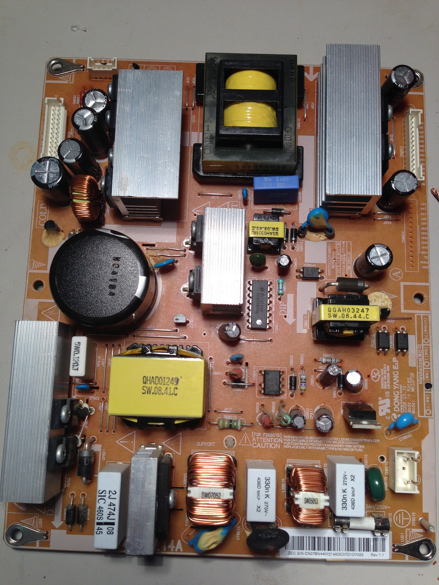

    I downloaded the service manual but there is a major problem. All the troubleshooting and diagrams have DIFFERENT numbers and names than what's on my board. My power board is a BN44-00214A. I've pulled EVERY capacitor including the big one out of the board and bench tested it. They all check OK. The Blue capacitor on the board is also ok.

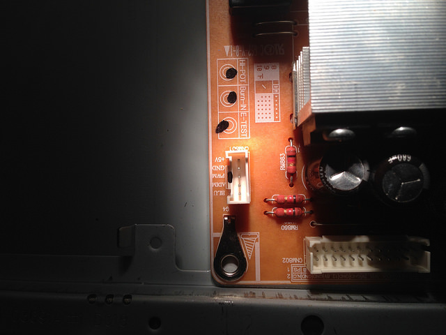

    I checked the solder joint on the (transistor/bridge??) QB802 and it looks fair. I manged to scorch the board near there too. I pulled it and cleaned it and added my own solder. I haven't tested it yet except out of circuit and with my MM. With Red prong on left lead and Black prong on right lead (nothing in middle) in diode mode I get .62. I don't get readings any other way or combination.
    I'm getting NO DC voltages anywhere else on the connector pins that go to any other part of the TV. I'm not getting 24V or my 12v or my 5.3v etc.
    How do I test that QB802 and what else do I need to check. I DID scrape all the glue off all major components. I also checked the big cap but forgot to write the values down, but they were within the 10% limit.

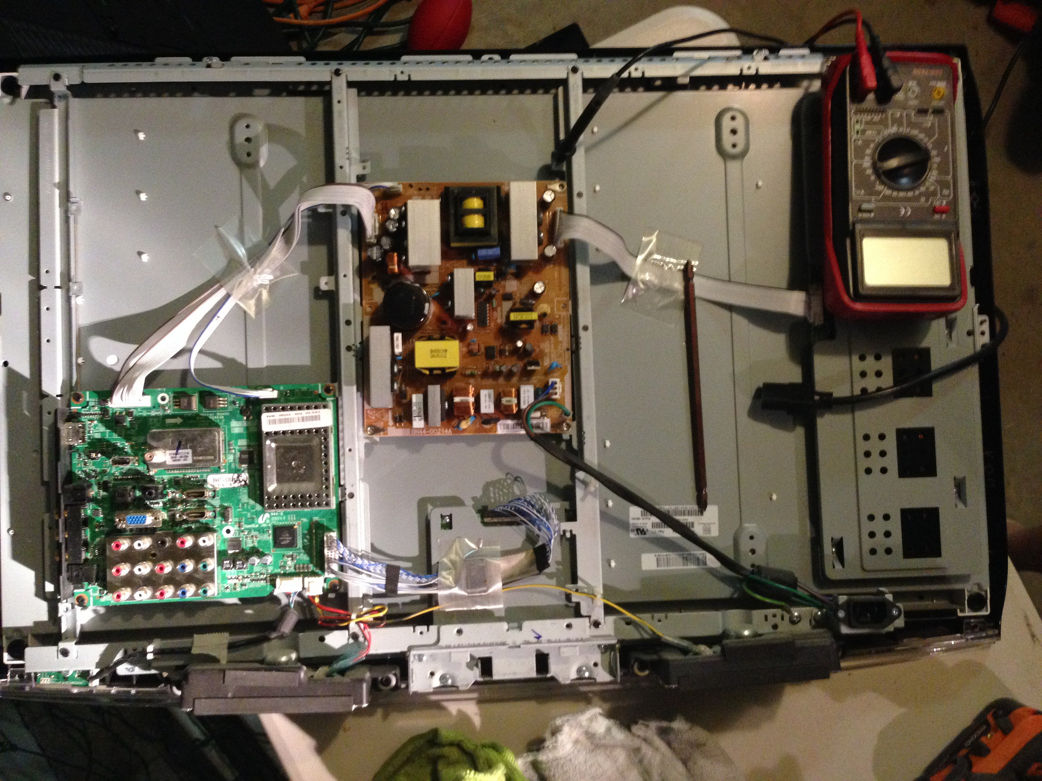

    I attached a clear well lit picture.
    Has anyone had similar problems with this unit and manual? I searched the forum and saw the same model TV having problems, but my problem is different.

    Lots of issues with this PSU, caused by bad glue.
    https://www.badcaps.net/forum/showthread.php?t=42422
    Were there burn marks around QB802 there before?

        This schematic of the power supply might help. Are you getting the PS_ON voltage at pin 1 of CNM802 on the power supply board?

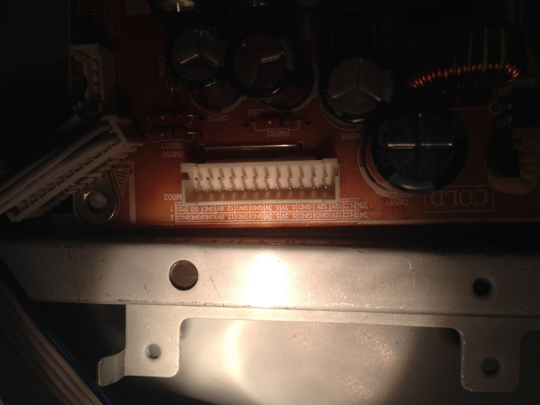

          No I'm not getting any voltage at PS_ON on pin 1. I DO get 5v at pin 3 though, which is the ONLY voltage I get out of that entire connector.
            Re: Samsung won't power up ln32a450c1d
            Pull the plug from power board to main at main board end, with a 500-1000ohm resistor jump stby to Ps on(pin 3-pin 1) the board should now show all supply voltages. if you see it is working your problem is with the main board, if not its power board. hope this helps Flocko

              Hi again. So I did like you said and jumped the pins. All power connections came alive and read the voltages they were supposed to. AMAZING! I guess this means there is something on the power board that's bad. Specifically something from the input voltage to the pwr_on voltage? Where do I look now that I know this?

                The fault is on the mainboard the power supply seems fine as its giving the correct voltages now

                  Hi you have a problem with the main board as it is this board that turns on the power board, the 5v stby from the power supply goes to the main , when you use the remote or side buttons to turn the set on, it returns a voltage of about 3v to the PSon pin . that was why you were asked to check for life on pin 1, faults to main boards are hard to trace, so I would look for a replacement, the part numbers for Samsung mains are on the white bar code sticker and need to match like for like look up the number you find on shopjimmy , as some time you can use other board numbers as well Flocko
