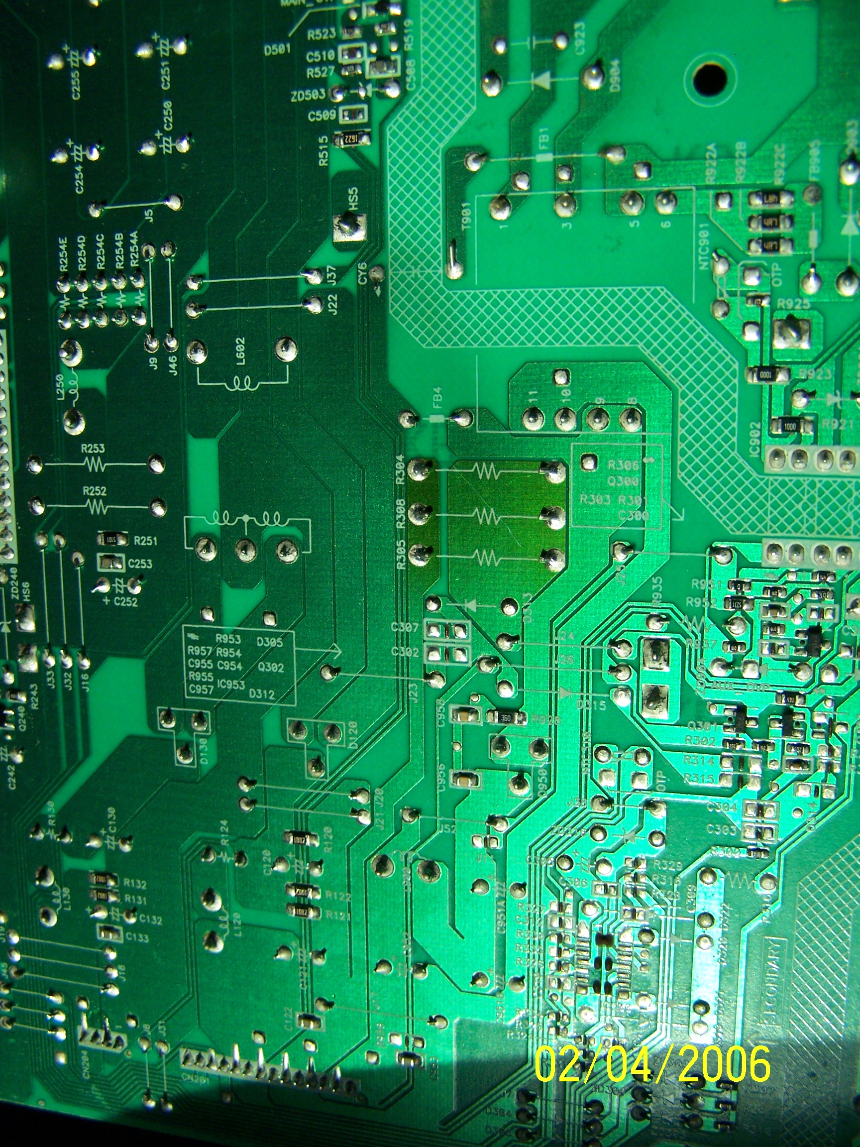

    I have replaced the T-Con and mainboard and nothing but when I look at the PSU resistors R304,305 and 308 only read 28 Ohm. They are marked 68 Ohm. Back of the PSU at resistors location is yellow compared to the rest of board. Is it possible why all I am getting at the 24VDC pins for the master and slave only 8 VDC. I am a novice so any help would be greatly appreciated.

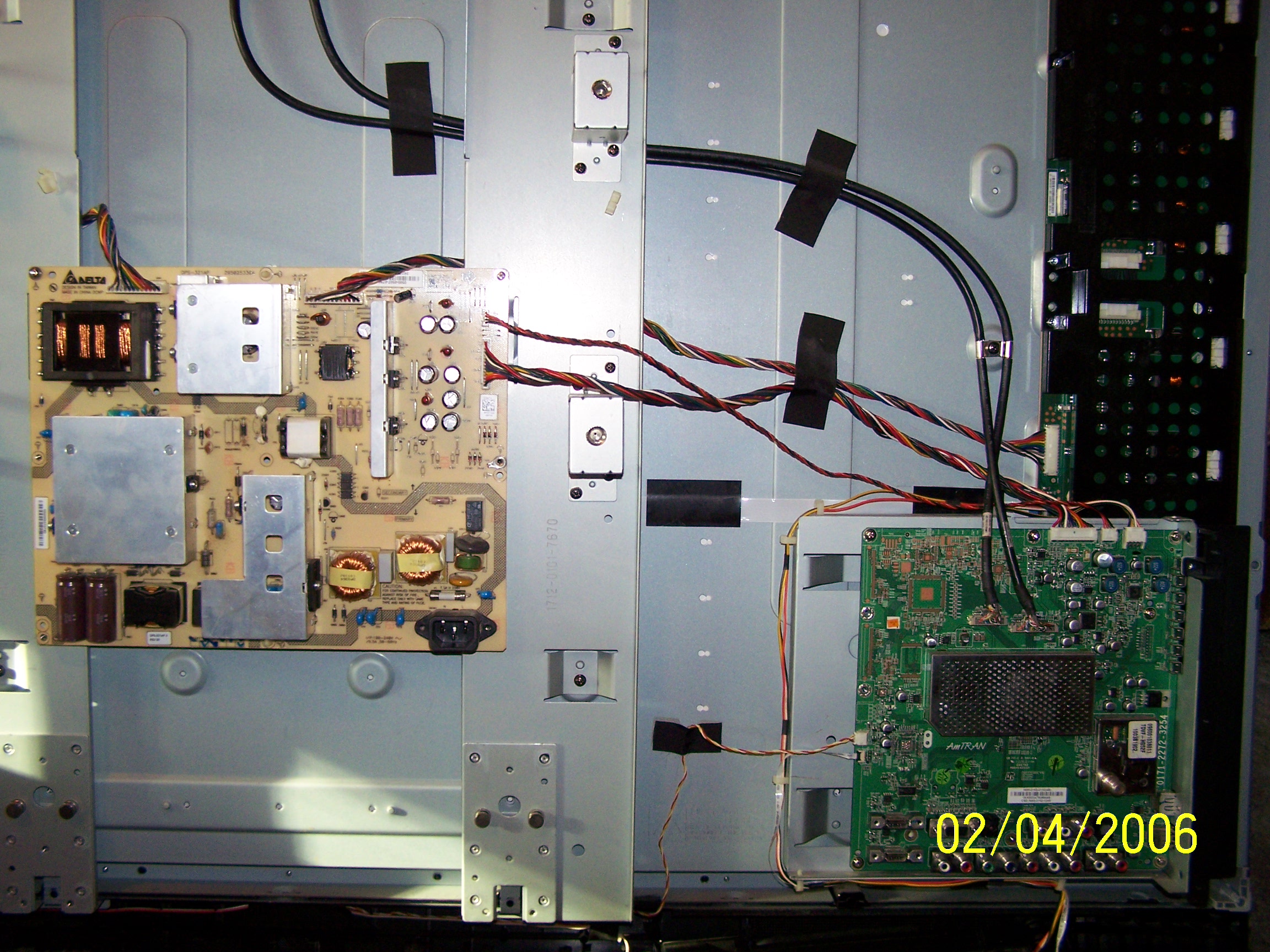

    Start by uploading good clear and well focused pictures of the whole back side of the TV so we can see how all the boards are connected together, then pictures of the TOP and BOTTOM sides of the power supply board.

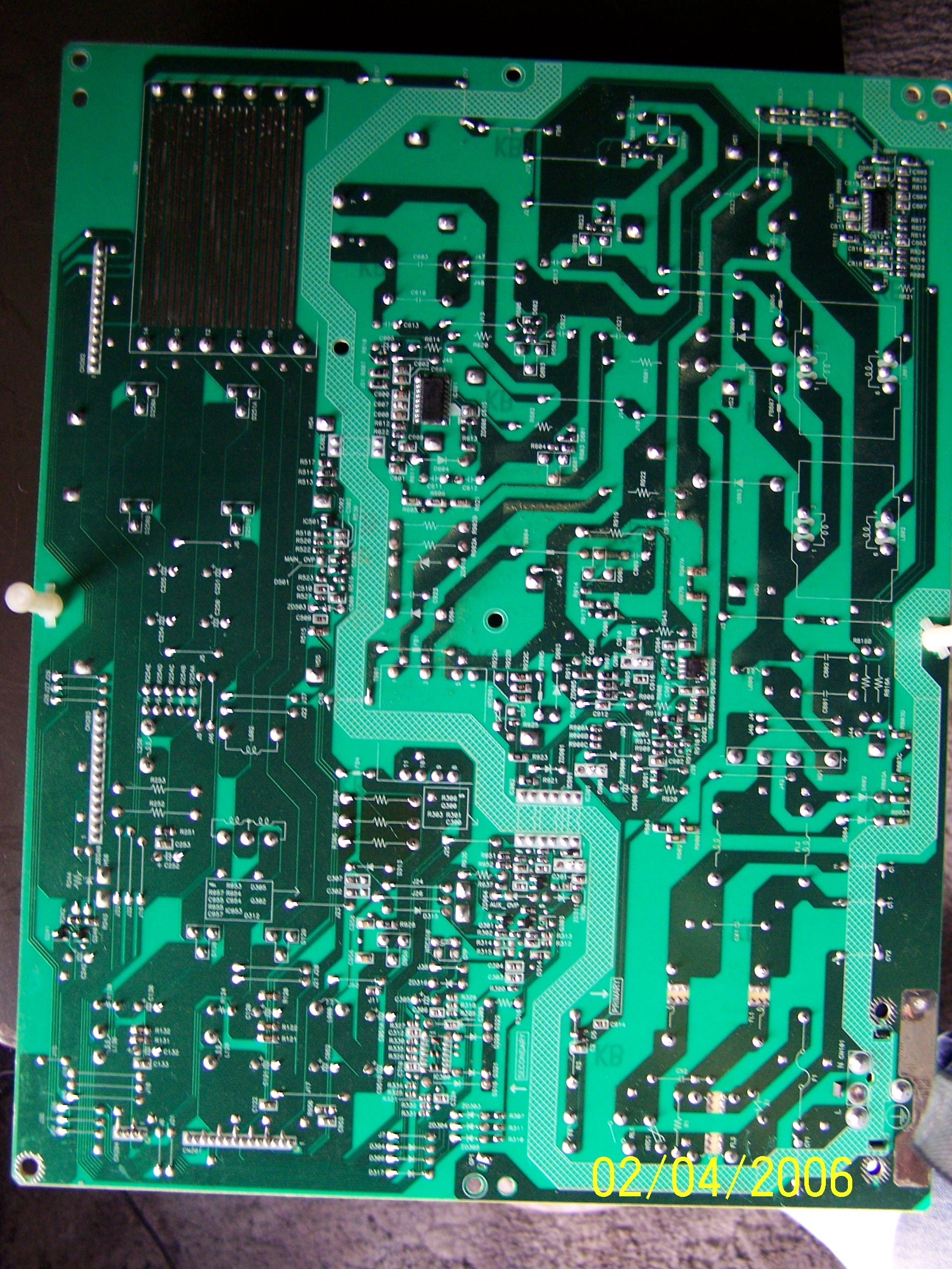

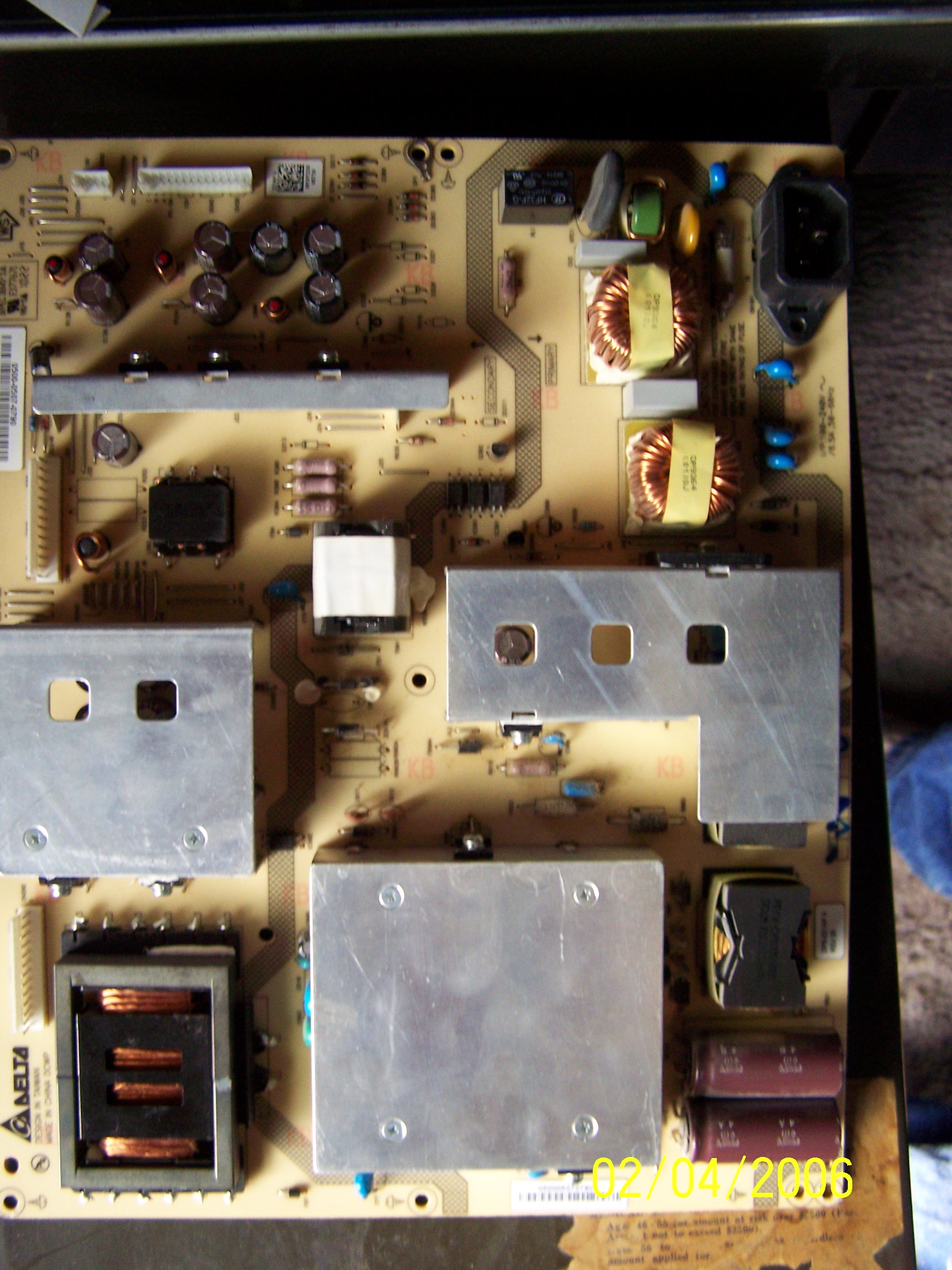

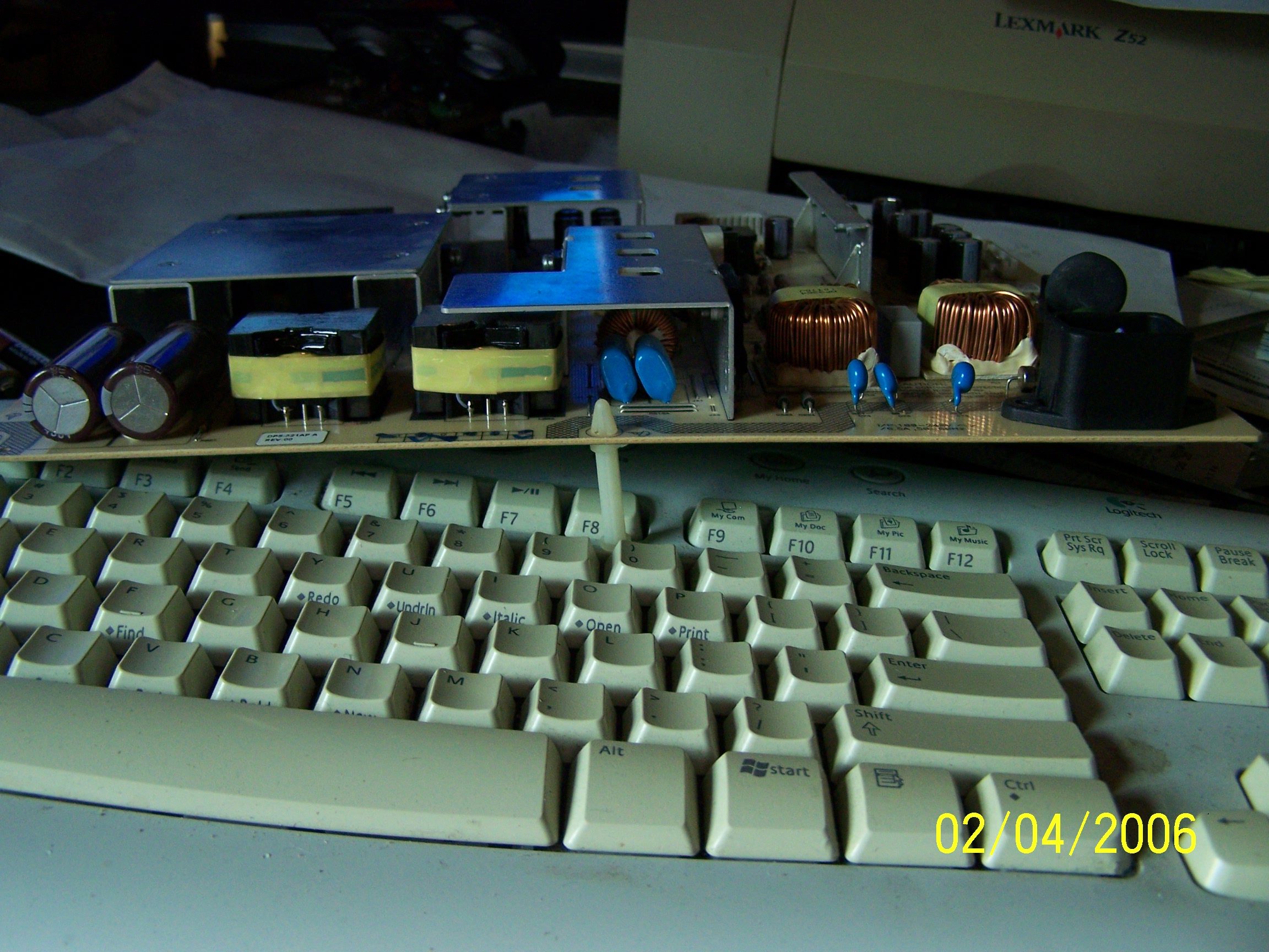

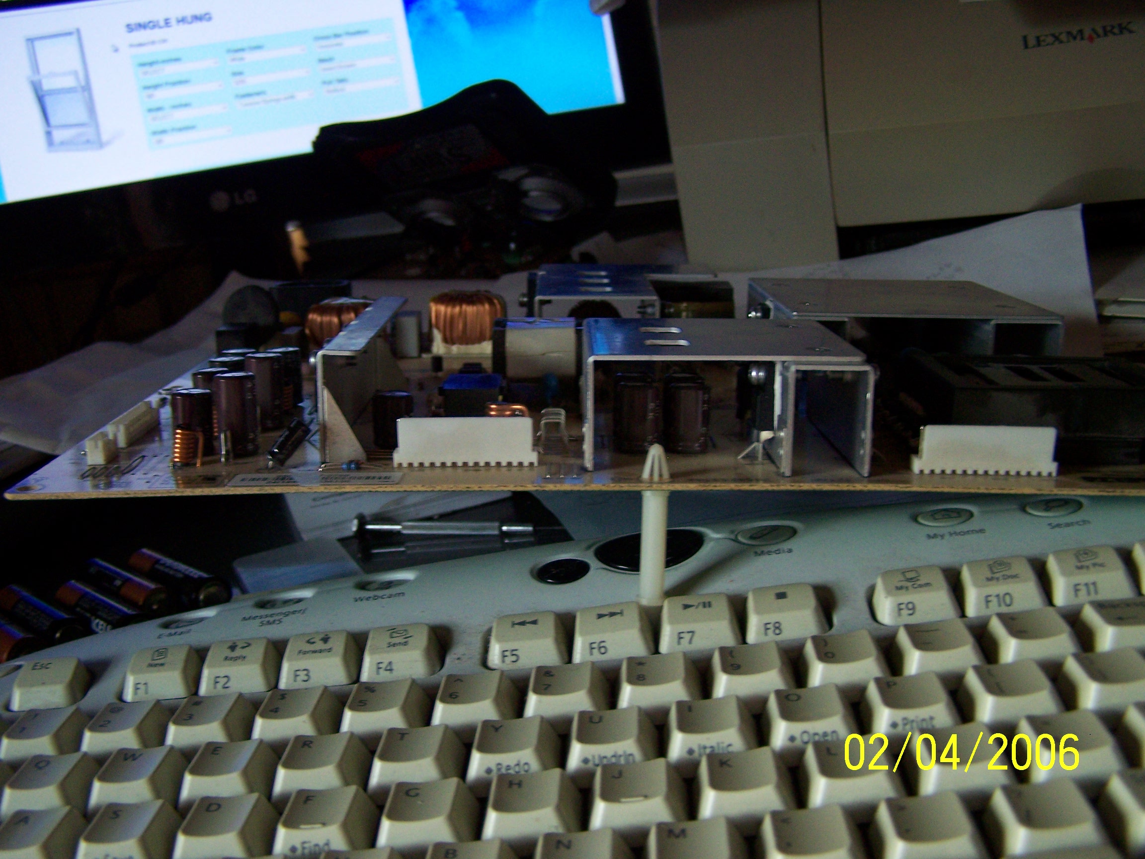

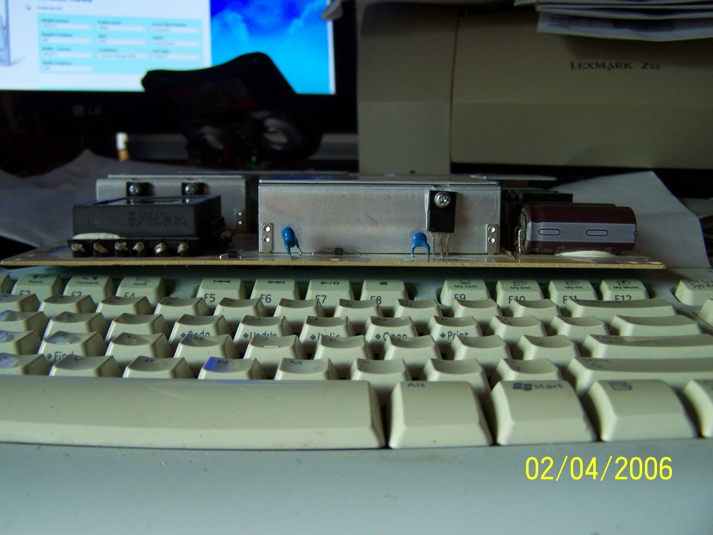

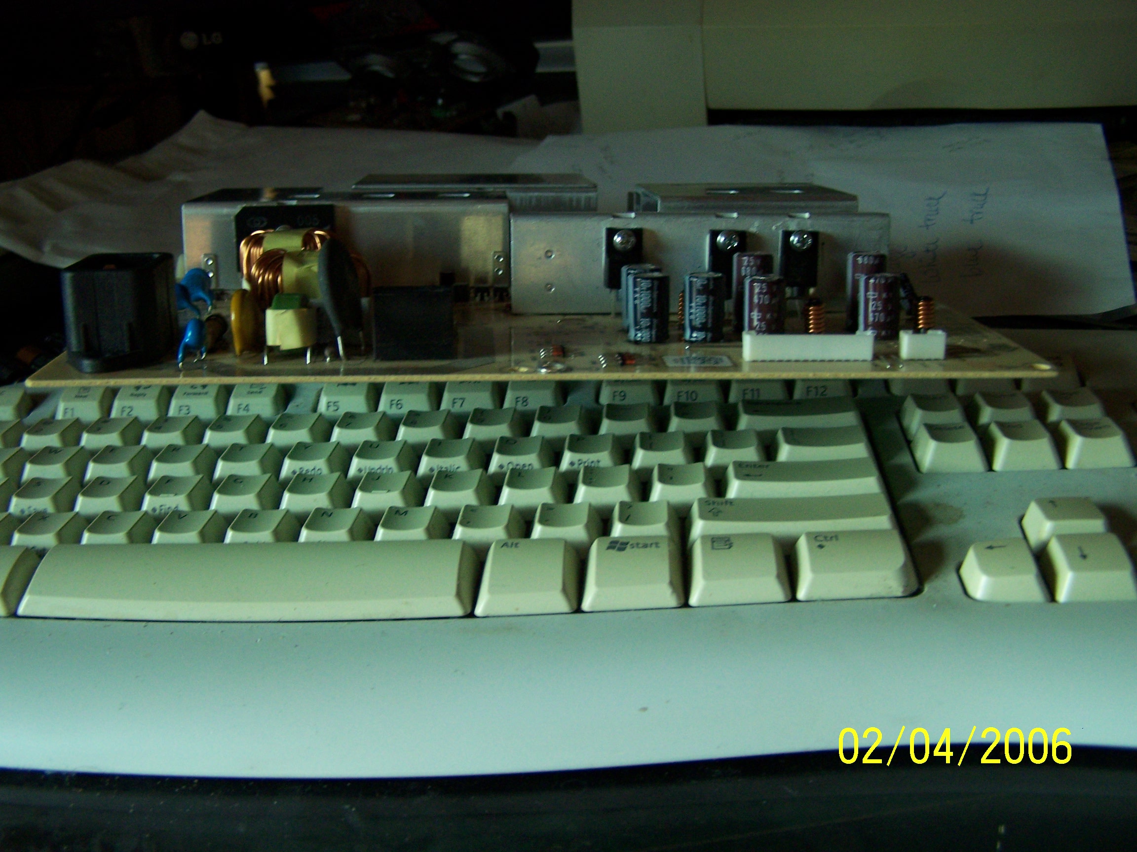

          As per request here are the pictures.
            Re: Vizio E550VL Black Screen/PSU
            "I look at the PSU resistors R304,305 and 308 only read 28 Ohm." They are connected in parallel so the total resistance is about 23 Ohms.
            So BOTH inverter boards are disconnected you still do not get 24VDC, right?
            Please check the DCV between the two legs of main filter cap C801A when TV is on to see if the Voltage is >360VDC.

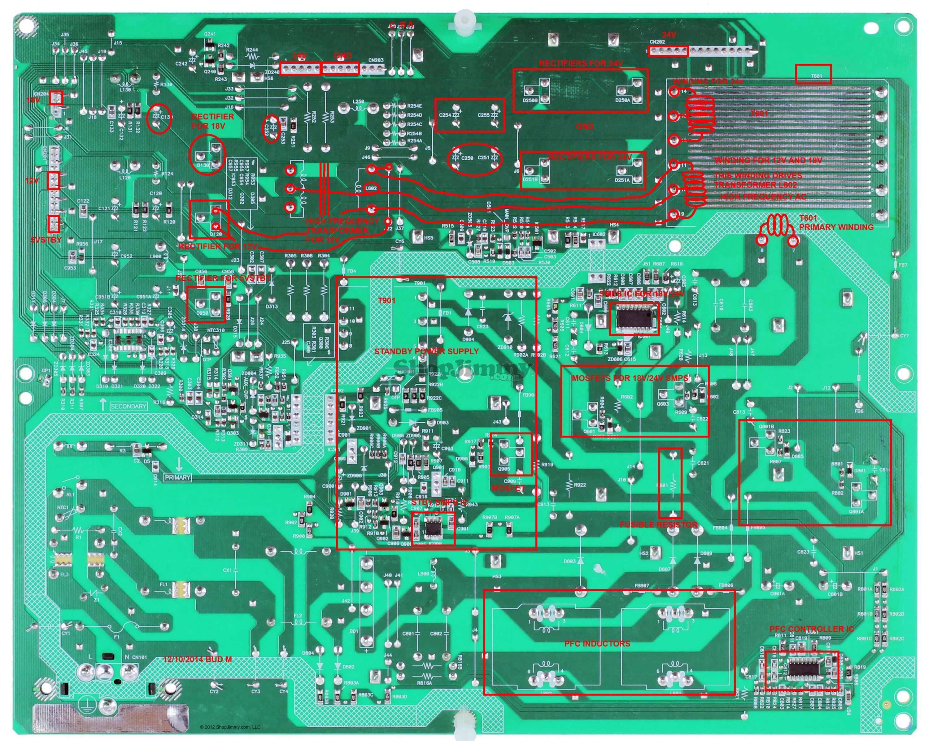

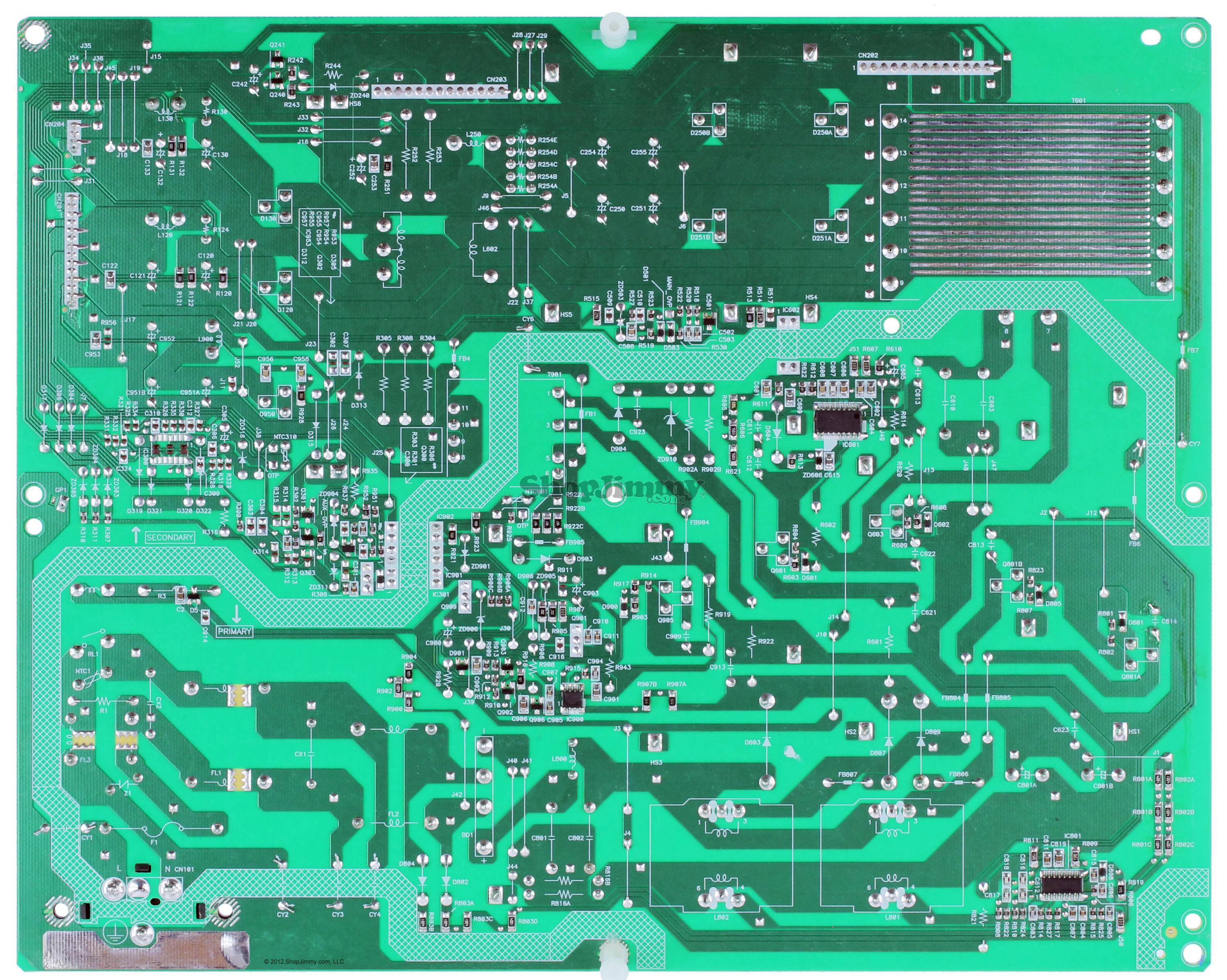

                        The white connector on the power supply board that goes to the main board has the pin labeled with name of the pin next to it, so list each pin name and the measured DC Voltage reading (when TV power switch is activated) next to each one.
                        See CN201:
                        http://assets.shopjimmy.com/media/ca...0790-top_1.jpg

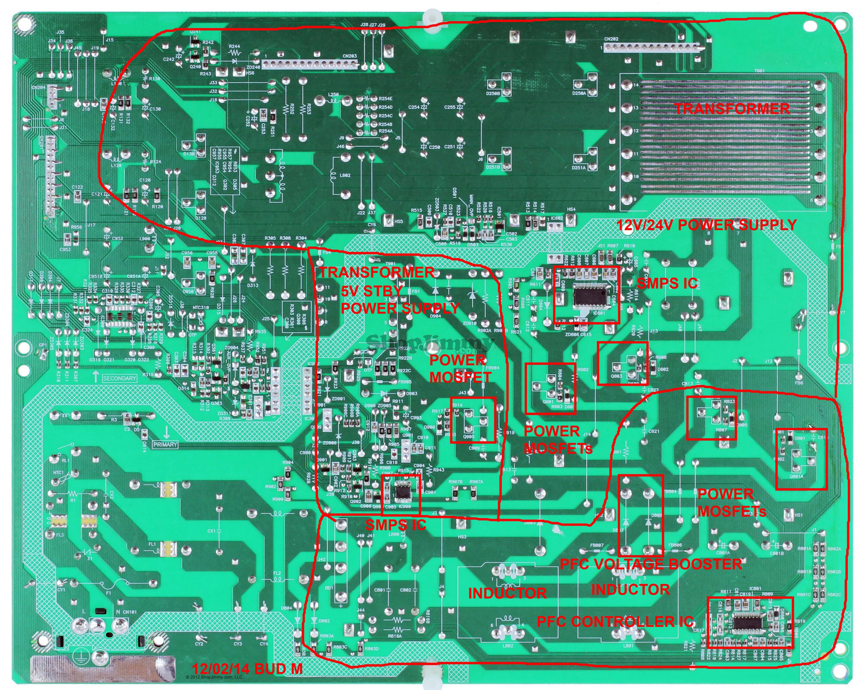

                              First off I will stay with this until the problem is solved. I will pull the board and turn it over and check the voltages as indicated on the traced picture. I have been checking all the voltages one the front side at the pins. Maybe I am missing something. Have a Happy Easter.

                                  Right now we are interested in the 24V power supply section without having the inverter boards connected to CN203, CN202. You just put the meter probe on CN203 PIN 1 (24vdc) and black probe on pin 7 to see what DCV you get.
                                  The boards will be mounted in place.
                                  And in what section are you checking the Voltage, the primary side circuit? the secondary side circuit?
                                  We also still need to find out why the PFC Voltage drops down.
