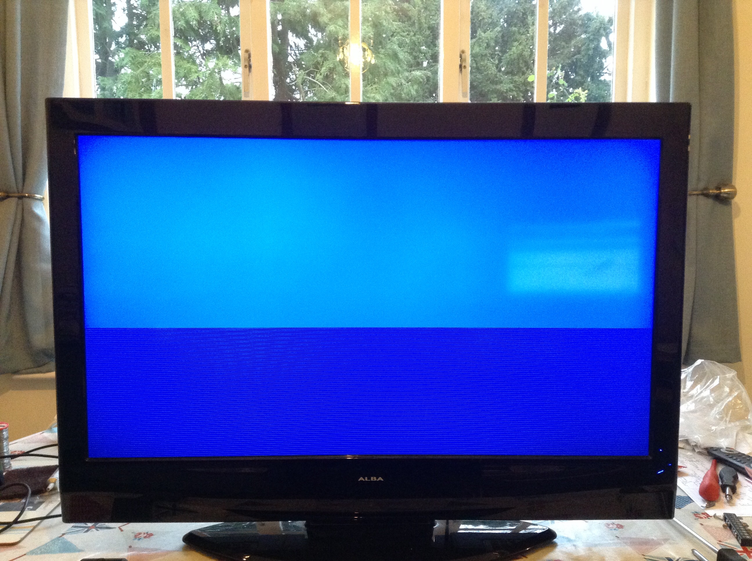

    I have an Alba tv which when turned on shows a picture but top half is darker than the bottom half which is lighter. Possible inverter?
    Re: Alba TV LCD32880HDF Picture issue
    Most likely it's a bad LCD panel unfortunately. Got a picture of the fault?
      Attached picture
        Is that an lta320ap06 lcd panel ?
                Yes it is the lta320ap06 panel
                      Them panels are pure junk seen lots of them fail, not worth replacing as the new one wont last long either.
