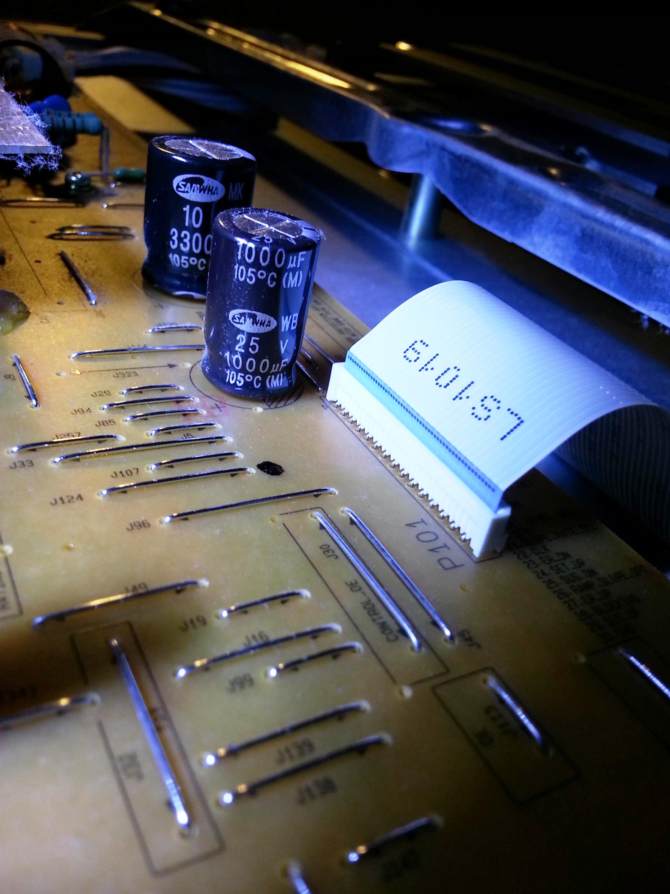

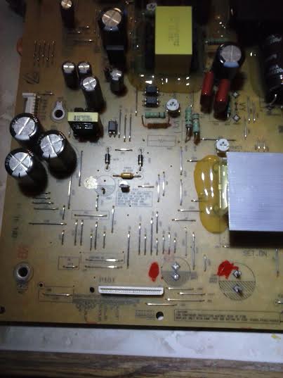

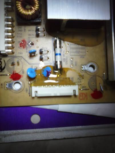

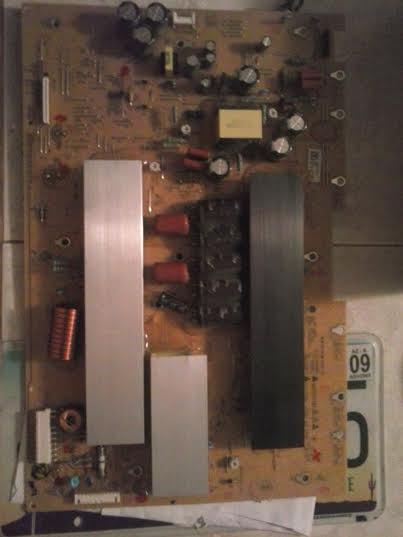

    I found this LG T.V on the side of the road with a free sign and could not help myself, the back was already off and most boards looked great but then I got to the Y sustain board and there was a couple CAPS ripped off and need help to find out what V and UF sizes were they?

    Re: LG 50PJ350 Y sustain Board HELP!!
    Ordered a New board, hopefully will see if it works.
      what's the chances of someone else missing the same caps asking the same question in BADCAPS, slim, very slim, or incredibly have?
      A search using the part number of the PCB yielded this.
      https://www.badcaps.net/forum/showth...ht=EBR63039801
      3300uf 10v, 1000uf 25v
        better check for shorted buffer boards before install,and bad ZSUS. search the model and you should find a post with the service manual which is not too bad for a lot of checks that can be done.
