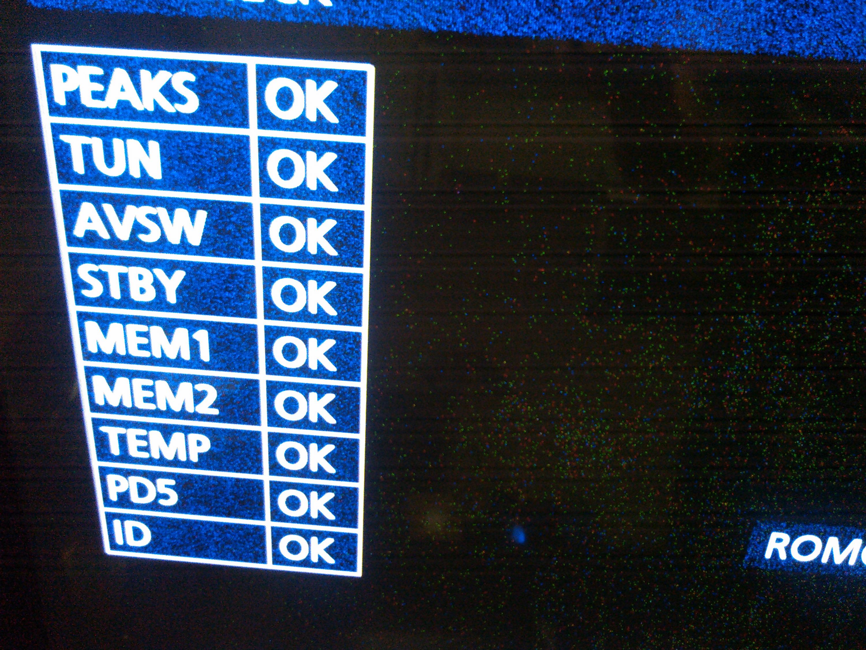

    Greetings! I picked up this tv with a 14-blink no power condition. After some research I decided to replace the SS board and rework the SN board, using the repair kit from ShopJimmy).
    Now the TV powers on (good), both green LEDs are on for both the SN and SS boards (yay), but the image quality isn't right (bad). Picture attached. You'll see colored, snowy pixels. I ran the self test mode and everything it reported was 'OK'. I can run any test patterns and access the service mode if that will help. I had to adjust many parameters - like R-cut, B-cut, G-cut, R-drv, B-drv, G-drv, etc because at factory values the blue pop-up windows were completely washed out white. At least now I can read the text for testing purposes.
    I've seen a few other threads having similar issues with Panasonic TV's and people suggested replacing and checking different components. I am electrically competent but don't have experience repairing TVs. I'm sure eventually I'll find shorts and replace the right component(s), but why reinvent the wheel when someone here probably knows right away where to look.

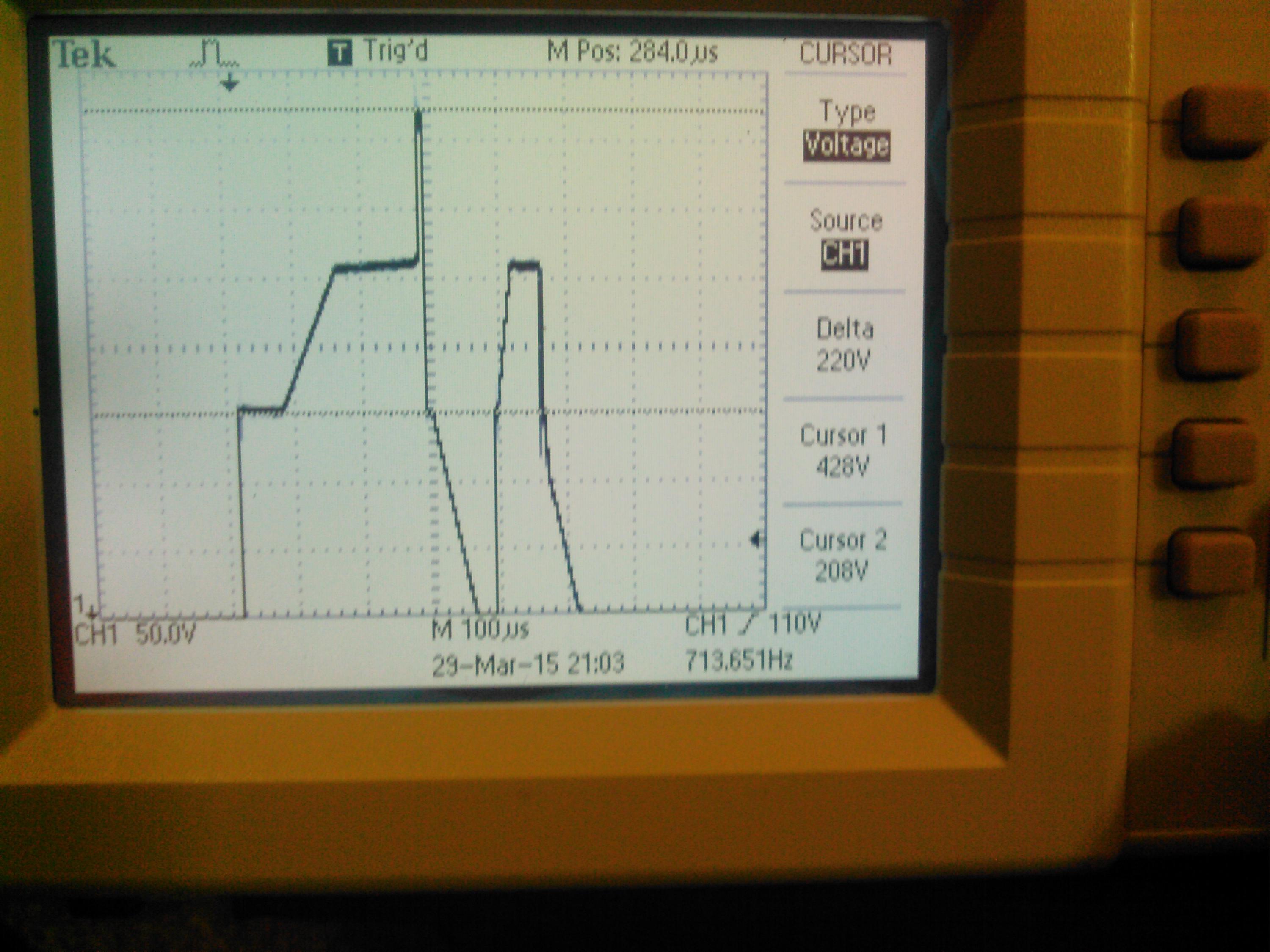

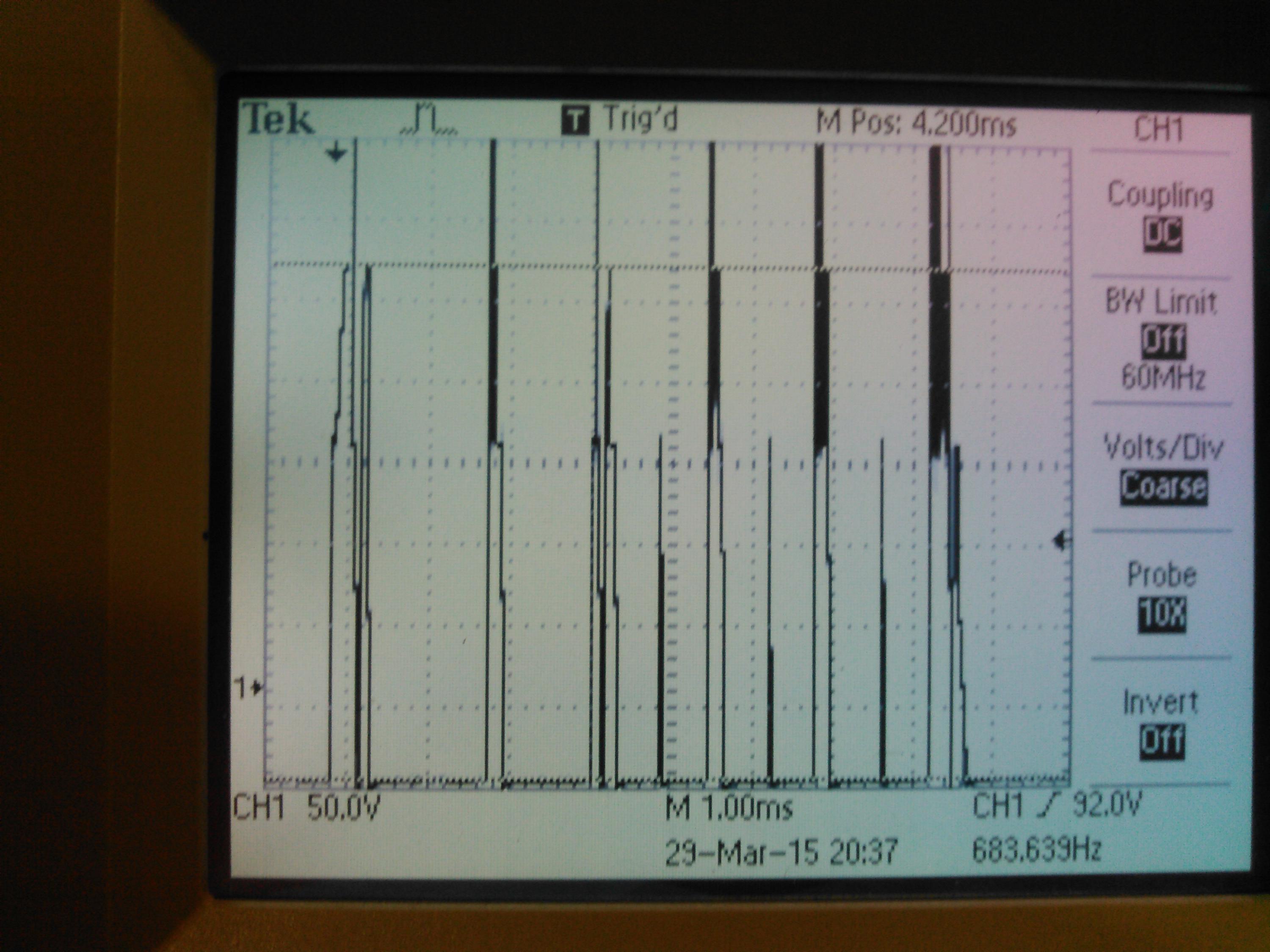

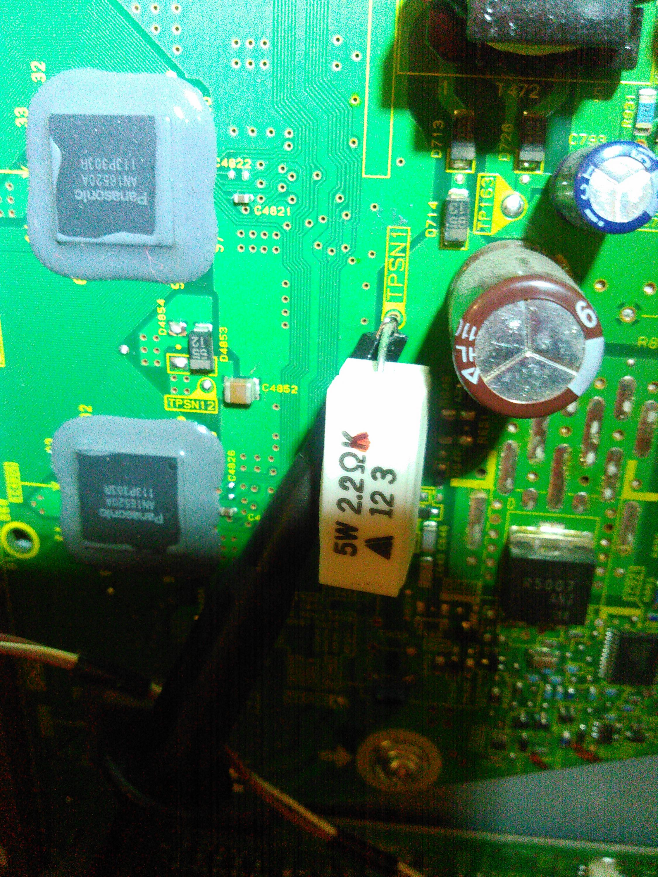

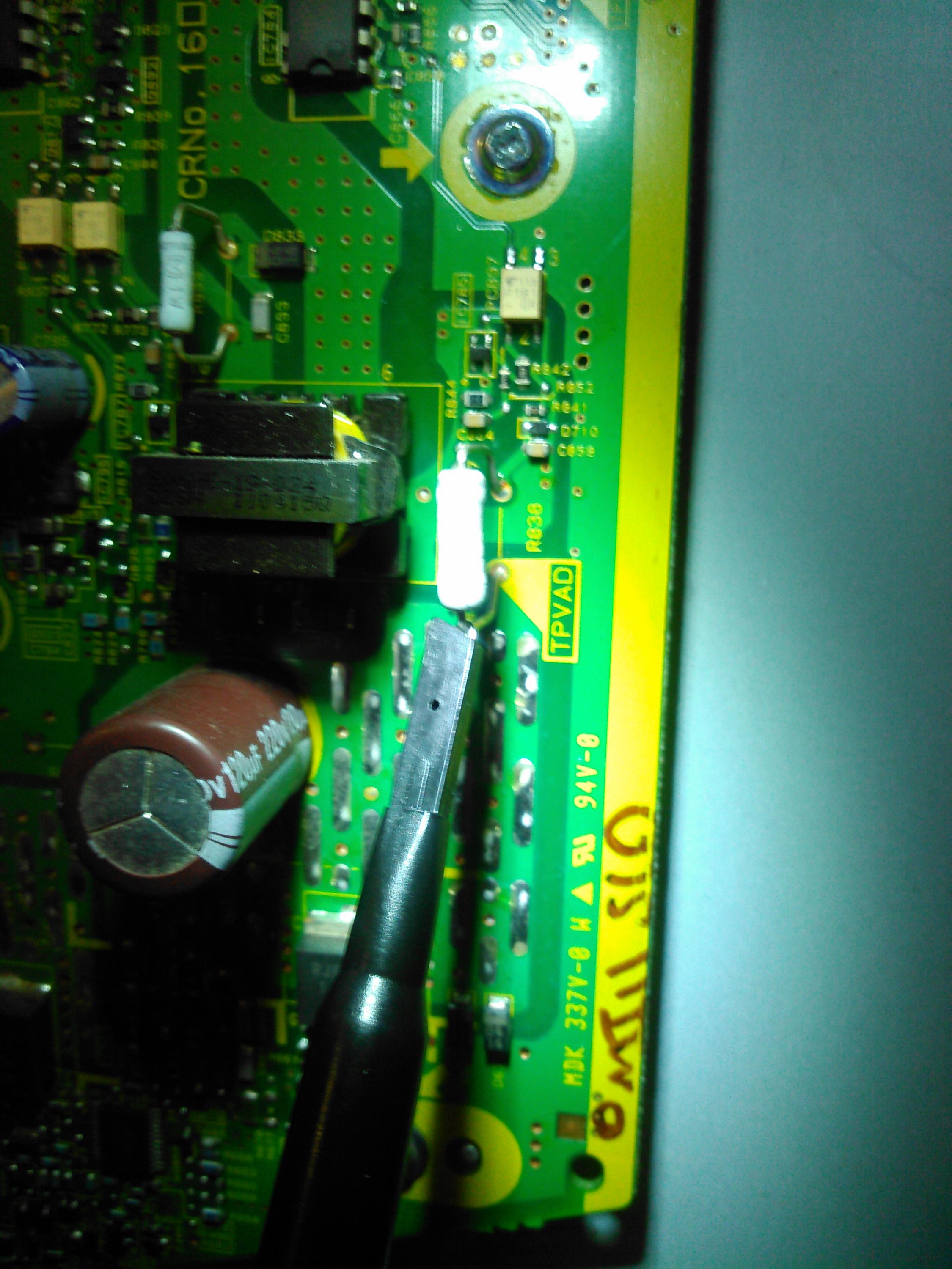

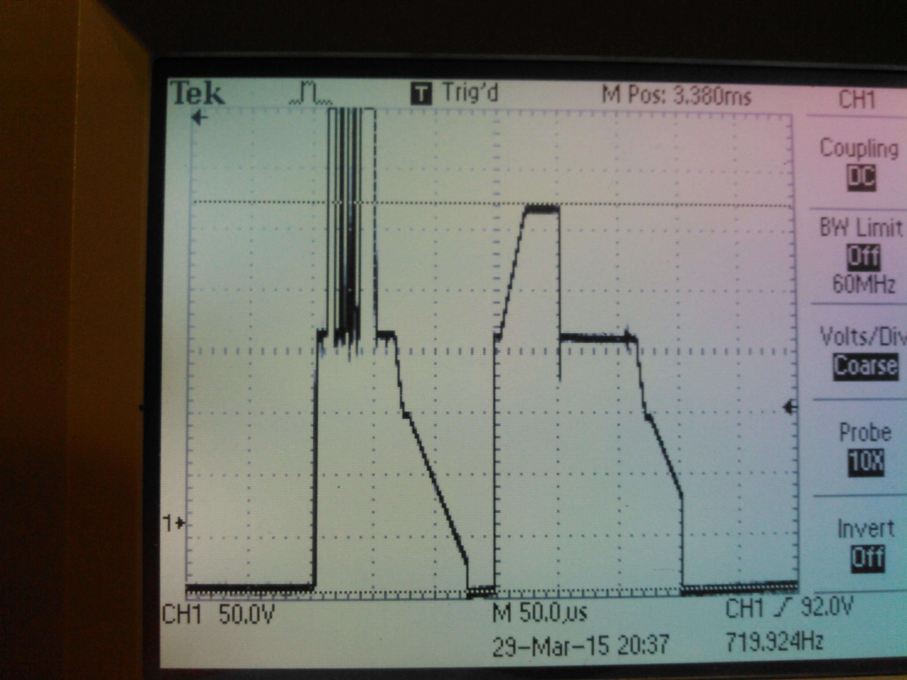

              I borrowed a scope and took measurements at TPSN1 and and TPVAD (probe points shown in attached images). On the schematic there are notes by TPSN1: "Reference Voltage Vscn:147 +- 3V" and by TPVAD: "Reference Voltage VAD: 205 +-5V.
              I do not think these test points are the reference voltages, as they have some transient activity (scope images coming, need to get them off of the scope). The schematics in the service manual have fonts so small they are nearly unreadable! Is there a readable version available somewhere?
              I'm going to try:
              1) Find the DC reference voltages Vscn and VAD and probe them.
              2) Find out what these transient signals should look like. What should I see at TPSN1 and TPVAD?
                Re: Panasonic 42" TC-P42S30 *almost* fixed. 14 blinks -> snowy image bad color
                On TPSN1 there are series of pulses that repeat at 60Hz. I'm measuring TPSN1 with respect to ground (using the P2 connector). The pulses change between about 3 levels (-50V, 200V, 300V, approximately). The series of pulses lasts about 8ms, then the -50V remains until the next period begins.
                Could anyone tell me what I should be seeing here? I've read a little bit about how the pixels are reset and cleared, but I have no idea if this waveform is bad or not.
                Or maybe that IS the problem - TPSN1 should be a DC voltage Vscn, and obviously it is not on my tv.
                I'll post my plot from TPVAD shortly.

                  TPVAD has similar looking pulses. I'm attaching a zoomed in image. Does someone have reference waveforms or could someone describe what they should look like?
                  BTW - Vsus is clean at ~215V.

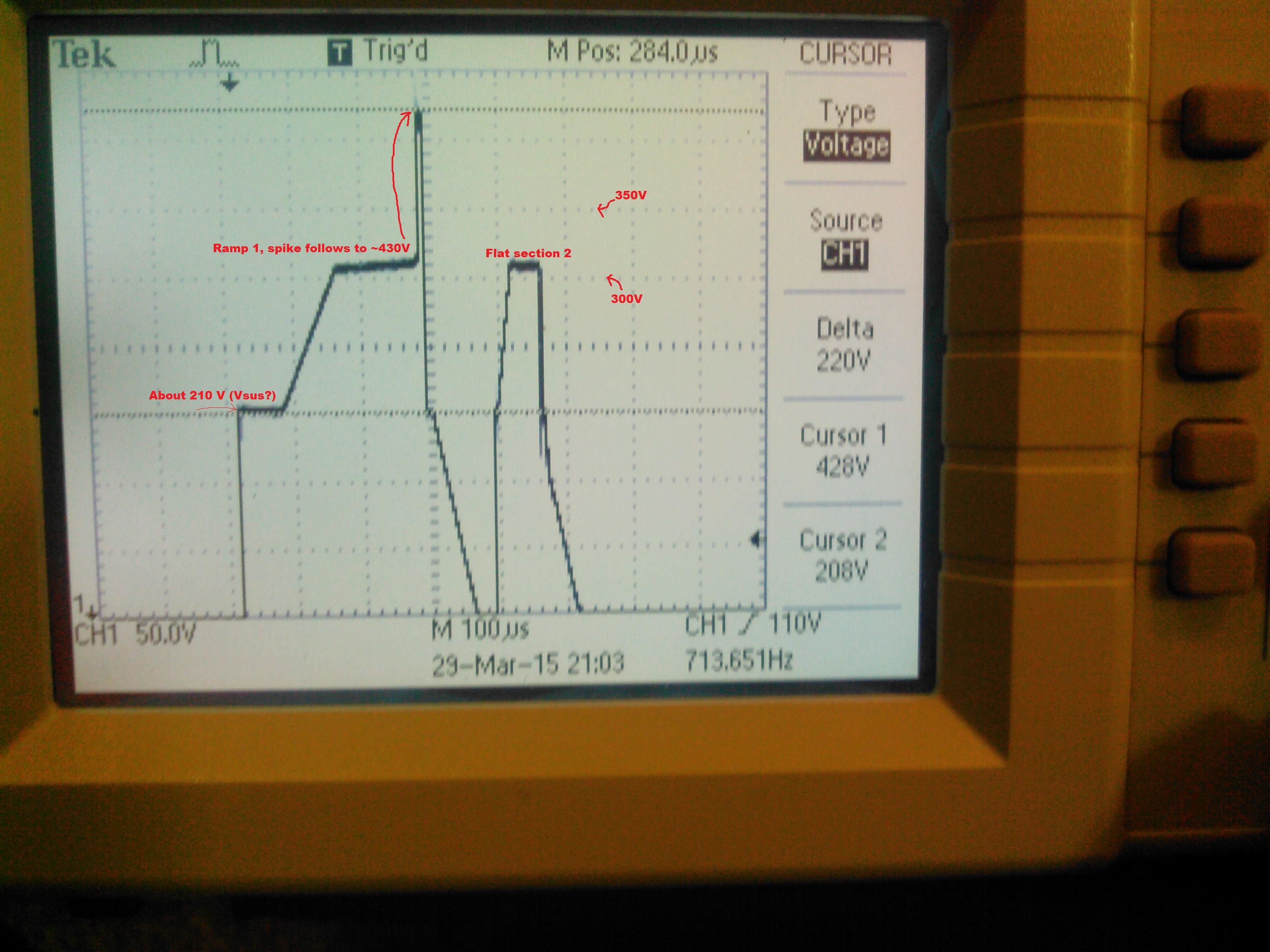

                      Looks like your set-up ramp is truncated. The flat portion with the end spike should be a slow ramp up to Vsus. Same for follow flat portion. Low Set-Up will cause a distorted, underdischarged image.
                        I annotated my original plot since the voltage scales weren't well labeled. Could you point out the ramp you are referring to? The waveform begins at a negative voltage (maybe -50V, I don't remember exactly) and then pops up to ~210V (Vsus I assume). Then there's a steep ramp up to over 300V, followed by a shallower ramp before a jump up to ~430V. Then it drops to Vsus before starting a negative ramp down to -50V again. If you can draw on the picture that would be very helpful.
                        If it's a timing issue maybe a bad cap is shortening the ramp. I'll have closer looks at the schematics.

                          You're probing the Vscan output which is about 150V above the Vfg output (it's exactly Vscn above it.) So, subtract 150V from that. Your wave will start at -200V, and should go up to Vsus in a single ramp. These Panasonic sets do not have a Vset ramp that is greater than Vsus, they keep the whole set-up portion below Vsus.
                          The flat sections are the problem, as you've highlighted. Panasonic appear to use the SUS IGBTs to finish off the waveform - that part is working. But the FET/IGBTs that do the ramp up portion are not working for some reason.
                          Basically, output can be in three major states: -Vad (-190~-200V), GND, or Vsus (~210V) or it can be ramping between them. Note that it's a coincidence that Vad ~= Vsus on this panel; other panels are different.
