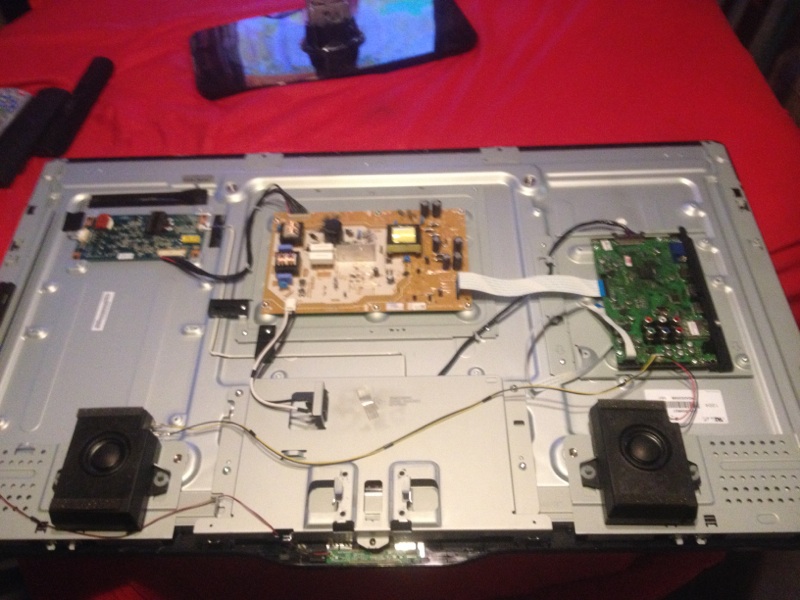

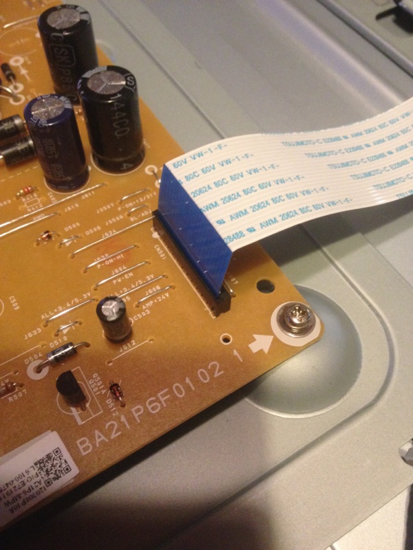

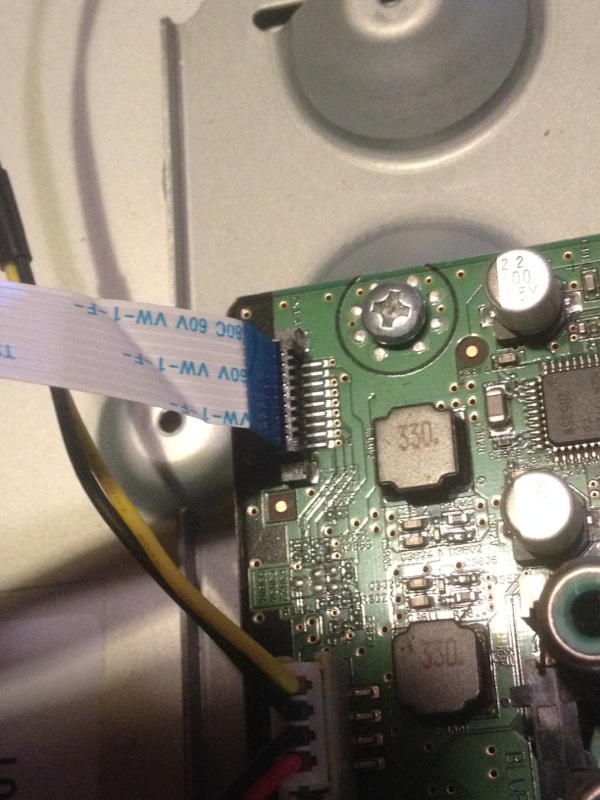

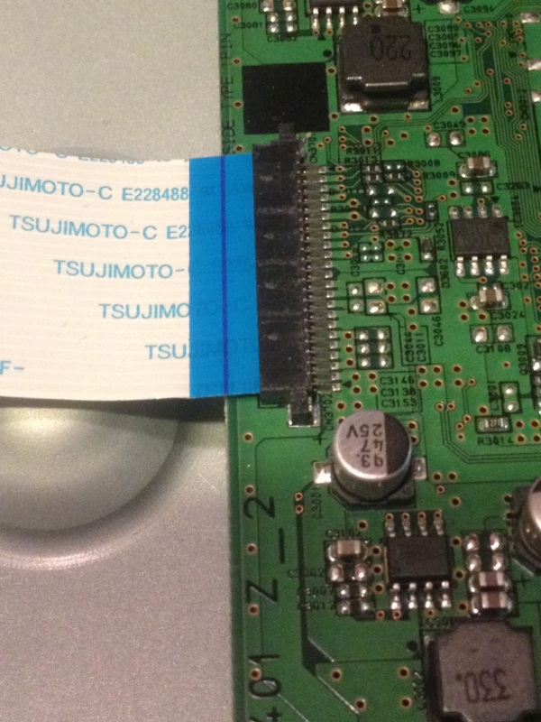

    I've got a 40PFL4707 that was dead, so I replaced the power supply that didn't fix it. I got the new one, that did not fix it so I checked the pins on the ribbon cable where it connects into the main. It had voltage on and on the board. So i ordered a main board and installed the damn thing still don't work. it. Does anybody have a schematic for this tv? I need to confirm the voltages going into the main, and from the main to the ir board. Any help would be greatly appreciated!

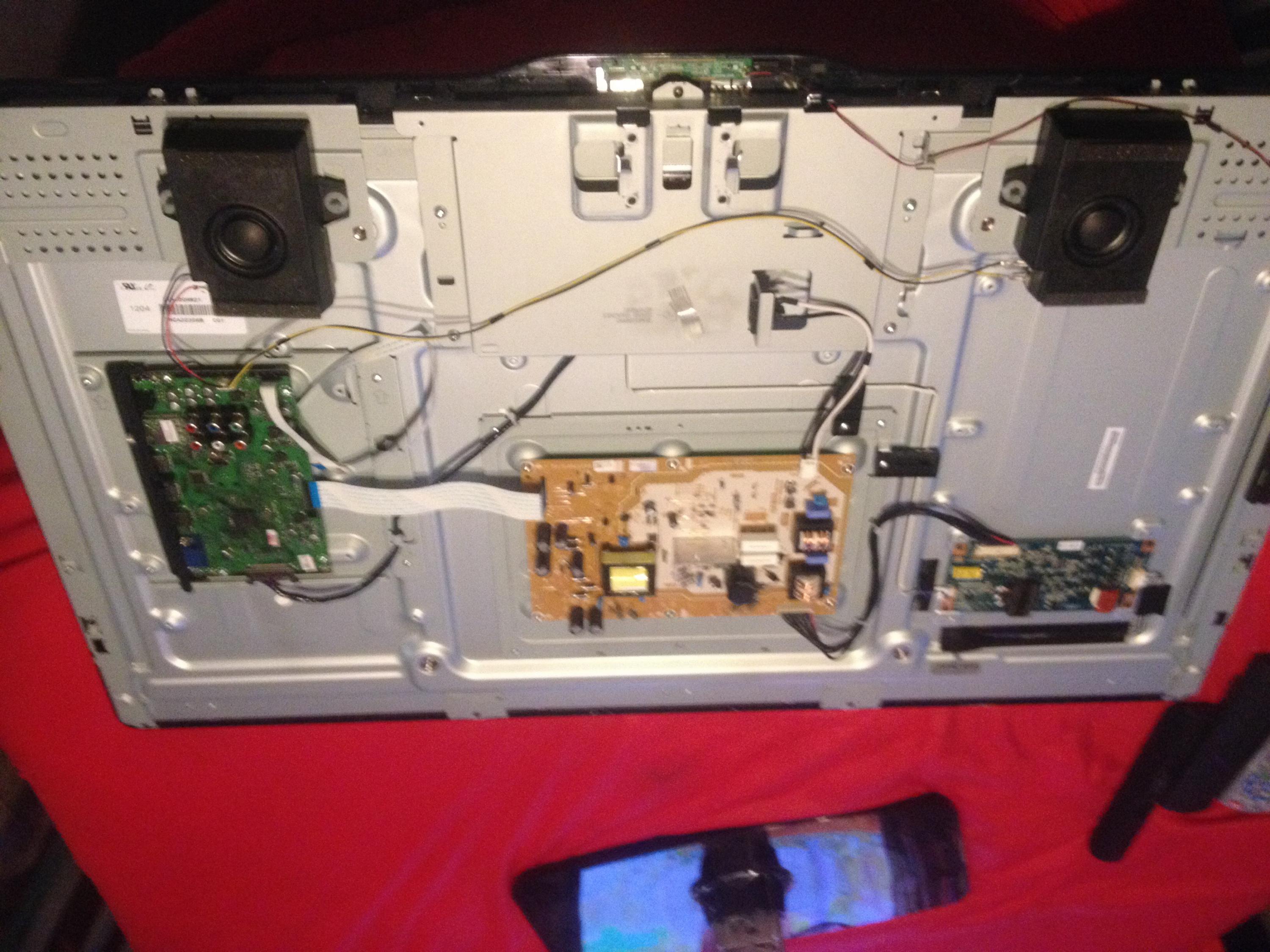

        Any good clear pictures of the whole back side of the TV to show all the boards and how they are connected together? That will be a start.

          Re: Philips 40PFL4704 dead
          Hello Bud! I will post those shortly, I have to do it via iphone :-(.
            Here are a few pictures of the set and it's questionable ribbon cables.
              Pictures for everyone to review.
                  This looks like 40PFL4707. I am working on repair of this TV for last 4 years now . Its become my favourite past time hobby. Incremental progress.
                  If you find source for these ribbon cables, do let me know too.
                  Here are my suggestions. Look at my thread. I have attached service manual for this TV. You should check following voltages
                  AL+3.3v
                  LED+24v
                  P-ON+21v(12v)
                  Pin 3 of IC3008, IC3001, IC3003
                  Also check the voltages on CON3 on LED driver board for LED-1, LED-2, LED-3,LED-4..it should show around 11v
