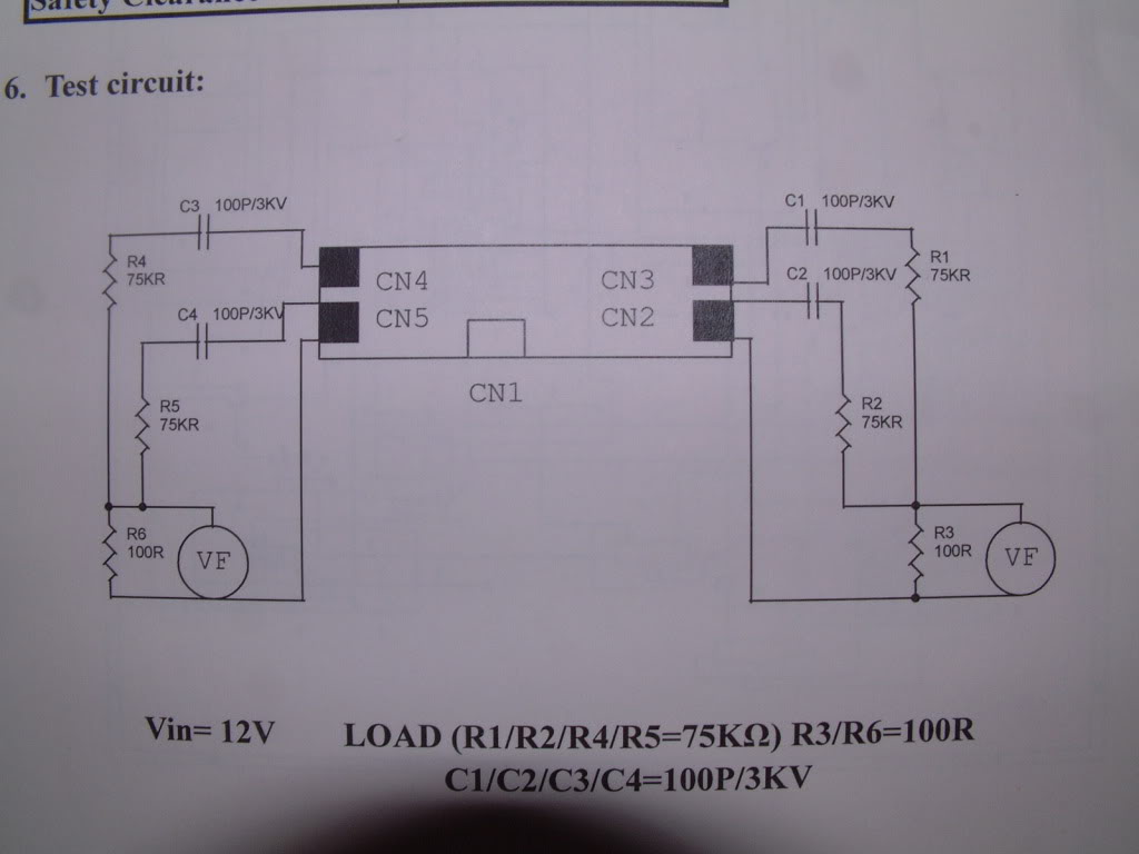

            Re: SHARP LC-37D65 CCFL Inverter dodge to test....
            Measure Voltage drop of the sampling resistor and then calculate the current.
            The 75K is for the lamp Z simulation. 4 sampling resistors if you want to test each lamp.
