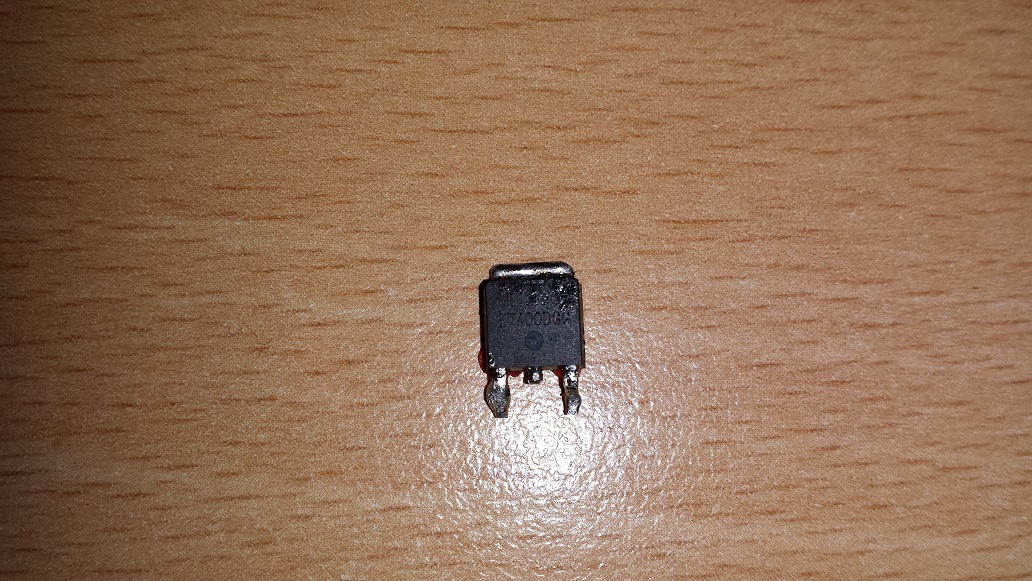

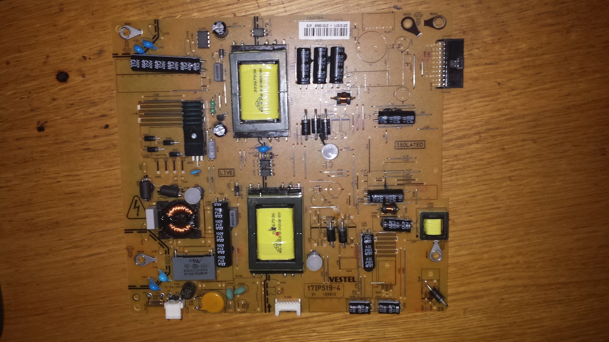

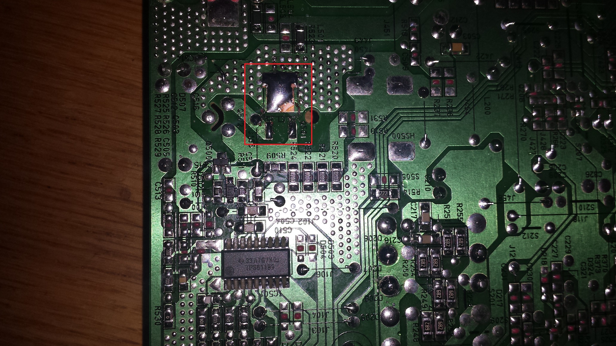

    So, this one turned up on the bench. Power light flashes, but the set won't power up. It's stuck in standby. Now, I would have thought that the main board had corrupted firmware. But, somewhat surprisingly that was not the case.
    There are two faults: the main issue is the 17IPS19-4 power supply 24V isn't coming up, which is due to a FET and diode in the boost converter being shorted. Naively testing the commonly failed diodes (on the output) would lead you to suspect the diodes were shorted - but they aren't. Surprisingly, it's the diode on the output of the boost converter which is short. But, this alone wouln't account for the short on the 24V output - it would just prevent the LED strips working, the TV should still otherwise "work".
    What's happened is this diode being short appears to have damaged the main boost FET for the boost stage (this is all on the secondary so no blown fuses or damage to the primary.) The boost stage takes the ~24V and boosts it to about 60-70V for the LED strip. This is shorted, preventing the 24V rail coming up, and the main board detects this fault and shuts down.
    So, removed the FET and diode and sure enough now the TV turns on, and you can see a (non-backlit) image on the screen using a torch. So the set appears to only have a PSU fault. I will replace the FET and diode and see if the problem is fixed.
    The only major concern I have is if that LED driver IC has been damaged (TPS61199); the FET has around 130 ohm gate-drain and gate-source (with 5 ohms drain-source) so I *think* it's going to be OK. I ohmed out the gate drive to Vcc and ground and it's about 2k to each so it doesn't look shorted. The parts are cheap so I'll just try it and see what it does. Worst case, the FET blows up again, but it's not expensive.
    These power supplies, whilst cheaply made with the cheapest off the shelf components, don't look TOO bad, especially when you compare them to a PW25-4.... frankly, I'd take a million of these over a single more PW25-4...!

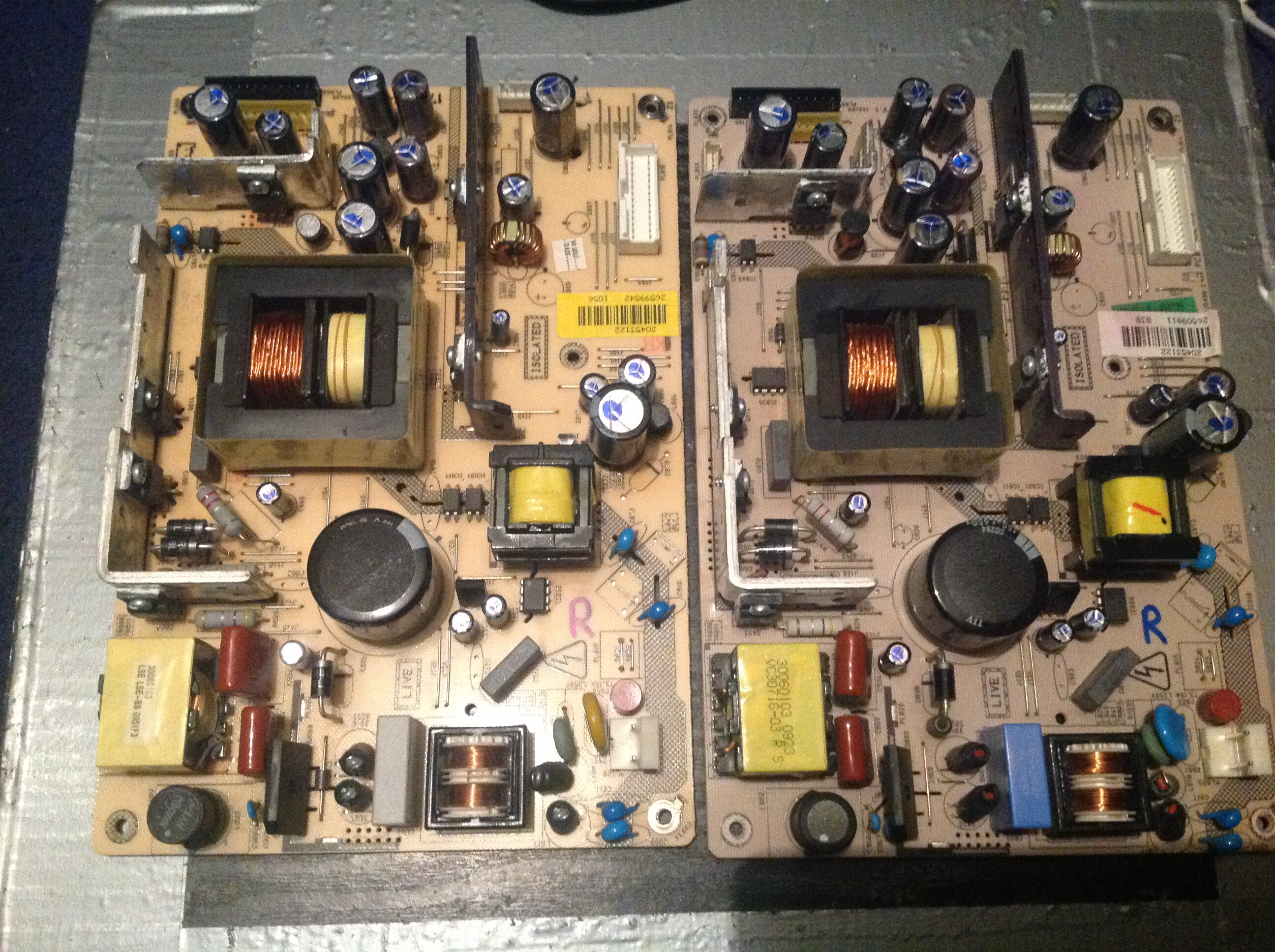

    I just recapped two 17pw26-4 that had blown samxons and the one on the right had a blown diode that was causing the 24v not to come up, thanks for the info Tom.
    Dont ask why im wasting good caps on these just dont have any cheap caps in stock, caps used panasonic, rubycon, chemicon and nichicon.

        Vestel are great at blowing diodes, the newer led ones are the worst they make the 17pw20 look well built such a shame so many people will have brought these junks becuase of the reduced prices.

                    TV is fixed.
                    So, the Vestel schematic is wrong again (wow, what a shock!) They suggest using a 30V MOSFET (STD17NF03)... but after blowing up two FETs I realised that obviously, a 30V FET in a circuit with a 65V OVP threshold would not work. I think it's another case of the Vestel CAD engineer being too lazy to spec in the right FET, publishing the schematic and then changing it before final production.
                    I found a compatible FET on a scrap Sharp inverter (2SK3706) and was able to fix the TV. This FET is 80V rated so should be OK. The LED strip voltage is 56V in this nameless panel (can't find any info on it) and it has four terminations into the TPS61199 IC.
                    Why do people buy these shitty £160 TVs? And then why do they wonder why they die?
