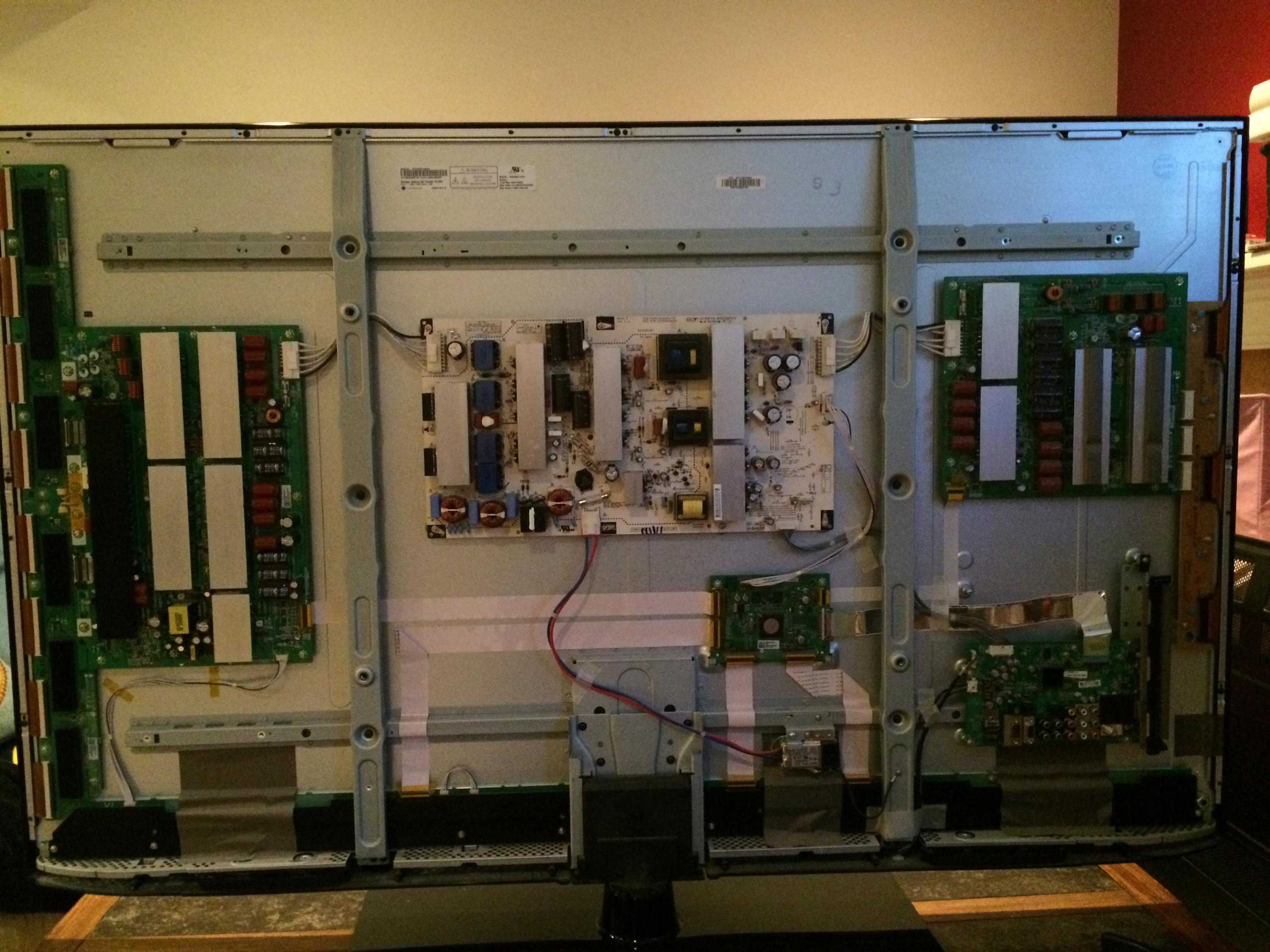

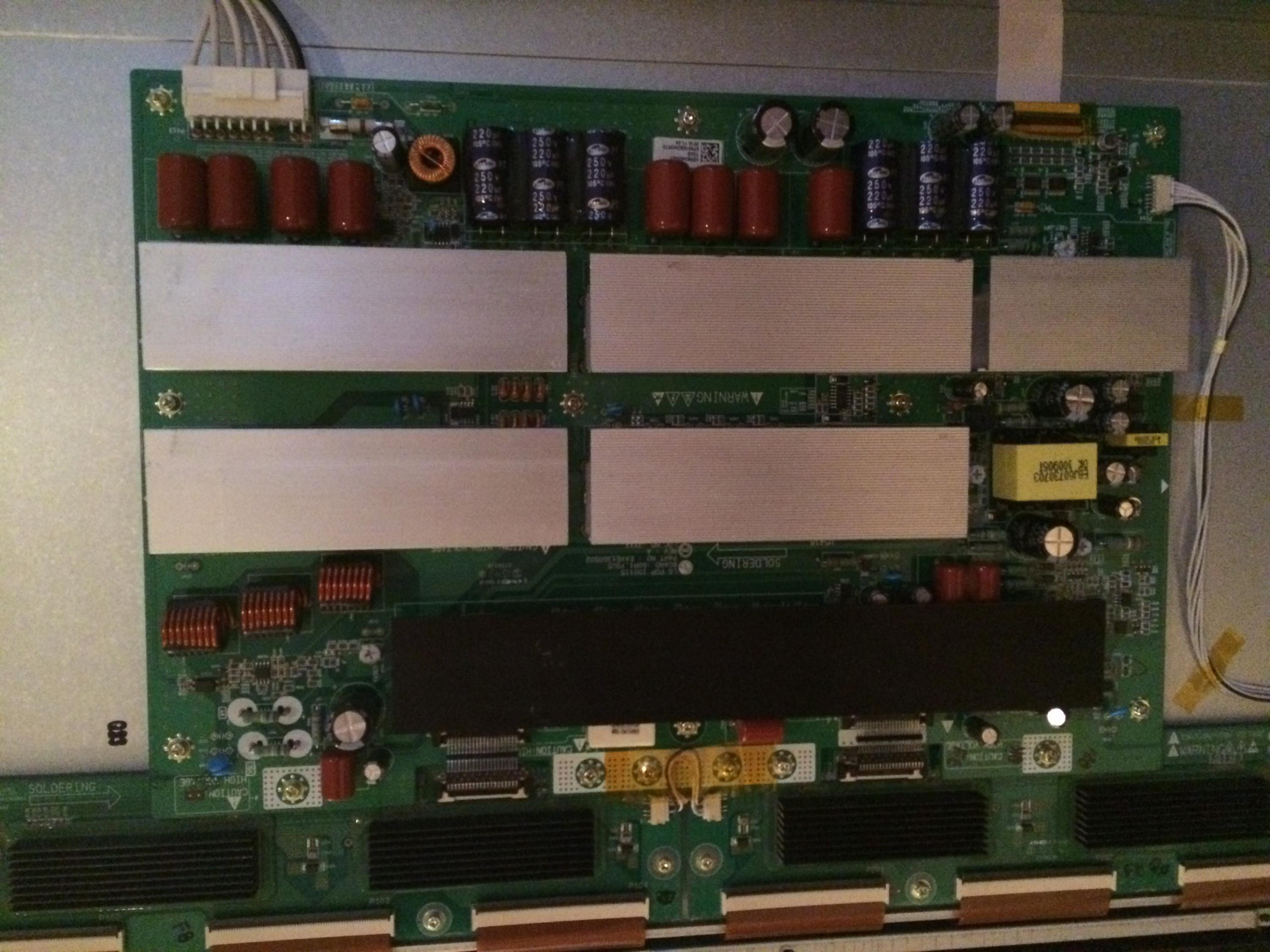

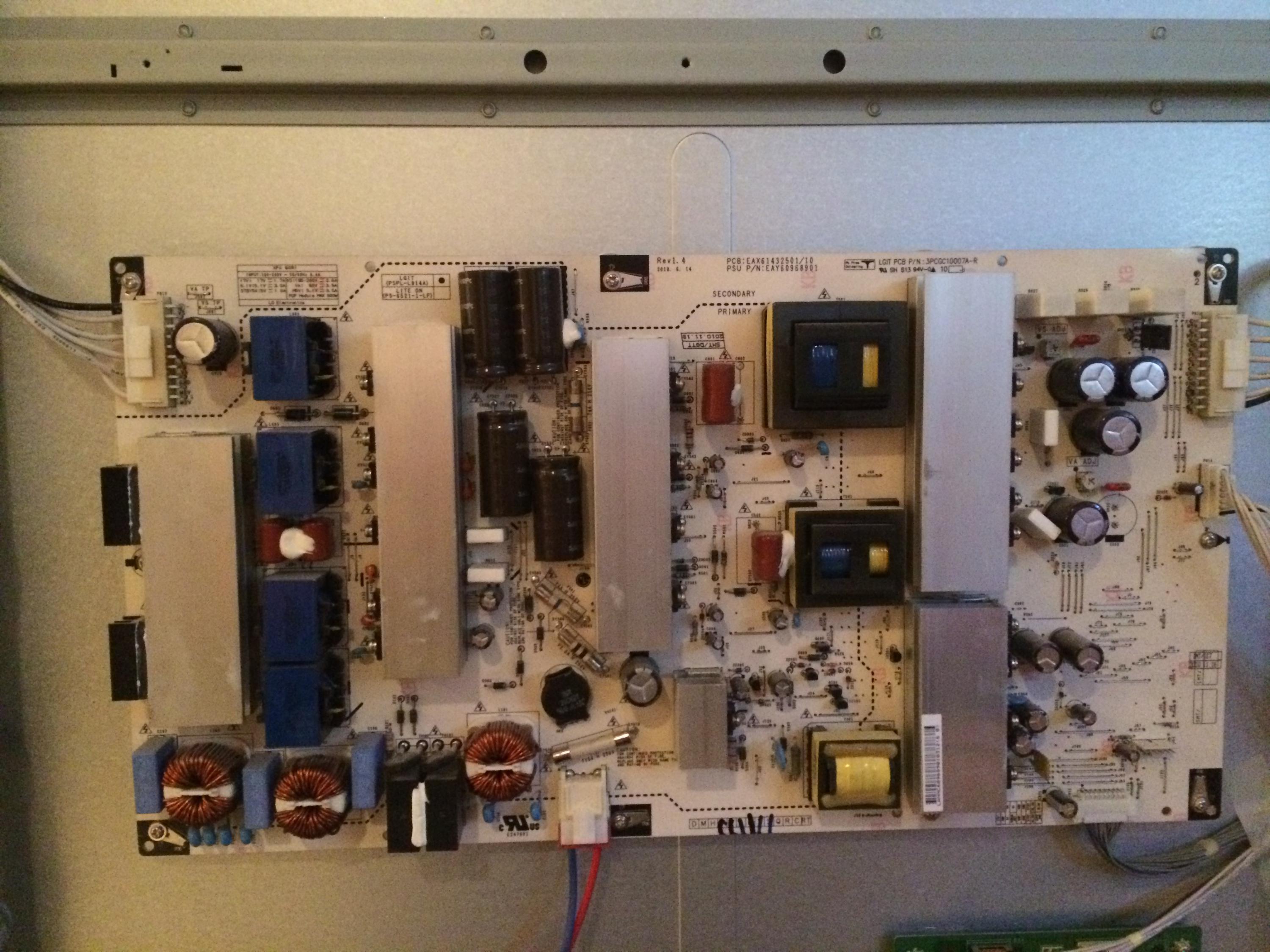

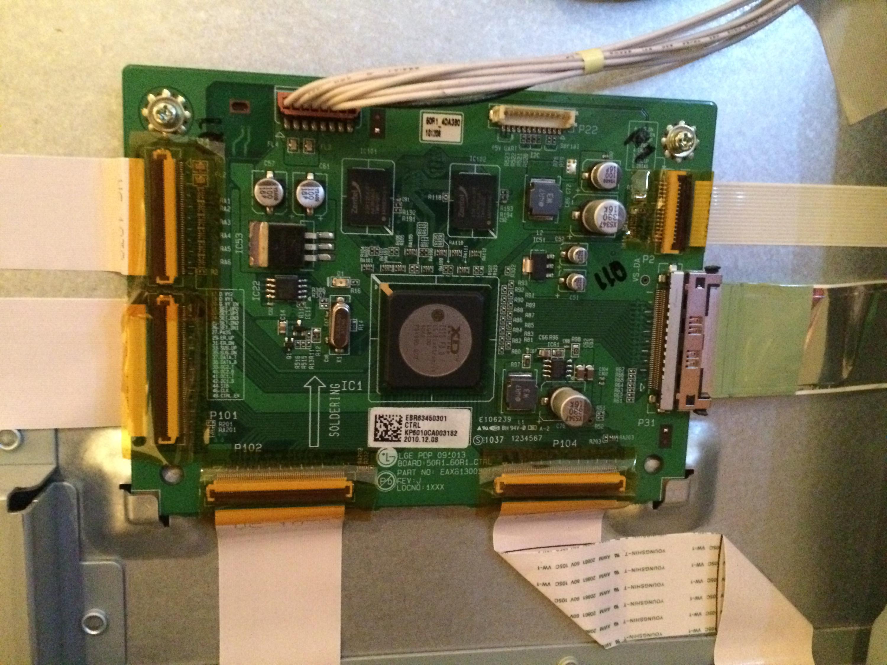

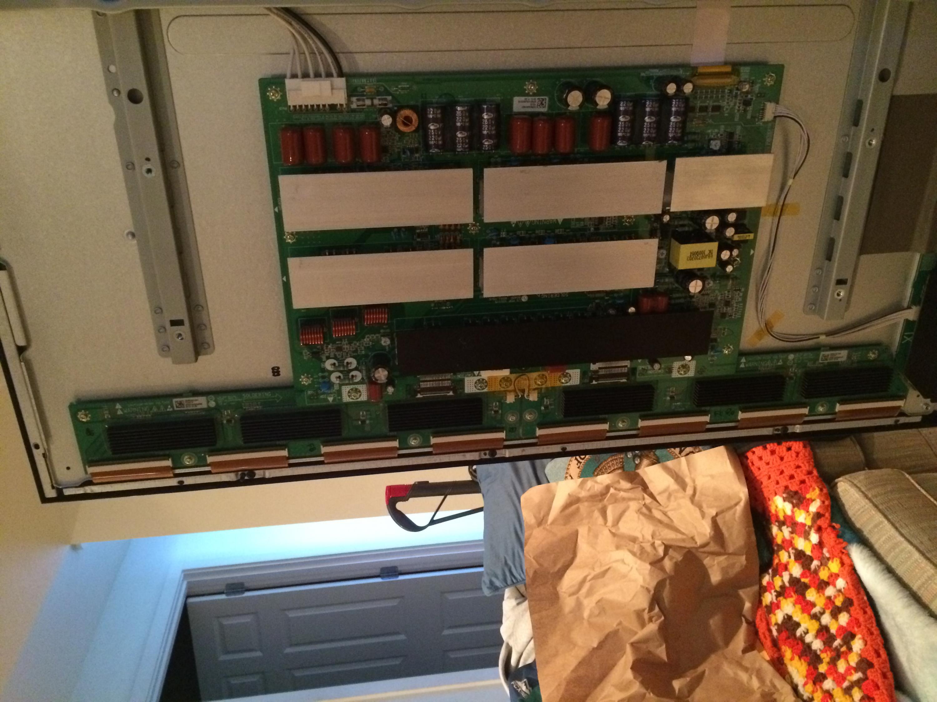

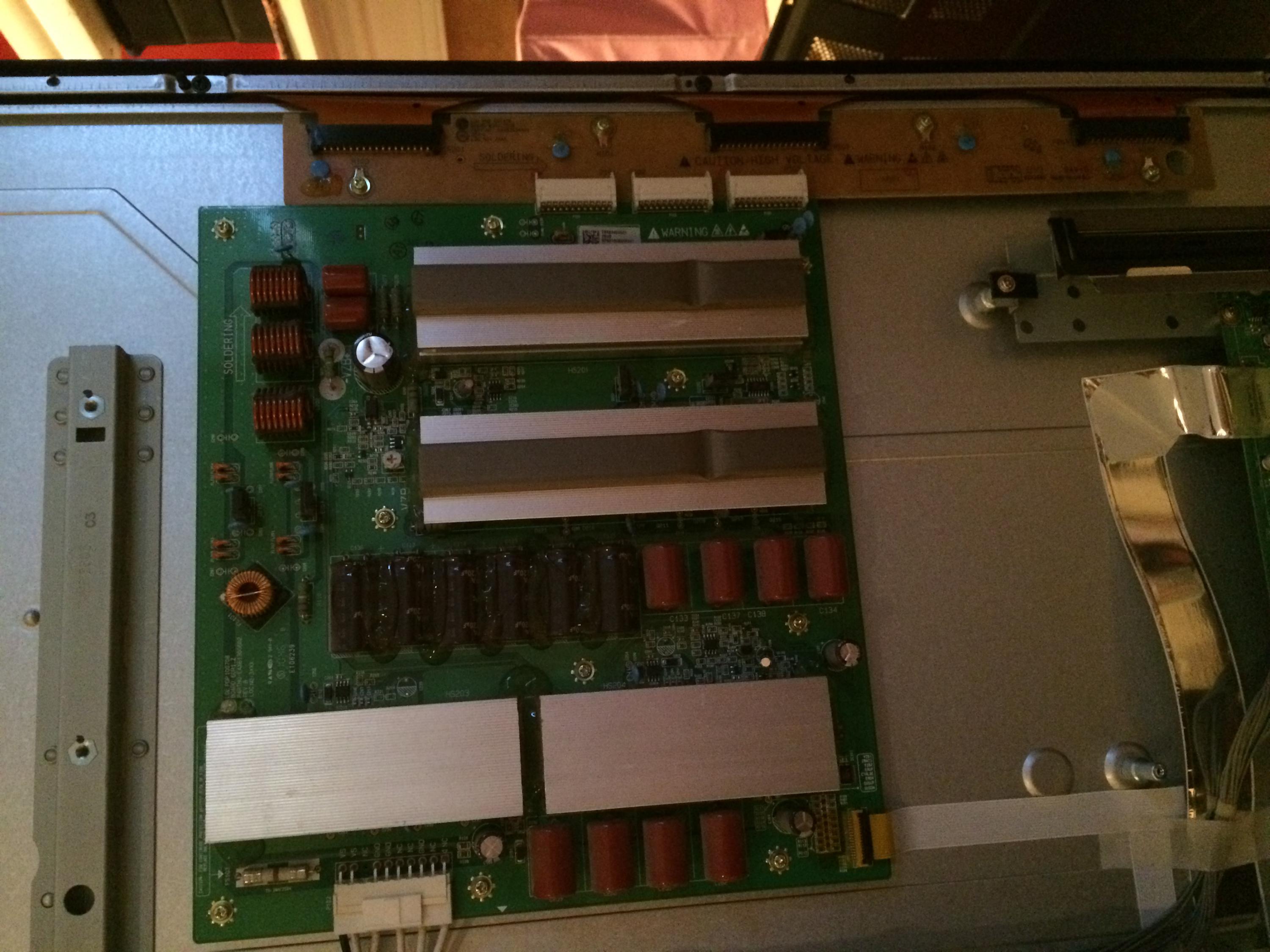

        I can't take pictures of the lines since i can't get the picture to turn on. Here are photos of the entire back, and close ups of the boards. Hope that helps.
        I only know basics about electronics so I don't know how to check the voltages, I do own an digital multimeter I just don't know how to use it.

            Re: LG Plasma Model 60PK550-UD has sound but no picture
            Well I have replaced the power supply board now also and I still cannot get a picture, only sound.
                I had one of those, bad logic board.
                    Is the logic board the same as the control board?
                    • PowerAmpFreak
                      • 977
                      • Sweden
                      Yes, the smallest board with the fastest brain
                      • jlbarsness
                        • Mar 2015
                        • 9
                        Well some good news, I replaced the control board and I have picture again so that issue is fixed. I still have the random green vertical lines, there is only one now it is on the left side of the screen near the middle.
