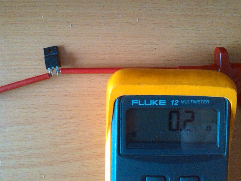

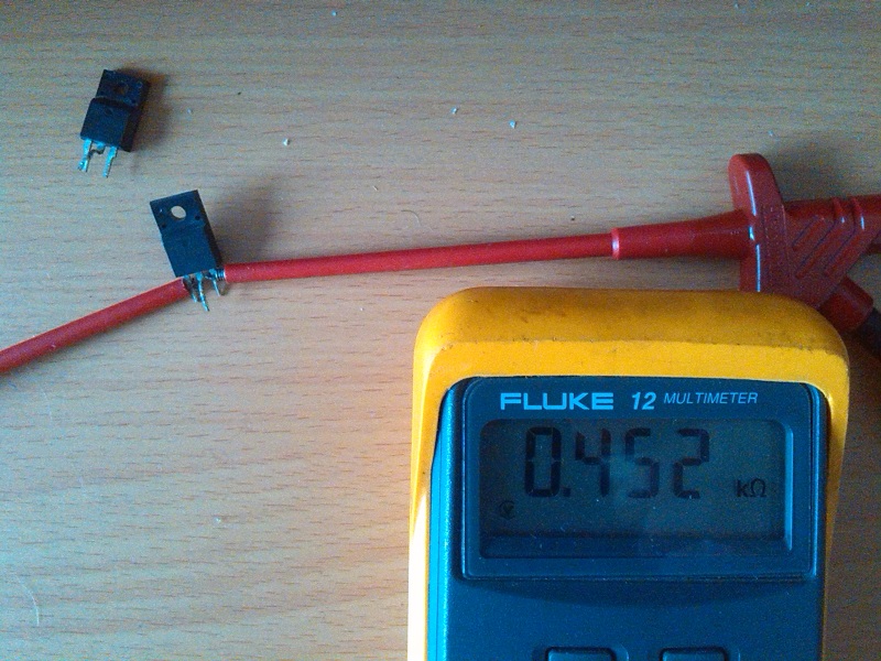

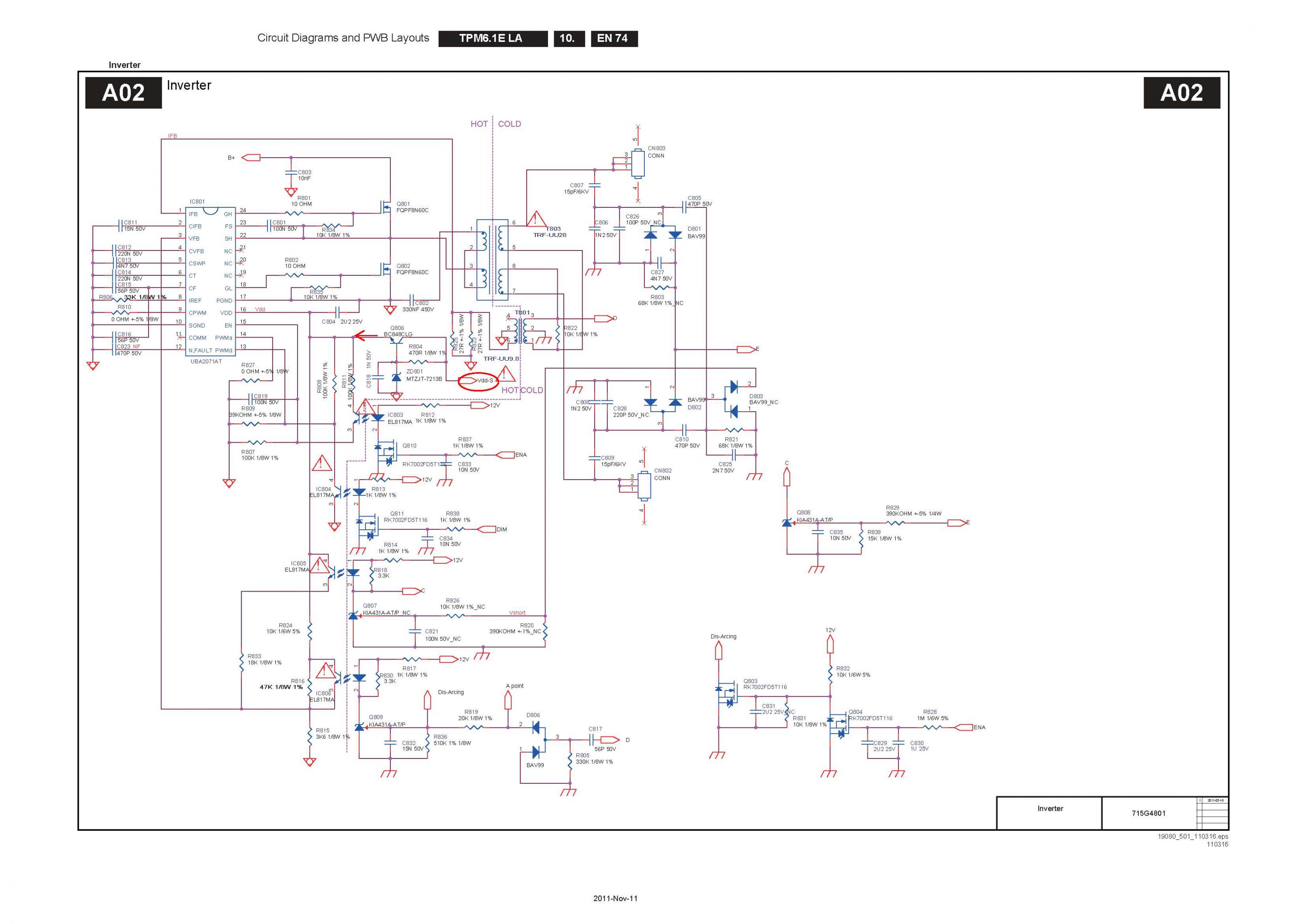

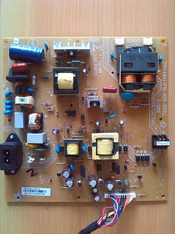

    Problem with Philips LCD, fuse is out and one of the inverter mosfets is shorted.
    Is this a case of poor power supply design allowing the fet to fail do to use of the lcd or is more that I have to check?
    Type fet this http://pdf1.alldatasheet.com/datashe...D...F8N60.html

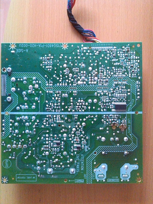

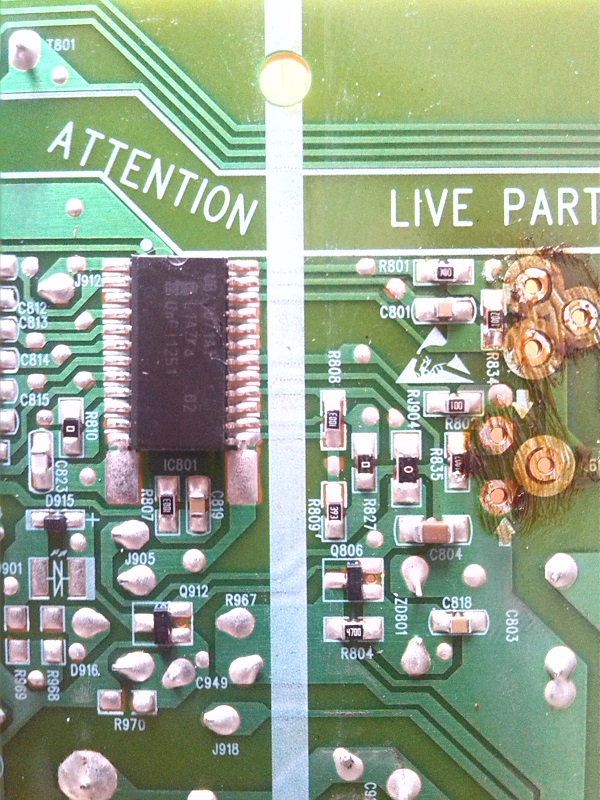

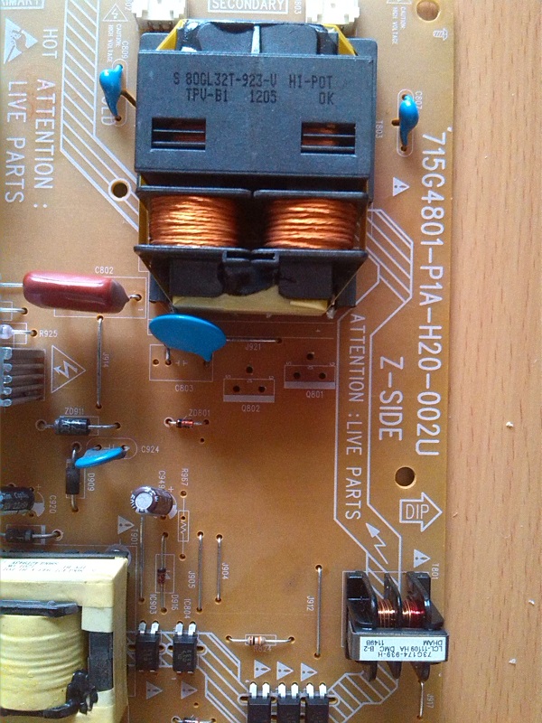

    The board looks a little brown under the inverter transformer, should remove and inspect the transformer, this can be due to worn out lamps or just worn out or under rated transformer.

      Mosfets are replaced and fuse is ok now, only the back-lights will not lights up.
      There is no 12v and 24v is come on and dropping to 0v, S/B is make just one swing to 3,3v. 5v standby is steady, ENA pin is also makes just one swing to 3,3v and the bake to 0v. So i think the PSU is turned in a protection.
      I have removed the UBA ic no luck all is stay the same, also look for short on the main-pcb and disconnected the 12v and 24v no luck also. So I running out of option, maybe there is some one that can give me the golden tip.

        If the mosfet blows, usually there is more shorted or bad. Check the gate resistors etc, maybe IC801 is bad.

                  Re: 32PFL3606 Fuse blow invert mosfet shorted
                  Q806
                  B = 0.38V
                  C = 0.38V
                  E = 0.00V
                  ZD801
                  A = 0.00V
                  C = 0.38V
                  IC801
                  VDD PIN = 0.00V
                  ZD909 Not shorted
                  A = 0.00V
                  C = 0.38V
                  Q903 Not shorted
                  B = 9.86V
                  C = 0.38V
                  E = 9.86V
                  Maybe you have so more information, thanks a lot for your support.

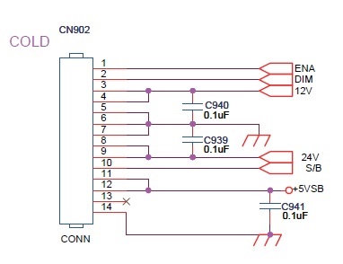

                    Can I get the list of the pin names of that white connector of that power supply/inverter board?
                    It sounds to me the signals from the main were present to turn on the power supply but then go away.

                      Yes of course you can get them, here you go. But I have enable the supply with 5V to the ENA, and also tested with 5V to the S/B pin. Same low voltages, on the components.

                        So, if you jumper 5V to the ENA pin, the 12V and 24V output stays constant? If yes, then it sounds like the problem is in the mainboard?

                          Nope if I jump the ENA the 12v and 24v is not present. And only the above values are present, ant the 5v standby of the supply is steady.

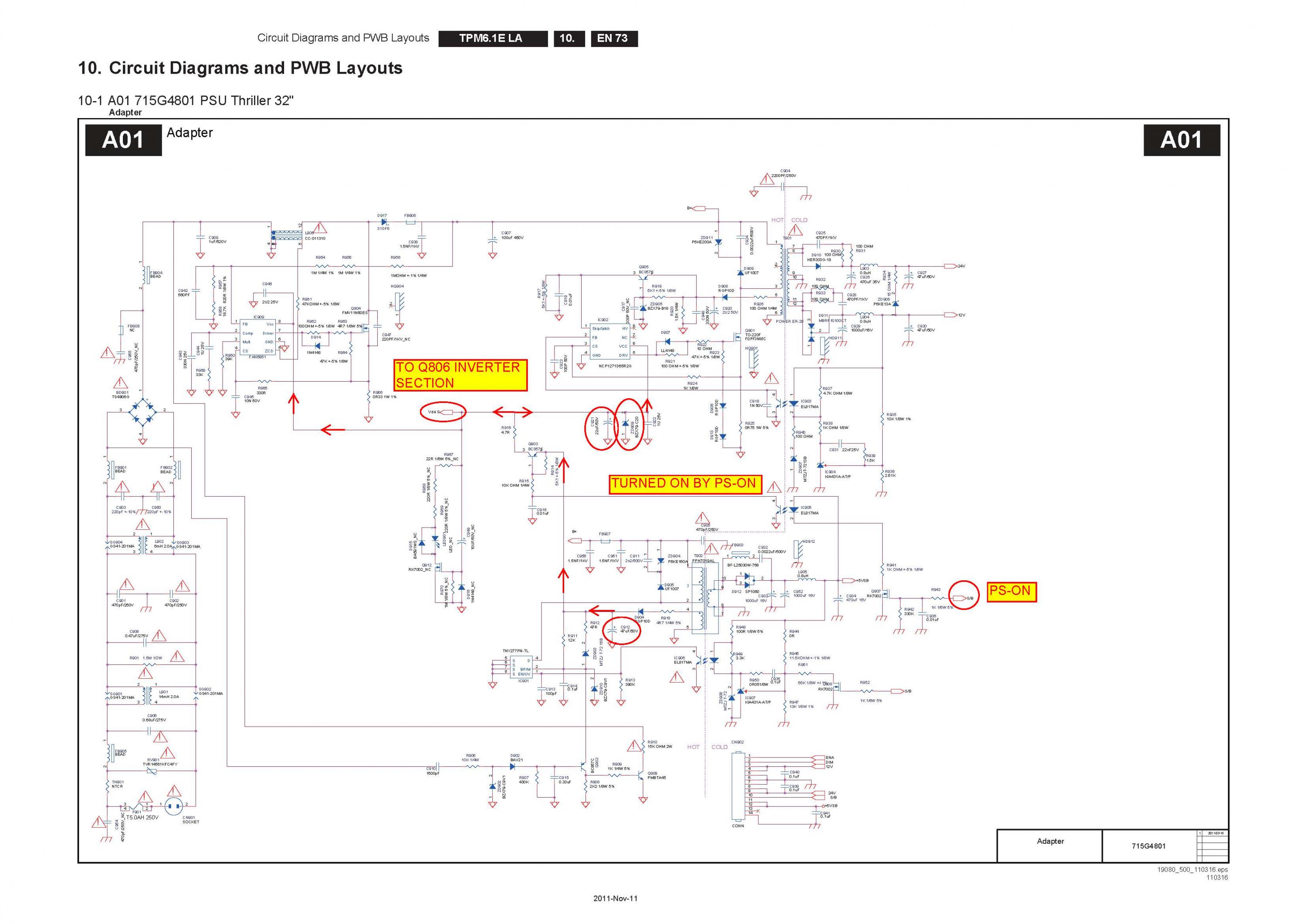

                            OK, per diagram of the connector pin out, the ENA pin is BL-ON (Backlights on) command pin.
                            The S/B pin is the PS-ON pin. And when you force on you must remove the cable for that command wire going back to the main board first otherwise you can damage the switched transistor on the main board, and always use the resistor for current limiter.
                                        10V is way too low for the ICs to run.
                                        Check the resistance between VCC pin and GND PIN.
                                        Some thing is loading down, it can be the IC, the zener, or bad filter caps.
                                        See the parts I circled.
