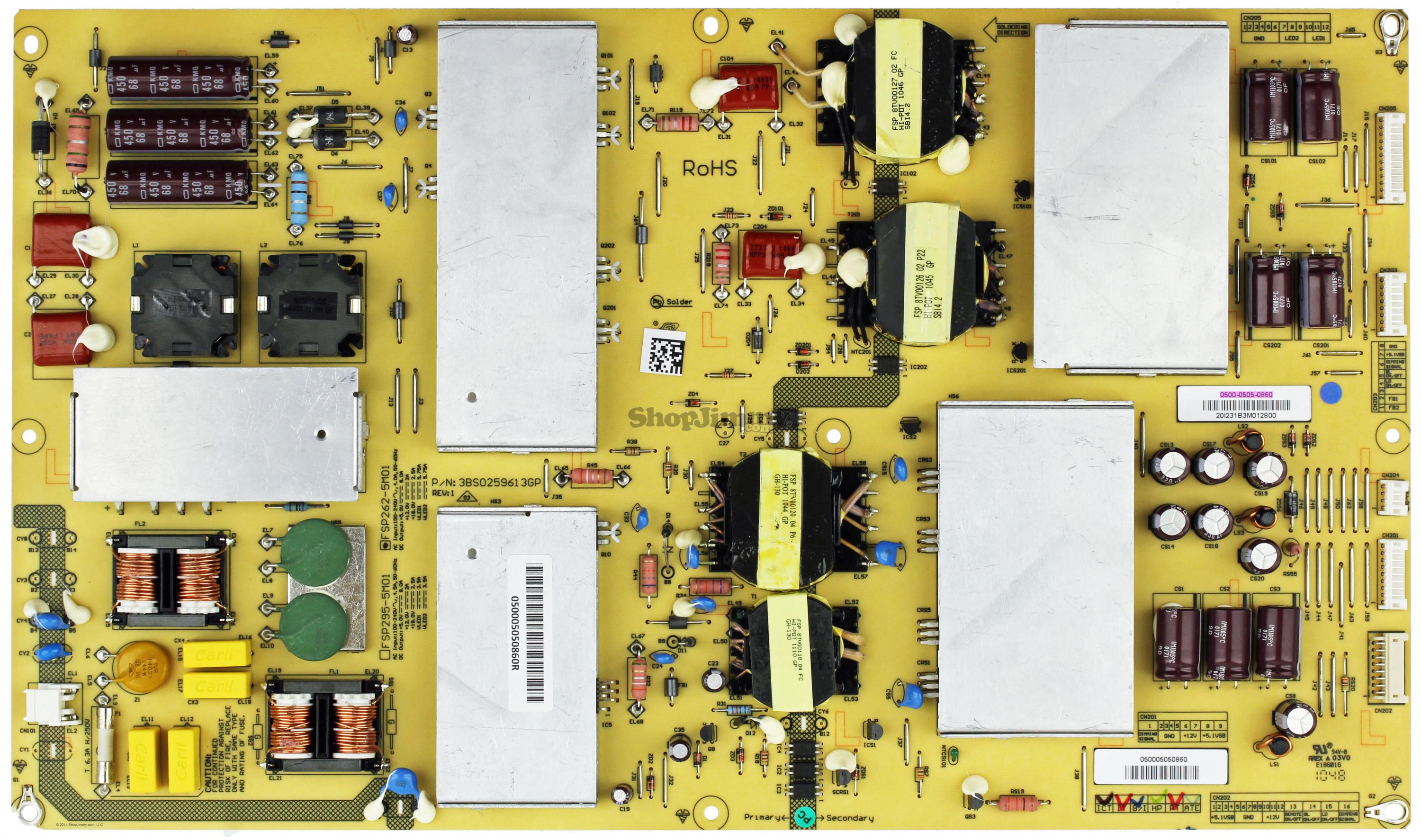

    4 wires PS to Vid Main is CN204
    8 wires PS to T-Con is CN 201
    two rows, eight wire positions in each row PS to Video main is CN202
    I have no schematic, no details of what each pin is.
    Can we guess that the MAIN needs replaced?

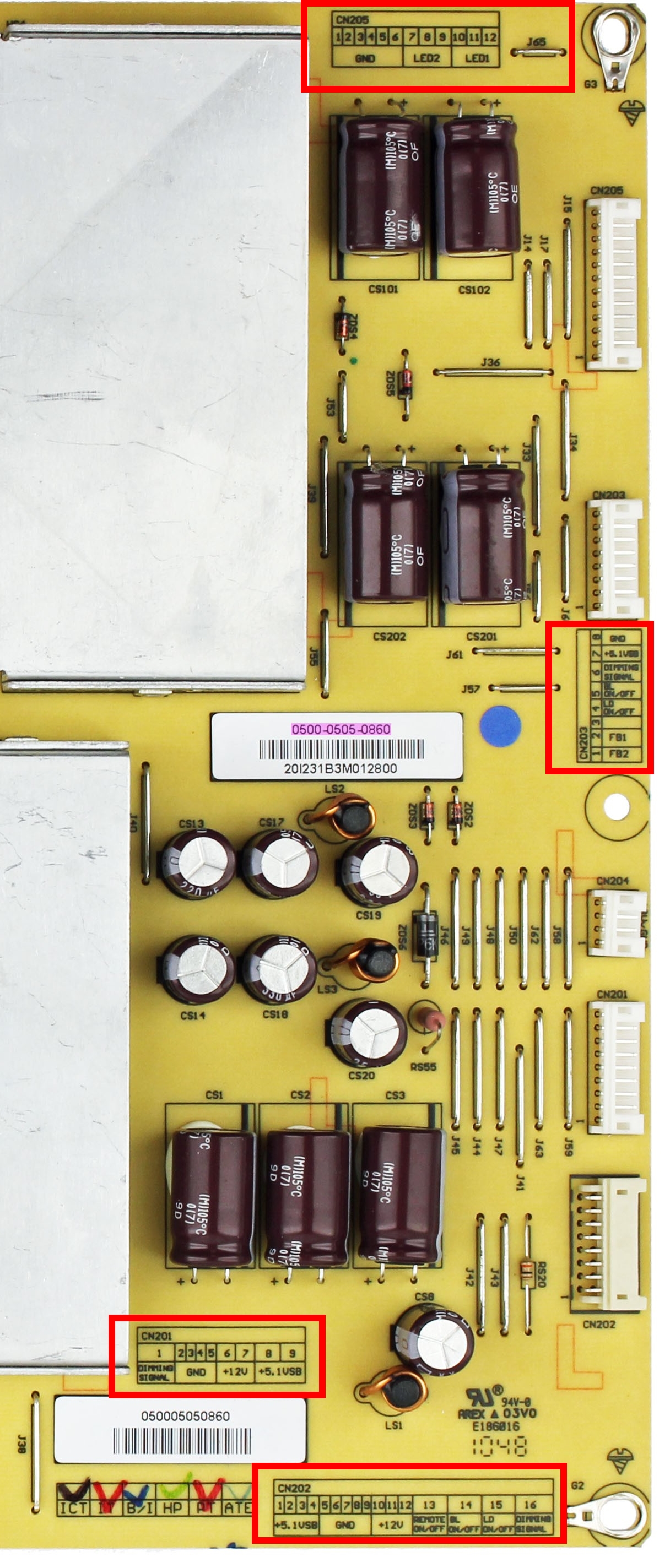

      Re: Vizio Failing afterwarm
      OK, so do you need just the two (cn202 & 204) from power supply to the Main Board? farright connector is #CN202, I do not see
      how to tell what color wire correlates to what pin # , as there are two rows, two holes do not have wire in them.
      CN202 = 1234-+5.1
      56789-GND
      10,11,12- +12
      13-remote on/off
      14-BL on/off
      15-LD on/off
      16- dimmer signal
      CN204 is not stamp on board
      These values were recorded when the TV was in picture failure mode, not while in the good 1st minute running fine mode, so would
      that explain why the values 3.3v & 11.8V are low?
      I ask does this mean the PS is not out-putting correctly, or does this mean the MAIN BOARD shorting is drawing voltage incorrectly?
      I can see why the Timing board is hard to diagnose as it gets power from CN201, and those #'s do not correlate with the stamp #'s.
      Capleaker stated in his post 16 about cooling the main? Will I need to do a re-record during 1st minute? I'd guess the values
      at that instant would correlate correct until the failure occures. What magic is next?
      All these boards look clean, no bulgeing/leaking, or burned regulators, resistors or ect parts. I have learned so much here.
        "OK, so do you need just the two (cn202 & 204) from power supply to the Main Board?" CN201, 202, 203, 204, 205.
        OK, TRY AGAIN: Notes: I do not care about the color of the wires, I care about the Voltage readings of the pin and the pin's names
        Your report in post 22:
        CN202 = 1234-+5.1 Is that what you are getting?
        56789-GND
        10,11,12- +12 Is that what you are getting?
        13-remote on/off So what is the reading?
        14-BL on/off So what is the reading?
        15-LD on/off So what is the reading?
        16- dimmer signal So what is the reading?
        And this is what request in post 9:
        For example:
        Connector CN201
        Pin 1: DIMMING SIGNAL: TV OFF = xx VDC, TV ON = xx VDC
        PIN 2, 3, 4, 5: GND
        PIN 6, 7: +12V: TV OFF = xx VDC, TV ON = xx VDC
        PIN 8, 9: 5.1VSB: TV OFF = xx VDC, TV ON = xx VDC

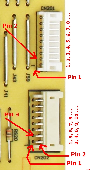

          Originally posted by Bills86e
          I do not see
          Most dual row connectors are numbered in a staggered configuration.
          First pin is marked on the board with some kind of indicator, in this case it is actually a number 1. but sometimes it's a dot or something around the pin.
          If a pin is not connected with a wire, it stil has a number.
          There are exceptions to these rules, but in most cases they apply.
          See the attached image for how the numbering works on a single vs double row.
          -David VanHorn
            That image is exactly as mine is, entirely!
            So where do we go from here? (to find the culpret board) Also, where is the stamp for connector 204? Its not on PS circuit board.

            Yes, those values are the O/B stamp on my PS-CB
            the post 18 were by location on theconnector, not by number, and the values noted during failure.
            The stamp values for CN202 are:
            rear row
            _ brown _ white purple green orange brown
            0, 3.3, 0, 11.8, 0, 0, 5.1, 5.1
            front row
            red black _ grey blue yellow red black
            .1, 3.3, 0, 11.8, 0, 0, 5.1, 5.1
            Agent24 has given us more incite to this connector, ......Thanks Agent24!
              CN202 are:
              rear row
              front row
              That's better but we don't know which of those colours corresponds to which pin number because we can't see your TV and the photos from ShopJimmy don't show the wiring either.
              You need to count the pins (as I have shown in the previous image I posted) and write down the pin numbers instead of the wire colours - or at least post a photo showing your board and wiring so we can match the colours up with the numbers ourselves.
              It should be on your board in the same area as it is on the photo of the one from ShopJimmy. But if it is not, that is why we need photos of yours, because they are not always the same. It makes troubleshooting hard if we don't see the same thing as you see.
              Sometimes a board's design is revised and things are changed, and it is not always given a new part number. So you can get different versions of the same board which are slightly different.

                      #30
                      OK I can only get the white logo. No pic or sound. Will not power off.
                      It seems that I could more easily unplug the CN202 from the MAIN, as the probe would go into the female?
                      • Bills86e
                        • Nov 2012
                        • 24
                        • usa
                        #31
                        with power, logo white
                        16=.0v 14=3.3v 12=12v 10=11.8v 8=.0v 6=.0v 4=5.1v 2=5.1v
                        15=.06v 13=3.29v 11=.05v 9=.0v 7=.0v 5=.0v 3=5.09v 1=5.09v
                        without power, logo orange
                        16=.0v 14=.0v 12=.0v 10=.0v 8=.0v 6=.0v 4=5.1v 2=5.1v
                        15=.0v 13=.0v 11=.0v 9=.0v 7=.0v 5=.0v 3=5.1v 1=5.1v
                        • Agent24
                          I see dead caps
                          • Oct 2007
                          • 4940
                          • New Zealand
                          #32
                          So it looks like the 5.1v Standby rail is OK as is the 12v rail.
                          It looks like the mainboard is sending the Remote ON signal and the Backlight ON signal OK, but there is no LD On (whatever that is) or Dimming control signal.
                          Which pins on CN202 are the ones without wires?
                          Can you measure those other connectors now as well and post the voltages along with the pin numbers also?
                          -David VanHorn
                                          1 minute goes by quickly. Then its too warm to come back on alive, to get more than one pin reading. How do you pro's do it fast.
                                          The shop here wants $160 to diagnose it, but no guarrantee.
                                          If I unplugall three cards (5 connectors) I can plug the AC in and read the PS
                                          and match to the four stamped chart values, and note CN204's values. (4wire)
                                          or 1= is this a bad idea? If they all matched, would that indicate at least the PSU
                                          DC output(s) mean a good board, or 2=does the PS have to be under a "load"?
                                          I will need basic electronics knowledge to proceed to get to "the boards are faulty"
                                          3= would a PS board change its DC output in a minute?
