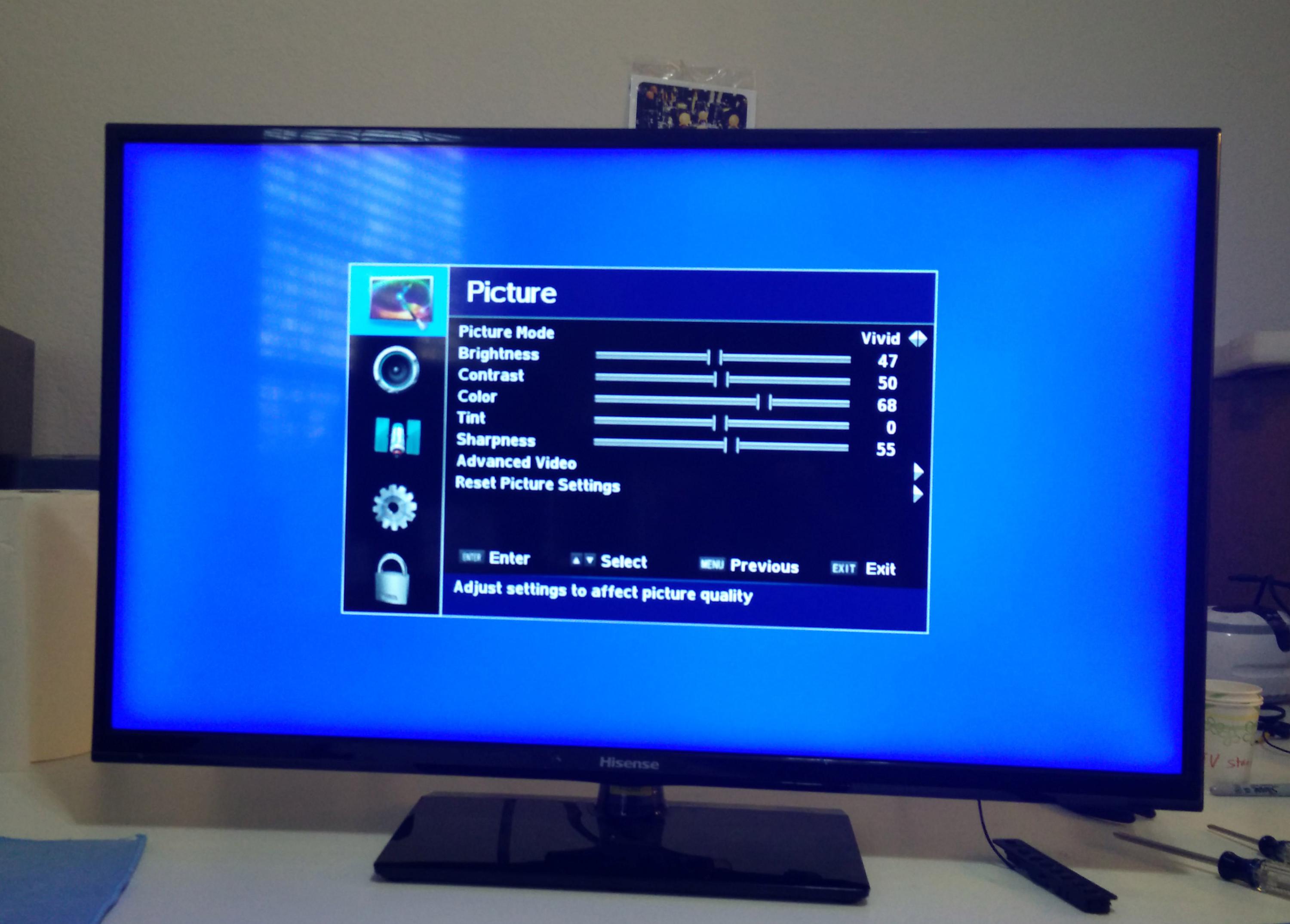

Hisense 40K360MN dim picture like in power saving mode

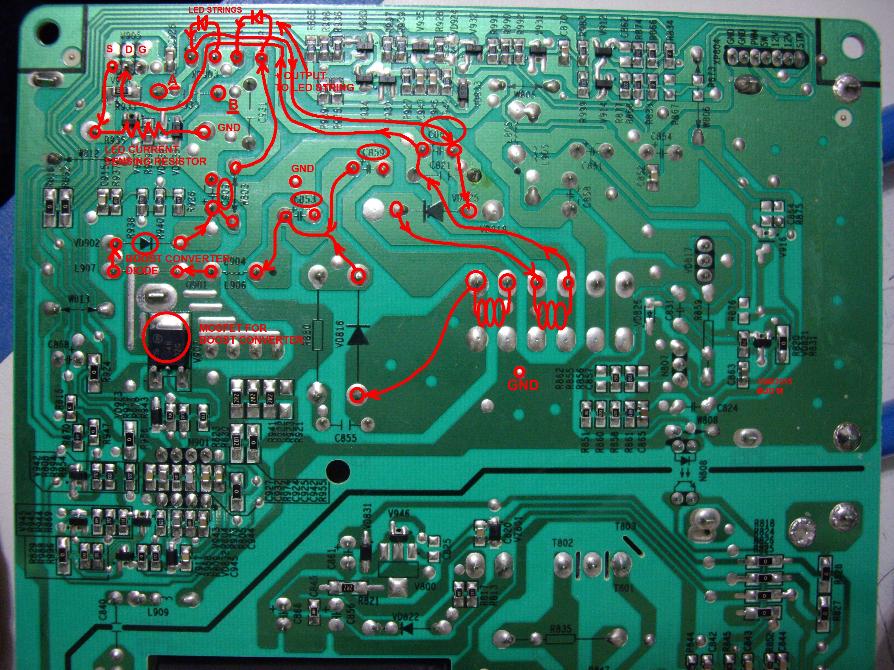

      I will have to download the picture and start tracing this weekend, I may ask for more closed up pictures later on.

          "I was also wondering about C869 having 0VCD when I measured using the chassis as ground." OK, I took a quick look at the circuit around C869, it is not ref. to the chassis GND so you need to measure directly right at the two legs.

            Okay, thank you for looking. Right at the legs I got 138VCD then.

              OK, I traced out the board, the LED STRINGS are connected in series to form one long string, so if you measure the Voltage between point A and Point B when the TV is first turned on, you should see very high Voltage and if you disconnect the LED connector and do the measurement again, the Voltage should also shows the same readings.

                From A to B with the LED connected it shot right to 460VCD and then moved to 463VCD and stabalized shortly after
                With the LED connector disconnected I got 467VCD.
                  Re: Hisense 40K360MN dim picture like in power saving mode
                  OK, the LED strings has open connection either at the connectors inside the panel or the LED inside the panel.

                          Wuahaha WOW!!! I was not prepared for the front glass/actual LCD panel to come off from the backlight like that!
                          You sir are a genius!!! One of the LED strips was slightly unplugged. I plugged it back in and now it is up and running again. (I just realized I probably should have put some tape or glue on that while I was in there)
                          Do you have a paypal or something I can make a donation to? I would like to buy you a beer.
                          Thank you again for all of your help!!!!
