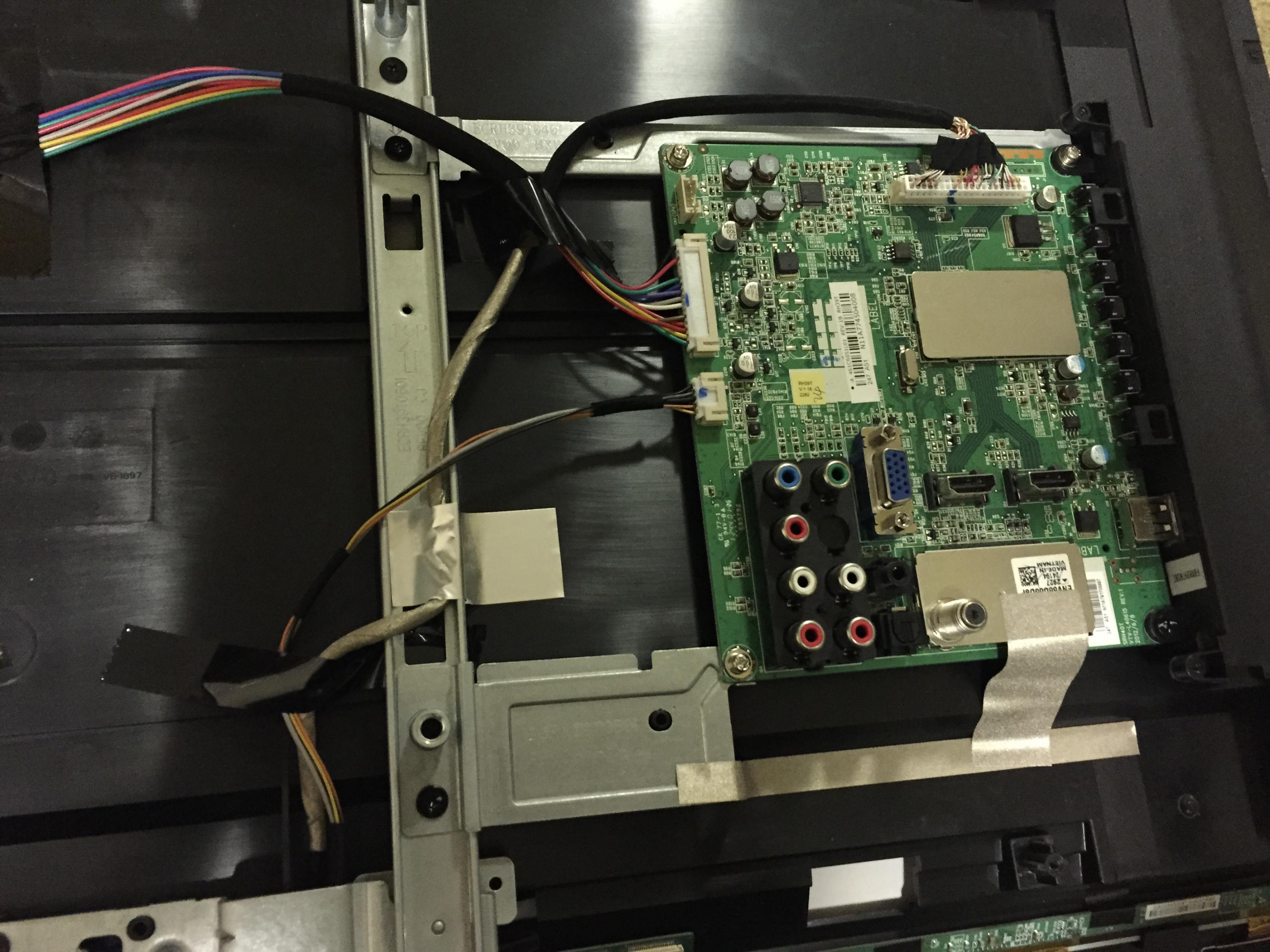

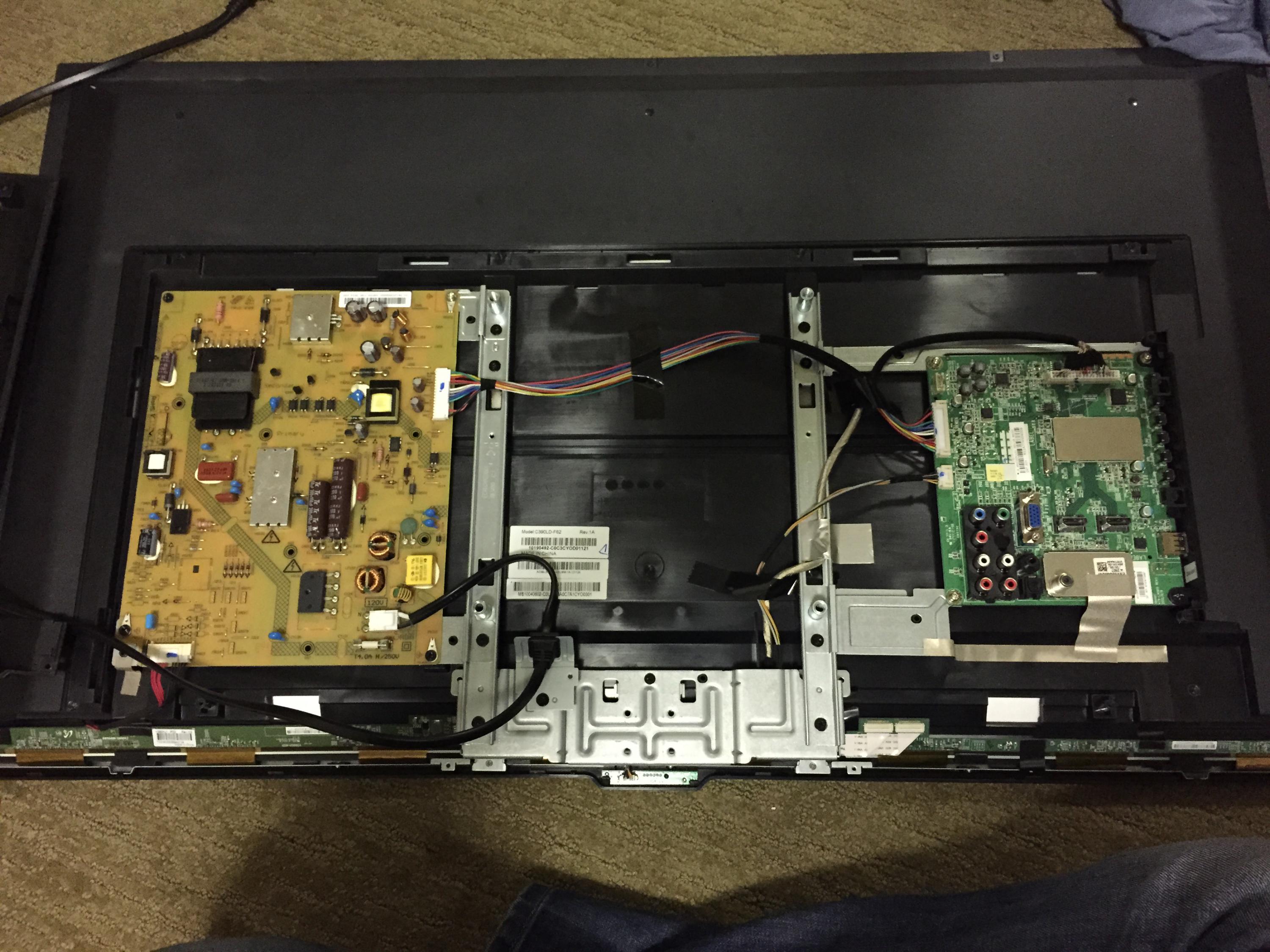

    I have a 39" Toshiba that I gave to my grandma. she called me and said there was no picture. There is a green led light on the front for power that comes on but no picture... No sound but I am not sure as I can't be sure what input or channel I am on...
    I took the back panel off. I didn't find anything wrong for sure. I see the power supply available for sale but I don't think it's that because the light turns on in the front.
    Any help appreciated.

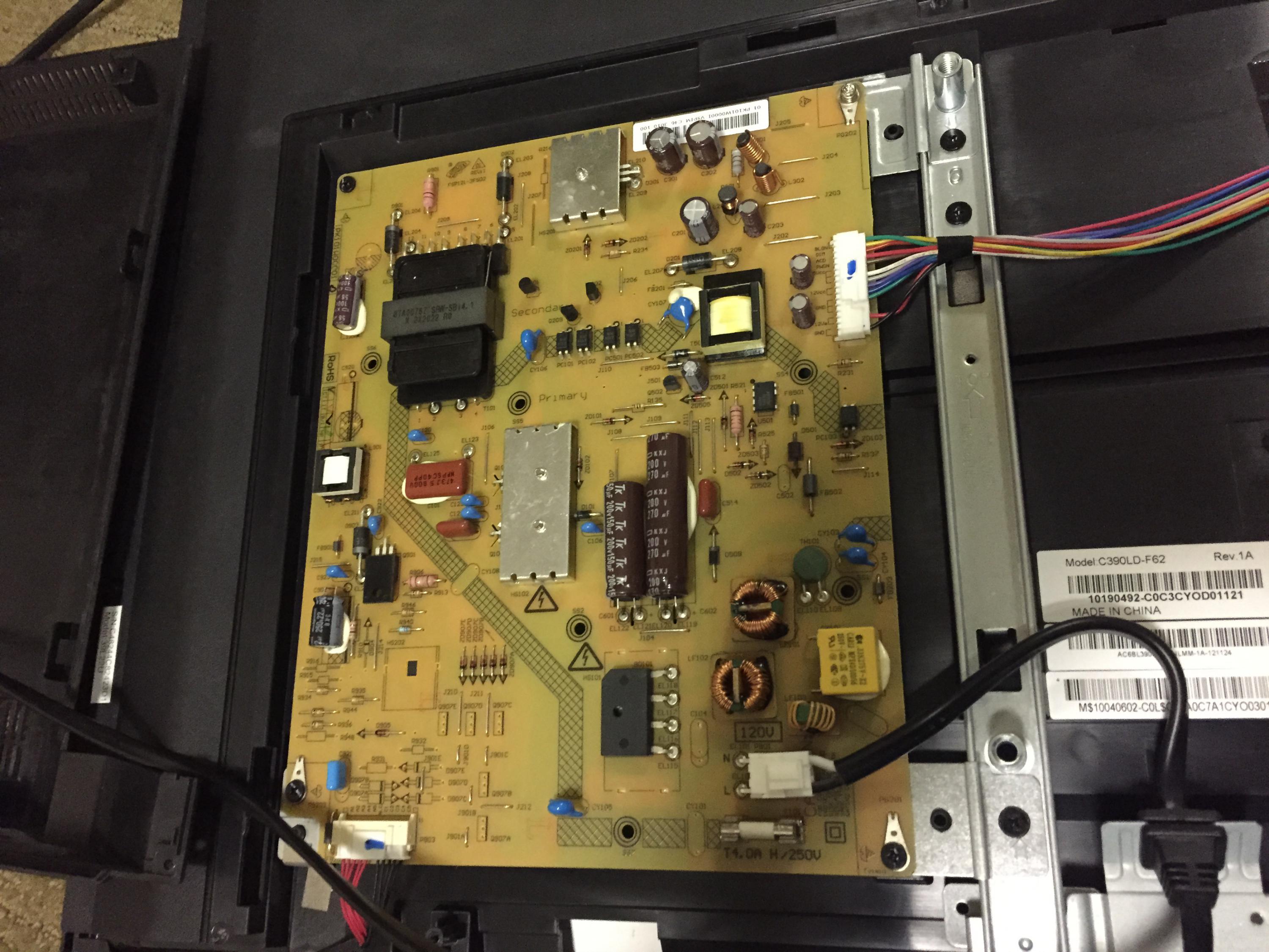

                        By the way, the one in your link does not match your power supply board which looks like it is made by FSP.
                          Re: Toshiba 39l22u
                          I need to verify the version of the board you have, looking at your pictures and the SJ pictures, it looks this is the board you have in your TV, please verify:
                          http://www.shopjimmy.com/toshiba-750...pply-unit.htm#

                            The board states FSP121-3fs02 so I guess it is the FSP one... I don't have any ohm resistors but do you think if I swapped the power supply it would work assuming I could find a board?
                            http://www.tristatemodule.com/p-2731...02-39l22u.aspx
                              Re: Toshiba 39l22u
                              BTW: "ACD 3.55: OK, Analog dimming control signal from the main board" It is AC Detect, not 100% sure if normally HIGH = GOOD or = BAD.
                              All I know right now is that you do not have any 12V outputs or LED drive Voltage, so you can try new power supply board or try to find out why 12V and the LED drive Voltage are not present.
                              Those Voltages are generated by power transformer T101 driven by MOSFETs Q101, Q102.
