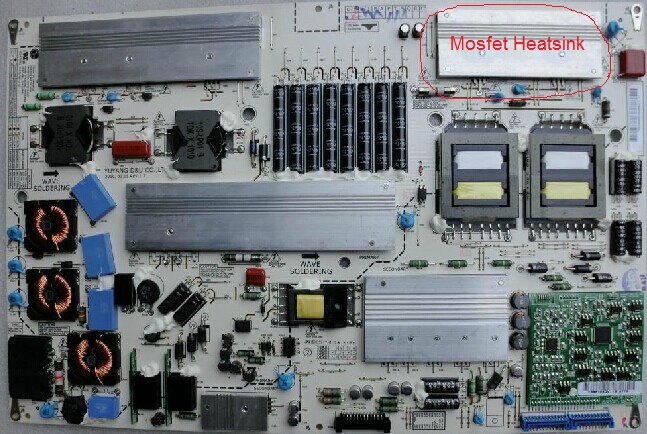

    My LG 47LE5300 Turns on but no picture, no sound.
    I am looking for PSU (YP47LPBD) schematic diagram as I think high voltage Mosfets are not working.
    They are ice cold which tells me they are not working. Maybe the problem is the High-voltage resonant controller is not functioning.
    Thanks in advance

    We need to see pics. You need to invest into a DMM and measure some voltages. BTW, I'd leave my fingers off the primary side (to measure temperature) as that could end up deadly.
      Re: LG 47LE5300 Turns on but no picture, no sound
      That heatsink is for the LED backlights and other power supplies is not going to do anything until you find out if the standby power supply is working not, if the PFC Voltage booster is working or not, etc. Do you have PS-ON, BL-ON, etc?
      So show us the pictures of the whole back side of the TV so we can see what we are dealing with.
      What DCV do you get at the black connector on the power supply board that goes back to the main board, there are labels for each one of the pin of that connector.
      List the pin number with the name of the pin with the DCV readings when TV is plugged in but power switch is not activated, then with the power switch is activated.

        Thanks a lot for reply.
        Here are the pictures of TV and black connector pin voltages.
        When you say: "PS-ON, BL-ON" what does it mean?
        PS-ON=Power Supply On?
        BL-ON=?
          PS-ON = Power supply on, it is the command signal from the main board to turn on the rest of the power supply.
          BL-ON (or Inverter ON) = Backlights ON for turning on the backlights circuits, the command signal is also from the main board.
          You should read my BASIC LCD TV troubleshooting guide, your TV uses LEDs in stead of CCFL.

            I checked the voltages.
            The only voltage that I have is 3.3 V Standby. I do not have other voltages like 12 and 20 VDC.
            Seems no command is coming from processor to start the system.
            Any suggestions?
