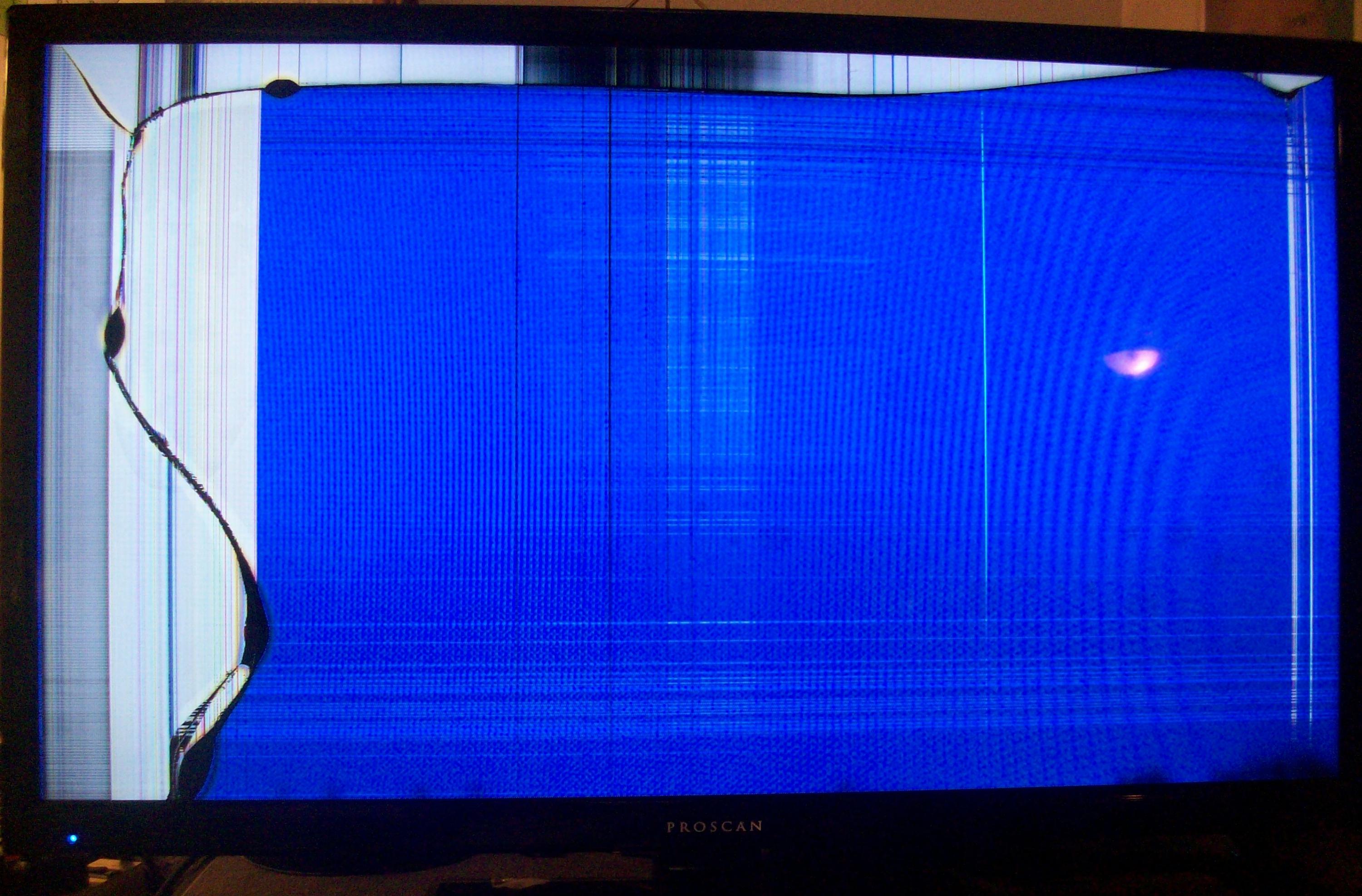

    It appears to have possibly also suffered some water damage since it sat out in the weather a couple for days by the trash, has some rust on the screw heads, plus there are a few spill drips on the screen.
    It will partly show the flickering no signal screen at times. I know an inner pannel is cracked as I pushed along the visible dark line and heard it crack more and show more cracking. There is no visible damage to the outside. Where would I find a replacement screen, and is it even worth fixing or better saved for parrts?
    Re: Proscan PLDED3273A-B cracked inner panel
    Not really economical to buy a spare panel
    Better to strip for parts and see if the come of use/ or sell them off..
      Seeing how Amazon.com has a new TV listed at $225 USD + free ship + warranty,
      http://www.amazon.com/Proscan-PLDED3.../dp/B00AM5JSVU
      I can't see any rational buyer offering more than $100 for an used one.
      I also see that Walmart.com has a bunch of 32 inch LED TVs in the $150 to $175 USD range.
      You might be better off parting this TV out?
        Yeah, thanks for confirming my thoughts guys.

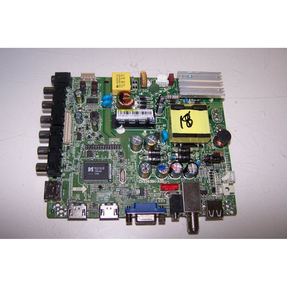

          Oh! I might need the main board out of that!
            Wait, mine is a 3216a, what are the part numbers on the main board out of curiousity?

              Strip it for parts--Thats all its good for now.....

                I don't know Shinju, I've not taken it apart yet.
                  The mainbaord is CV3393BH-A32. Here's a pic of one.
                    @Steve,
                    Are those Capxon brand caps on the main board?
                    --- begin sig file ---
                    --- end sig file ---
                      Yes.
                        Thanks for the photo Steve, your Panel is a few revisions newer then mine. Main boards are not even the same design.
                        bummer!
