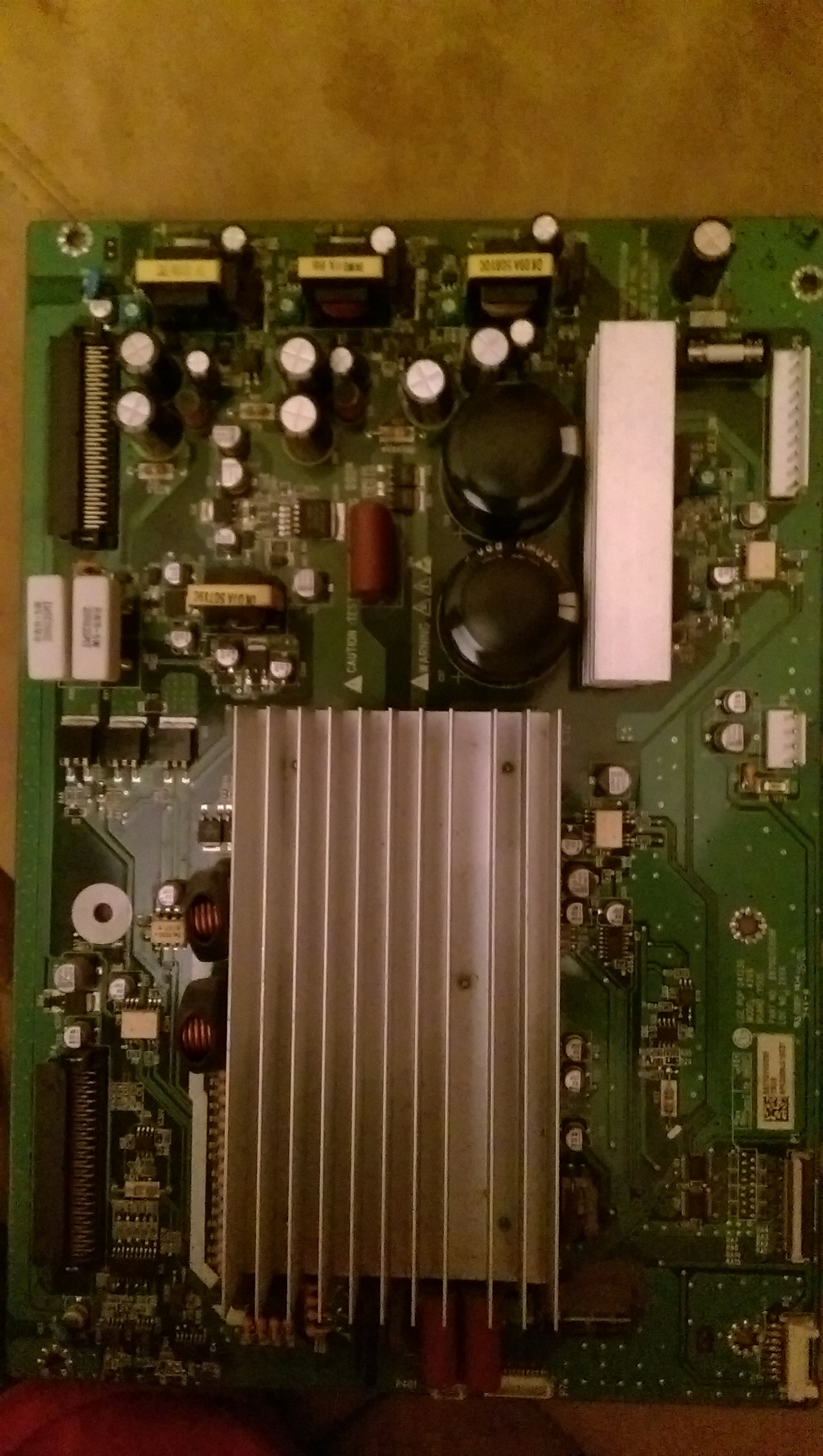

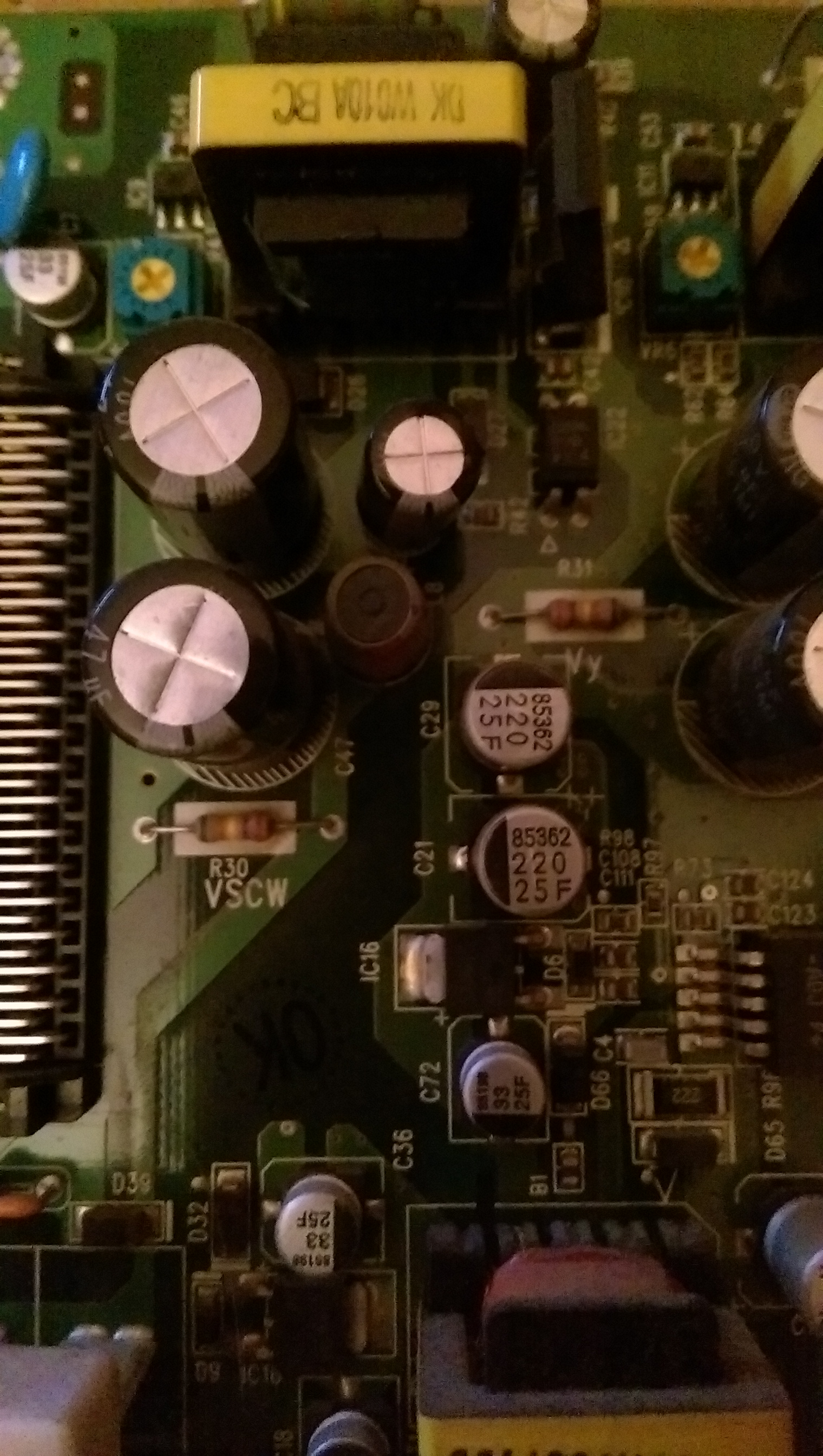

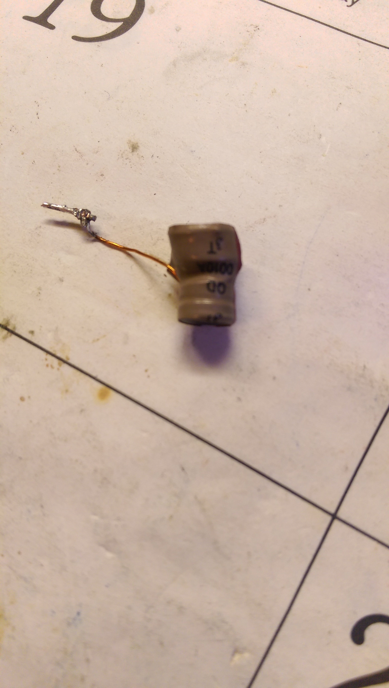

    I have a friend's Hitachi 42edt41 that has twin wide vertical bars on either side of the screen. Once I tore into it I noticed a component on the board that was split, can some help me identify this part. Written on it is qd 0010a 3t. The number next to it on the board is L6. There are two more just like it close on the board with L10 and L8 next to them. Hopefully the pics I'm posting will help.

    these are just inductor coils. if they are ohm with zero resistance then they're good. they always look weird but it doesn't necessarily mean they're bad if you have vertical bars on the screen we should see a picture of the screen with the fault because that can represent many different things as in possible panel failure for a control board issue.

      Thanks for the response, I'll post a pic of the screen once I find a replacement for that coil, it pretty much crumbled when I removed it
