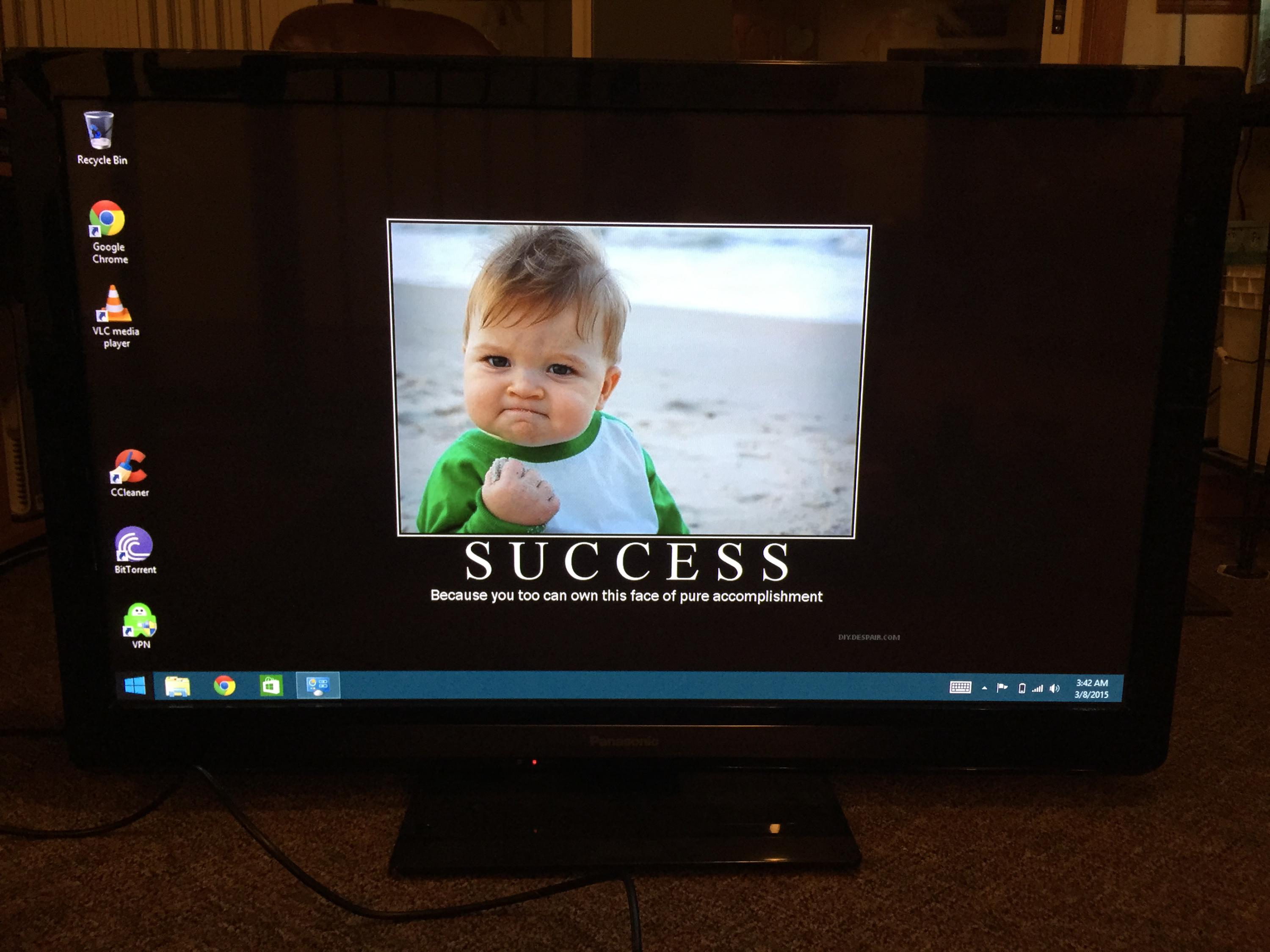

                        #111
                        Re: Panasonic TCP42S30 SN Board reflow-Help out a noob!
                        I did use flux towards the end, it made everything flow really well. The board contact points on IC502 were really messy once I lifted it, so I used the flux and a fine tip on the iron to even them out, even though they were so small it was surprisingly easy. I must say the flux is very sticky, I'd end up shifting it out of place because it kept sticking to my tweezers! The screws are in as tight as I'm comfortable making them, if I put my ear next to the board it's the ERC caps themselves that are humming, wondering if something got slightly damaged when I popped the ERC cct, who knows.
                        Anyways, here she is in all her glory!

                          #112
                          LOL, I was wondering where my flux pen line went . Into the quote.
                          Now , when you describe buzzing caps as pretty loud and then come back and say "if I put my ear next to the board" it's not quite the same description.
                          Sounds normal if you have to get your ears close to the board to hear a buzz.

                            I only put my ear up to it to locate exactly where it was coming from.......As a reference, I have to put the volume up to about 60 to hear the audio clearly over the buzzing. If there was a scene with no music and just dialogue, you would easily be distracted by it. I'll be connecting it to a system so it's really no big deal, I just wanted to be sure that something wasn't actually wrong.
