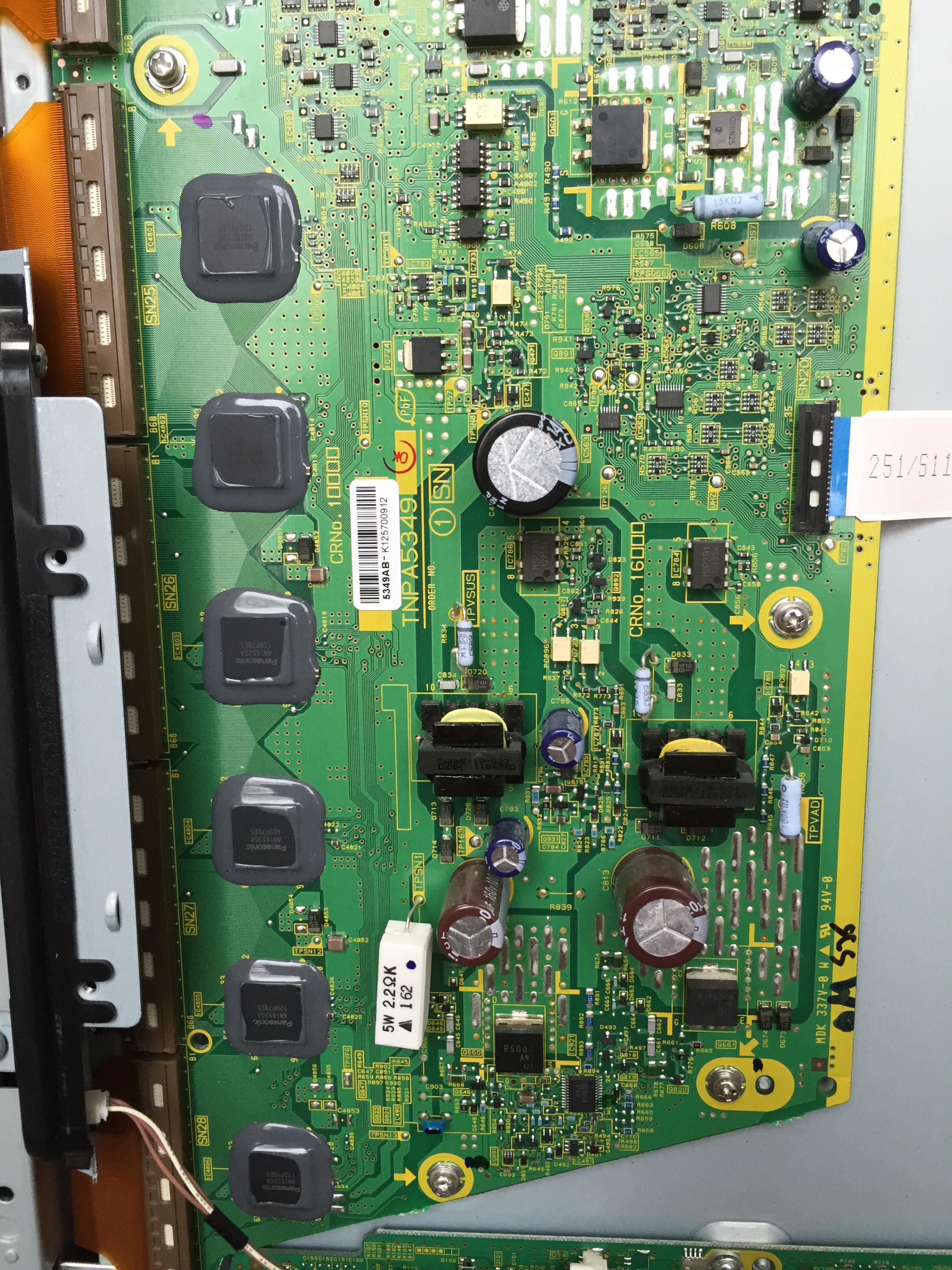

Panasonic TCP42S30 SN Board reflow-Help out a noob!

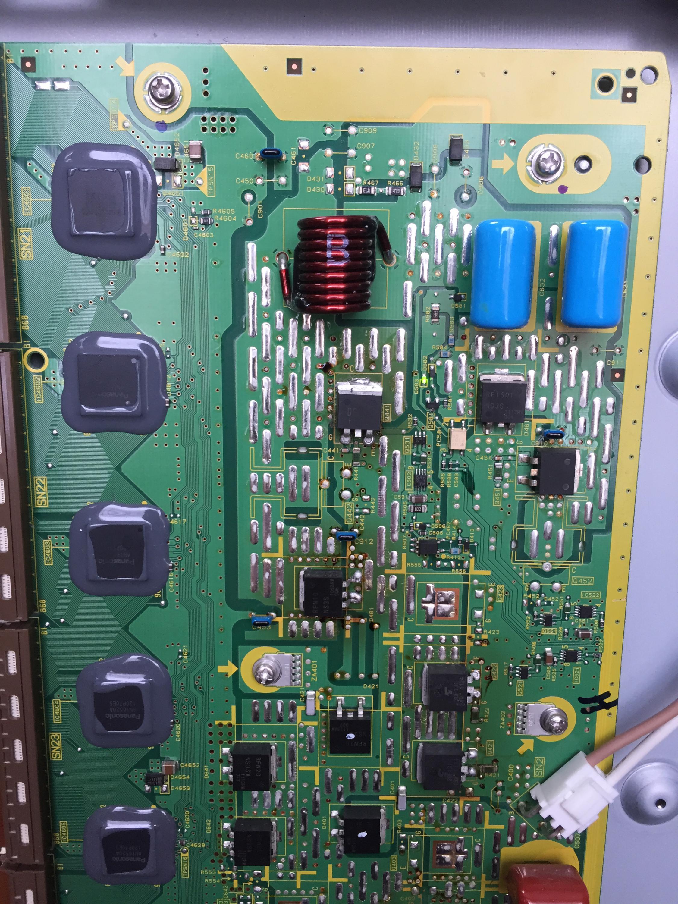

                  #68
                  Re: Panasonic TCP42S30 SN Board reflow-Help out a noob!
                  Try measuring Vfo and Vfg to ground with a meter (SN board outputs, should be ~100V), also check -Vad, Vscn and Vset (where available)
                  Maybe try checking ERC mid voltage (can't remember if this set uses an ERC midpoint though...)

                    #69
                    Having trouble locating those, I'm seeing things like TPVFG and TPVAD, am I on the right track?

                        #71
                        TPVFG and TPVAD will do for now. I forgot this set has buffers on SN board so you can't easily probe some of the points you can on other sets. Do you have a nice high res shot of SN board?

                          #72
                          I can get one, give me a sec........TPVFG is reading 175V and and TPVAD is reading 30V.

                                #75
                                What voltage do you get across those two blue caps, top right of SN board? (Voltage across any one - doesn't matter which, they're in parallel)

                                      #78
                                      Voltage across blue caps = ~200V

                                        #79
                                        Since TPVAD is reading low at around ~30V, any idea what the problem could be?

                                          #80
                                          I haven't read the whole thread, but did you replace a few transistors? If so, and your ERC voltage is at 200V, then I would suspect the driver chip for the ERC IGBT is stuck HIGH. I had that on my set (I did not power it up with the fault though.) This will cause all sorts of problems... I would suggest you replace all the driver ICs and small transistor pairs for any set of IGBTs that have failed.
                                          BTW, ERC should measure ~Vs/2 (or around 100V) when working. You can confirm by measuring SS board. They should match each other, within a few volts.
