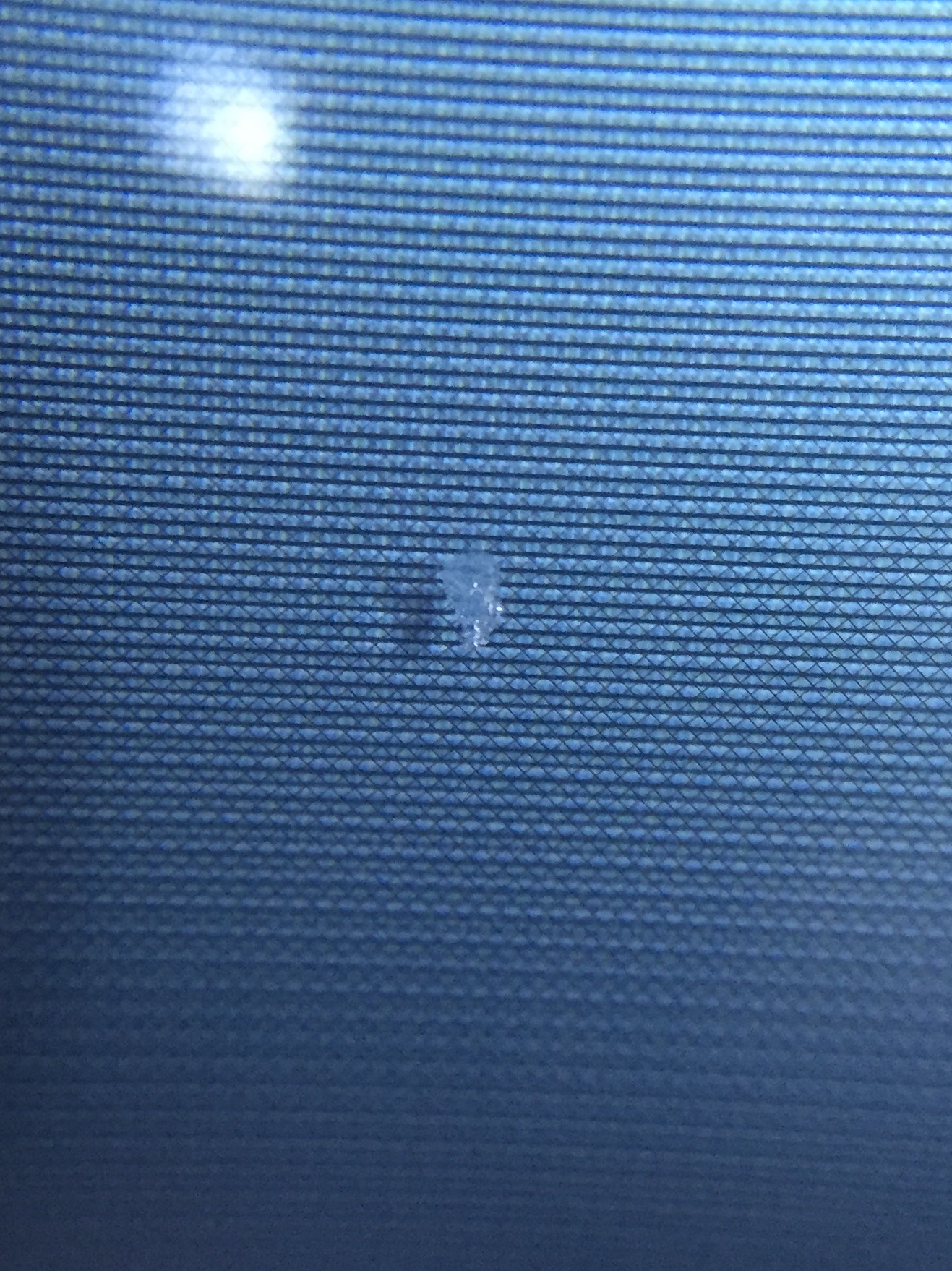

    Just tried to power on with the room pitch black, absolutely no detectable light coming from the panel at any point.
    I also tried checking for continuity at SS61 and SS33 as instructed by the flowchart, they both checked out ok.

      not sure what to make of it unless the panel has a small fracture and somehow not shorting the boards. photos

        Idk how you'd ever be able to tell from the photos, but the small chip in the center of the light is the only visible blemish on the panel.

            you're right, i can't . more interested in the rear but a chipped panel maybe the issue. as far as i know there is no protective filter glass on these so it's conceivable there's a fracture and gas has leaked.
            more opinions would help. do you have a jewellers loupe to have a real good look at that chip, maybe a pinhole there?

              Funny you mention that, I just got one in a resistor kit.....the chip appears to be superficial but I'll see what I can do.
