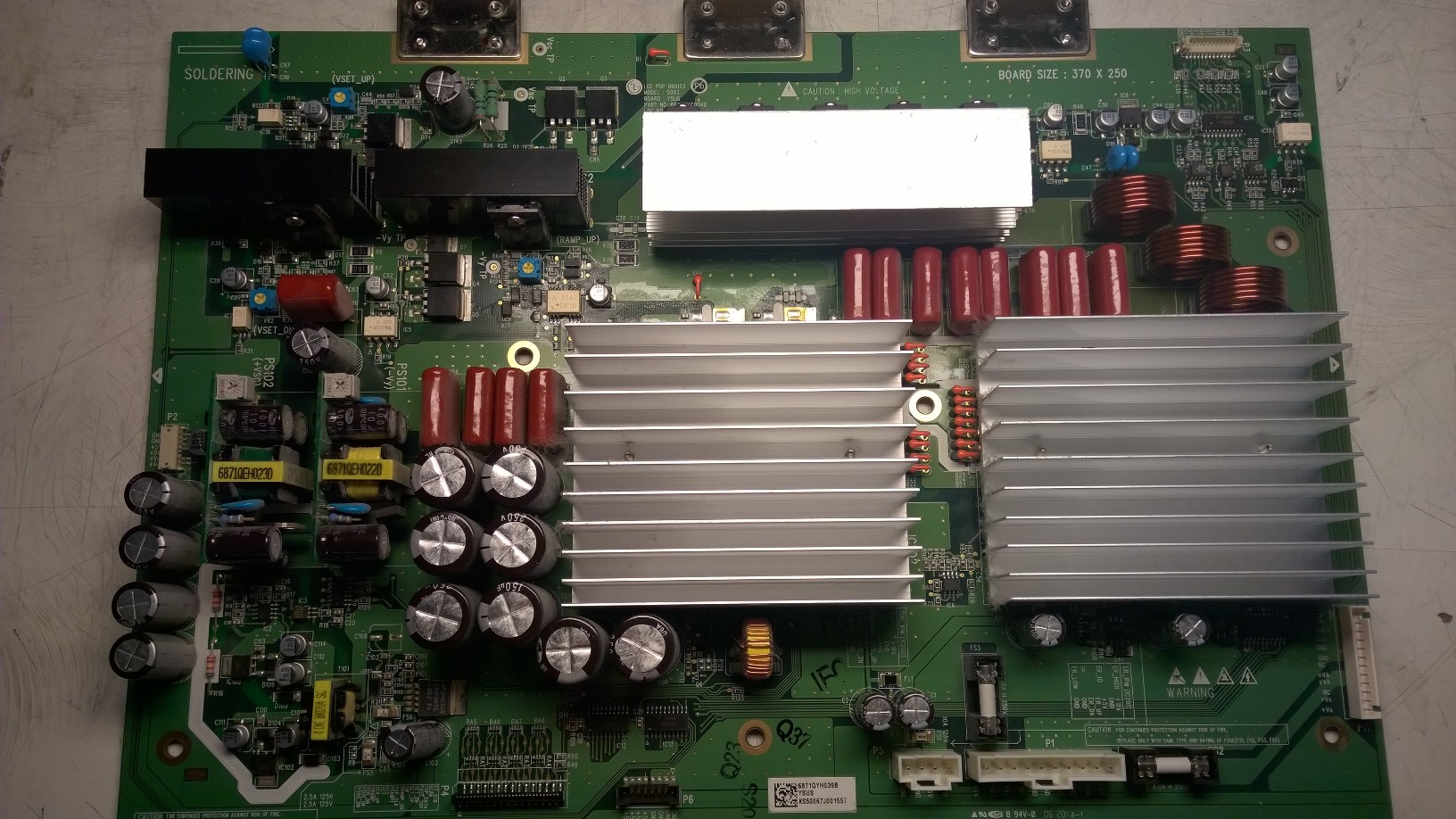

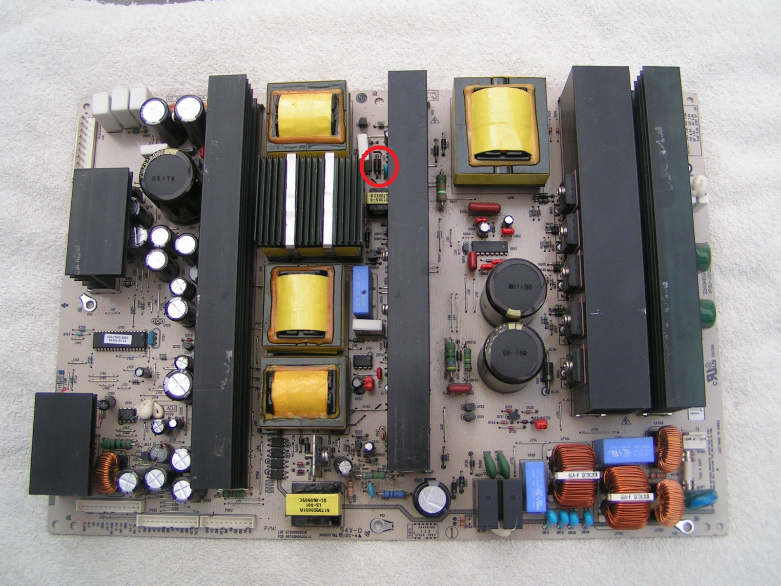

              Hi
              Sorry to jump your thread, but I was wondering if you could help me in providing the details of the components (value/markings) located on the power board.
              The components are shown on the board as C802 and D801 which are located between the two heat sinks.
              I have attached a photo to show actual location.
              Any assistance would be appreciated.
              • Cornboats
                Dave
                • Oct 2010
                • 232
                • United Kingdom
                Re: LG 50PC1D need help guys
                C802 is a capacitor
                D 801 is a diode
