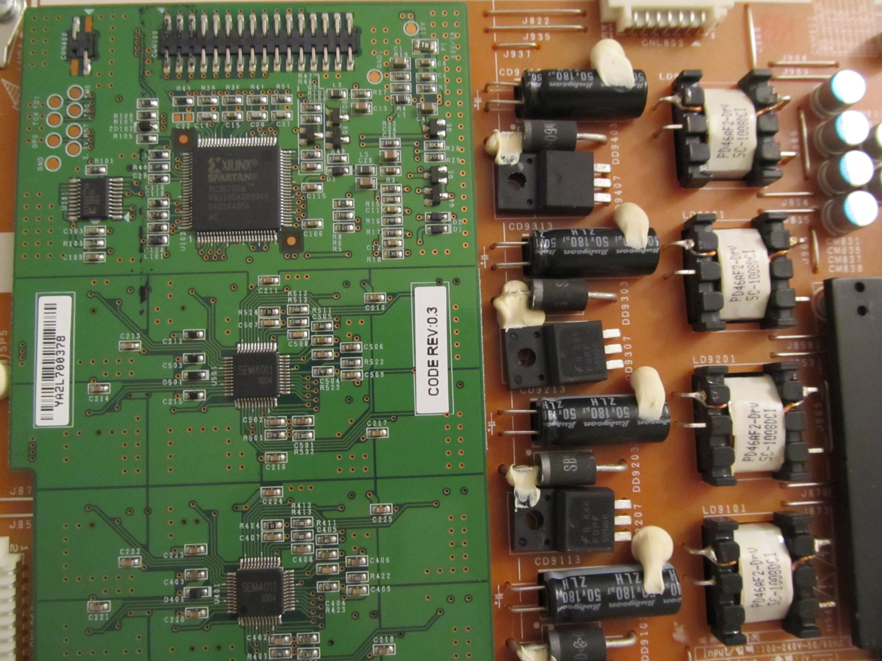

        Re: Samsung un46c8000 broken board
        Posting pictures of the back of your tv showing the boards with clear pictures may help you more with fixing your problem

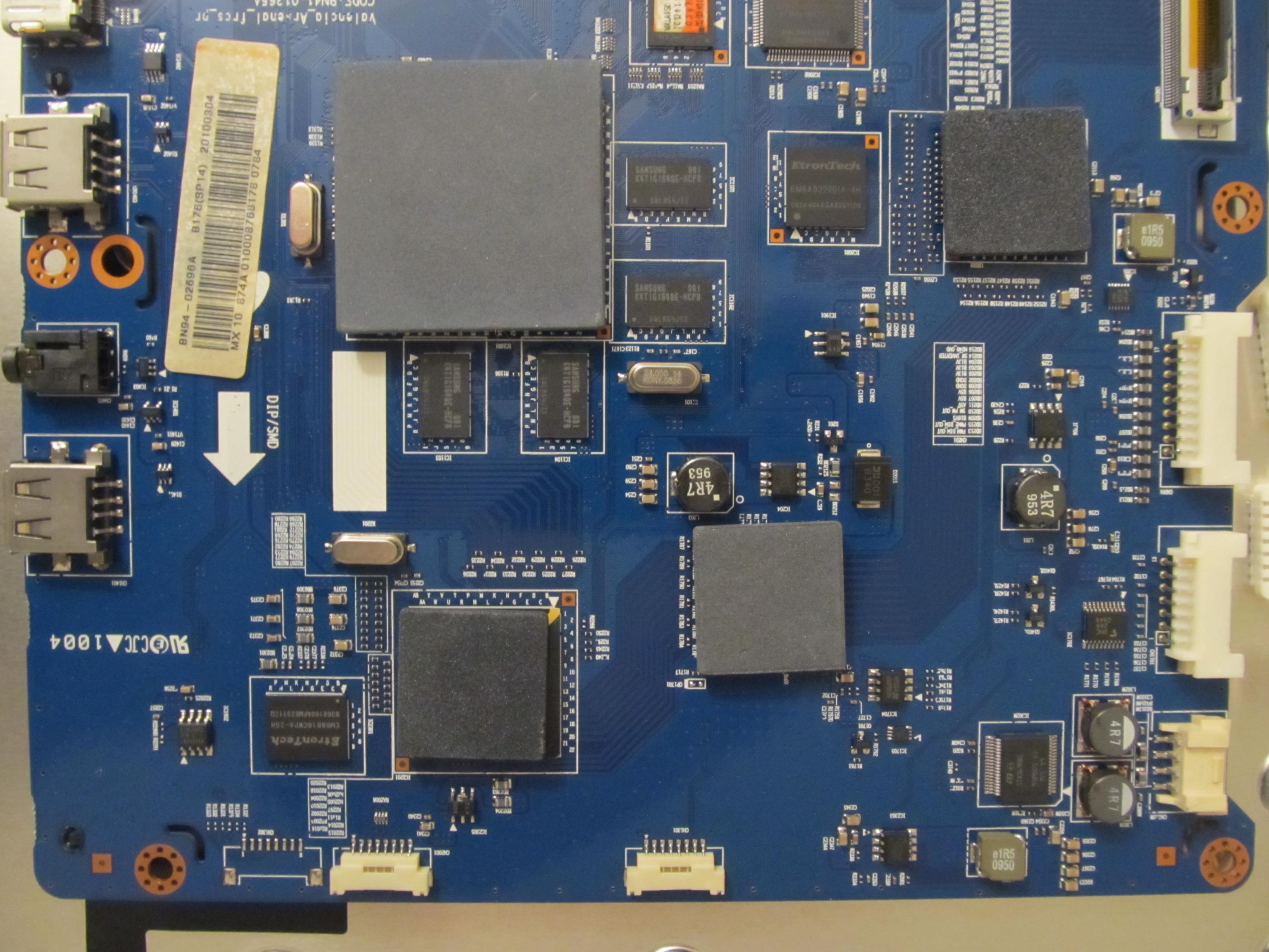

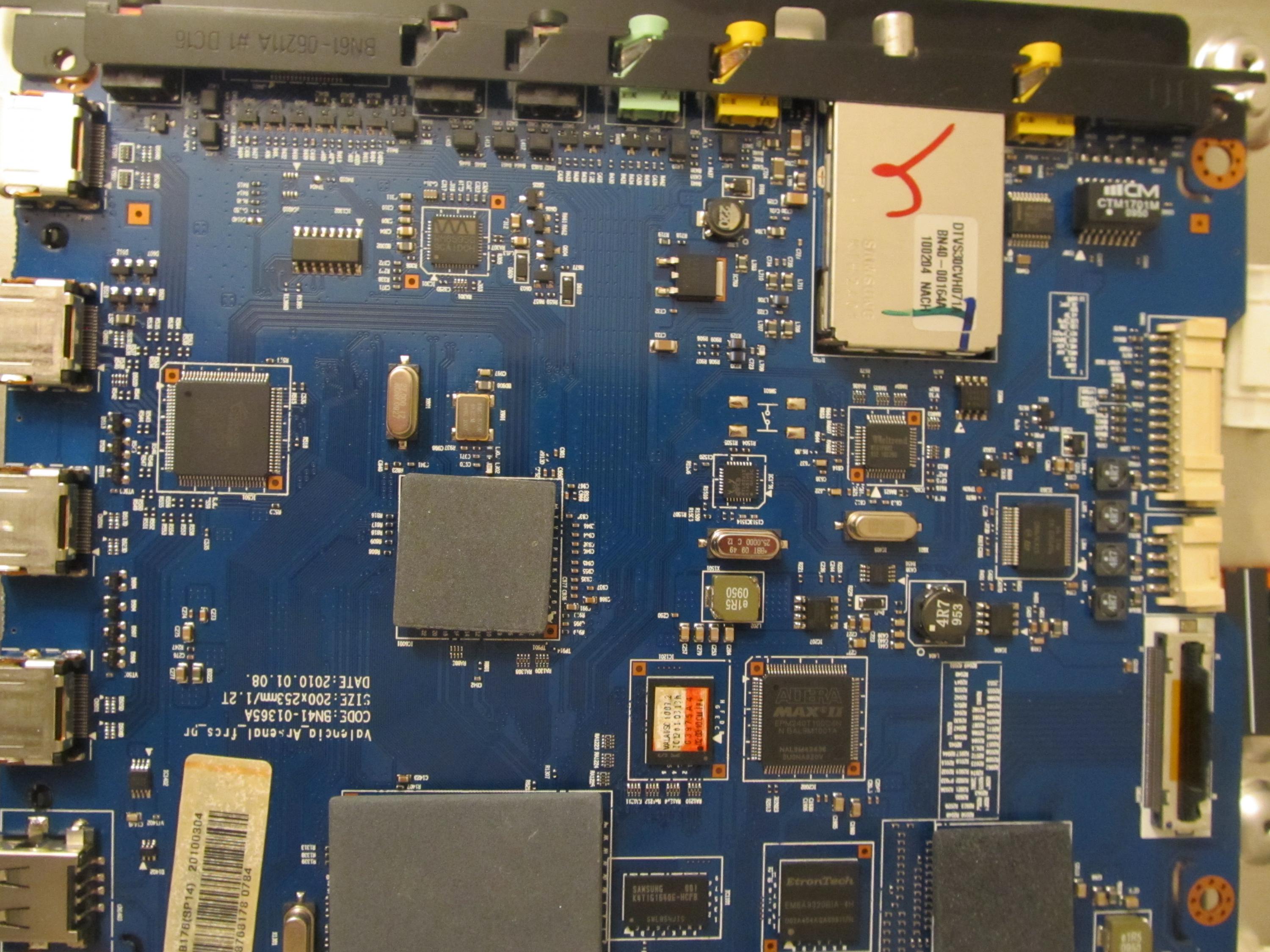

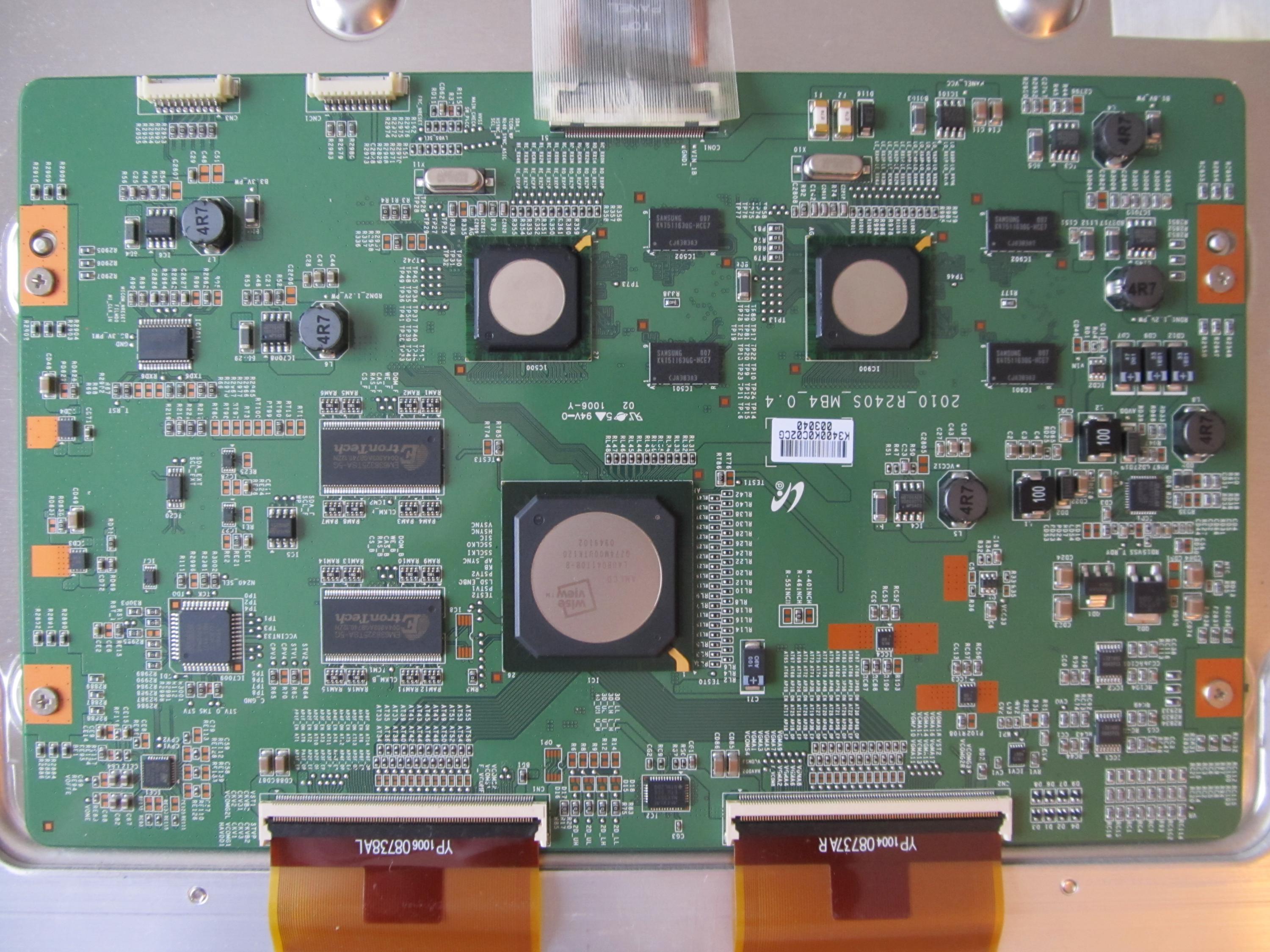

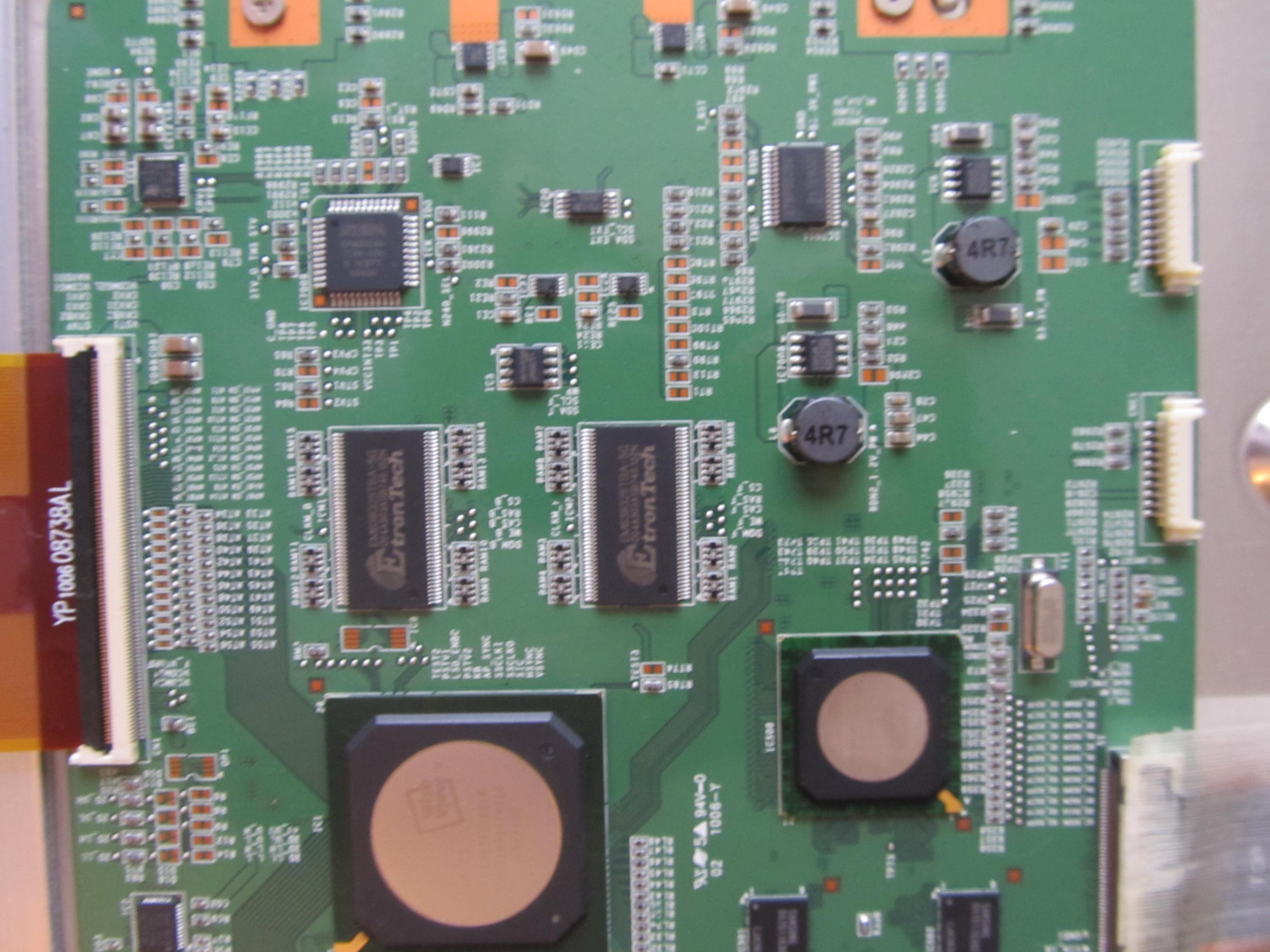

            Thank you for the explanation mmartell. Yeah I looked into replacement board but could not find any cheap enough. Also tried to sell it with no avail. I will post pictures of the board though. It does not look like anything is leaking or poorly connected. I have not checked voltages yet.

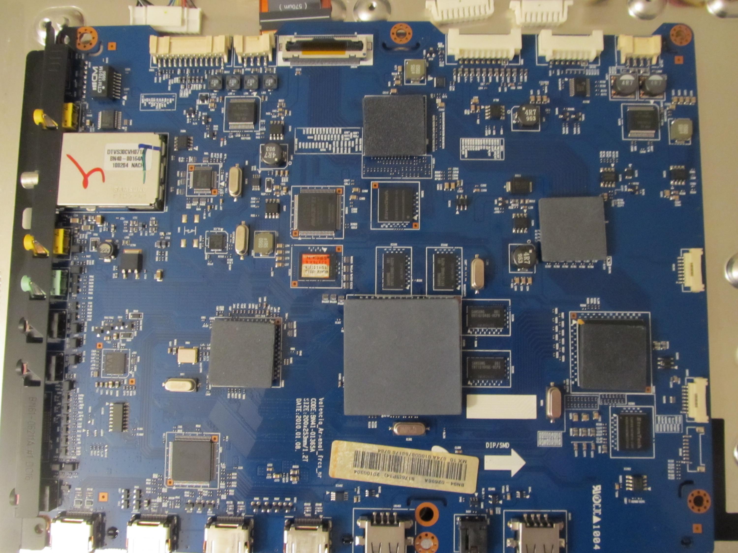

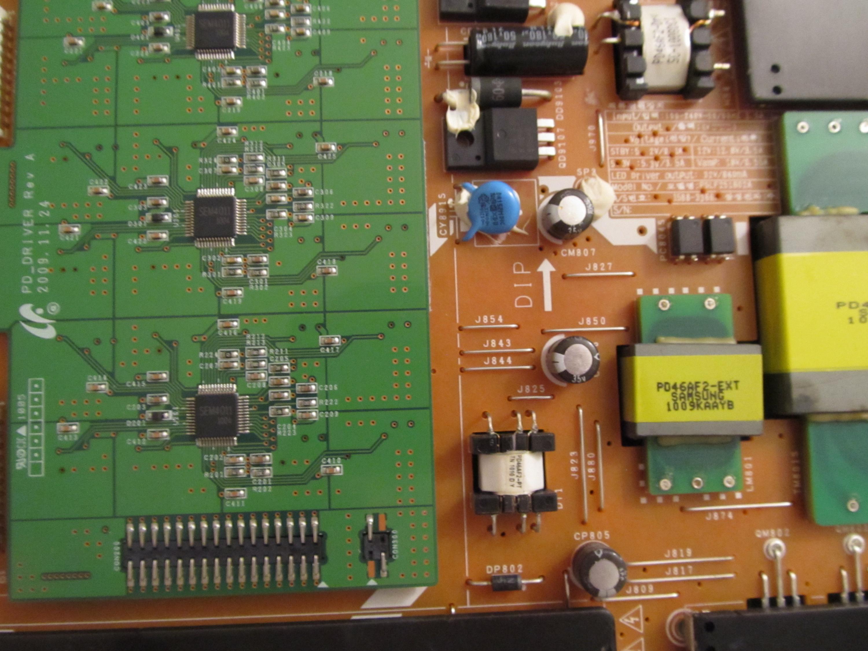

              Board with HMDI and cable inputs

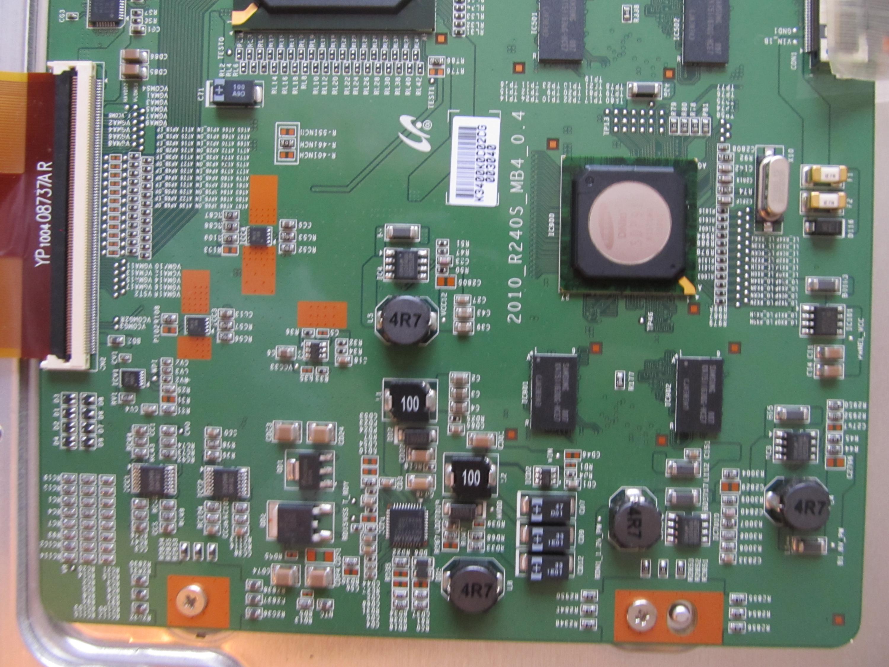

              • whywontyouwork
                • Feb 2015
                • 7
                Main board
                  Main board.

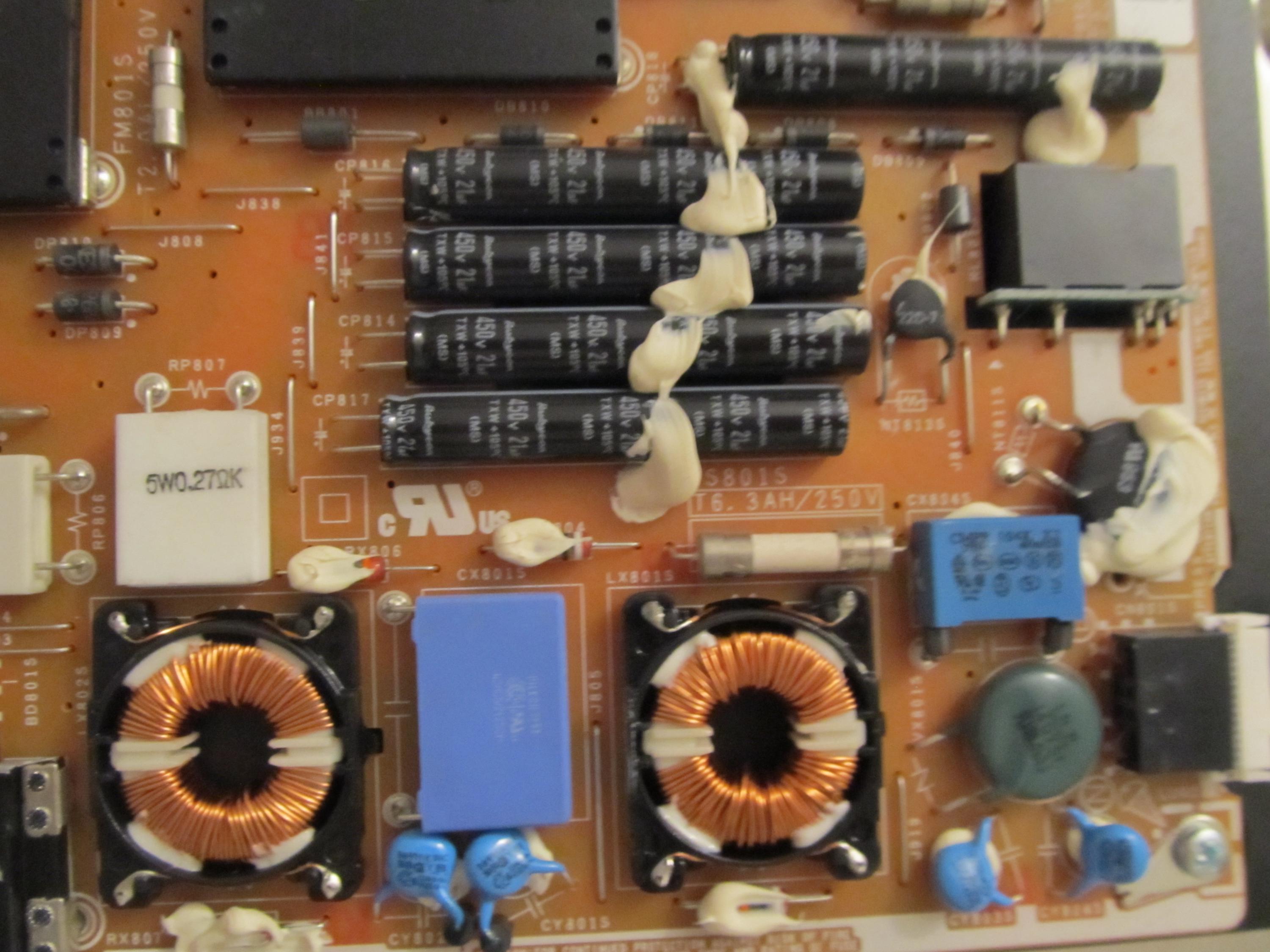

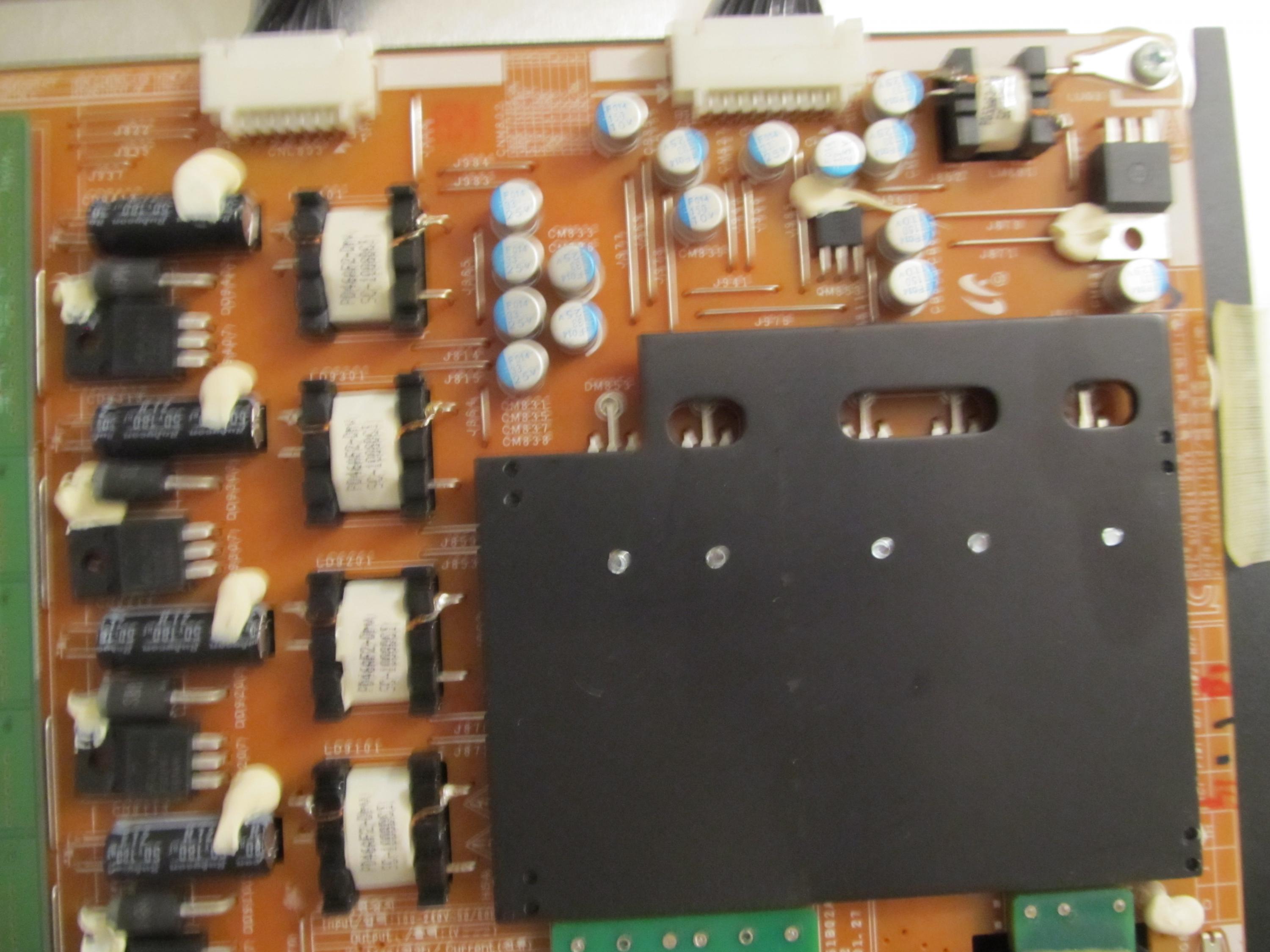

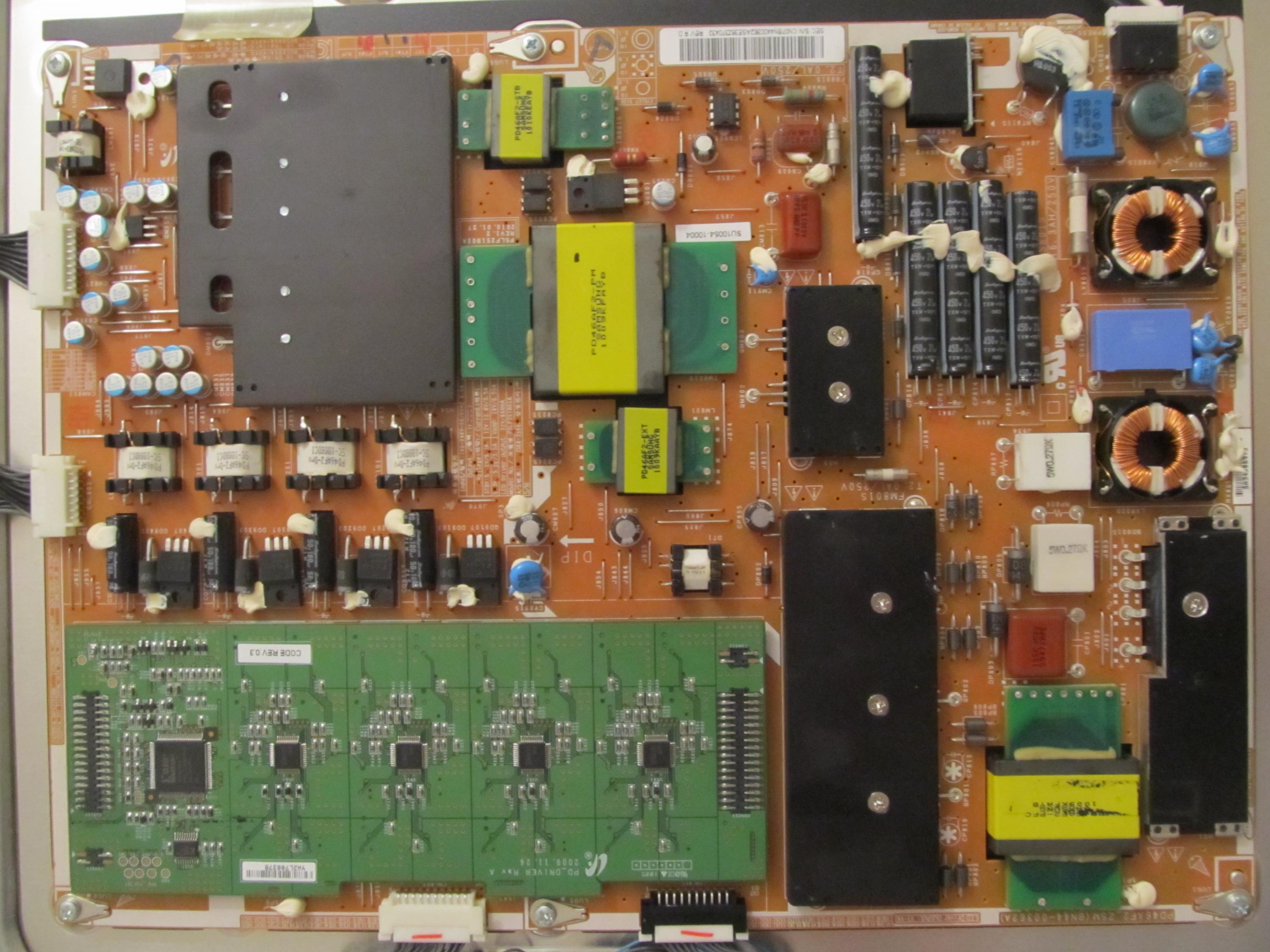

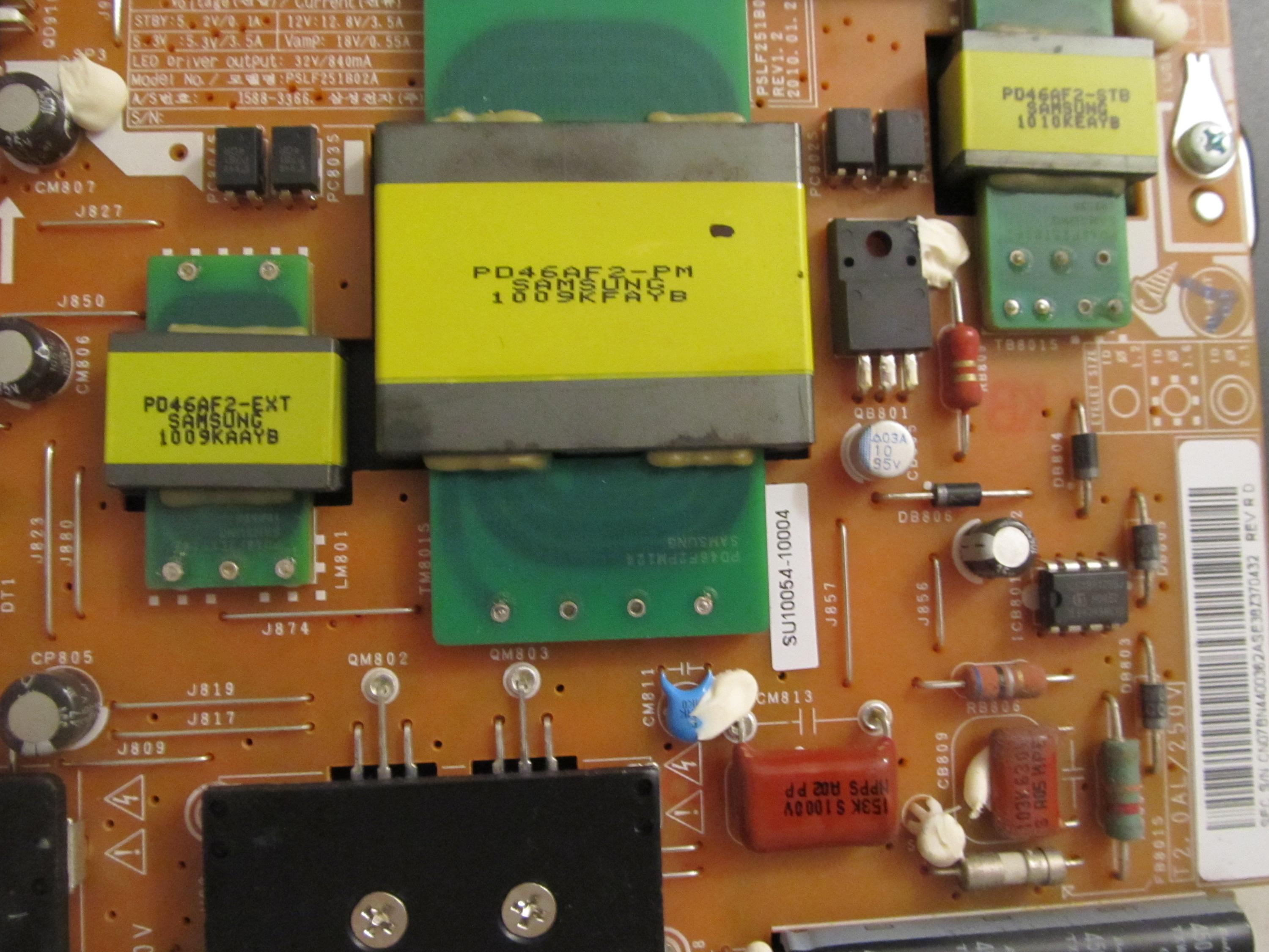

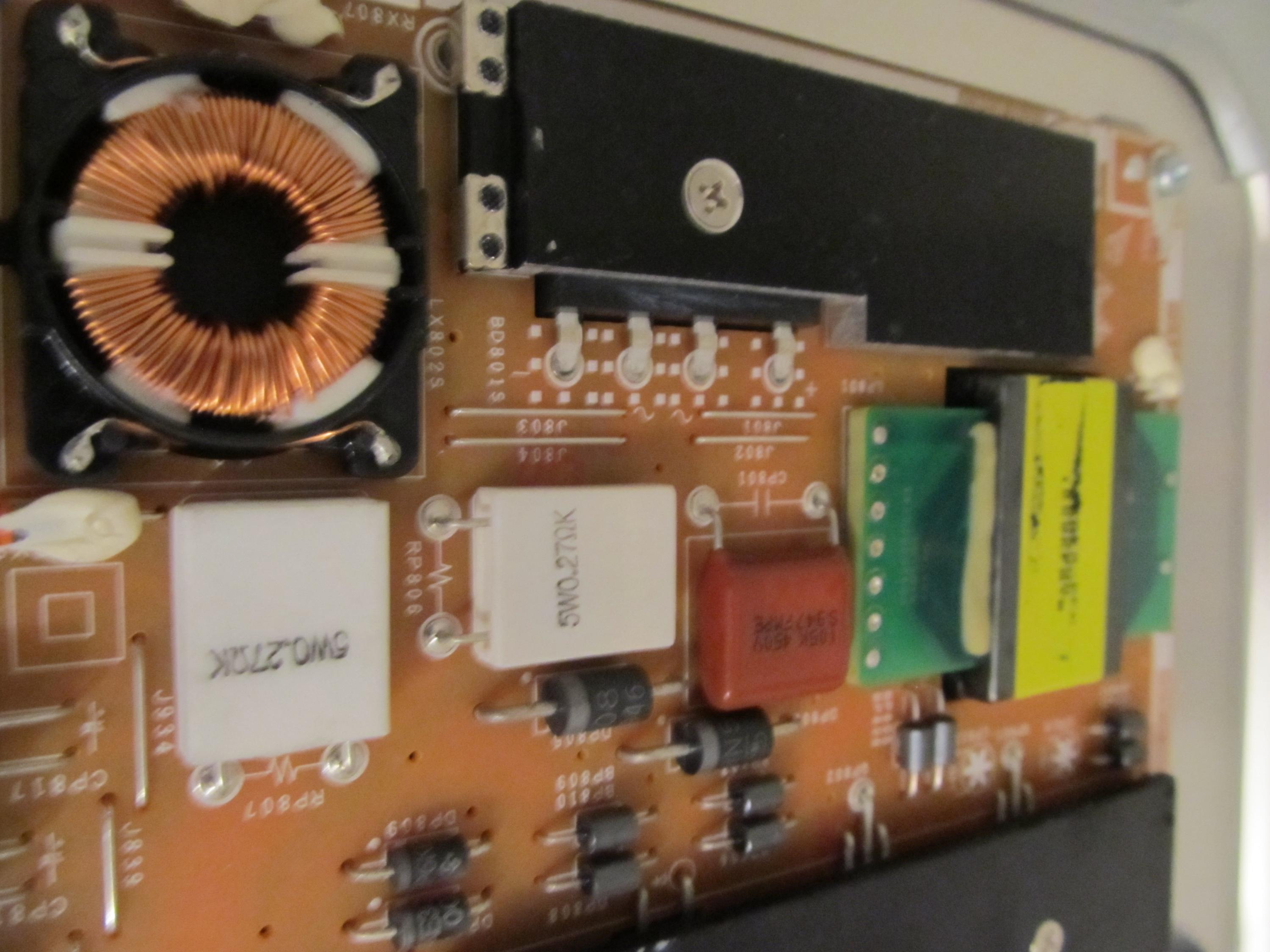

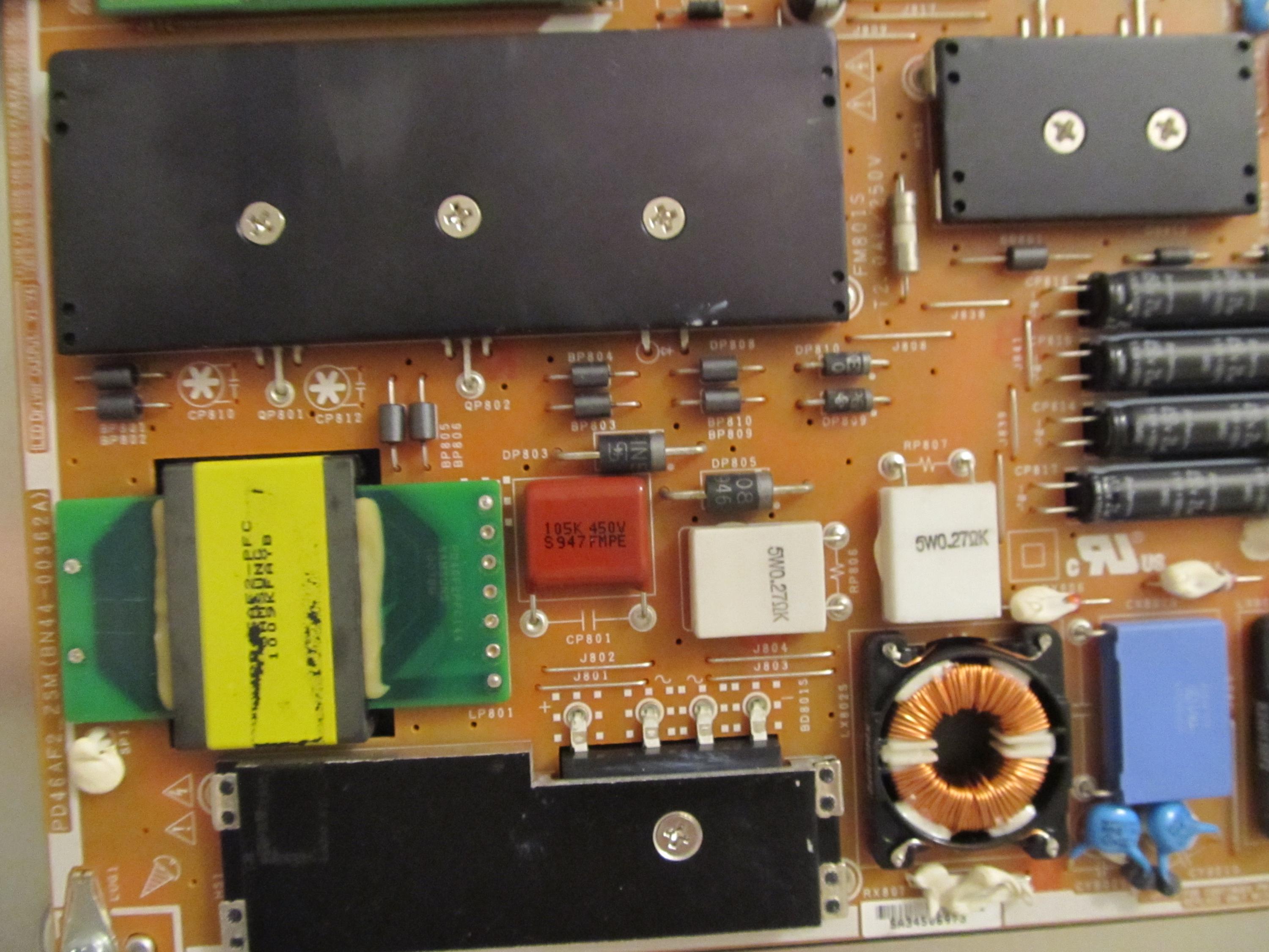

                    Main board
                    Power supply board.

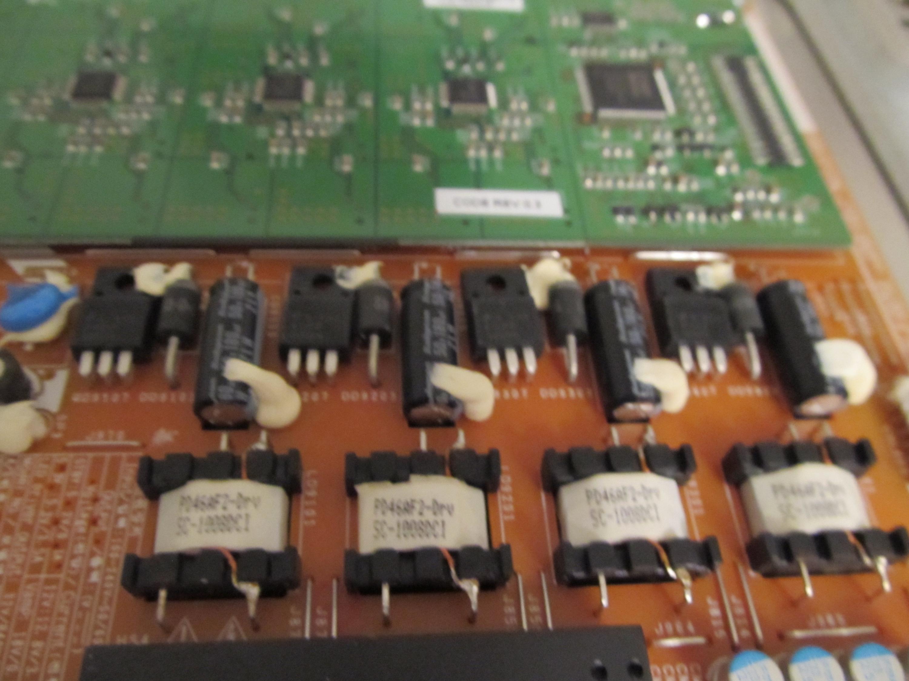

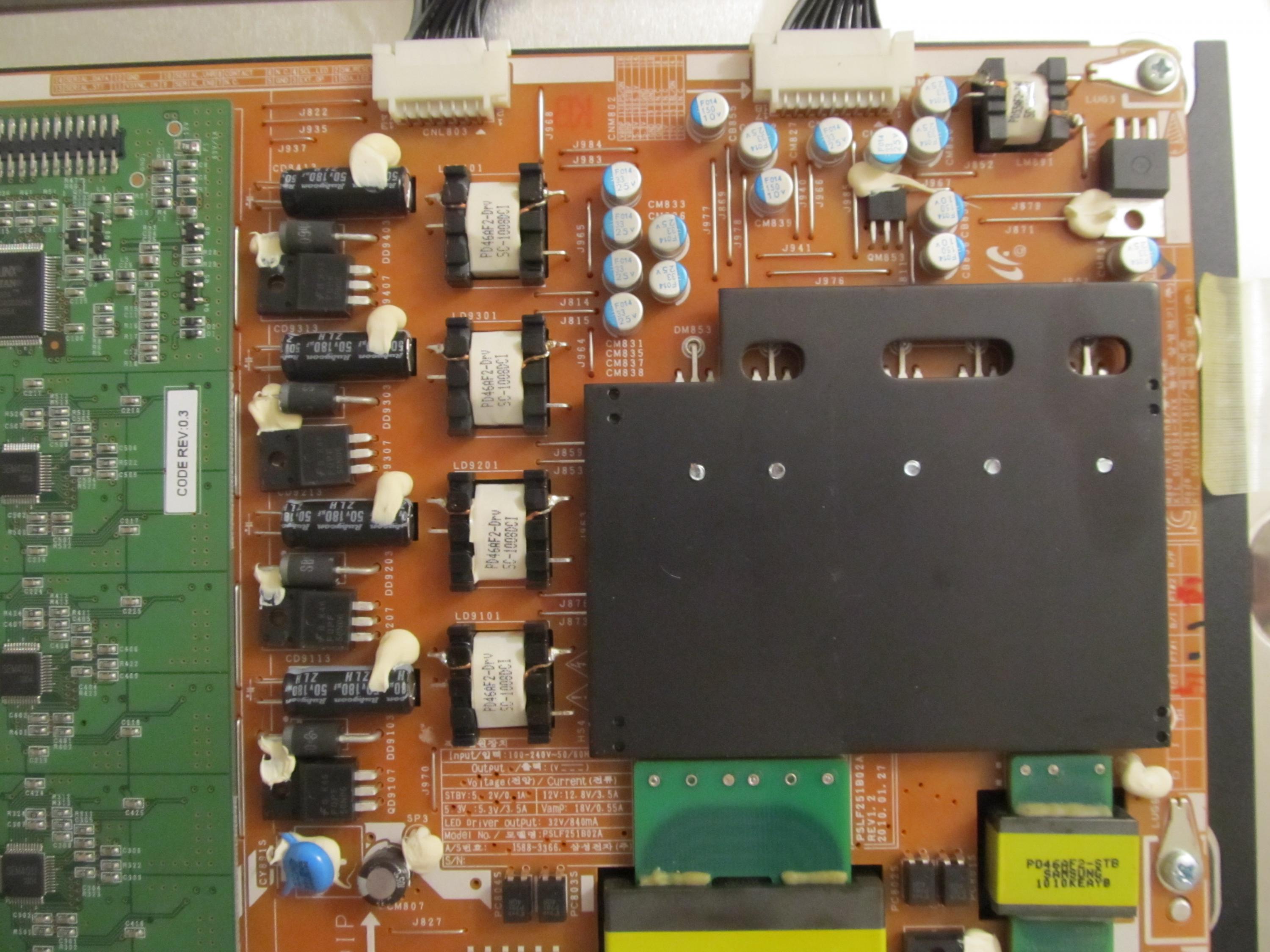

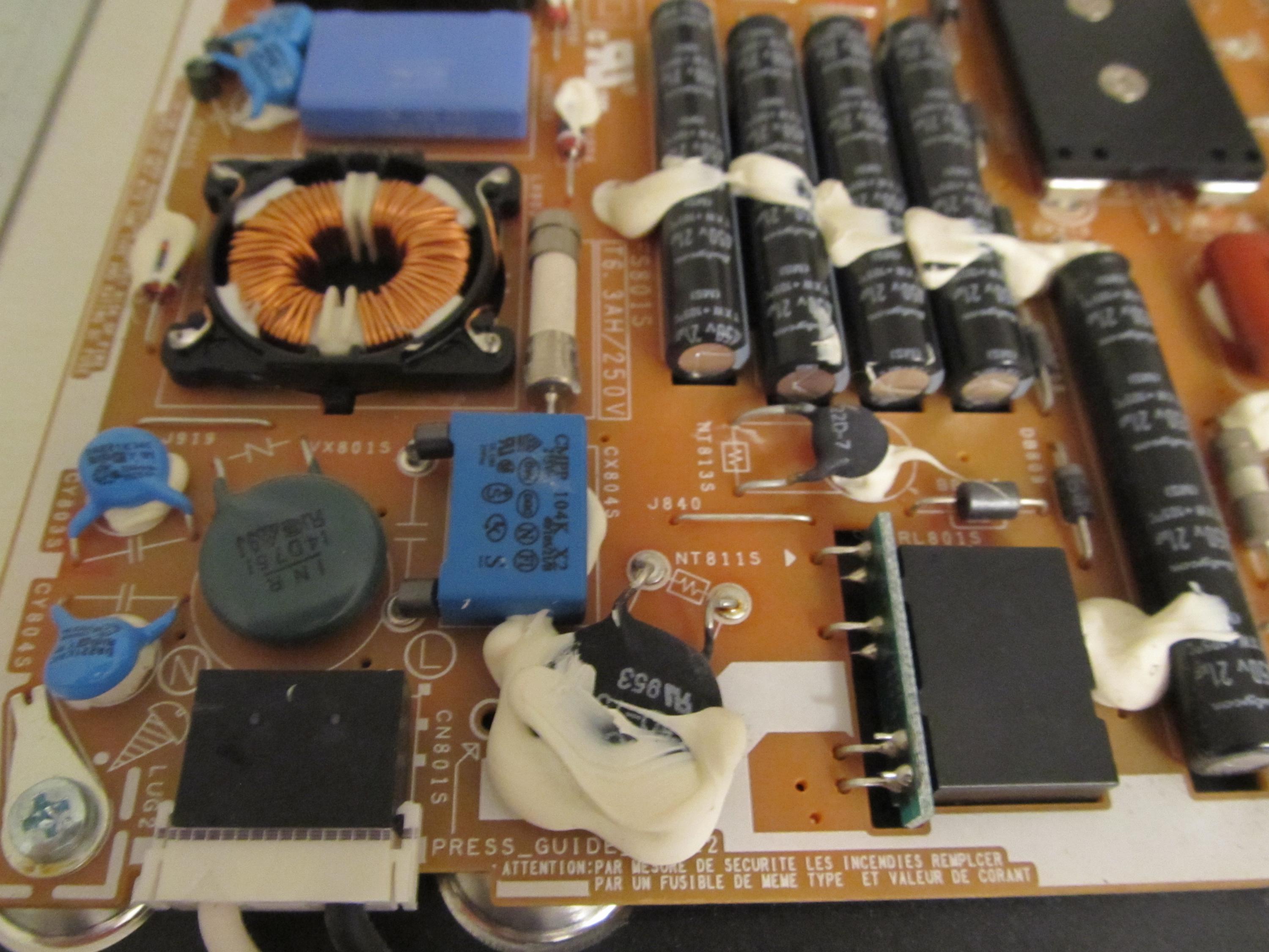

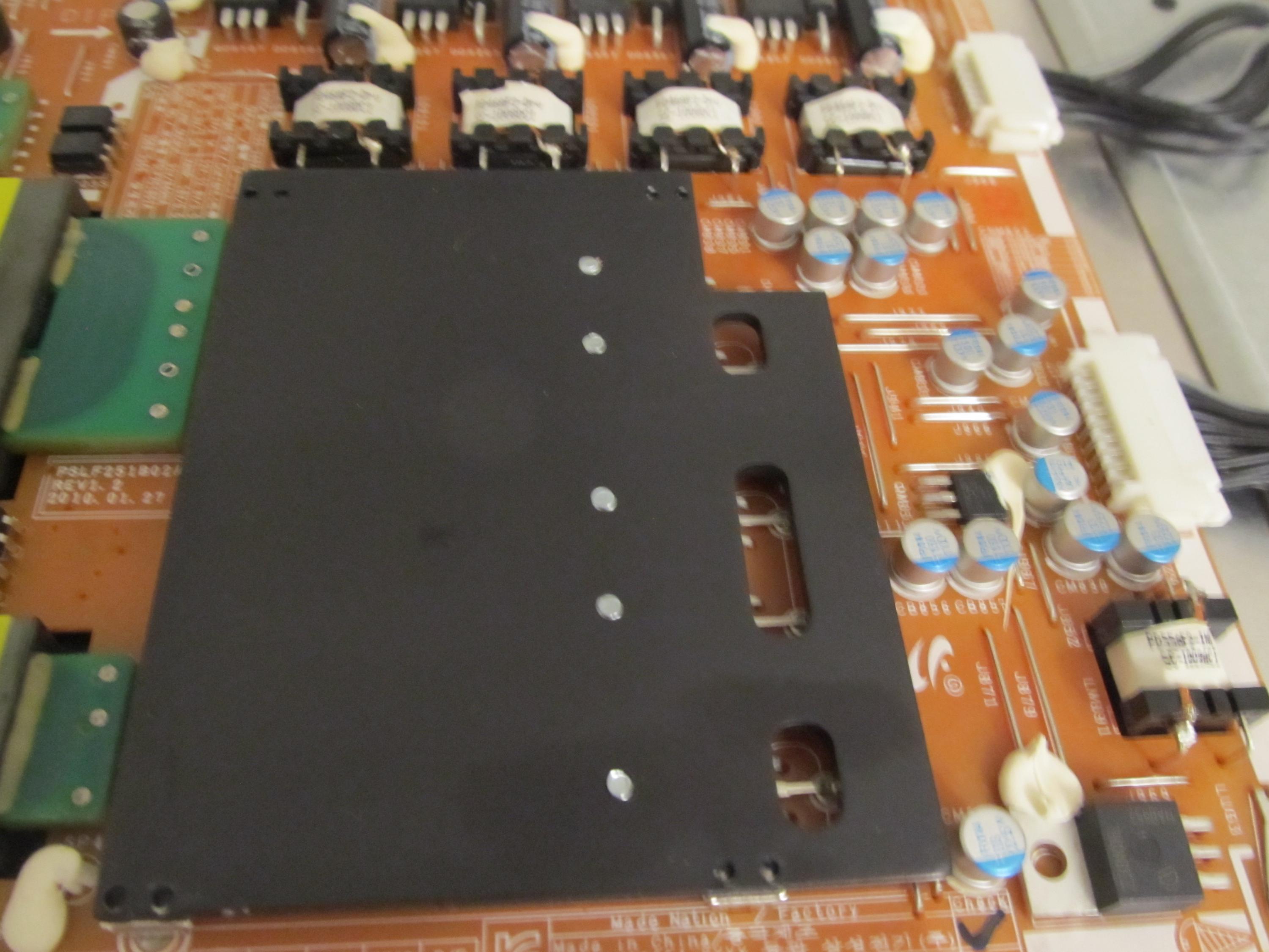

                    • whywontyouwork
                      • Feb 2015
                      • 7
                      Here is the power supply.
                      When I spoke with customer service and looked online, it was the board BN94-0296F that was replaced for this issue. It is the blue one I posted.
                        Put a hair dryer on the main processor (on the main board) for about 30 seconds and then try to power it up and see if the symptoms get better, worse or no change.
