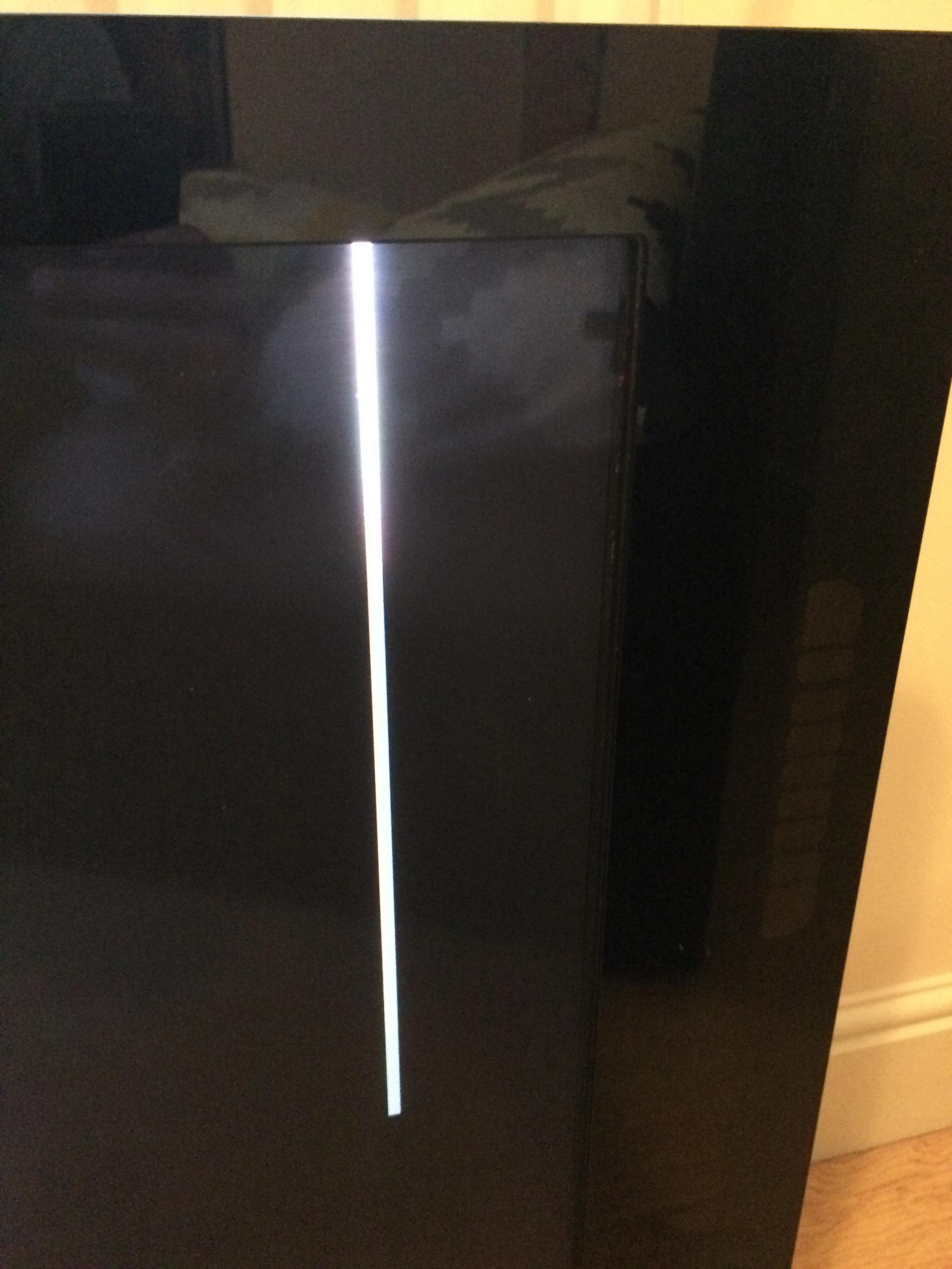

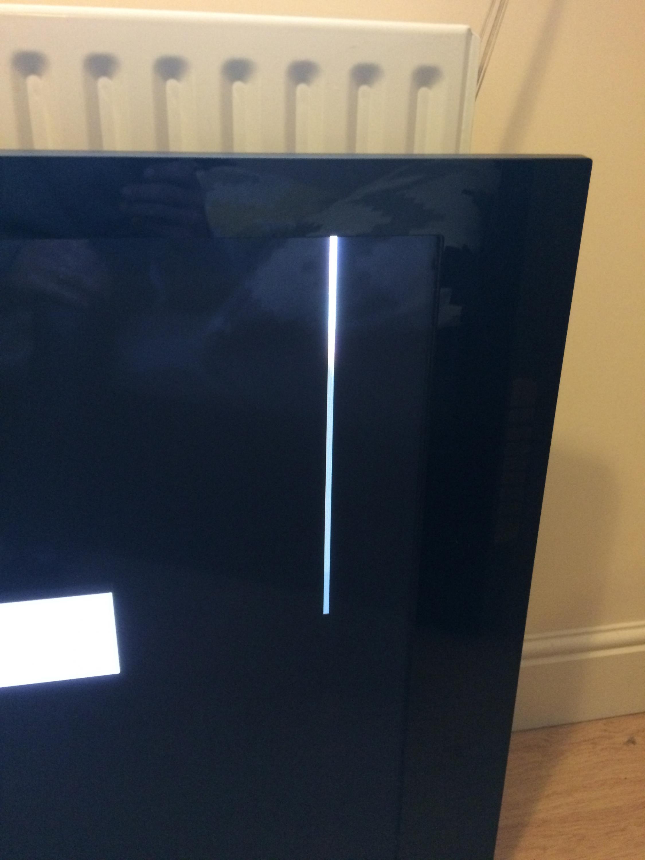

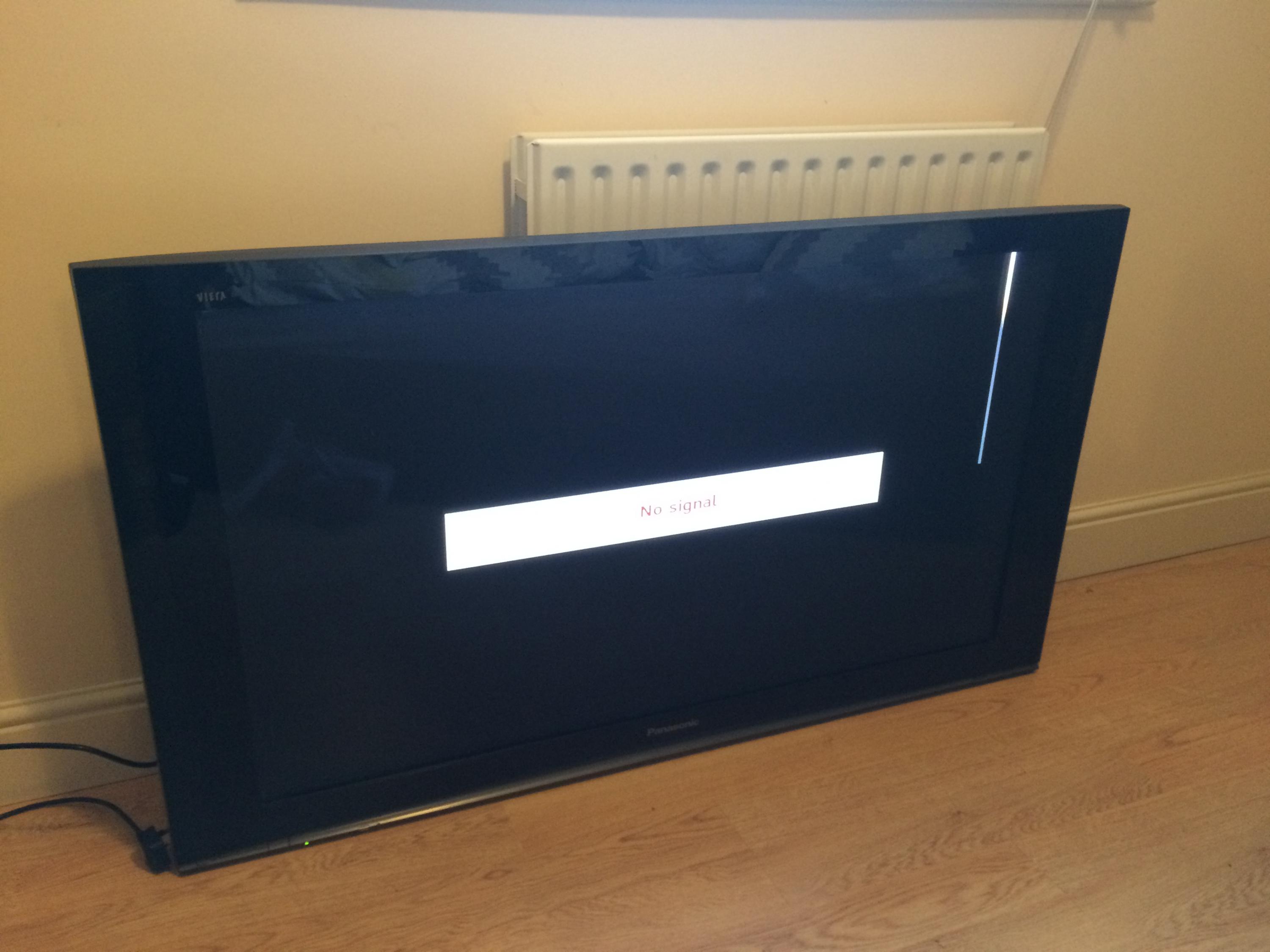

    Hi All!
    new to the forum, hoping to get some advice on an issue with my Plasma screen
    I bought the Tv from an auction yesterday, not really having any idea whether it would work or not.
    Got it home, plugged it in and bonus! It turned straight on with everything working as it should, except for one white/grey vertical line on the top right of the screen, extending about halfway down. It is less than a cm in width, very defined edges and is bright white at the top, shifting to a grey on the way down.
    I have taken a few photos to show the issue, but can't find a great deal on the net to explain the problem. Just wondering if it is a common issue or something that can be fixed at home etc?
    I have taken the back off the TV, and although it is very dusty, after a clean all looks to be in good order and all the ribbons etc are connected and clean as they should be.
    Can anyone shed some light on the issue?
    the model is a TH-50PZ70B
    Many thanks in advance! -Dan

          Re: Panasonic 50" Plasma white vertical line
          The PZ70 series use address-chips top and bottom. Looks like your upper address-chip in line with the issue has failed. These address chips are part of the panel, so unfortunately the set is stuffed.
          --It wouldn't be a SC buffer board fault--that would give horizontal lines.
          You may get lucky and find a poor connection to that address-chip, but experience says otherwise.
          --You may find that chip gets hotter than the others rather confirming the issue.
          It Wont be a Main Board fault IMHO....
            Hi Alastair, thanks for the reply!
            so the address chips require the full panel replaced then? bugger! I was under the impression that the horizontal lines would be caused by the side buffer (X axis) boards and vertical lines were produced by those along the top buffer board? because If I unplug the corresponding top ribbon the whole block turns white?
              Replaced the buffer panel today, made no difference unfortunately!
              Should I take it that the little white line of doom is terminal?

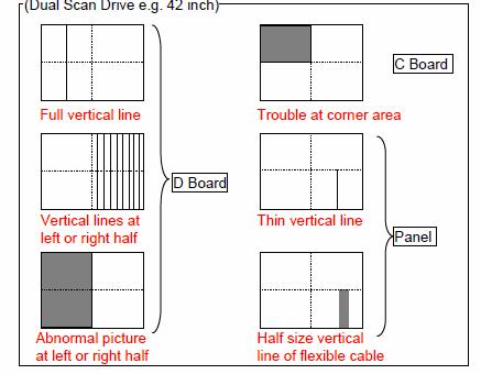

                Yes, Generally vertical lines are bad panels and horizontal are buffers
                • tw2005
                  • Oct 2011
                  • 6458
                  from the guide for this series

                    PZ70 series was first gen Full HD set.
                    To get all that extra resolution, the maker split the screen into four quadrants and used address-chips top and bottom reaching exactly halfway down the panel, most earlier and later sets dont use address-chips on both top and bottom as tech has moved on and all the screen can be driven by chips from one edge, while earlier 720p could be done with one set of chips....
                    These first gen Full HD Pan. Plasma sets are probably the most complicated and intricate ever made, but usually pretty reliable, just the odd panel failure and PSU issues....
                    I used to have a 42PZ70B, Excellent set with superb picture, sold it some time ago, working well Only drawback was its Huge power consumption and heat generation--505W!....
