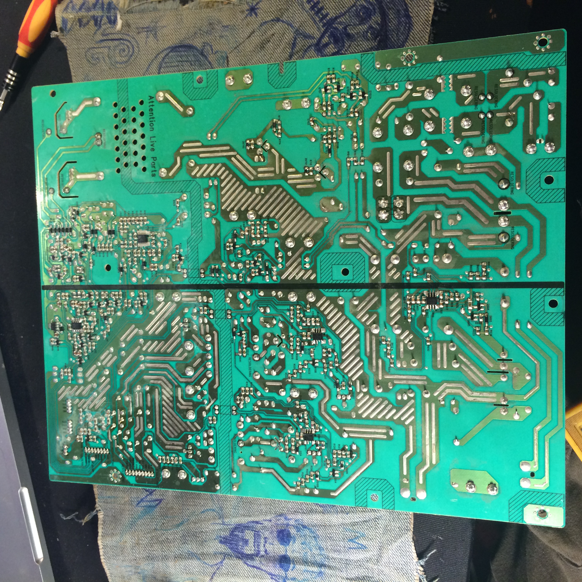

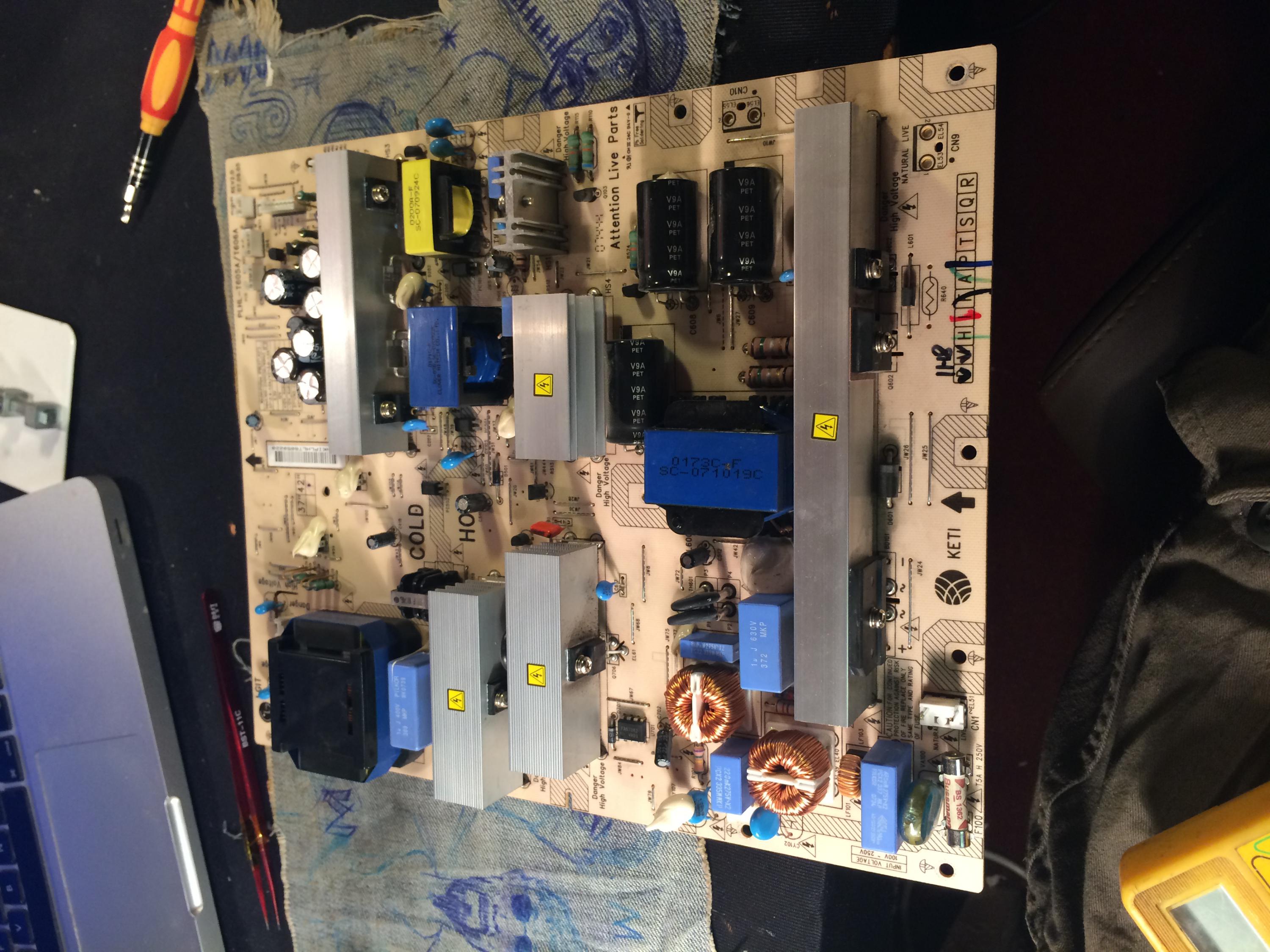

    Hey.. first post but hopefully lots more!!
    I have a philips TV i got in..
    Initially it was blowing the internal fuse so I took the board out and on the back was what looked like little burn marks on some of the traces, i cleaned them with isoprop and then put it back together.
    Now its not blowing the fuse but still not powering..

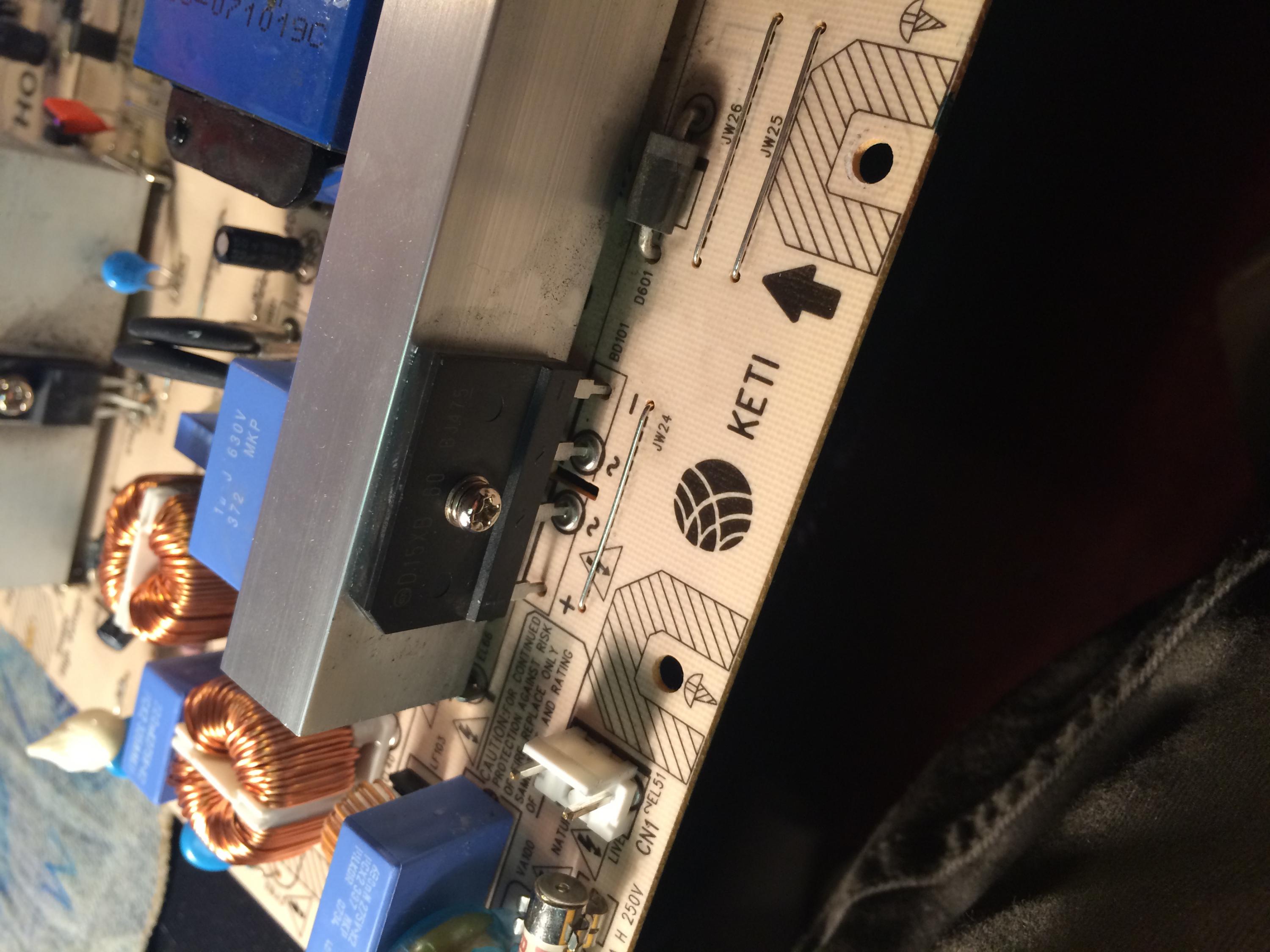

    Done a bit of research on here and decided to check the bridge rectifier..
    First I took readings with it in the board..
    1-2=532
    1-3=517
    1-4=0
    2-1=517
    2-3=1313
    2-4=517
    3-1=531
    3-2=1354
    3-4=528
    4-1=0
    Then removed it and took readings again..
    1-2=504
    1-3=489
    1-4=1142
    2-1=1
    2-3=1
    2-4=489
    3-1=1
    3-2=1
    3-4=498
    4-1=1
    4-2=1
    4-3=1
    Then I tested 1-4 on the board itself with the BR removed..
    1-4=0
    Where too next or any idea of what the prob is..
    Thanks in advance,
    Liam
    Re: Philips 42PFL5522D/05 Not Powering
    Looks like you have a short on the output side (DC+/DC-) you should check the other MOSFETs/diodes on the power supply heatsinks for shorts. You only need to check across Drain and Source for a short on a FET.
        They should all read open circuit - probably a single "1" on your meter. A result near to zero is suspicious - remove the device to confirm.
        BTW, you should not use BS1363 ("Bussman") fuse for power supply. It is designed to protect cabling and plug not power supply. You should consider using a light bulb tester. It will save you from blowing more fuses.

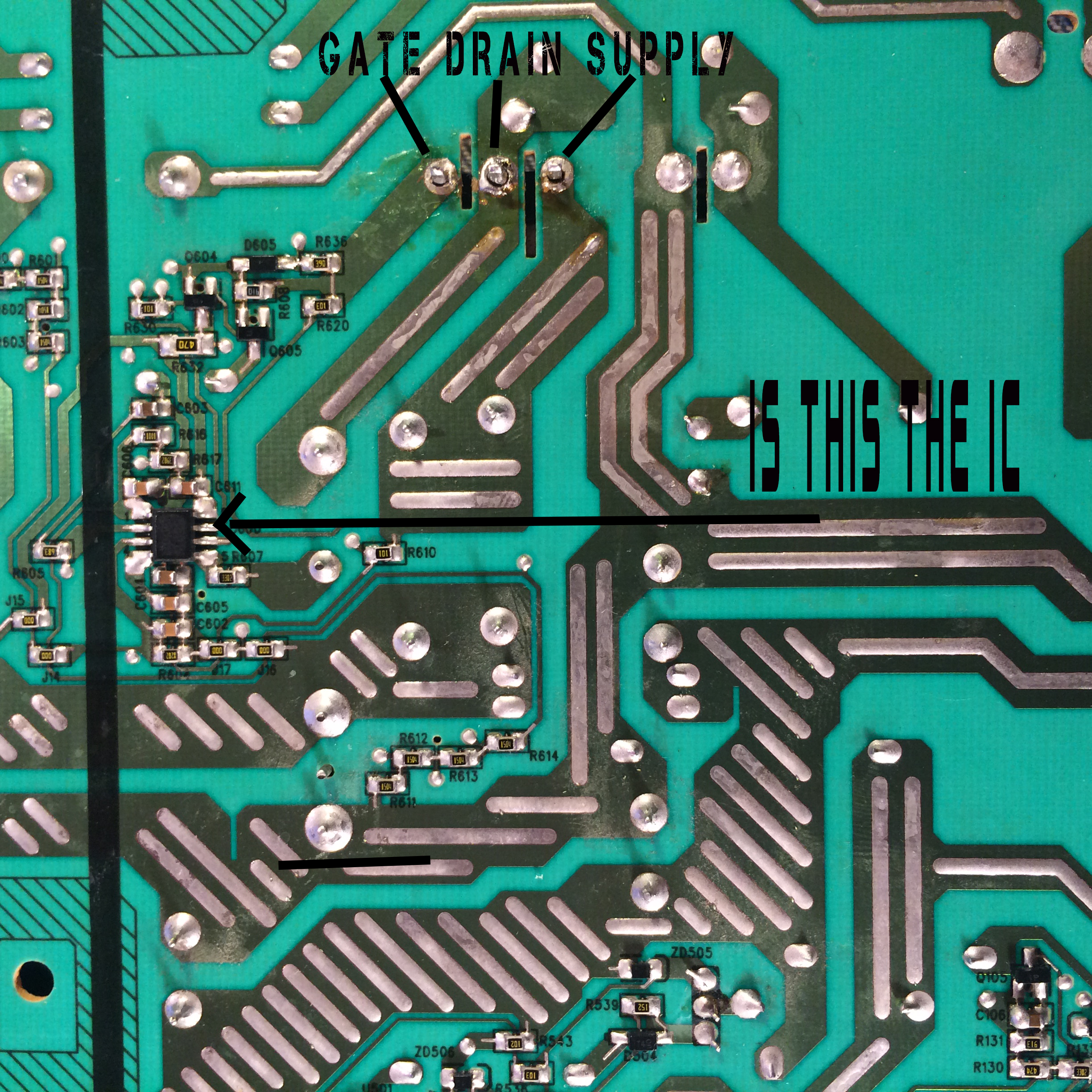

              You will need to replace the FET and the IC responsible for driving the FET... You can usually find this IC by tracing back the gate pin on the FET.
              You have to replace the IC because the IC can be invisibly damaged by the FET failing. If it is bad it can kill a new FET and cause other damage.
              • liamoc74
                • Feb 2015
                • 80
                • Ireland

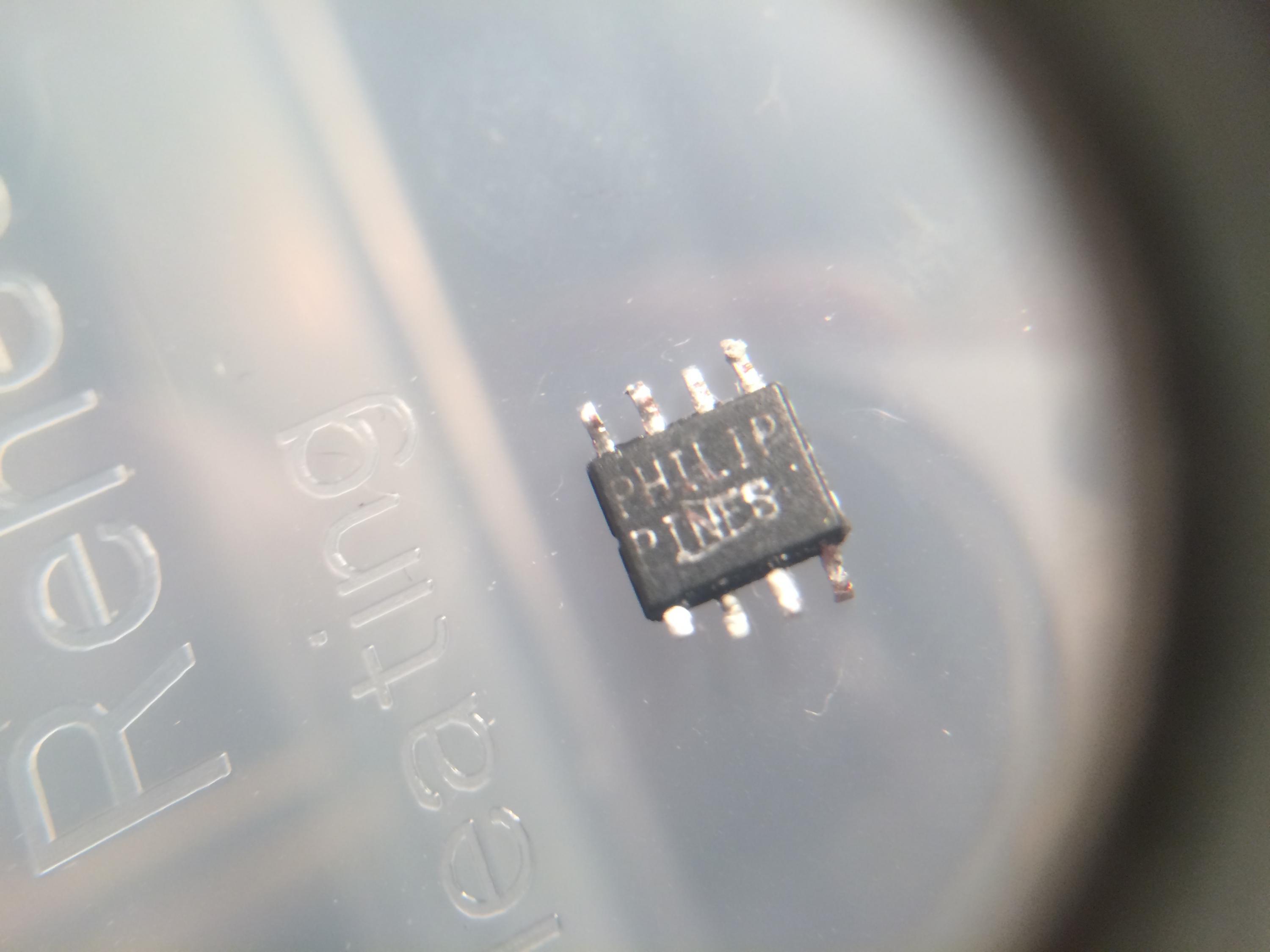

                Okay sound, found the fet on ebay for a couple of quid..
                With the IC, is it the one ive noted in the pic..?
                How can i test with multimeter, try'd continuity but no joy..
                Pic attached..
                  That's the one.
                  BTW: It's source, not supply. The source is the most negative end of the transistor so is in fact the opposite of a supply. You can remember it's a "source" because the electrons flow out of it (in a conventional current model), whereas for the "drain" they drain into the transistor.

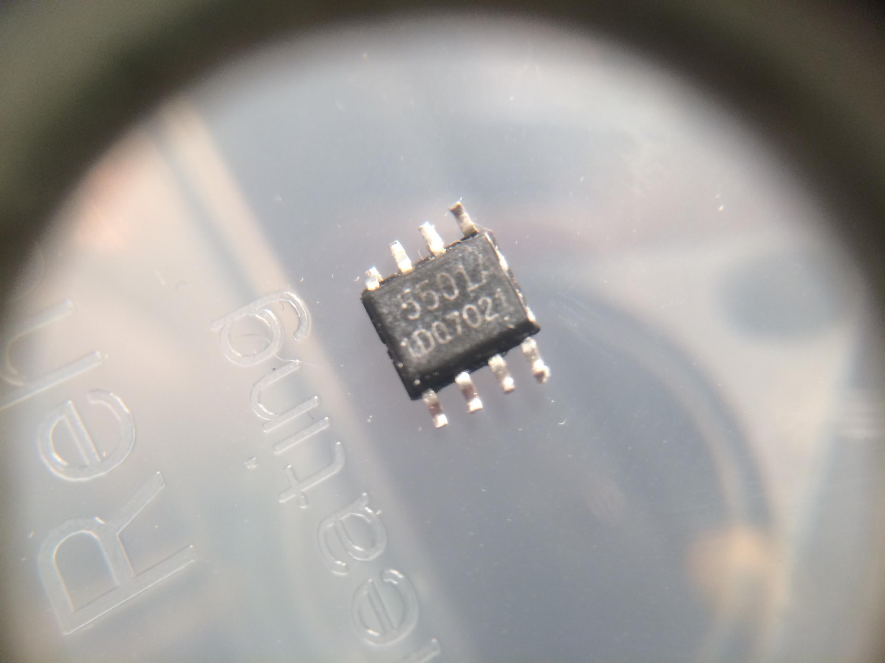

                      Any ideas where i can get the ic from..
                      Number on front is...
                      5501/1D07021
                      On the rear is
                      PHILIP
                      PINES
                      Any ideas - done some looking but nothing coming up..
                      Cheers
                        Are you sure it's "5501" and not something like, "S501"? Could you get a picture of the markings?
                        • liamoc74
                          • Feb 2015
                          • 80
                          • Ireland
                          Seems to be
                          5501A 1D07021
                          not
                          5501/1D07021
                          Still cant find anything tho..
                            The "A" gives me this, a FUJI FA5500A PFC controller IC:
                            https://cdn.badcaps-static.com/pdfs/...e9f5f9227d.pdf
                            Available from ~£7
                            http://www.ebay.co.uk/sch/i.html?_fr...5500A&_sacat=0
                            • CapLeaker
                              Leaking Member
                              • Dec 2014
                              • 8352
                              Google FA5501A it's a power supply control IC.
                              tom beat me to it.

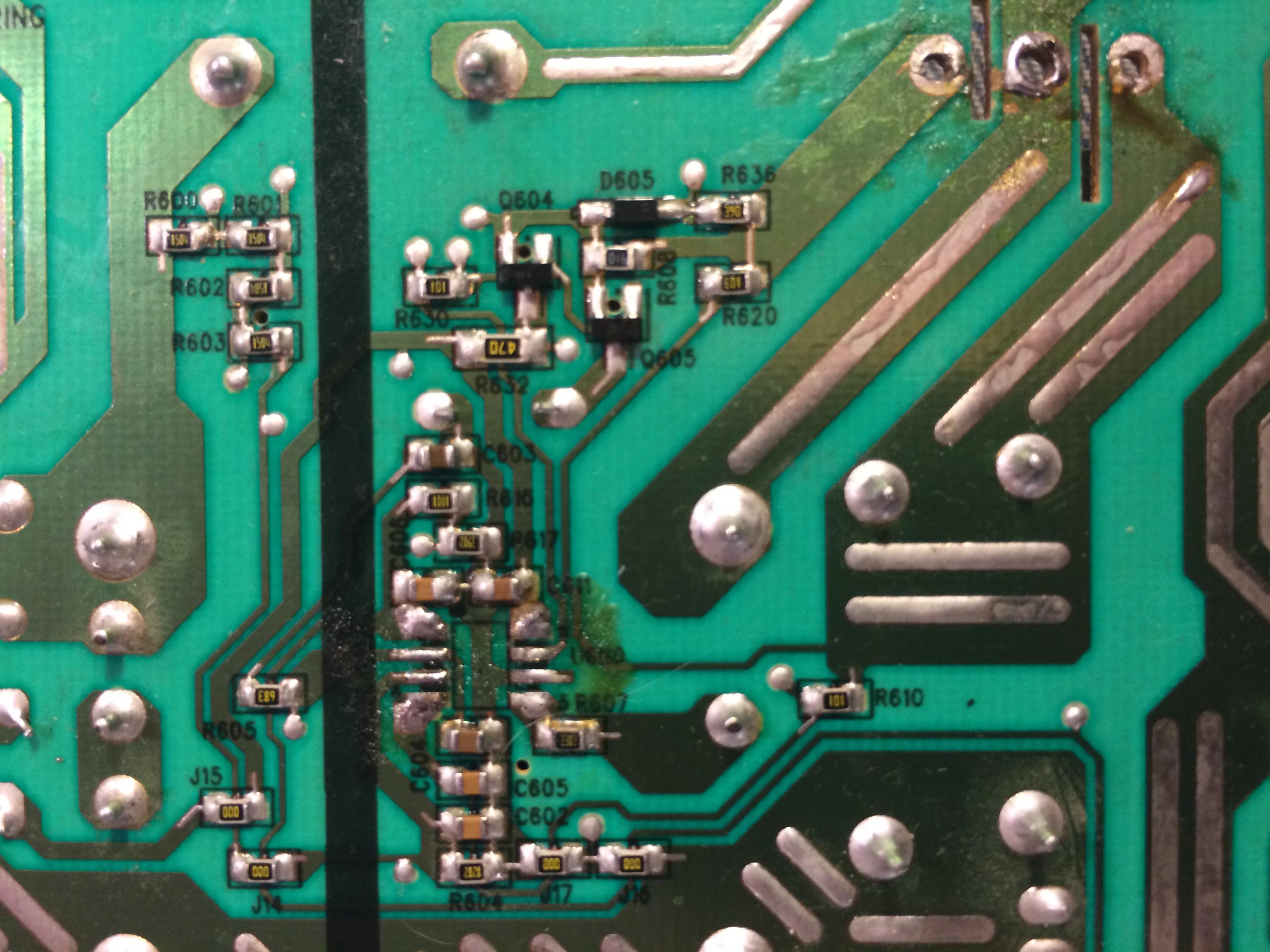

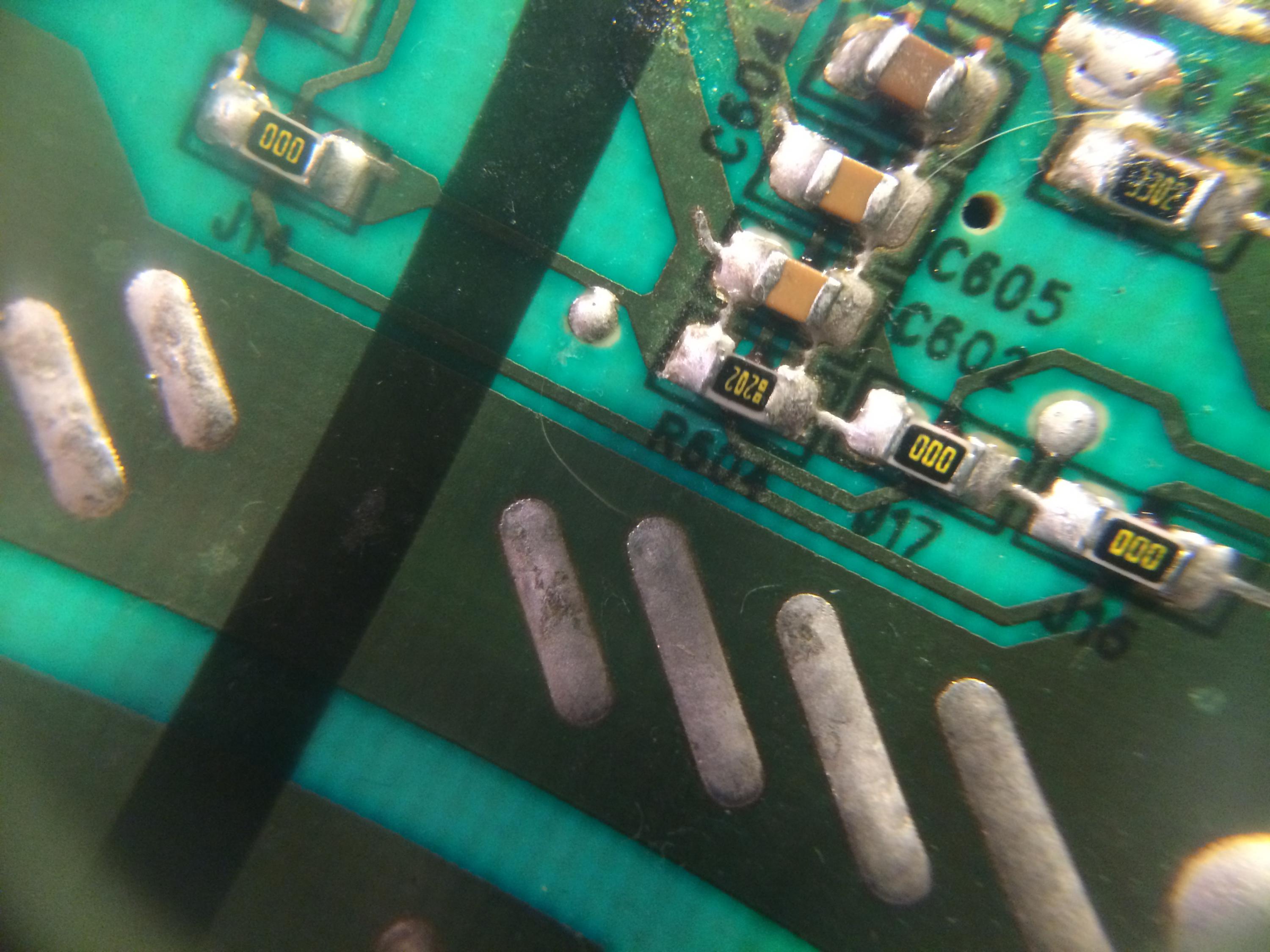

                                BTW, once you remove the FET and the IC, check the resistors and diodes in the gate area of the transistor. They usually survive but sometimes they can be damaged, if so it would be good to replace them too.
                                    I know it is a PFC controller, in SO8 package so I typed "top marking 5500A PFC controller so8" and it was one of the top results

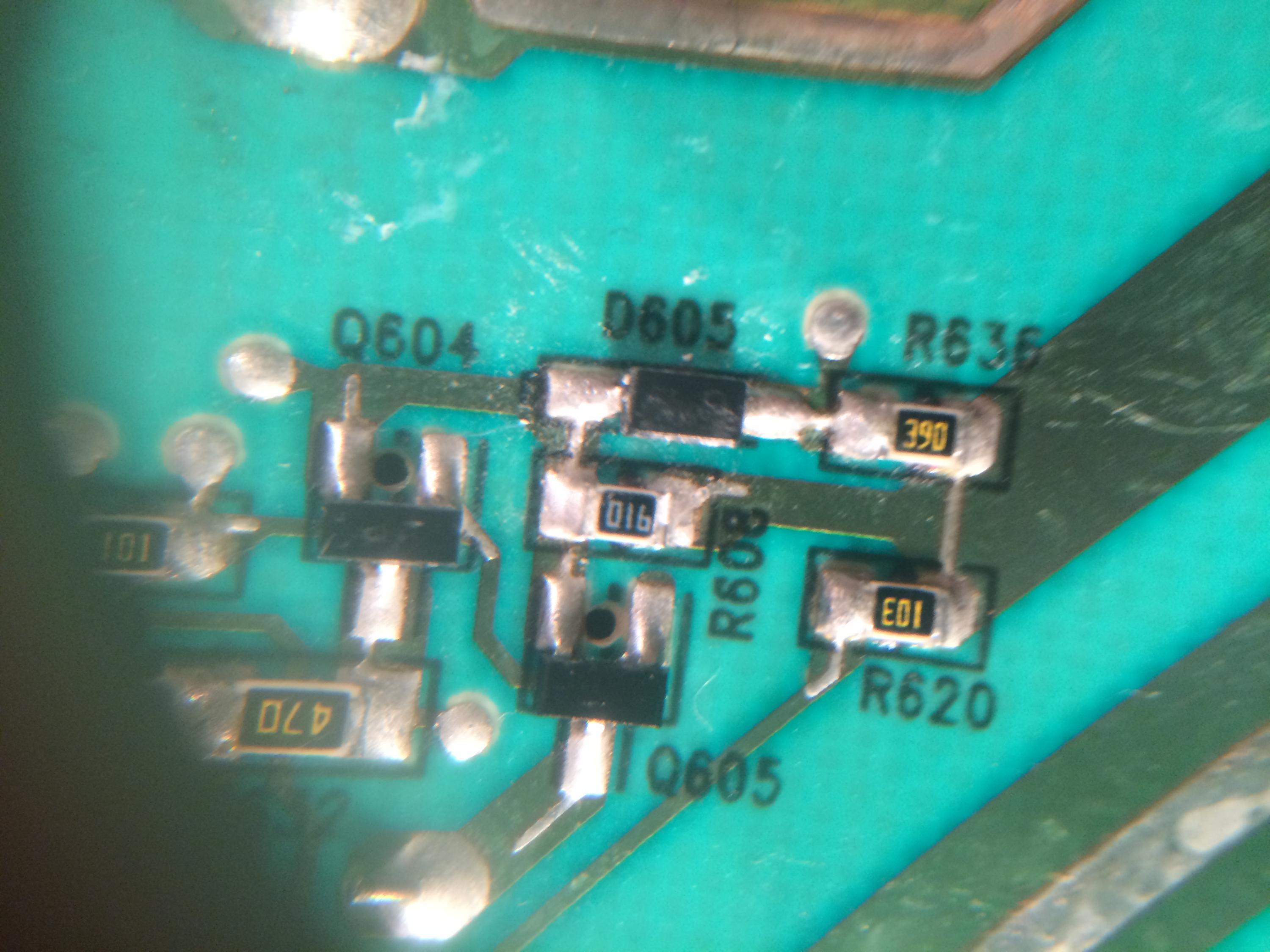

                                        Okay, I got the ic and fet ordered!
                                        Tested all the resistors, all good..altho the one on top left "R604" has different markings on it, 2 little squares..what do these mean!
                                        The diode "D605" is reading 130 with leads each way, that means its bad right.?
                                        Looking at the diode, all i can see is a 0 at the bottom, what does this indicate.?
                                        Also, trying to find info on testing smt caps but not getting anything solid, some people saying ya cant test them in circuit, some say you can but i cant seem to get any readings - anyone guide me in the right direction!!
