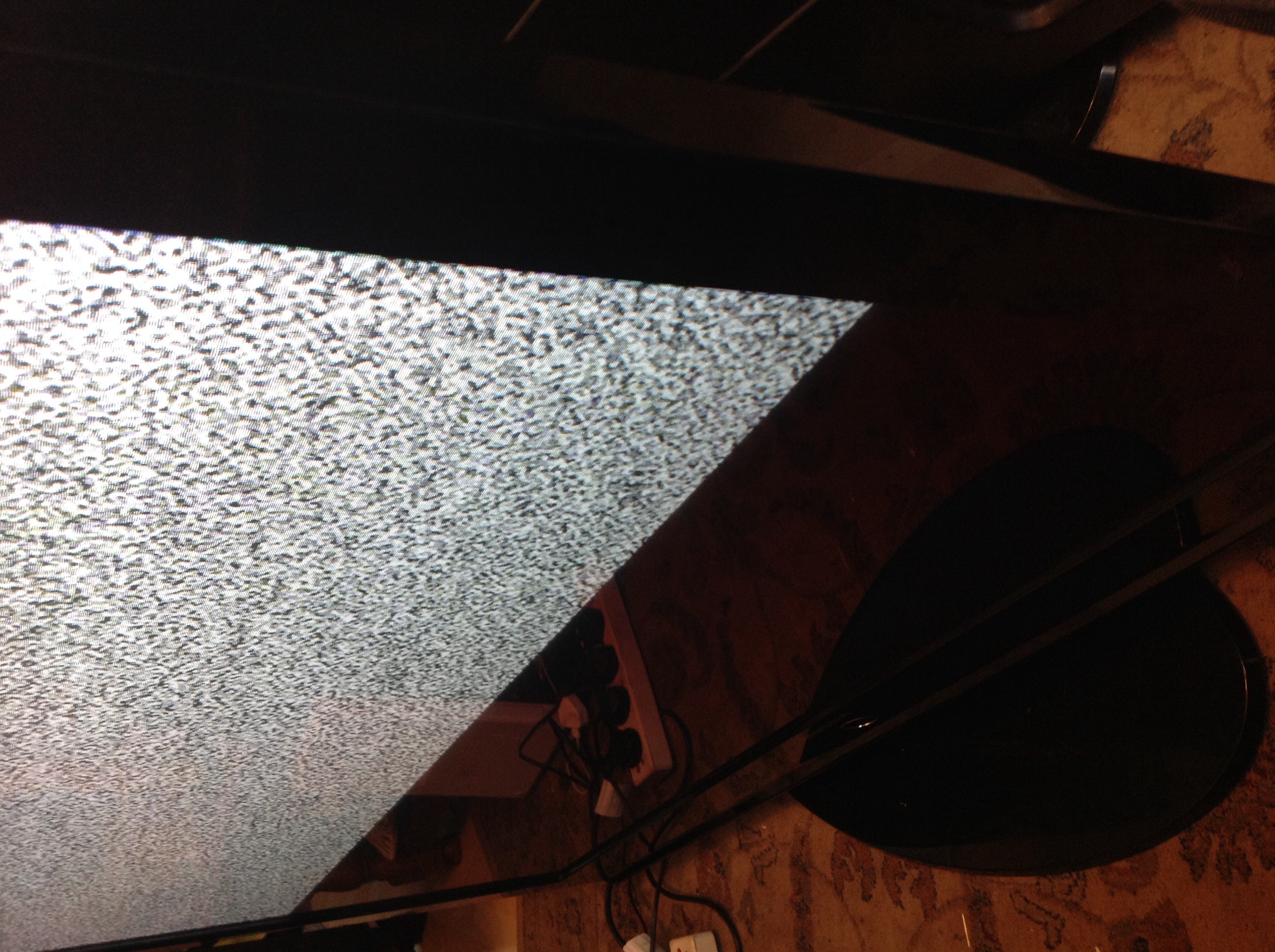

    Hello we need help with this samsung Ps-50Q96HDX/XEU as this plasma has 3 of us tv techs at our knees, the ysus was repiared by replacing the whole row of power mosfets, there we two blown mosfets that had als blown their resistors replced them with good exact parts. The tv will now work I see that the xsus has lit its back row of pixels but the ysus isnt lighting its from row and nothings workson thelowwer half of the screen, checked the ysus over and over and cant find nothing out of spec, the ysus is a LJ41-50120A can anyone who has repaired one of tese before give us an insight into what to check next, any help is much appreciated thank you.

    Hard to tell what you're referring to... bottom half missing or the interlaced lines? The lines appear to be the pixel drive lines and are normal.
    BTW, X-main and Y-main both drive the -whole- screen, both X-main and Y-main appear to be working, likely it's a Y-buffer fault (check cable between buffers seated properly)

      From the picture most likely the bottom connector from ysus board to buffer board either not seated properly or not at all.

          Tried different buffers and still half a screen so that leads us to think that the ysus is still faulty. As this model of ysus seems to have a lot of issues will caps going bad then wiping out the power fets and small smd parts, we are going to try replacing the old ysus or repair it.
            Re: Samsung Ps-50Q96HDX/XEU
            I really doubt the Y-sus/Y-main is causing this fault as you have an otherwise good image on the working half. There is a small chance the data isolator which carries the data from Y-sus/Y-main to the Y-bfufer is bad but I would say that is pretty rare.

                Do you mean that you can see the bottom of the screen backlighting but nothing being displayed? If so your buffers are working correctly but data is not being transmitted to the lower buffer.

                    Have you checked the ribbon going from the control board to the YSUS? Also make sure it's seated properly. on this model the control board is completely covered up by the main board and its a pain in the arse to get to unless you remove the main board and bracket and I have made the mistake in the past of pulling out the ribbon from the control board causing all sorts of symptoms when it was just something simple. Also I have seen ribbons with micro fractures causing data loss.

                        Just sorted this tv months after turns out there was a shorted ceramic capacitor and zenerdiode behind the lowwer heatsink with the fets with the fets mounted on replaced that and lower half of screen come back
