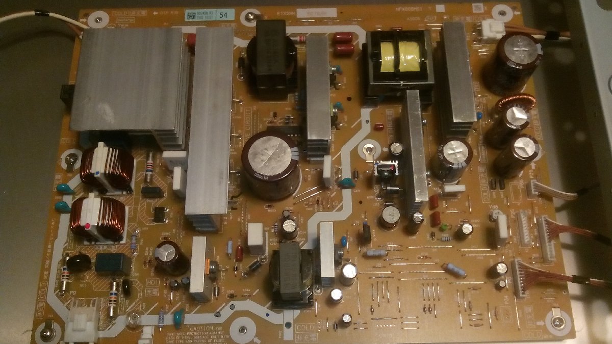

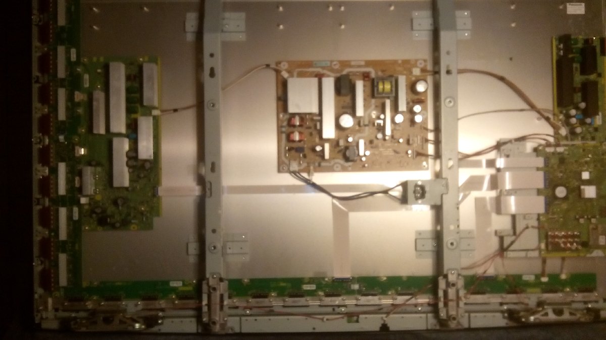

    I just got in yesterday a nice Panny TC-P54 Unfortunately, I left the back at the shop (working from home today) and don't have the rest of the Model Number..
    This unit does not power up. Does not light up. Completely dead.. The only thing I notice is a slight power hum in the vicinity of the Power PCB when I plug in the unit..

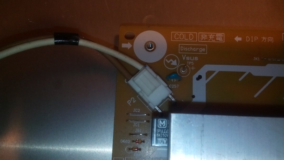

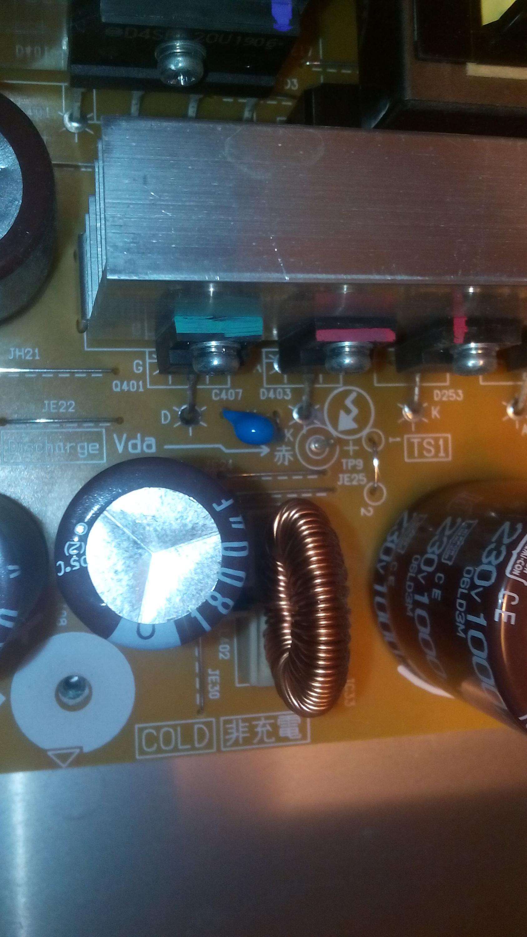

    Right off the bat, I noticed some differences from the last Panasonic.. There doesn't appear to be any VS or VA connections. Further, no voltage label on the back of the display. There IS a VSUS TP and a VDA TP on the power PCB, but that is all I can find.. There are a few TP posts scattered through out the Power PCB, but only the VSUS and the VDA are marked. There is 0V on the VSUS and VDA points.. The only voltage I have confirmed is the incoming voltage of 120v AC...

    most likely Tc-P54g25. remove the SC2 and sc20 leads and see if any changes
    don't reconnect after shutdown, if it powers up. vsus can be measured at either p2,sc2 ss11 or p11, 203v or so i think. get use to no labels from 2010 on.

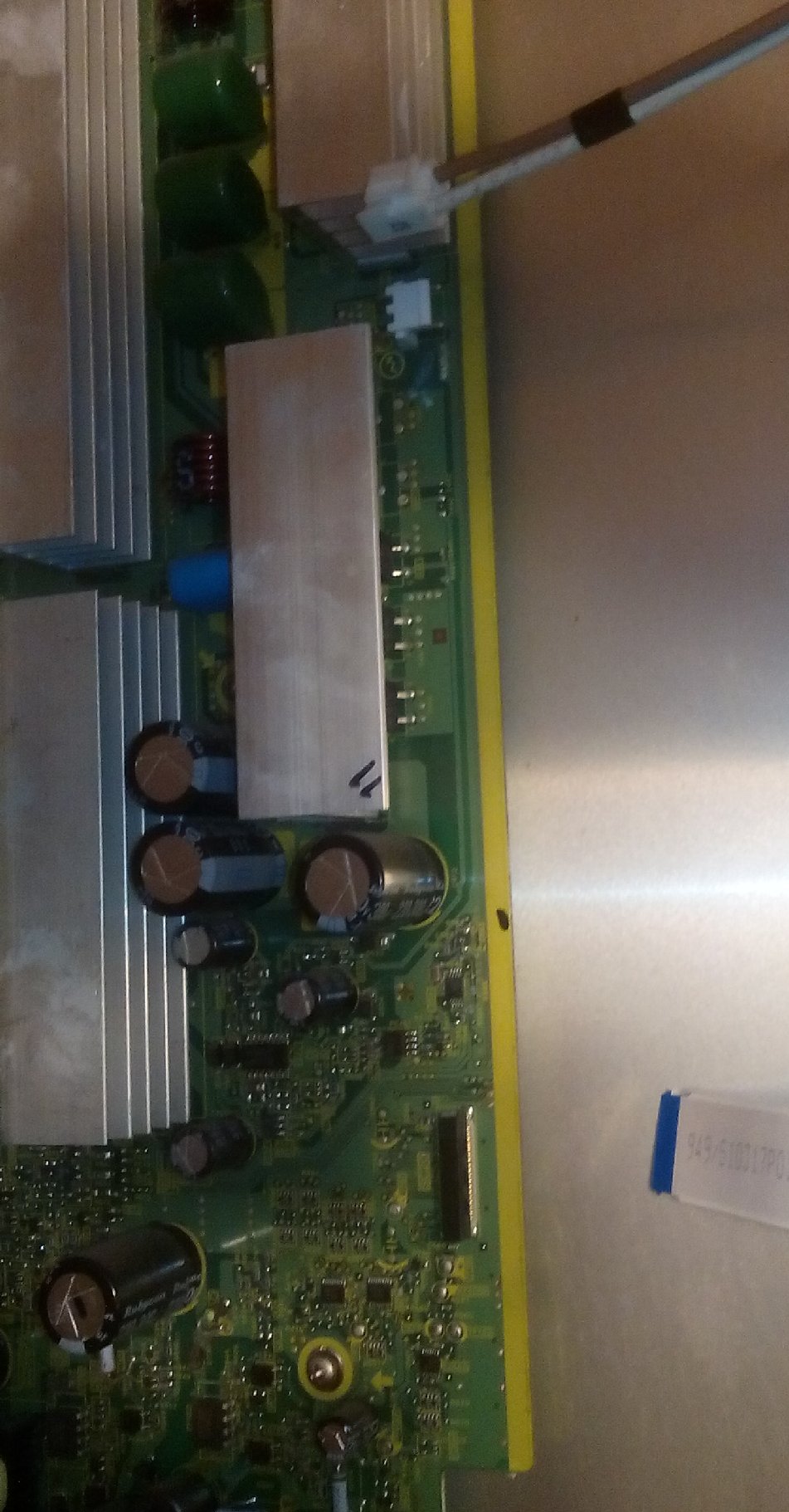

      Disconnected SC2 and SC20 (pic)
      Still dead...

        I was jumping the gun a bit. sounding like A board but i'd check across sc2 for short as these have a habit of blowing the SC shorting Vsus. A7 pin 1 is 5v stb, any life there?
