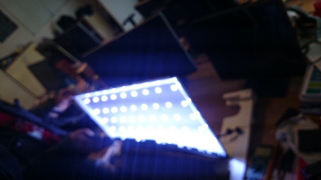

        #83
        Re: Samsung UE32F5000 (UK model) with no display. Power supply is OK.
        Not so fast...
        I’ve tested all them again with reverse polarity and all them but ONE faintly glow. I didn’t notice this glow before, because the room was very lit, but now with less light it’s clearly visible.
        This brings me another thought: how could be possible that there were 3 open LED? They failed at the same time? Impossible! Since all 45 LED are in series, after one opens, there’s no chance for others to keep working and get open some time later.
        So my conclusion is: there’s just one open, and perhaps 2 or 3 that show some wear and may fail sooner.
        I’ve had the brilliant idea of replacing that LED with one scrapped from a cheap chinese LED light bulb. Well, it has worked... for a few seconds. The cheap LED has shorted, while the others still working. Same as puting a wire bridge...
        I’ve discovered how hard is to unsolder these high power LED. I wonder how will I unsolder good LEDs from another panel and keep them usable. Hot air? Will they melt?

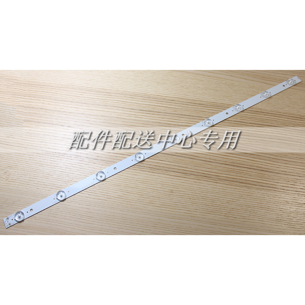

              #86
              Originally posted by ralphup
              Thanks, good video.
              I ordered two LED strips from AliExpress. Since I planned to use the "stacking" method (as explained by ReeceyBurger), I ordered those strips with best price/number of LEDs ratio, so I ended buying two 9 LED stripes (0.75€ per repair unit). There're others with same price but less LEDs per strip:
              http://www.aliexpress.com/item//32640850145.html
              Now I see there're other cheaper options. I'd try this lot of 5 strips with 10 LEDs, 0.48€ per unit:
              http://www.aliexpress.com/item//32656826571.html
              Well, after one month wait for the LED strips, I remove damaged LED, clean solder pads, put a piece of kapton tape over the soldering pads, apply thermal paste, cut a piece of replacement strip and solder with wires.
              I think that some extra care has to be taken when cutting pieces of aluminium strip. Since copper tracks are closely printed over aluminium, I use a metal file to remove sharp irregular edges and prevent copper track from touching aluminium base in any way.
              It works for a minute and darkness again. Why? Neighbor LED has shorted, and the next one doesn't test OK either. Replace these two and now it resists. I've lowered Backlight intensity from 12 to 8 (surprisingly, it wasn't set at maximum 20). Now I'm testing it before returning it to customer. I can't notice any color difference. In this sense, it's a success. My main concern is: how long will last remaining LEDs?

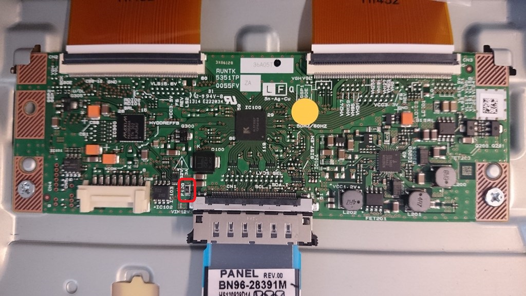

                  #88
                  Check the fuse on the Tcon for continuity
                  Check the voltages given on the Tcon
                  For example
                  VIN12V =
                  VGH =
                  VGL =
                  VCC3.3V =
                  VCC1.2V =
                  It appears as though these Tcon boards are troublesome.
                  https://www.badcaps.net/forum/showth...ighlight=runtk

                    #89
                    Thank you for fast answer. Fuse is OK.
                    Where I check whe voltages on Tcon?
                    Thank you
                    • dick_barton
                      • Aug 2015
                      • 6643
                      • Wales
                      #90
                      The points are all marked on the Tcon and will be shiny copper pads.
                      • mihu84
                        • Mar 2016
                        • 3
                        • Slovakia
                        #91
                        Do I understand this correctly?
                        IF yes, this are measured values.
                        VIN12V = 12.95V
                        VGH = 0.03V
                        VGL = 0V
                        VCC3.3=0.05V
                        VCC1.2=0V
                        I need change Tcon board?
