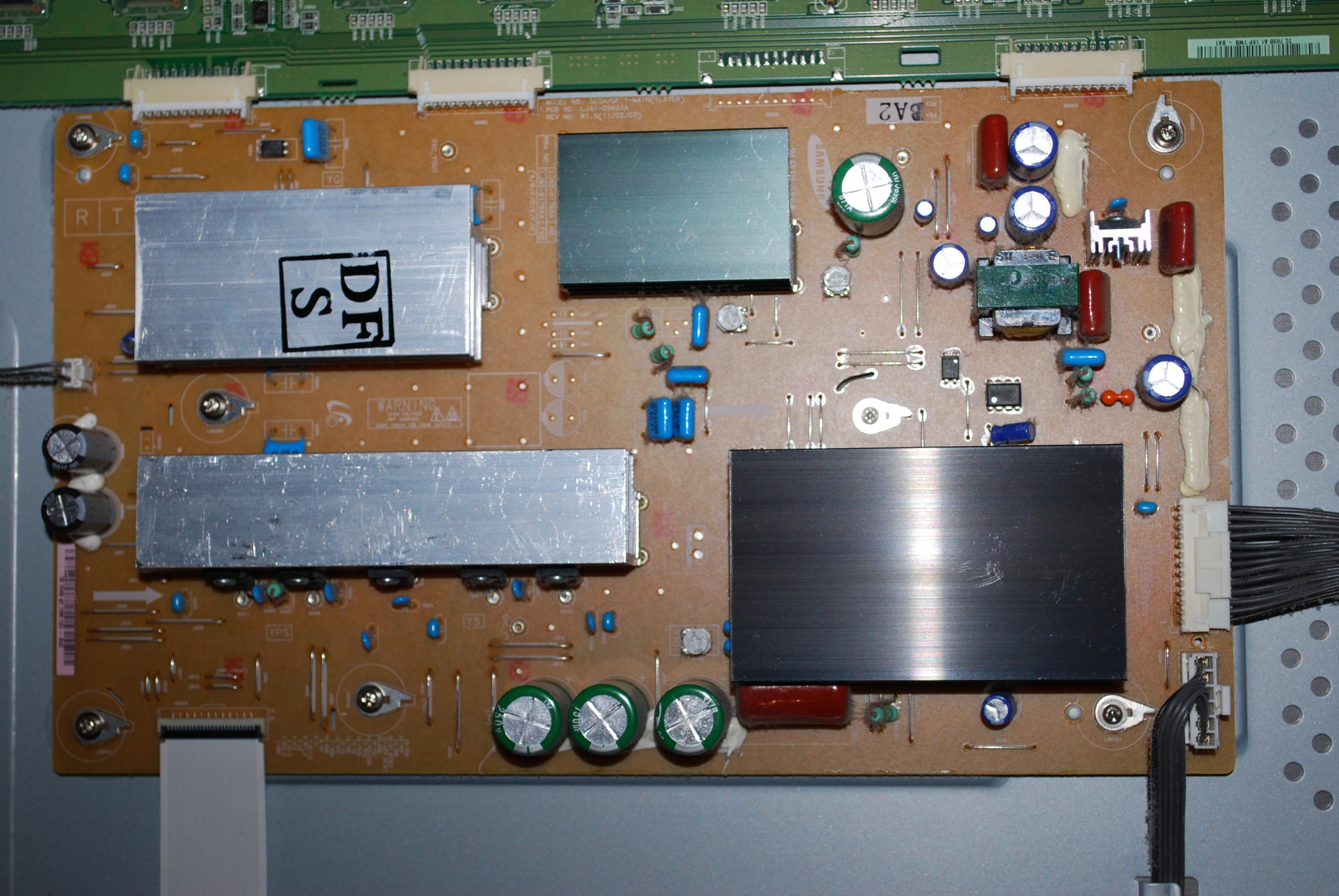

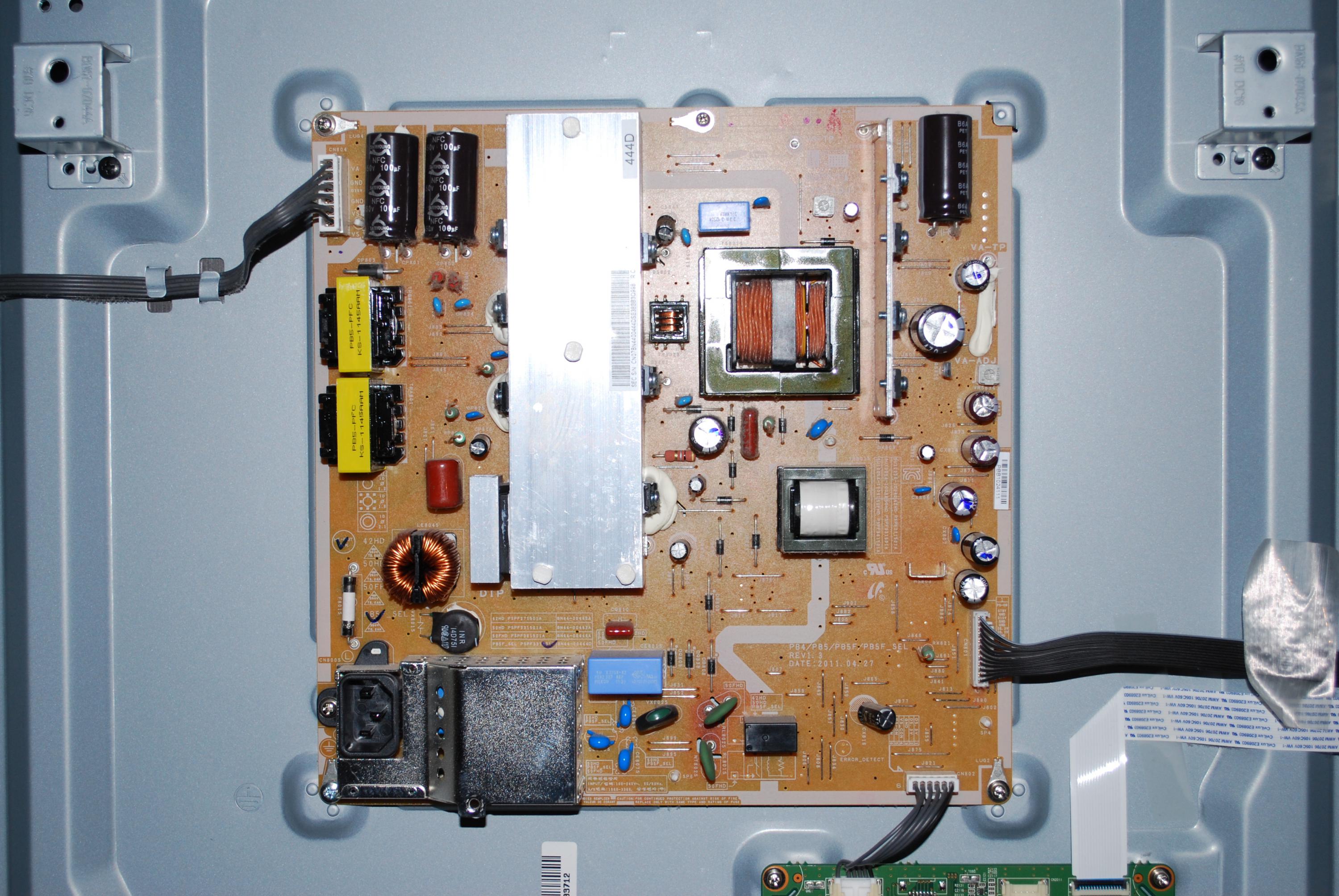

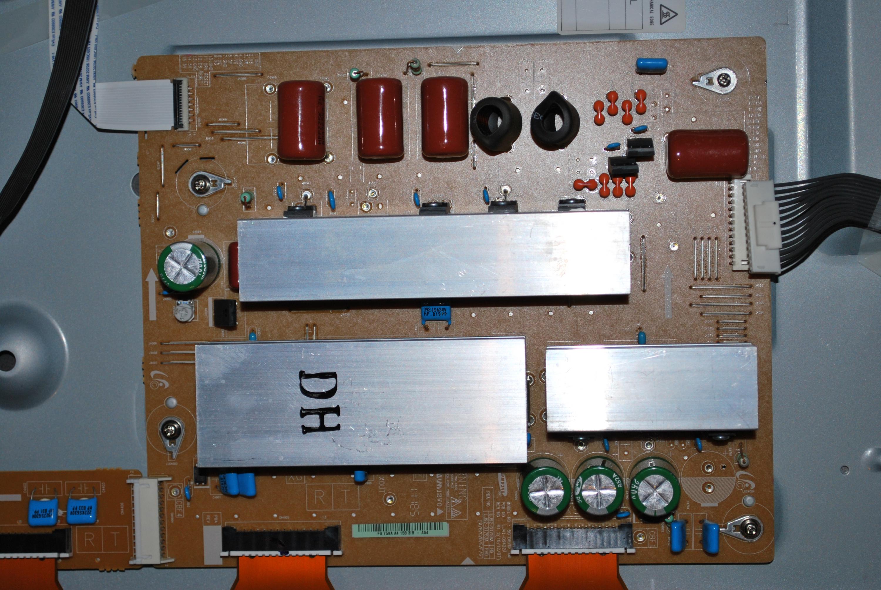

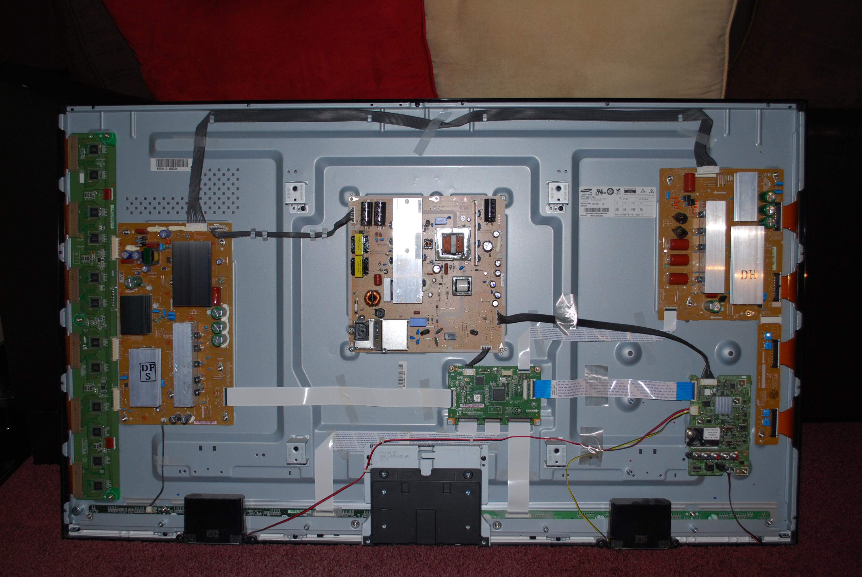

    So last week, I get home and try to turn on the TV and nothing happens. When I unplugged and plugged back in, all it would do is click 5 - 7 times and then nothing.
    I took it to a local TV service repair shop and paid $50 for an estimate. The estimate came back at $390 for a bad power supply and bad X main. (as well as something else which was ineligible - regulation???)
    I thought to myself, "Matt, you worked on million dollar aircraft in the Navy. Surely you can fix a TV." So I turned to google and was met with a plethora of information (good and bad).
    I disassembled the TV and first isolated the Y and X boards coming off the power supply. And lo and behold, it "turned on" with jingle. The I isolated the X main, but plugged the Y main in and it turned on again. I assumed that the X main board was bad, so I ordered a replacement from SHOPJIMMY and had it the very next day.
    I was so excited that I saved myself hundreds of dollars, but when I replaced the X main board, the clicking continued.
    I was assuming that since it powered on without the X main plugged in, that the power supply was good. Am I wrong for assuming this?
    If anyone can take time to help me, I would be very grateful. I already was forced to watch the Superbowl on a 27 inch.

    Posting pictures of the back of your tv showing the boards with clear pictures may help you more with fixing your problem
      Re: HELP!! Samsung Plasma just clicks
      Pictures of boards and chassis please

          Can you post photos of the insides of your plasma display?
          When you put in the shopjimmy Xmain it was back to clicking again I see? I did you unplug the X power plug and Ribbon cable and it came back on?
          Also make sure to get that ribbon cable on the Xmain in straight too.
              I did disconnect the X main and it still powered on fine.
              I will post pictures of the back when I get off work.

                  Check y main and y buffer board they are all connected to powers supply
                    When the y main and y buffer are connected (with the x main disconnected) it does start.
                    But when i connect the X main, it starts clicking.

                            so what voltages have u tested so far ?
                              So I haven't tested any voltages. But i do like to learn, and if you tell me where to check, I'd be happy to.
                                Could the power supply be frying the X Main?
                                  highly unlikey but we need you to take some VA/VS voltages as well as VY/VSC (Ysus test points) first.
