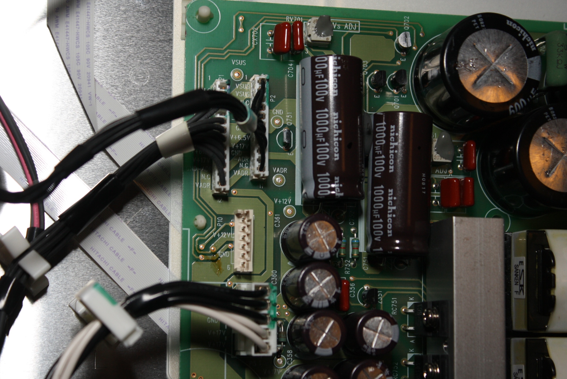

    I found some other ideas after doing more research on this forum. First, I unplugged the Y main harness, which yielded the same sounds and now a sequence of four blinking red lights. Next I plugged the Y main back in and unplugged the X main, which made no difference to the original symptoms (same sounds and two blinking red lights). It didn't power up enough to be able to try to find an audio signal.
    Are there any voltage checks I can do to further diagnose this issue? I have a digital multimeter and intermediate electrical skills so I am confident to attempt a bit more in depth diagnosis. Thanks in advance!

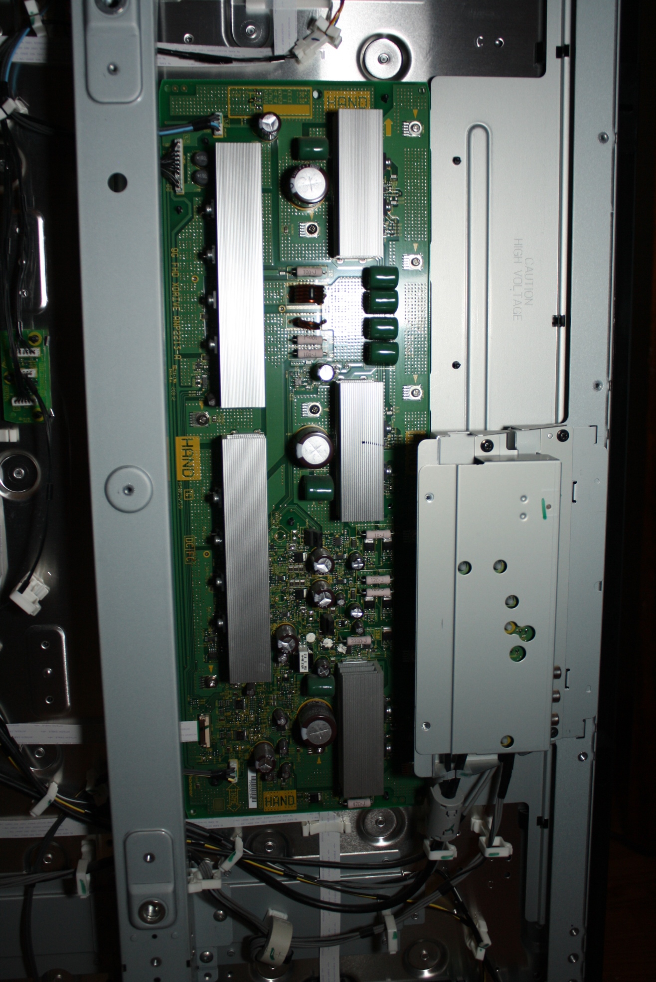

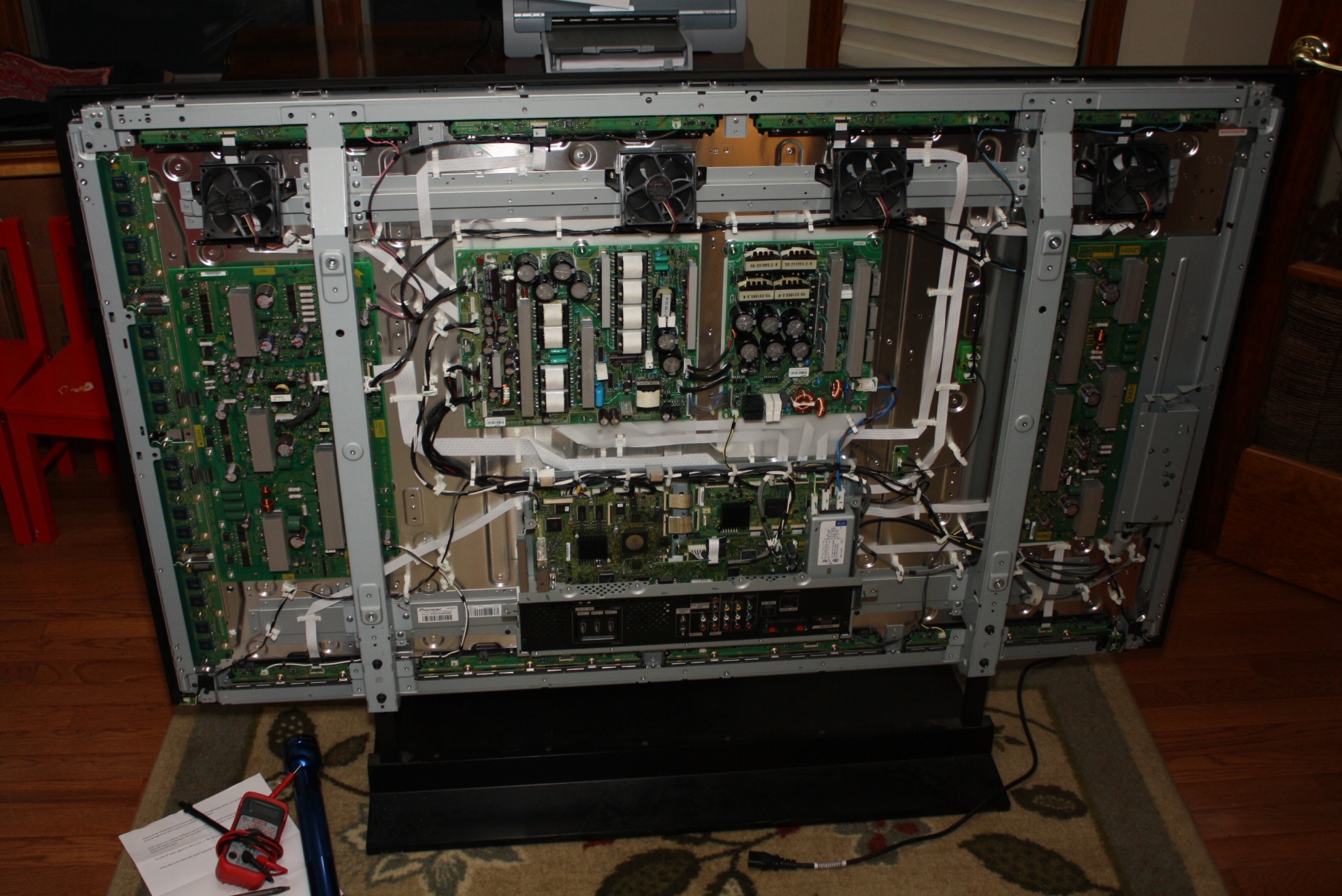

      Thanks so much! I was hoping you'd chime in. It was your thread that led me down the path of the unplugging/replugging tests I did last night. I can get more pictures but it will be tonight. I do have some pics, but only of the buffers. I thought I was missing something because I couldn't find any parts online for them. Now I know why. The Y drive is easy to find and a couple of places have them in the $60 range.
      Are there any particular pictures you would like to see? I will also get some pictures of the damage on the top of the capacitors on the power supply to see your opinion on whether that is an issue. I also still have the original power supply.
      Are there any other checks I should do tonight?
        Re: Pioneer plasma PDP-6020FD won't turn on

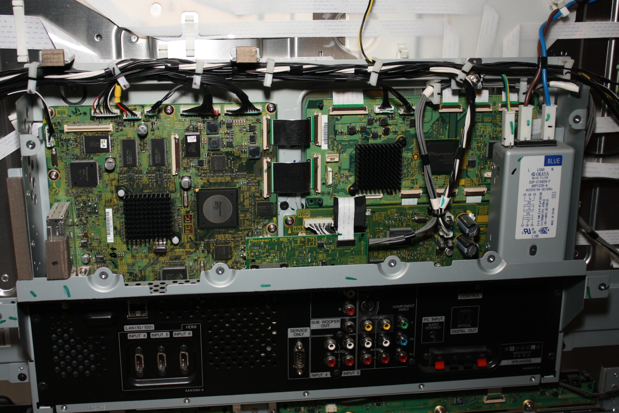

        Pictures of the overall layout and then one clear one of every major board will do. You can take a photo of the damage if you want (I doubt it is a problem to be honest.)

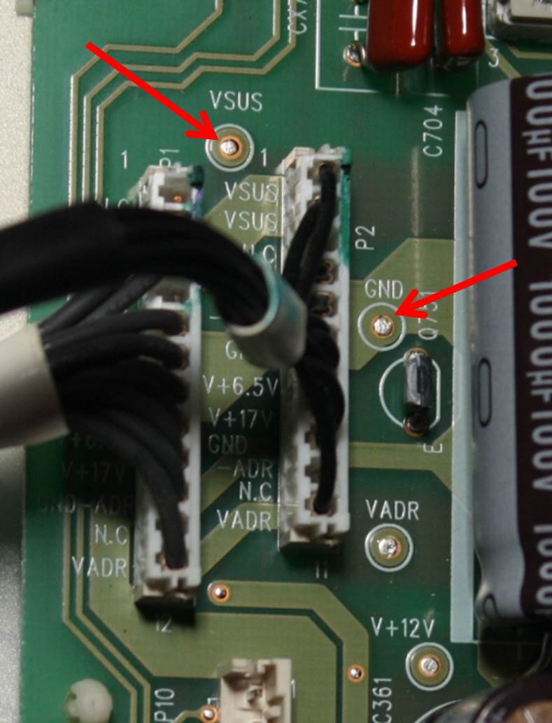

        As for checks, you could try checking Vs and Vd (could also be marked Va/Vda) outputs from your PSU. These will require a multimeter. You can locate the connectors going to each of the X- and Y-drive boards and check there.
        For a 9G 60" panel, approx Vs will be 212V +/- 15V and Vd will be 75V +/- 2V.
        These need to be tested with power connected so be careful, high voltage, danger.

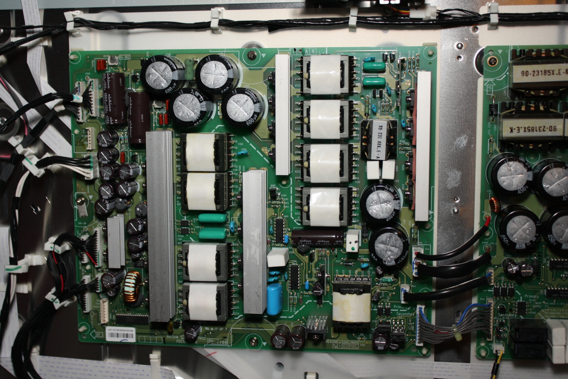

          Here's the pictures that I took last night. Most are self explanatory. The one labeled "power_damage" is a picture of the tops of the capacitors that I mentioned as having some damage from shipping.
          The one labeled "power_test points" is where I tried to find those labels you mentioned. I couldn't find them. The two cables on the top are the ones that go to the Y and X drives. The only ones I found were the circles on the board labeled, VSUS, GND, VADR, V+12V, and V+17V (that one is at the very bottom of the pic). Should I be looking somewhere else?
          The only cables that I could see that look like they have any business carrying 75 or 200 volts are the big ones connecting the two halves of the power supply board. You can see those clearly in the "power_damage" picture. Maybe the ones you said to measure don't carry much current, but regardless, I couldn't find them.

                    Tom, I really appreciate your help so far. Do you think I should proceed with replacing the Y drive or are there any other checks I should do?

                      Ok, there's a smaller connector on the top left of the power supply. One goes to Y-drive, other goes to X-drive. That has Vs, and I believe Vd on it. Can you see any pins marked Vs or Vsus? Check them for voltage both with Y-drive connected and disconnected. You only need to disconnect the large power connector.

                          There is a VSUS on there. I tested that last night and the new attachment here shows where I touched the multimeter, on those circles that I pointed to in the picture. I figured those are test points.
                          I plugged in the TV and tried to turn it on. The TV did the sequence I described earlier (it stopped trying to power on and started showing two red blinks). THEN I touched the multimeter to test it. The value was low, below 20V, and falling consistently. Could the falling value be because the TV is not powered on and the capacitors are discharging? Should I have the multimeter in contact as soon as the power button is pressed, to see what it does during the couple of seconds it takes while it is trying to power on and before it does the two red blinks?

                            That indeed are the caps discharging , try to measure immediately!
                              You should have the meter in contact with the point then power on the set. May require a helper.

                                I measured the voltages last night on the VSUS. With the Y drive plugged in, I saw ~20V for a second or so immediately after hitting the main power button and before the TV stopped powering up. The voltage then dropped consistently as the capacitors discharged. With the Y drive unplugged, it reached 208V before powering down. I did this a couple of times.
                                  That more or less confirms the Y-drive is at fault.
