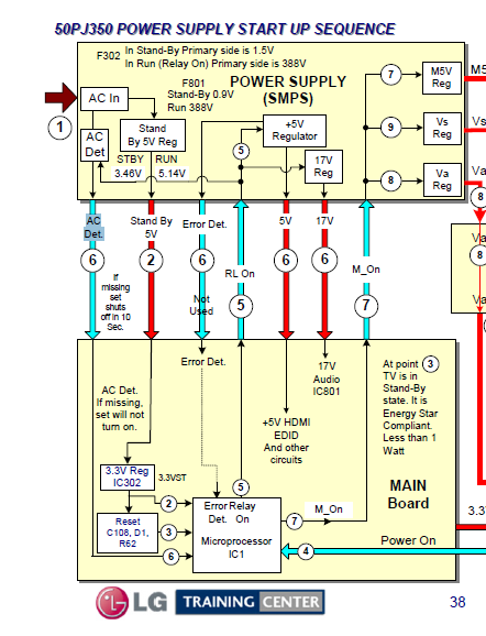

    I have a Zenith 50" plasma. Model: Z50PJ240-UB
    Set turns on and right back off. I found a training manual to test the SMPS. I am not receiving the 4.44 on the AC DET line. According to the manual the AC DET is collected from the Ac line rectified and then routed to the IC701. The IC then sends 4.44 on pin 16 to the main board. As long as 4.44 remains the tv functions. If AC DET is lost set shuts off.
    I want to test the rectifying circuit but cant identify where it is on the PSU.
    Any help would be appreciated

      In the training manual you'll find that you can turn on the PSU if you disconnect the mainboard OR if you disconnect the mainboard and then manually put resistors from 5V to RL_ON and M_ON .
      This will turn on both relays and then 5V VS VA etc.
      The PSU will stay on.
      They recommend putting a load on VS even though it works without it too.
      AC_DET is indicated as being an output on the page that says: "Signal and Voltage Distribution Block". If I follow the trace it comes from pin 2 of IC701 of the PSU, i.e. the uC IC701 detects if there is AC somewhere else and then activates this output.
      On the primary side of the PSU you will see two long resistor chains which could both be involved in measuring incoming AC, they then go to one of the optocouplers. The resistor chains come from cathode of D103 and anode of D308. You will have to draw parts of the circuit.

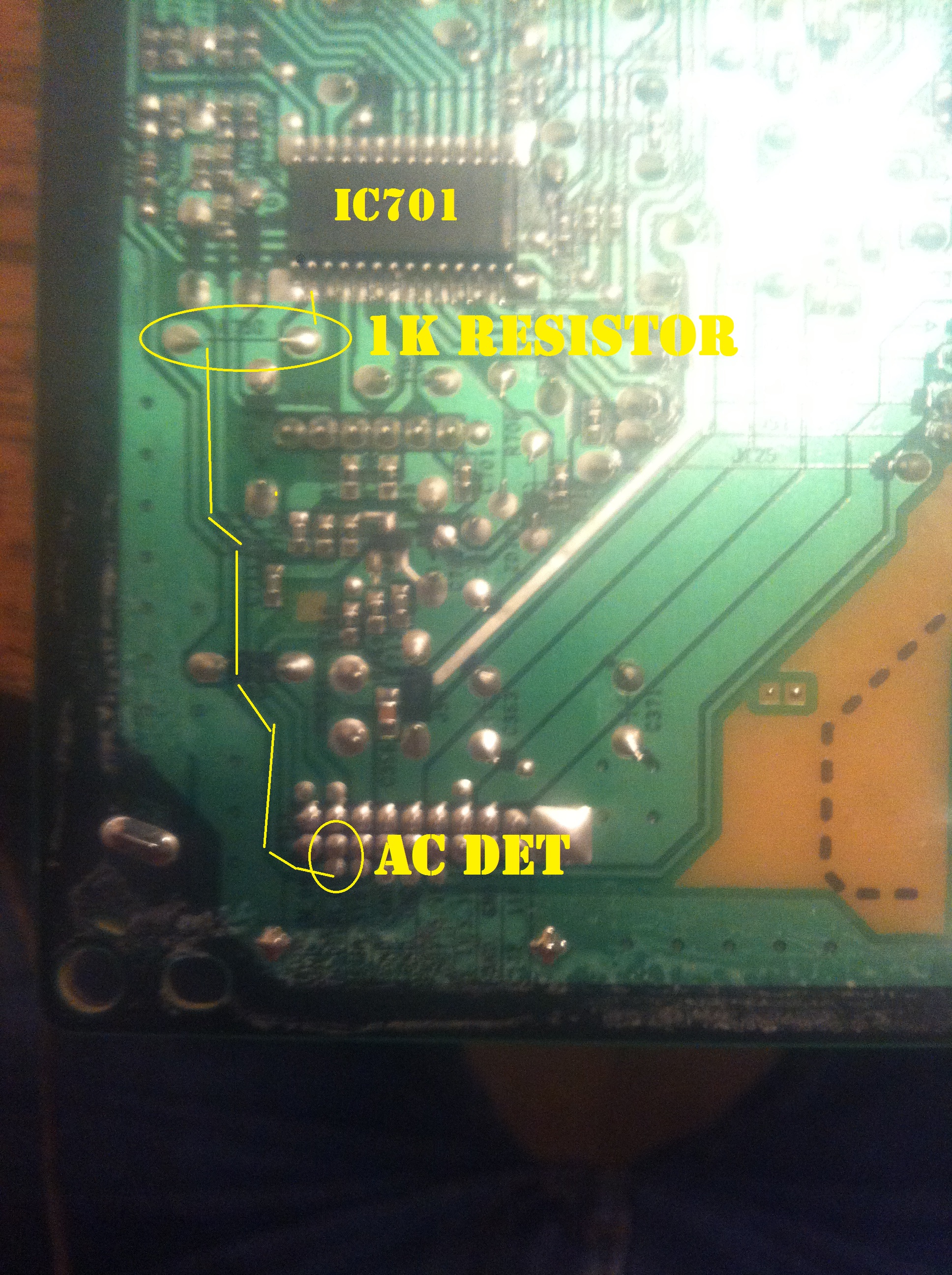

              • joshbsg
                • Feb 2014
                • 13
                • U.S.A

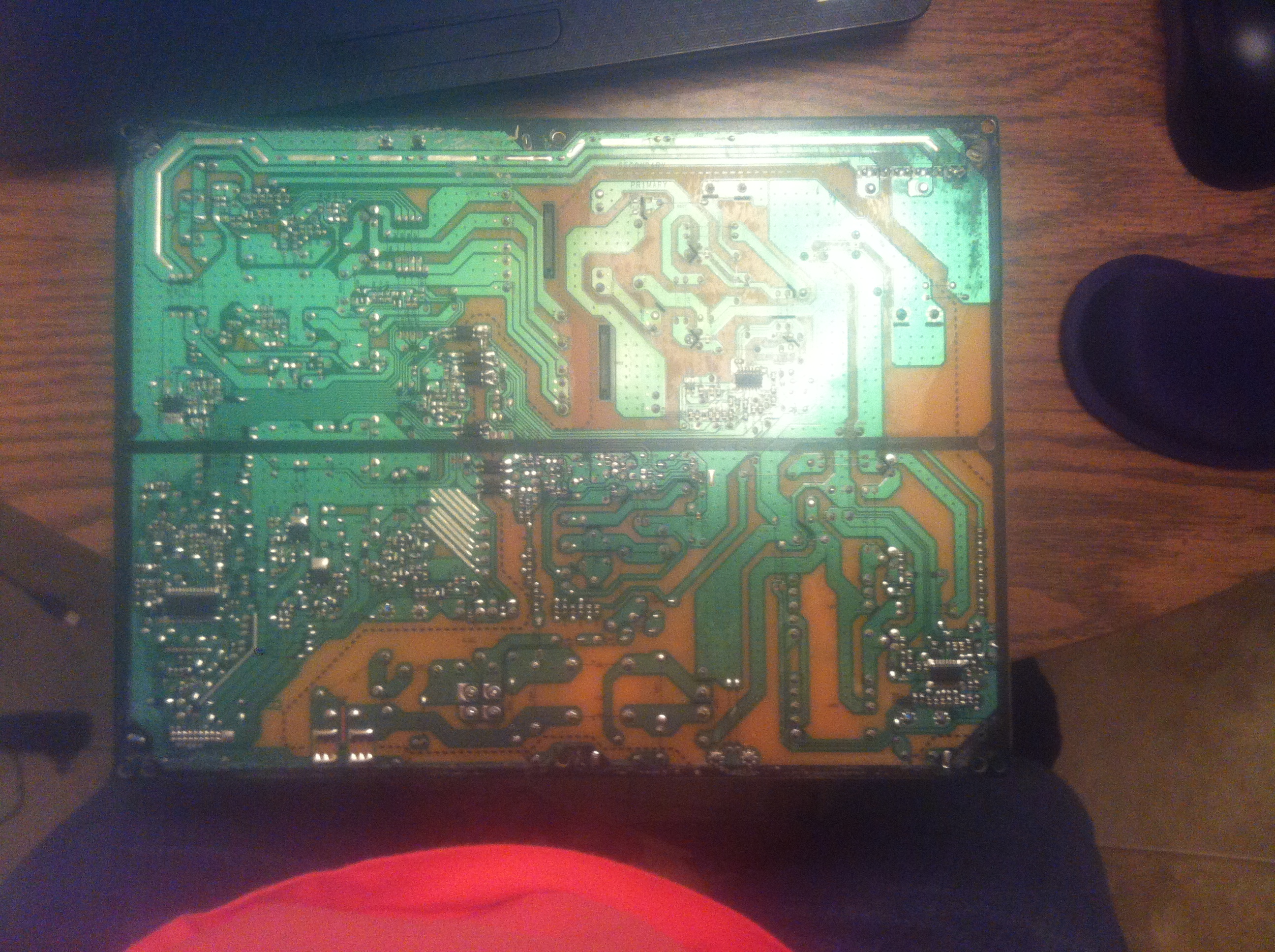

                Re: Not getting AC DET on plasma
                Here is the PSU

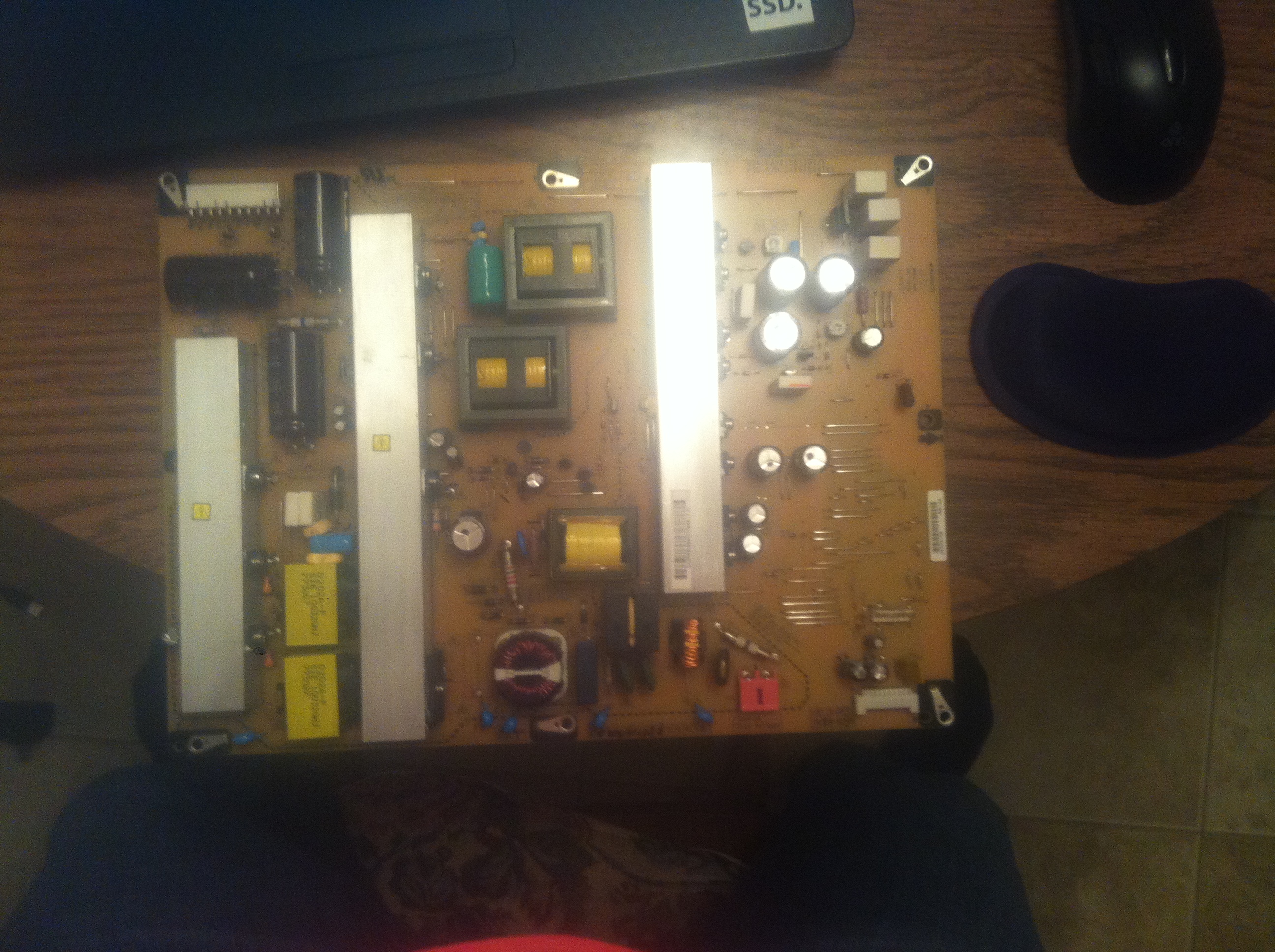

                    Paulstef:
                    The PSU 'never' gives the AC DET. Here is a pic. You can see where AC DET goes up to IC701 through a 1k resistor labeled R730.
                    If I tricked the mainboard by supplying 5 volts on that line it would not tell the tv to turn off. However, where can I steal 5 volts from on the PSU?
                      Im not sure that IC701 is getting the voltage to send down to AC DET. The resitor and path from IC701 is good. This has to be an issue with the IC701 or the rectifing circuit that supplies the voltage to the IC to give to the mainboard.
                      What do you suggest?

                        • paulstef
                          • Dec 2013
                          • 724
                          From what I understand it works like this:
                          If the signal AC_DET does not go to the uC on the mainboard then the uC on the mainboard will shutdown M_ON and possibly RL_ON.
                          Agreed on that?
                          Therefore if you desolder the resistor terminal that goes to pin 2 of IC701 and connect 5V to that resistor the uC on the mainboard will get it's AC_DET. Pin 2 of IC701 will not be connected anymore.
                          You can take 5V from P813 from either 5V1 or M_ON (which will be on once the mainboard sends the signal).

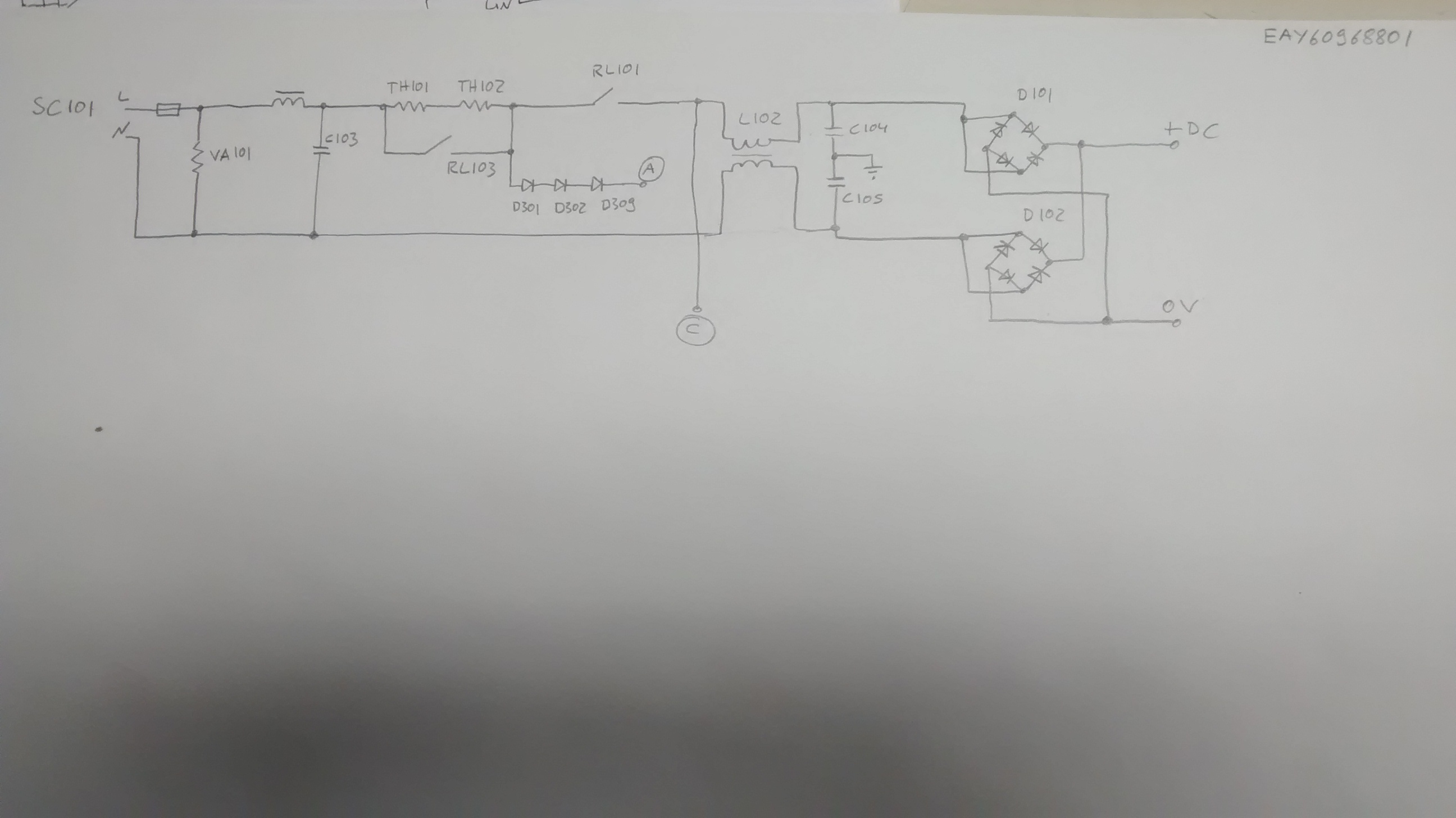

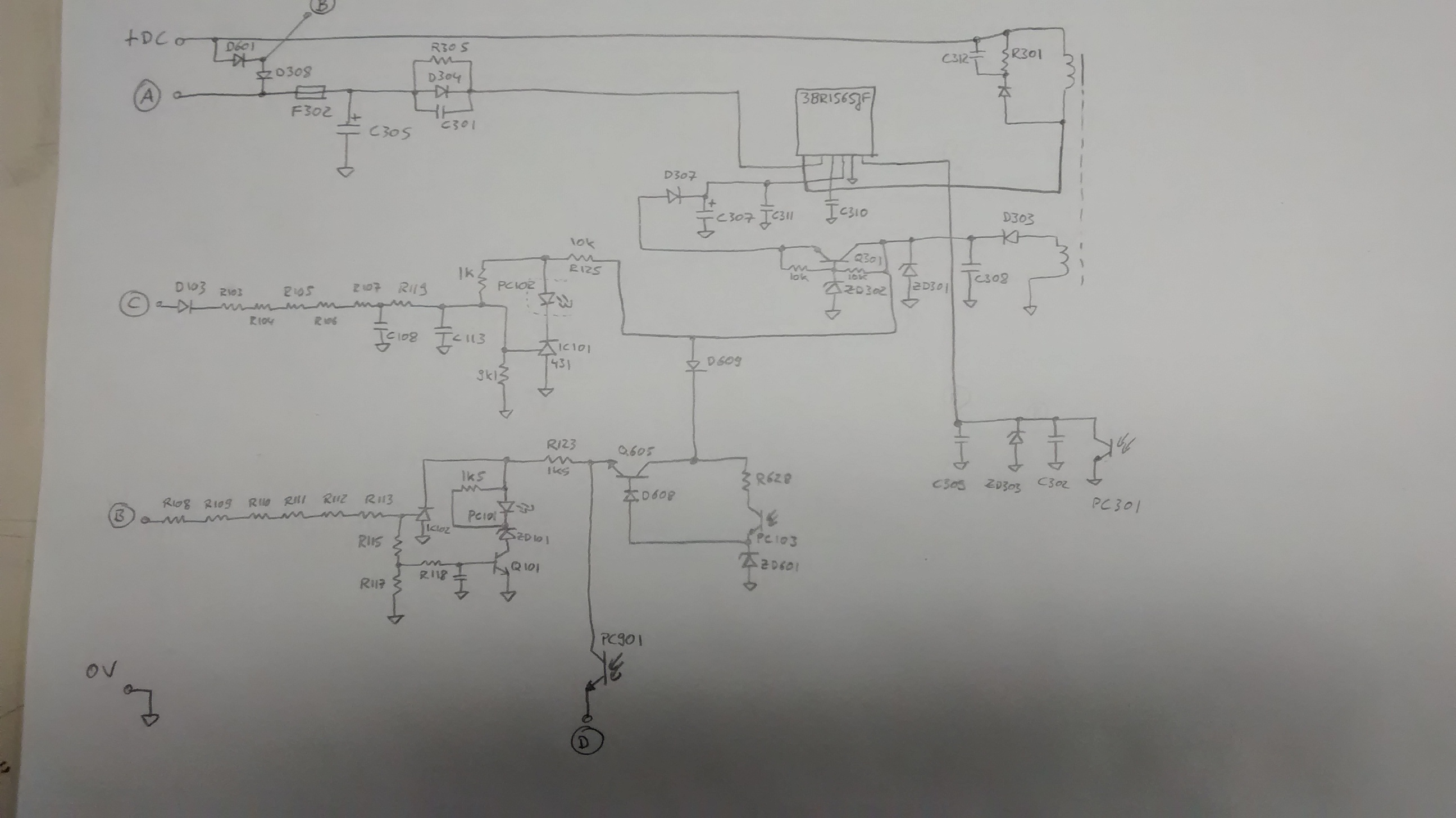

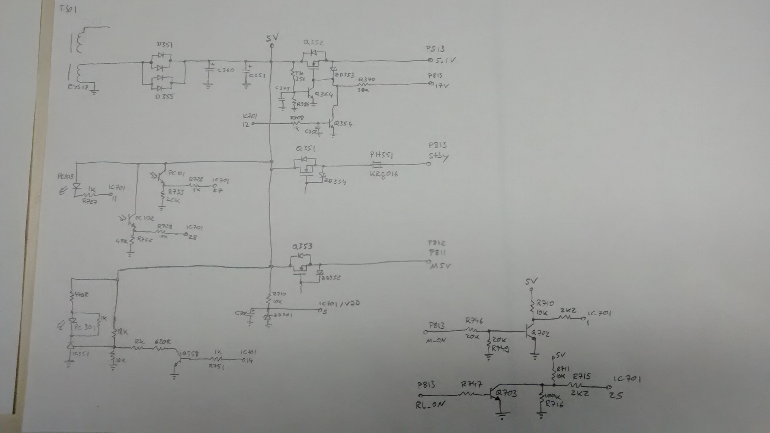

                              The most likely to detect AC seems to be right after RL101.
                              The mainboard turns on both relays, if AC has the right voltage PC102 should be ON. You should then get 5V on pin 28 of IC701.
                              These diagrams is all I have so far.
