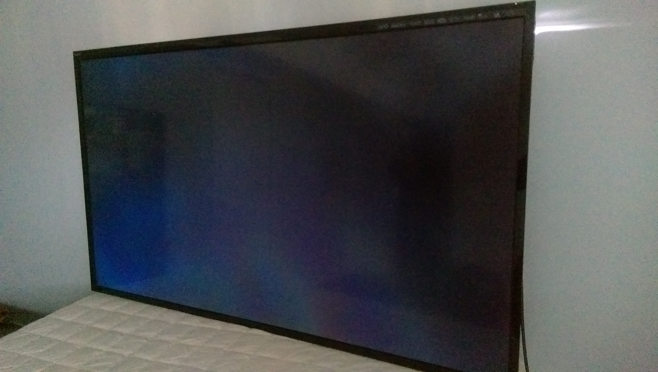

    Hey guys I was poking around the forum for an answer and still dont have a clear answer as to what could be the cause the video and audio not to work on this Vizio Model # e701i-a3. Serial # LFTRNXAP1002583
    My suspicions are either Main Board or T-CON .
    What I've done so far...

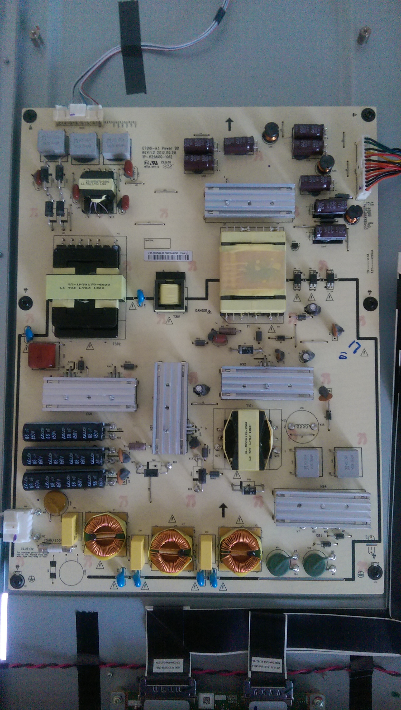

    Tested the power supply for power with meter and seems to be in good working condition.
    No signs of bad Fuses
    No signs of bad caps.
    No signs of bad Diodes.
    Tested each HDMI port on the Main Board for audio/video and nothing.

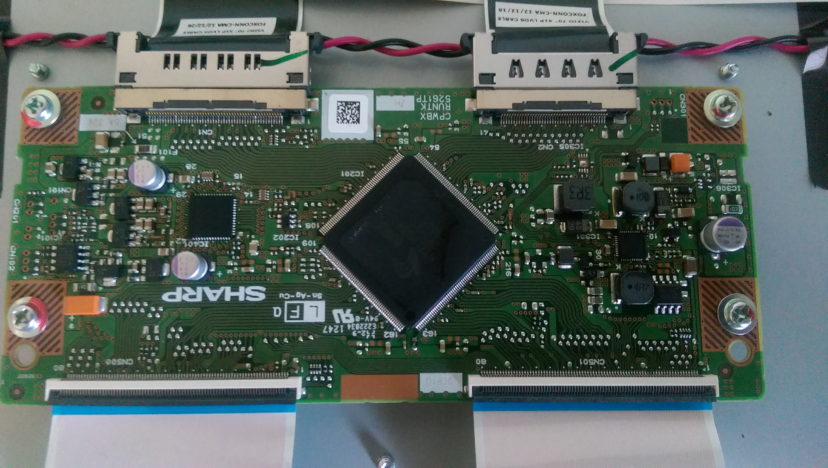

    Unplugged one ribbon from each side of the T-con at a time and no change was seen.
    Disconnected the ribbons going to the power buttons and to the IR sensor one at a time and vice versa and no change
    I dont think the T-con would be responsible because I know the T-con isnt responsible for audio issues.
    I've heard about the recall with the 70" Vizio's however the one I have doesn't fall under the ones recalled, however its almost doing the same thing as those other ones.
    All in all, im suspecting a bad Main board.
    Any input at all would be helpful

              i think in this case, jumping to the "bad panel" conclusion is premature, as a bad panel, just like the tcon, would not be able to cause any audio issues. verify that you truly cant change input's till you hear sound coming out of one of them, and then most likely it has to be bad motherboard. i wouldnt assume a bad panel until i knew i had a good motherboard and tcon and still was having the same problem.

                    see other thread on this tv. Likely that the panel is taking out the tcon board.... actually a component on the tcon board which is shutting down part of the tv.
