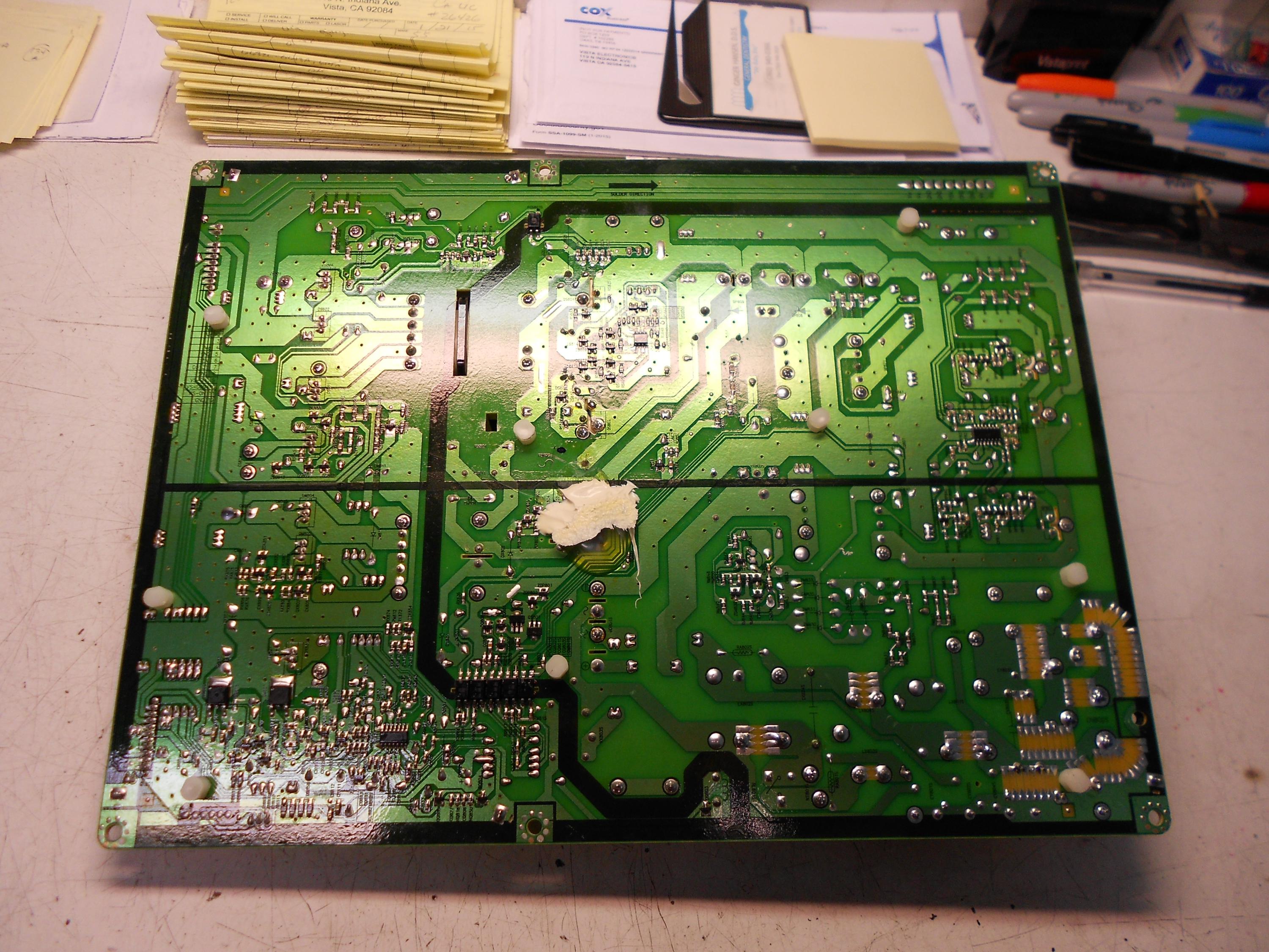

    PN60E8000GF had click-click or totally dead = no standby.
    Apply slight downward pressure on middle heat sink brings all voltages back.
    Power supply appears to be slightly warped....dubious repair. Replace
    the board for a solid, no recall repair ! Or remove all the glue blobs and attempt
    a less expensive as-is fix.

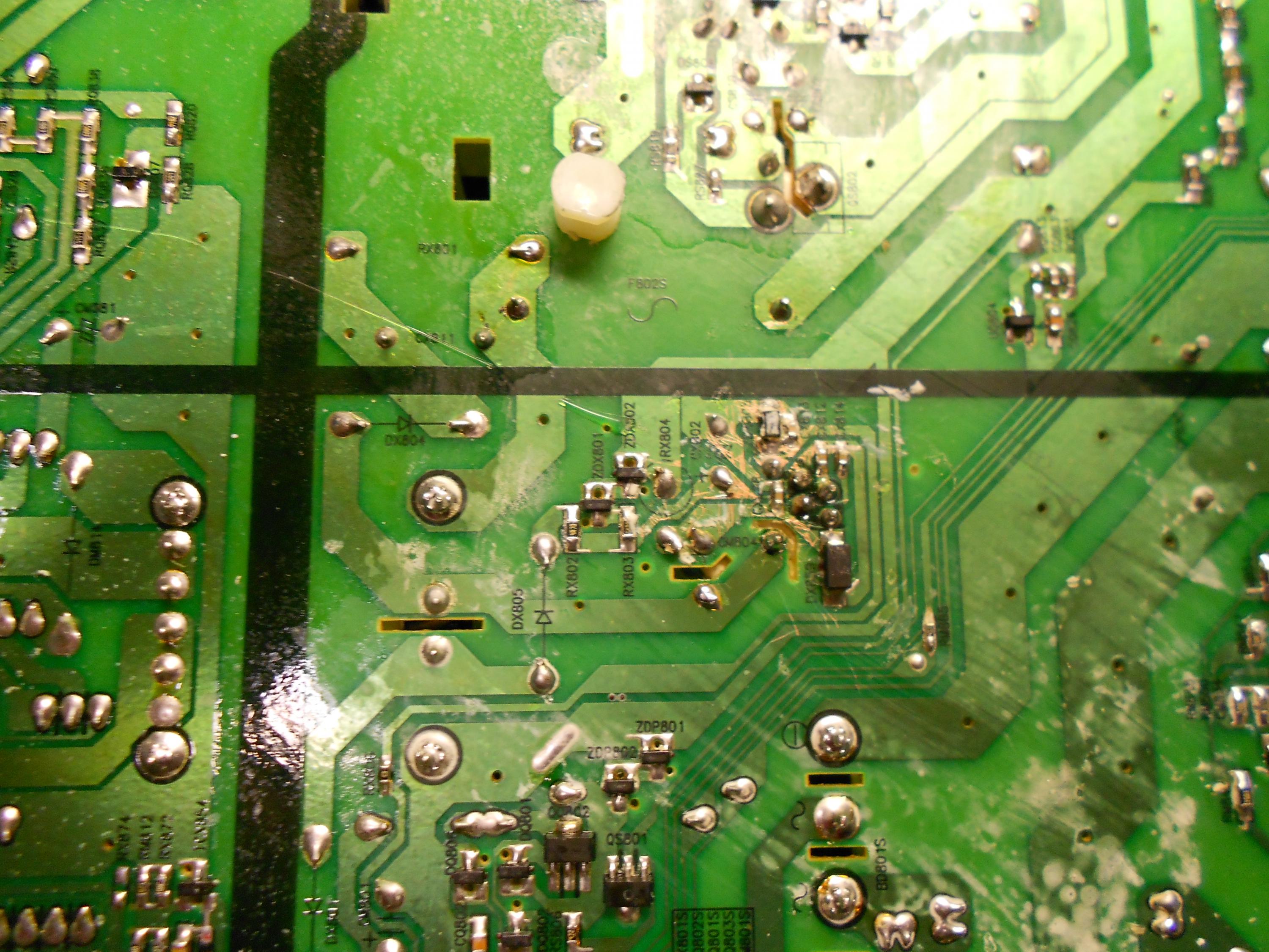

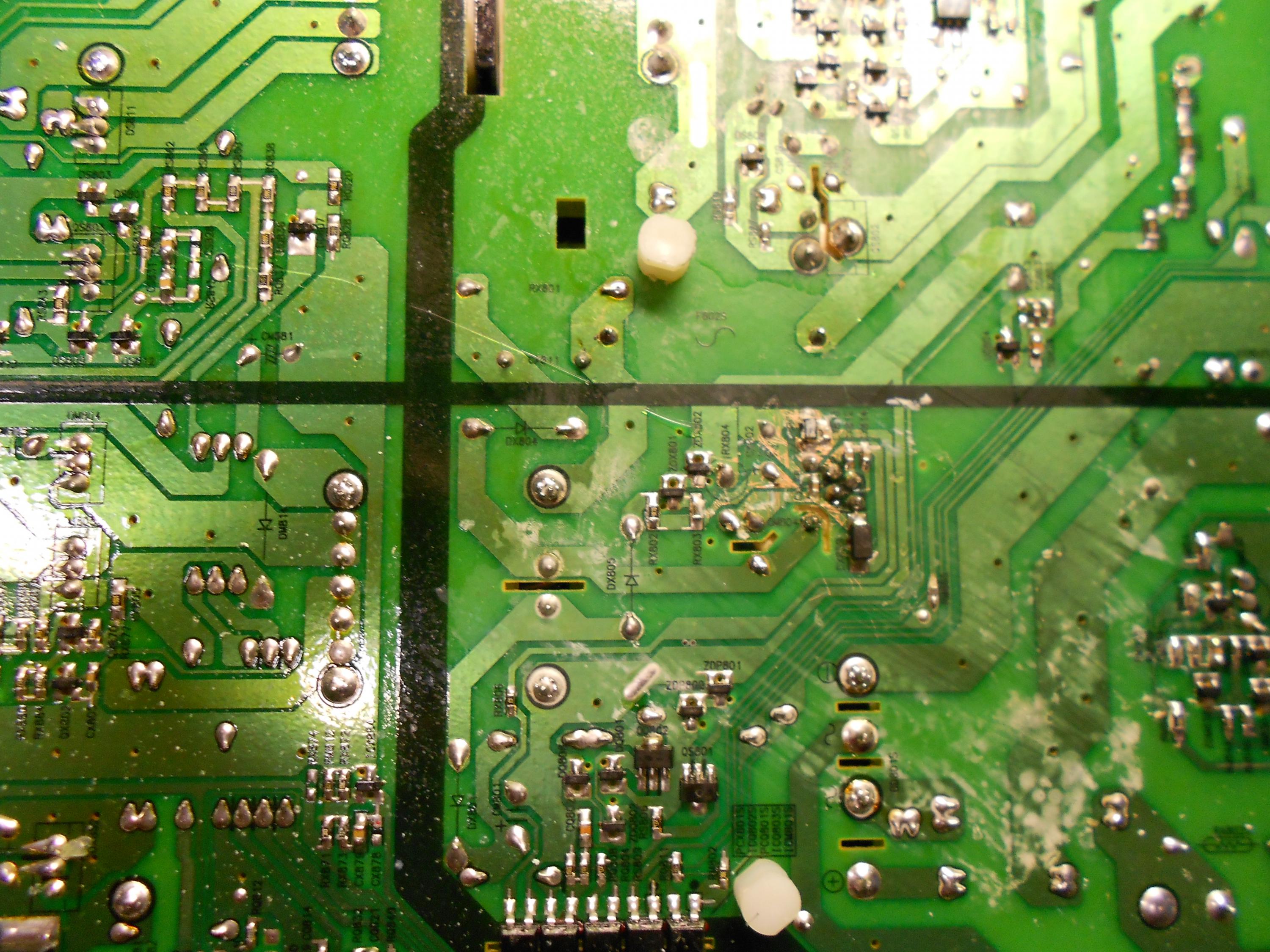

    Can we see the pictures of your board? If you can put pressure on the board to make it function, then it sounds like you have bad connection/s.
      Re: Samsung SMPS no standby question BN44-00514A (P60SW_CPN)
      Here ya go !

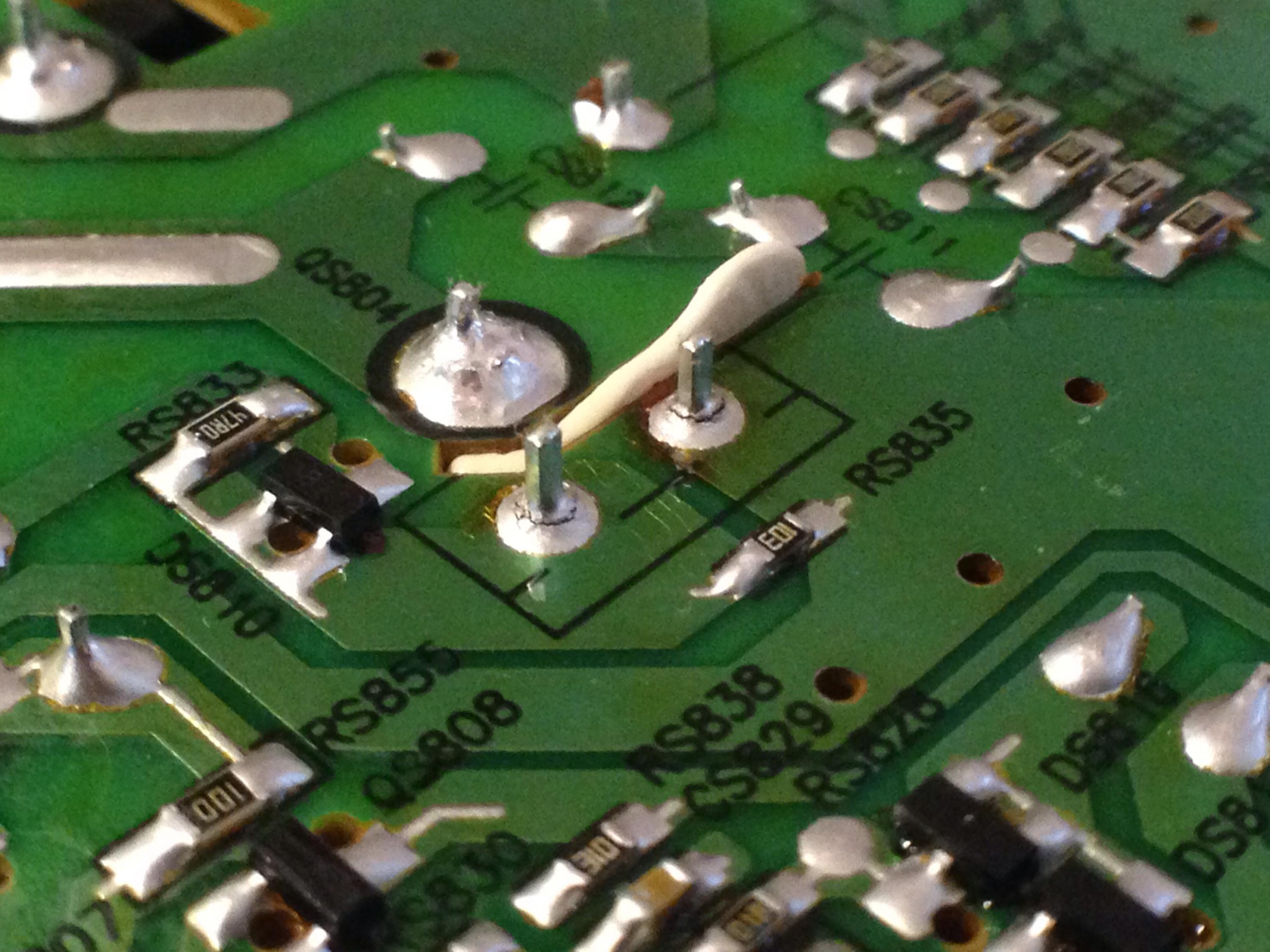

        I have done a number of these and the 64" versions. Always cold solder joints on qs804.
        I have even had brand new boards from samsung come with bad solder joints on that location as well.
          This is what it will look like
            Samsung seem to have a lot of cold solder issues. I've seen a 32" LED Samsung (D-series) with cold solder on the bridge rectifier (symptom dead with no power.)
              Yep, very common ring around the collar.
                Bingo ! Thanks all ! I removed the BLOB as you can see in the pix.
                Soldered area as needed = fixed !
