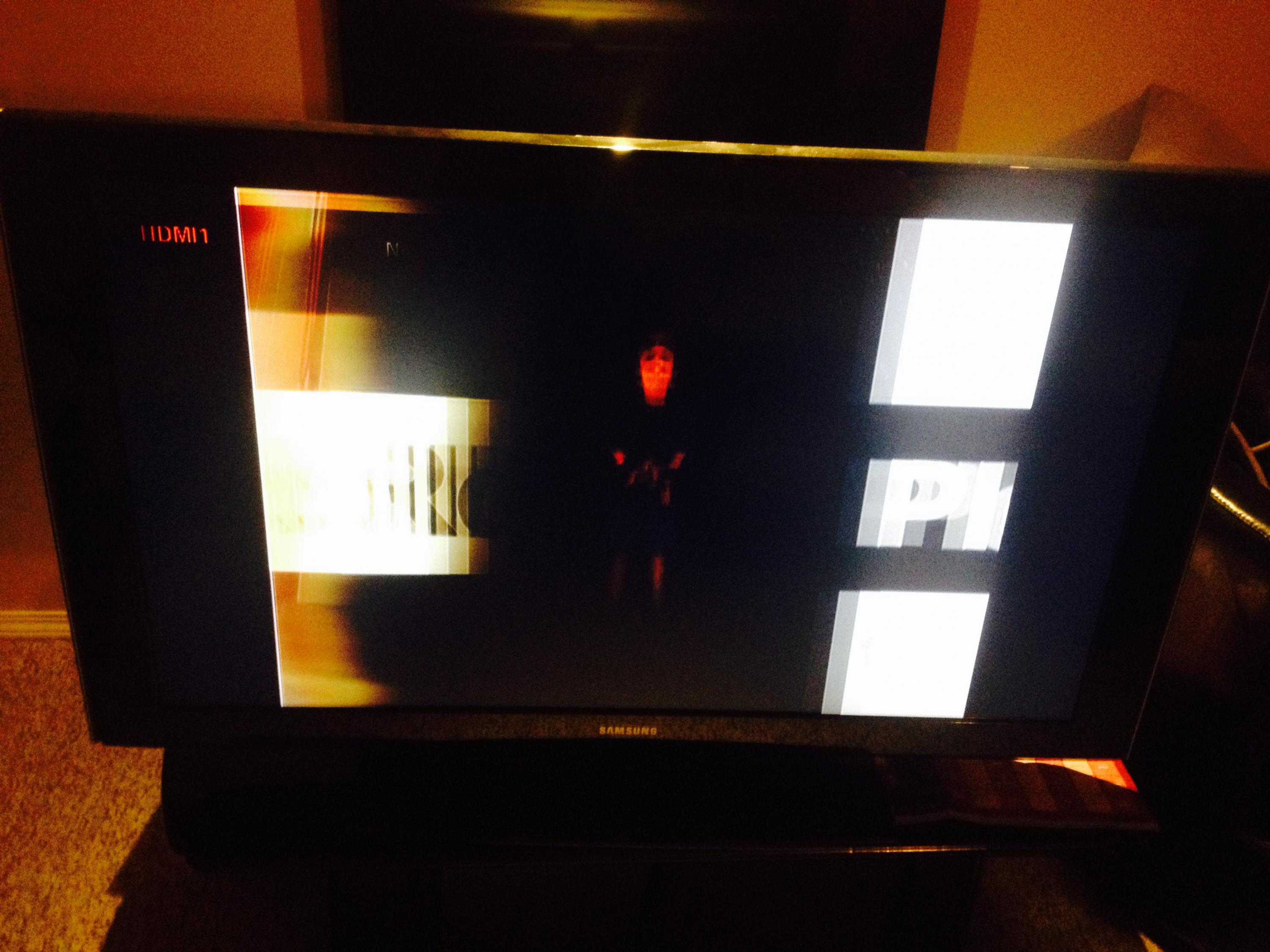

I have an LCD tv with a display issue. When the tv is turned on the display is wonky, then after about 20 minutes it is normal picture. Is this a display issue or something else?
Samsung Model LN46A530P1F LCD display issue

Just google "Tab Bonds Badcaps"Please upload pictures using attachment function when ask for help on the repair
http://www.badcaps.net/forum/showthread.php?t=39740Comment

Any screeching through the speakers ? May or may not be related..

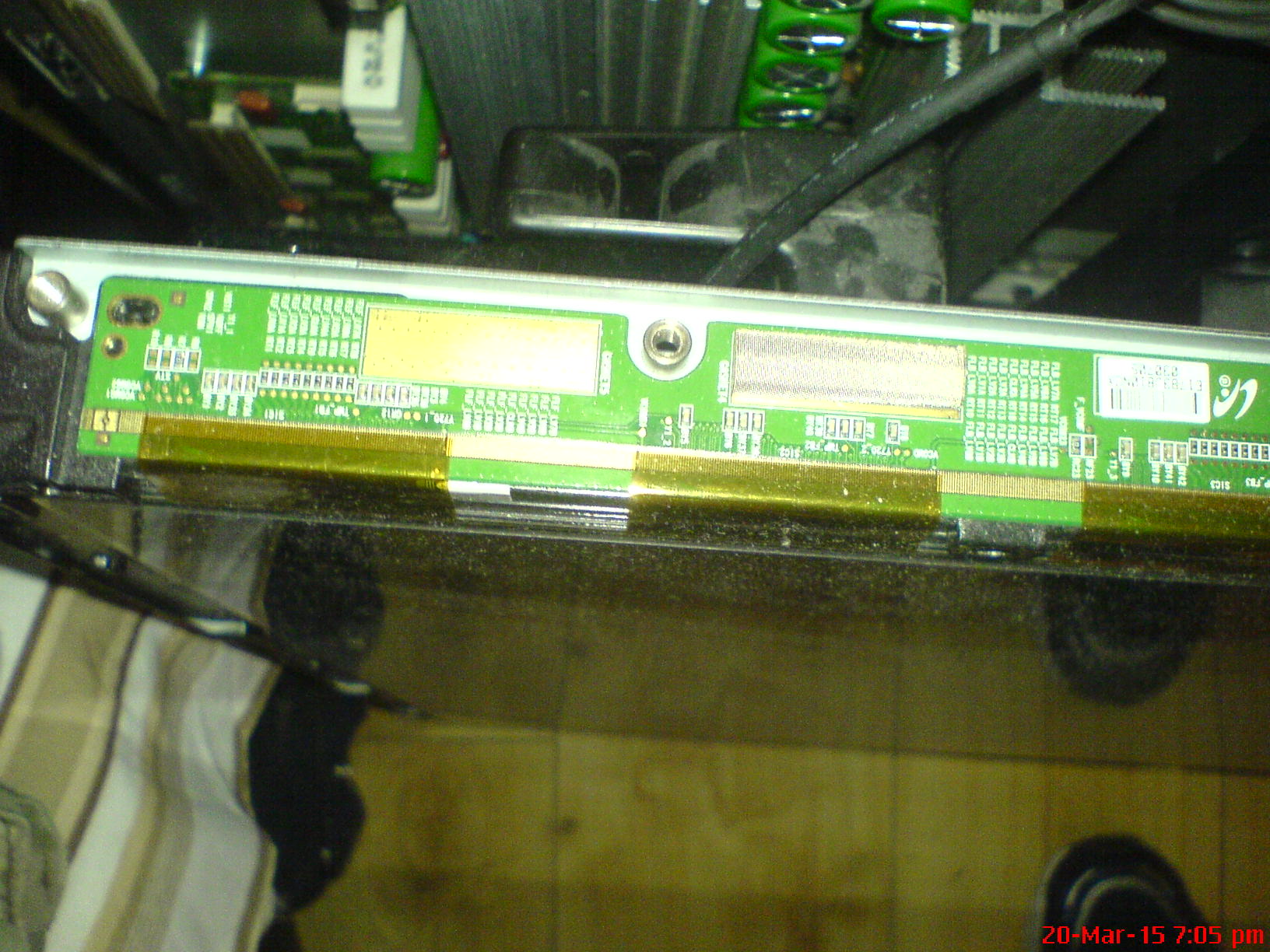

Hello,long time lurker,first time post,i had same issue as original post,decided to have a go at repair,found offending tab,top left,made a shim,worked for 3 days,tried second time and as i applied pressure my finger slipped and my ring hit the tiny resistors behind tab and screen went blank,just hoping someone can tell me whether i have ruined panel or maybe just destroyed t-con,reason i mention t-con is before this happened when i disconnected t-con i got white screen,now nothing happens,thanks in advanceComment
Re: Samsung Model LN46A530P1F LCD display issue
Those parts on the actual tabs are the driver-chips and are unreplaceable.
Give us a picture of exactly what you mean.TELEFIX
PLEASE DO NOT EMAIL ME PRIVATELY FOR REPAIR ADVICE. QUESTIONS BELONG ON THE FORUM!Comment
So sorry for delay in getting photo up,i hope this works my ring hit 1 or 2 of the 4 little fuse types above the left tab in photo,tv still has sound and backlight comes on but picture faded away,when i disconnect left side of t-con and reboot i get half white screen,dont know if it means anything,thanks for helping Alastair,have i destroyed the screen ?.Comment
