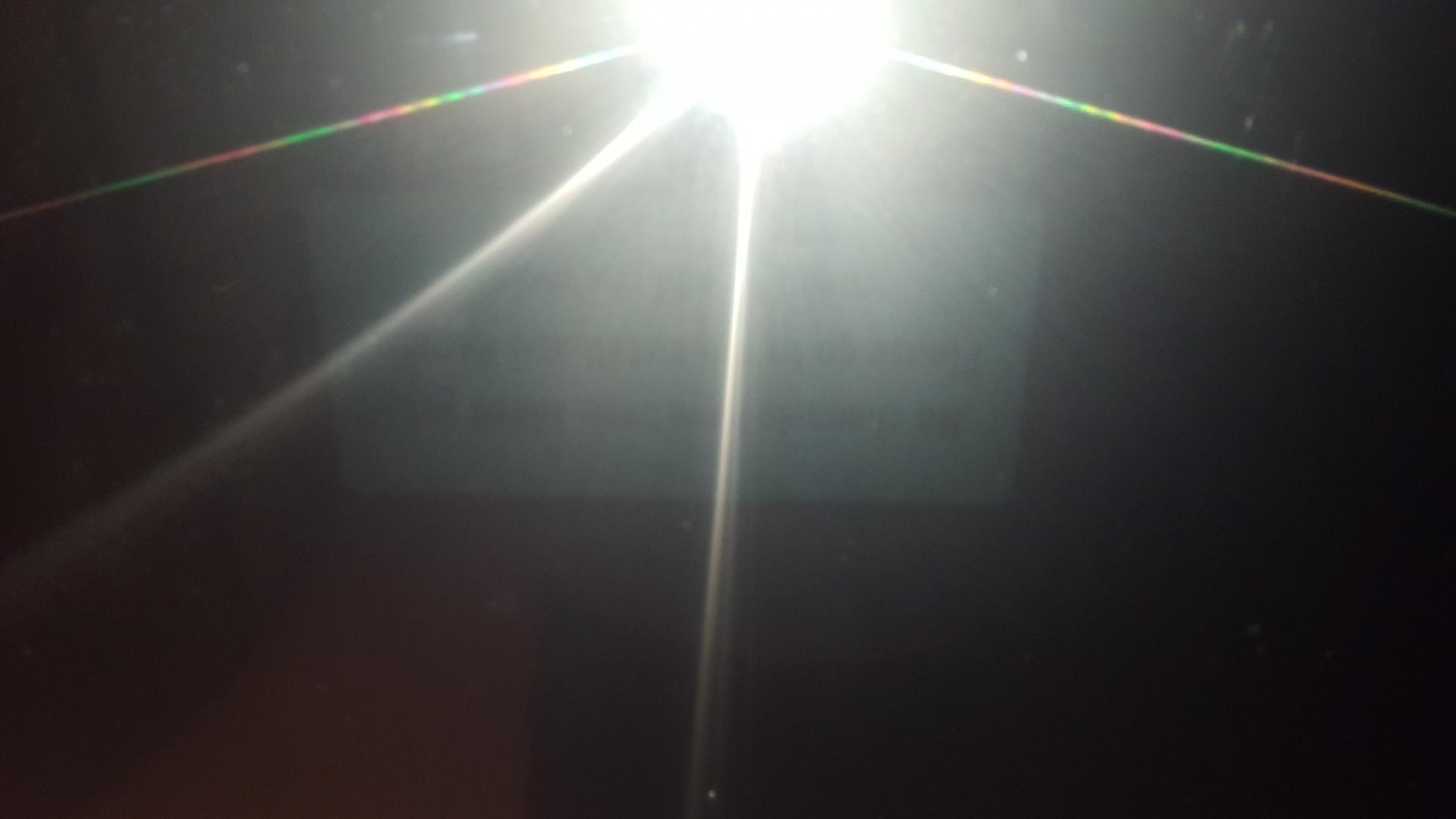

              Re: Toshiba 32w1333d - Flashing red/green standby light
              if i shine a light on the panel i can see a message saying no channels have been added yet and strangely it upside down ?
              • sordids999
                • May 2013
                right i can basically use the tv menu but upsaide and no backlight i have tried a factory restart but still the same
                  Well Sordids999 I have fixed lots of these crappy Led Tvs. As the voltage starts then collapses you have a failed Led with in the Lcd module. Tear apart the panel and get some images of the strips should be 2 strips with 22 Led in total.

                        #31
                        Yeah but your backlight is out not intermittent ? The supply briefly fires but then shuts down. I would recommend you take the panel apart first check this out:

                          #32
                          Right so it seems the to has two faults Led and software due to the screen upside down ?
                          Are the LED easy to source ?

                            #33
                            You can replace the actual bulbs they are easy enough to source from sashed screen Tvs if not you can easily substitute them.

                              #34
                              The confusing part is that i have flashed the main board with latest firmware but still the screen is upside down so the only option i can see to correct this is a replacement main board ?

                                #35
                                That is weird, I think there is an option to rotate the screen is the SM.
                                      Right so finally stripped the panel down but does anyone know the best way to test the LED`S ?

                                        #39
                                        And im not convinced the LED`S are at fault if i disconnect the LED strips and measure voltages going to the strips im getting the same again voltages starting high then dropping gradually
                                          The Voltage will rise up to high level util trip point is reached (it is constant current source so Voltage is varied to maintain constant current through the load), there is protection circuit to shut down if no load is not connected or open load condition.
