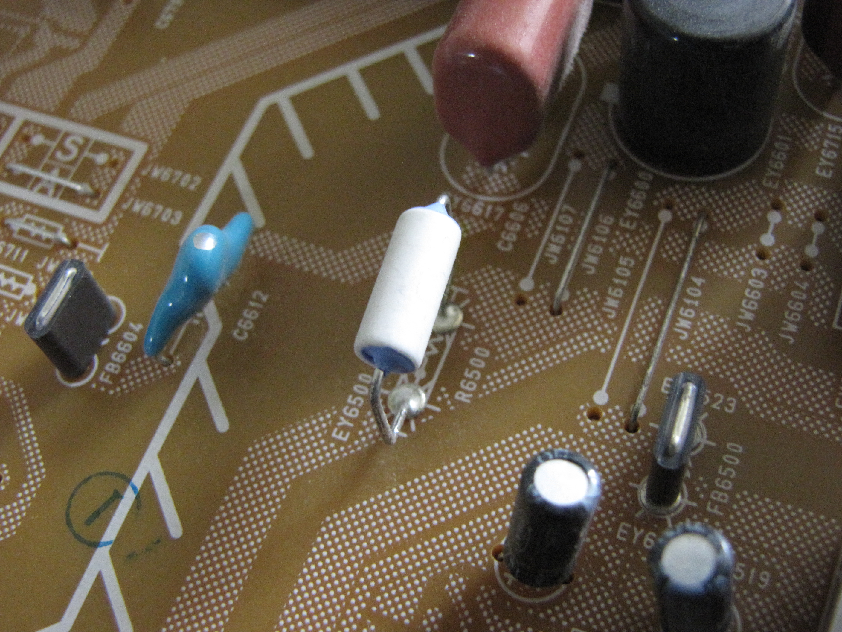

    Sorry I'm new to testing a resistor, how should I test it? Probes either side on 200 ohms?? This is the resistor correct? Just would hate to do something wrong.
            That is correct.
            No power APPLY to the TV.
            Set meter to 200 Ohms scale, then touch the two probes of your meter together and note the reding, then put the probes on the two legs of the resistor, the display should show about the same as when you touch the two probes together (<1 Ohm).

              Touching the two probes together is 1.4 - 1.6 and on the resistor it's 1.9 -2.0 with no power
                Re: Sony KDL-46W4000 (2 blink code)
                OK, the resistor is not bad, so now we will need to look deeper in the 12V power supply section, that will be tomorrow.

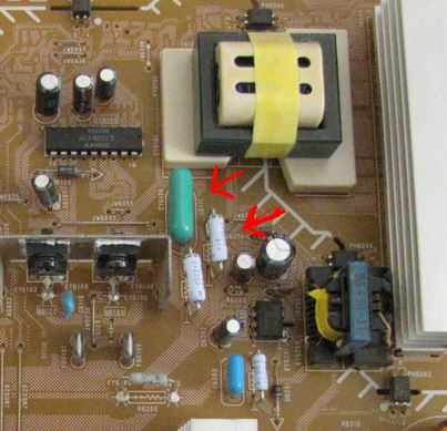

                              OK, sorry I did not see the post, it is usually shows up in BOLD for the thread that I have not read yet.
                              You need to remove C6111 (0.018uF 1000V) and find out if the capacitance is still within the spec., the cap should be around transformer T6100 for the 12V power supply.
                              Also check R6120 (0.22 Ohms 2W).

                                    I removed C6111 from circuit and from what I read to put DMM on Ohms? It read nothing at all, tried volts as well and nothing came up.
                                    When I had C6111 in circuit and at 2000k it showed 270 Ohms and 0.02 Volts. With the switch activated it showed 384 Ohms.
                                    Tested R6120 and that showed 00.8 Ohms at 200 on DMM.
                                    Attached a picture to confirm I tested the right ones.
